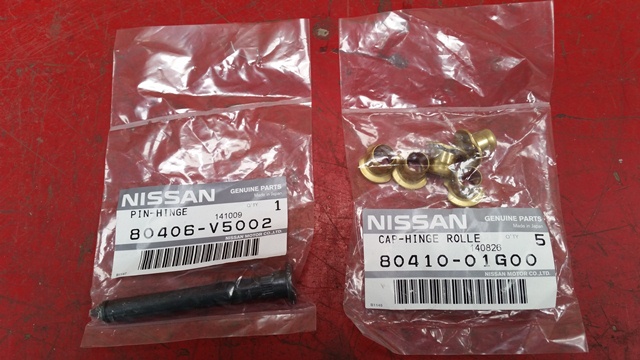

FYI - Essendon nissan quote
80406-V5002 - $18each pin
80410-01G00  - pack of 5(can’t sell separately)  - $25
Btw, the pins are slightly different, and the spline is shorter on the Nissan ones above. I think the ebay ones are closer to the original.
