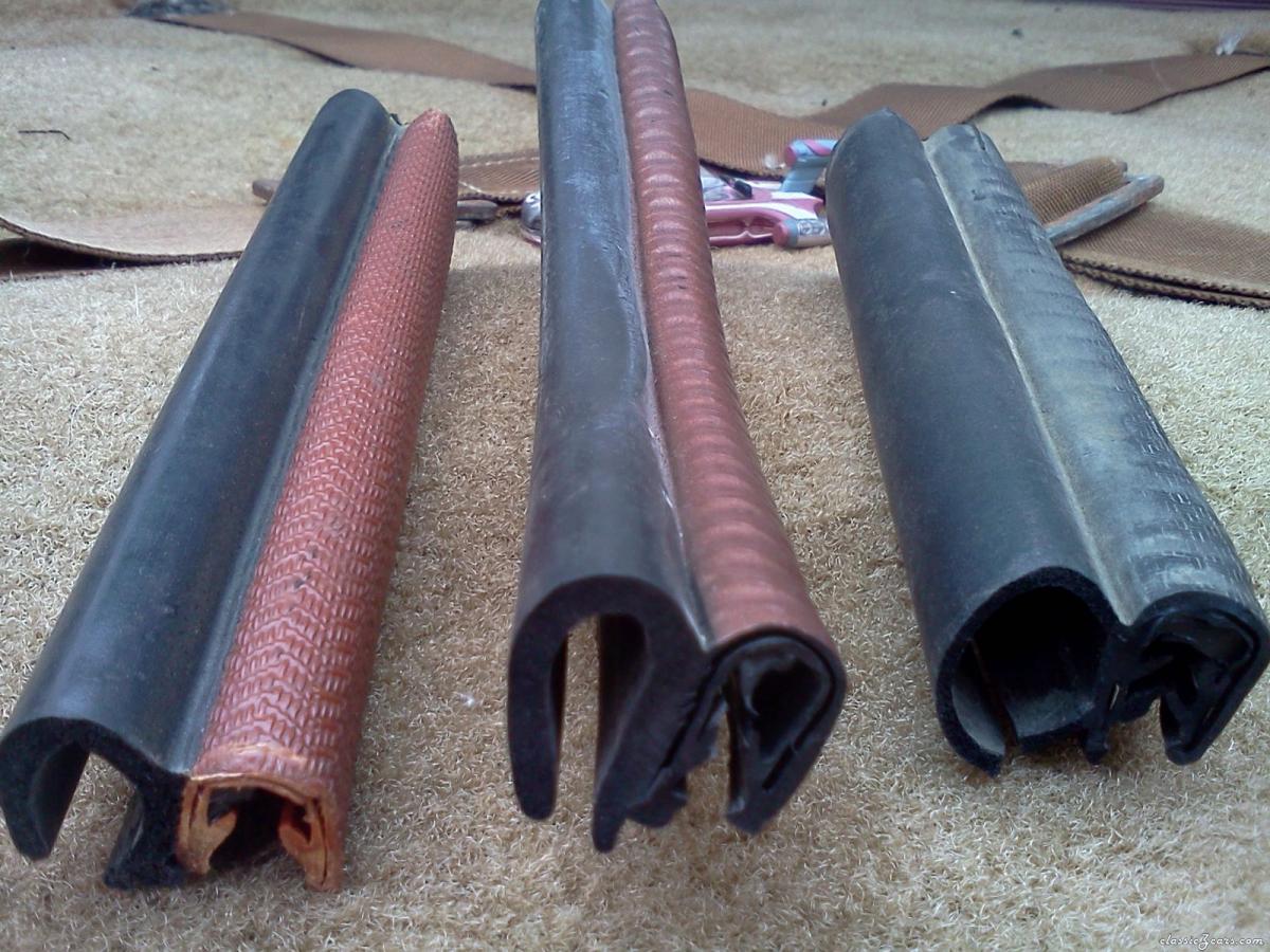

AndBir Posted January 24, 2018 Posted January 24, 2018 Please let us know how they go when you arrive and fit them? Some Korean car dealer is going to be wondering why suddenly there is a rush on for Sportage weather strips. Shall do, tried to get used ones from various wreckers however they were either no longer on the car shells or were torn. I found this photo of how the Kia weatherstrip(right) looks compared with factory(left) and aftermarket(centre). GongZ 1 Quote

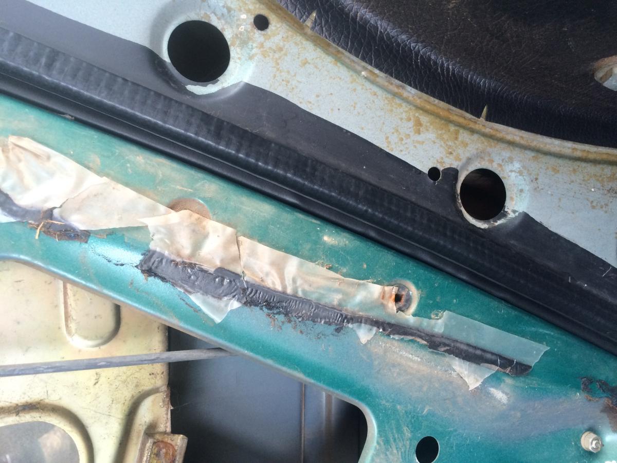

AndBir Posted February 21, 2018 Posted February 21, 2018 (edited) OK, Kia Sportage door seals arrived and looked good as the seal felt softer than the one I had looked at from Clark Rubber. They each come as a joined loop and the join makes a good point to have the 90 degree bend. The photo below shows the Kia on the right (metal showing) and a sample Clark Rubber one on the left (of the upside down photo!). The Kia's seal is of similar size but the rubber is thinner and less dense. It seems to be a good fit all round however still requires a bit more of an effort to close the door than previously but this is probably because the old original seals were stuffed! Edited February 21, 2018 by AndBir gav240z 1 Quote
