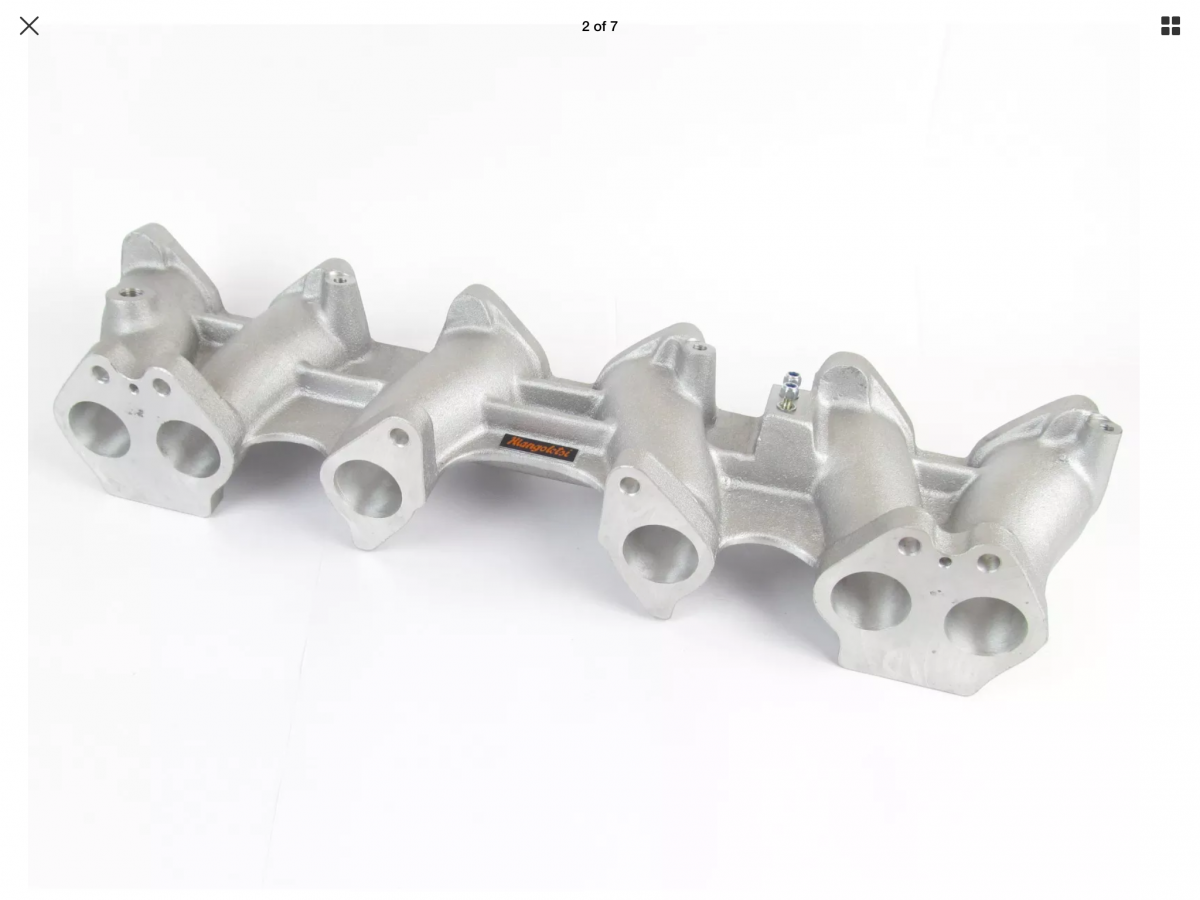

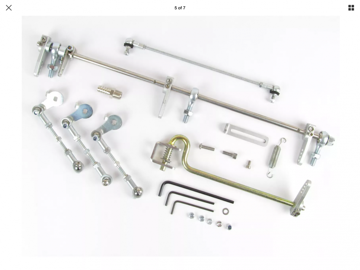

600Z Posted January 15, 2017 Posted January 15, 2017 I have one of the Harada manifolds that I will be fitting to one of our cars with a set of 45 Dellorto's. The manifold by the look of it is very well made, linkages could be better I feel but hopefully they will do the job. I'm also thinking about getting one of the Mangoletsi manifolds for another car, no real reason but they too look pretty good from the pictures and the linkages might be better, anyone have any thoughts? I have attached a couple of pictures of the Mangoletsi manifold. Quote

dat2kman Posted January 15, 2017 Posted January 15, 2017 That manifold fouls on the base section of thermostat housing, nothing a decent bit of file work wont fix. The anodised linkakes on the round section long rod, will slip and cause carbs to go out of balance. Look elsewhere for the hexagonal section rod and matching arms, for a positive non slipping linkage. Have fitted these, and had minor issues. Quote
C.A.R. Posted January 15, 2017 Posted January 15, 2017 That manifold fouls on the base section of thermostat housing, nothing a decent bit of file work wont fix. The anodised linkakes on the round section long rod, will slip and cause carbs to go out of balance. Look elsewhere for the hexagonal section rod and matching arms, for a positive non slipping linkage. Have fitted these, and had minor issues. Which manifold one are you referring to Jason? Quote
dat2kman Posted January 15, 2017 Posted January 15, 2017 (edited) Which manifold one are you referring to Jason?The Harada manifold. As above, i fitted it to Casey's car last year, the round shaft with bolt clamped linkage arms, supplied with it, would not hold.On the pic link in Gavs post, on the far right, the additional rectangular alloy bar, that raises the linkage rod, to get it better aligned, that end bit of alloy section, fouls the thermostat housing. Edited January 15, 2017 by dat2kman Quote
C.A.R. Posted January 16, 2017 Posted January 16, 2017 The Harada manifold. As above, i fitted it to Casey's car last year, the round shaft with bolt clamped linkage arms, supplied with it, would not hold. On the pic link in Gavs post, on the far right, the additional rectangular alloy bar, that raises the linkage rod, to get it better aligned, that end bit of alloy section, fouls the thermostat housing. Ahhh you used the 'small port' manifold - I remember having relieve that post to clear the thermostat on a customers Z. The Harada 'Big Port' doesn't have that problem. The top linkage arms are fine in use on the carb drop links, but you have to replace the one of the firewall with an EFi Hardware item, because - as you say - the supplied one doesn't have enough purchase on the rod, causing it to slip. Quote

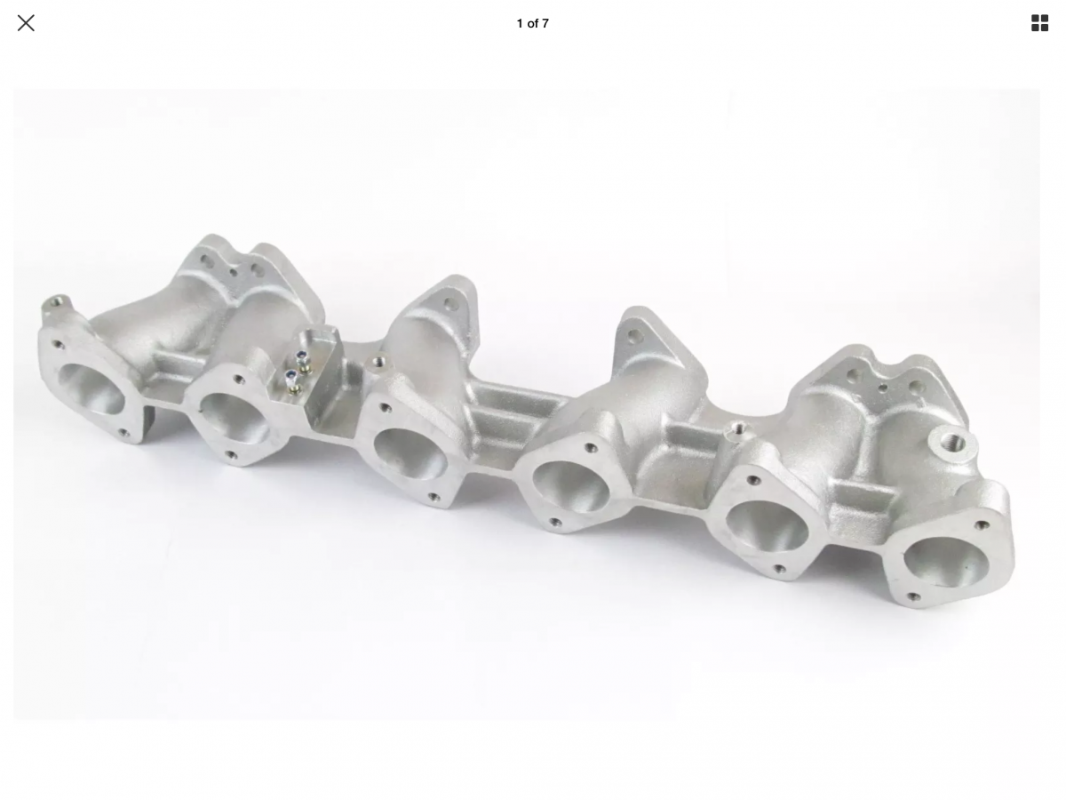

240ZR Posted November 27, 2017 Posted November 27, 2017 I have one for $275... https://www.ebay.com.au/itm/Datsun-240Z-260Z-260C-Skyline-R30-L24-L26-L28-triple-Weber-Dellorto-manifold/142571031200?hash=item2131e54aa0:g:4ZUAAOSwPO5ZzxBp Quote
