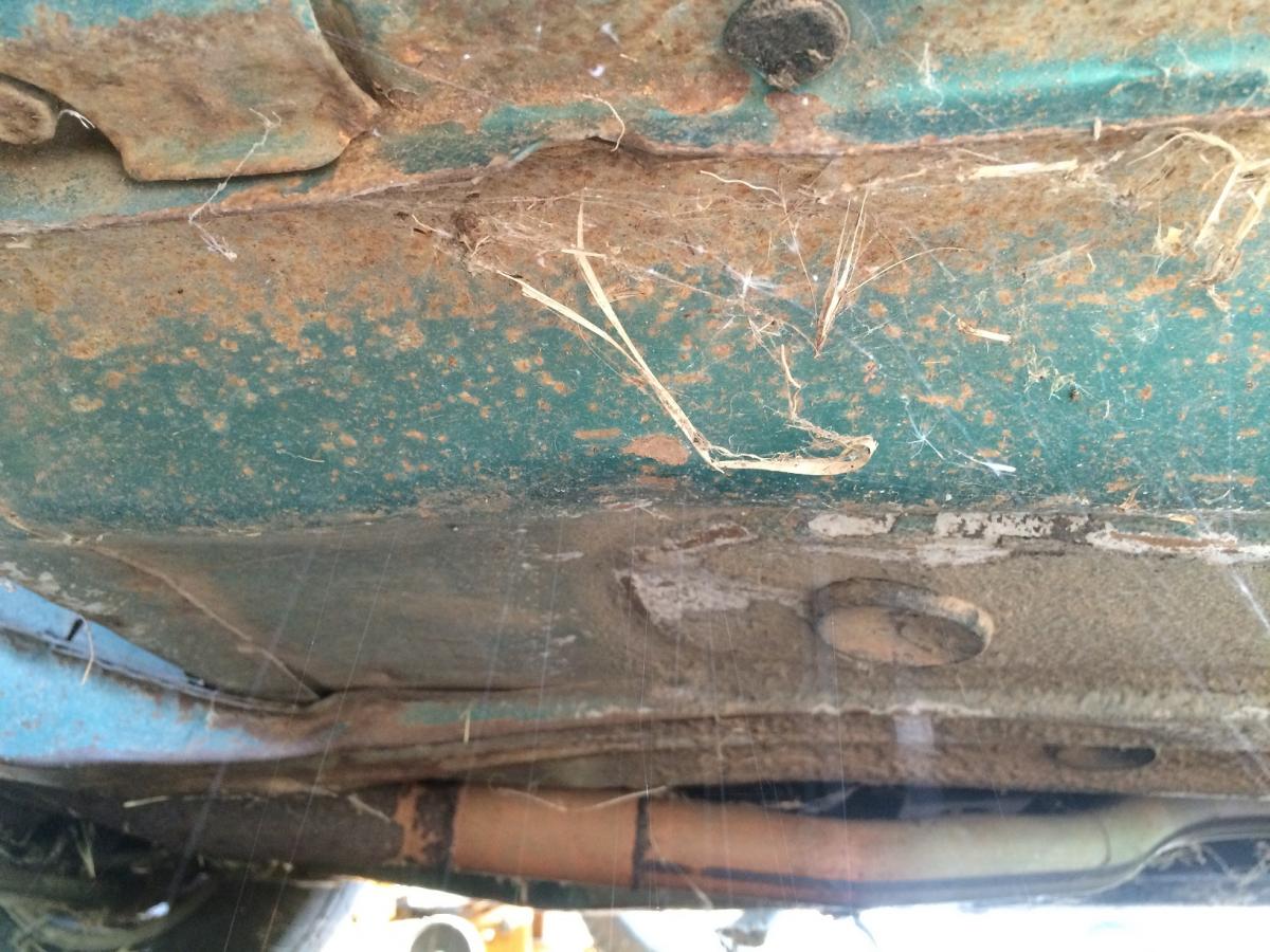

I want to get some of the inner lining off to spray on something like the Eastwood Internal Frame Coating spray into/onto the rust prone areas that cannot be reached easily - is this an appropriate product?
With the spray nozzle it may be useful to access the rocker panel / sill areas (via this black plug [top of picture] and cutouts internally)?

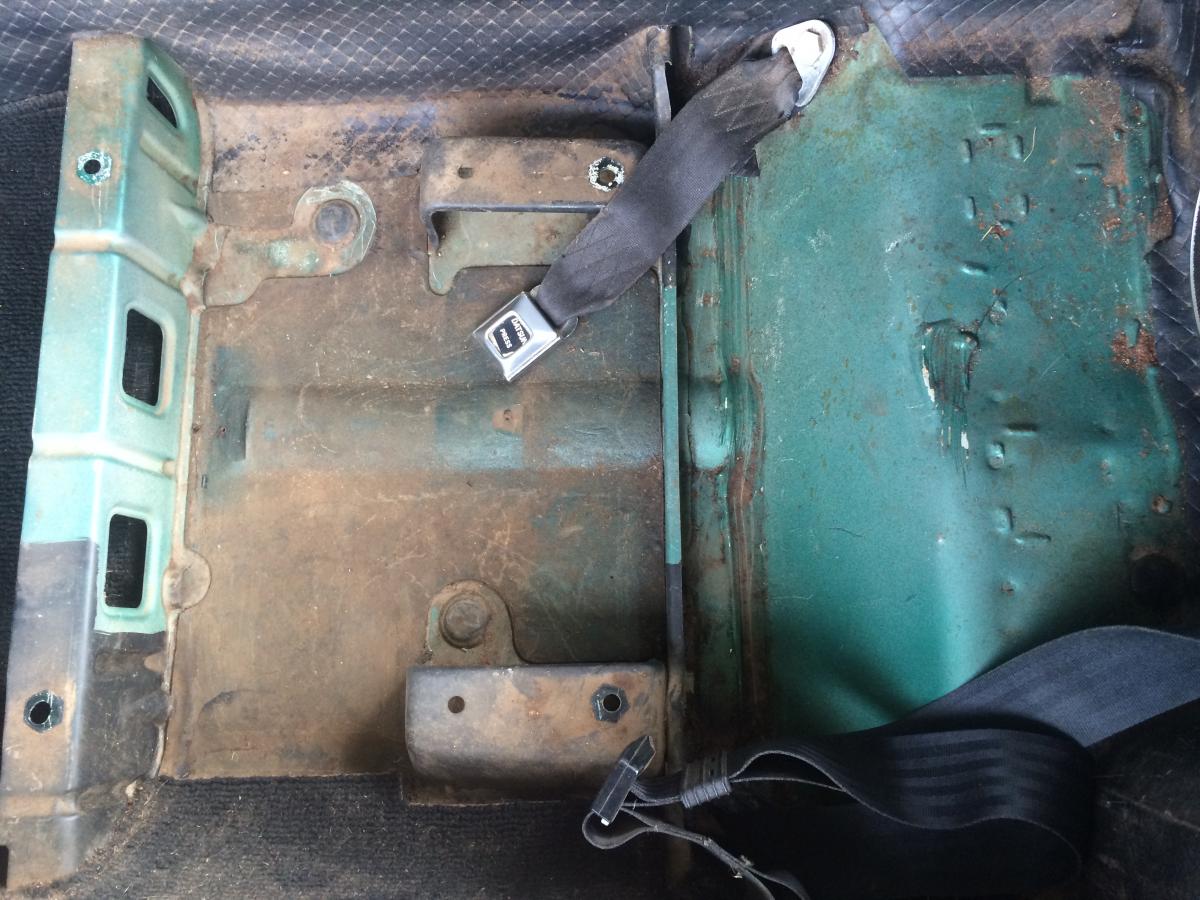

First was removing the driver's seat and then carpet and jute :
post-105219-0-10158400-1477474170_thumb.jpg Found some rust spots under the kick plate but behind and under the seat areas was OK.

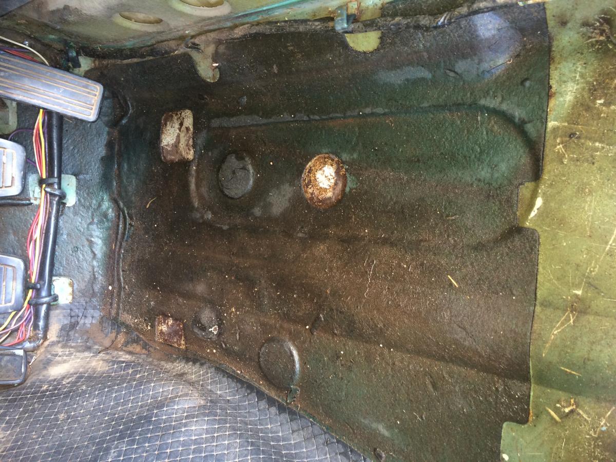

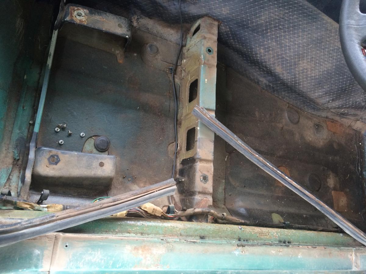

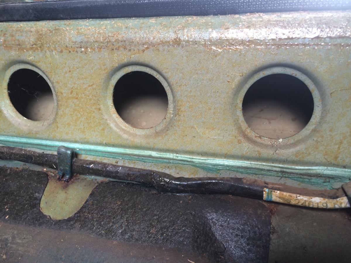

post-105219-0-35178700-1477474196_thumb.jpg Areas on the floor not covered by the tar sound deadener have minor surface rust.

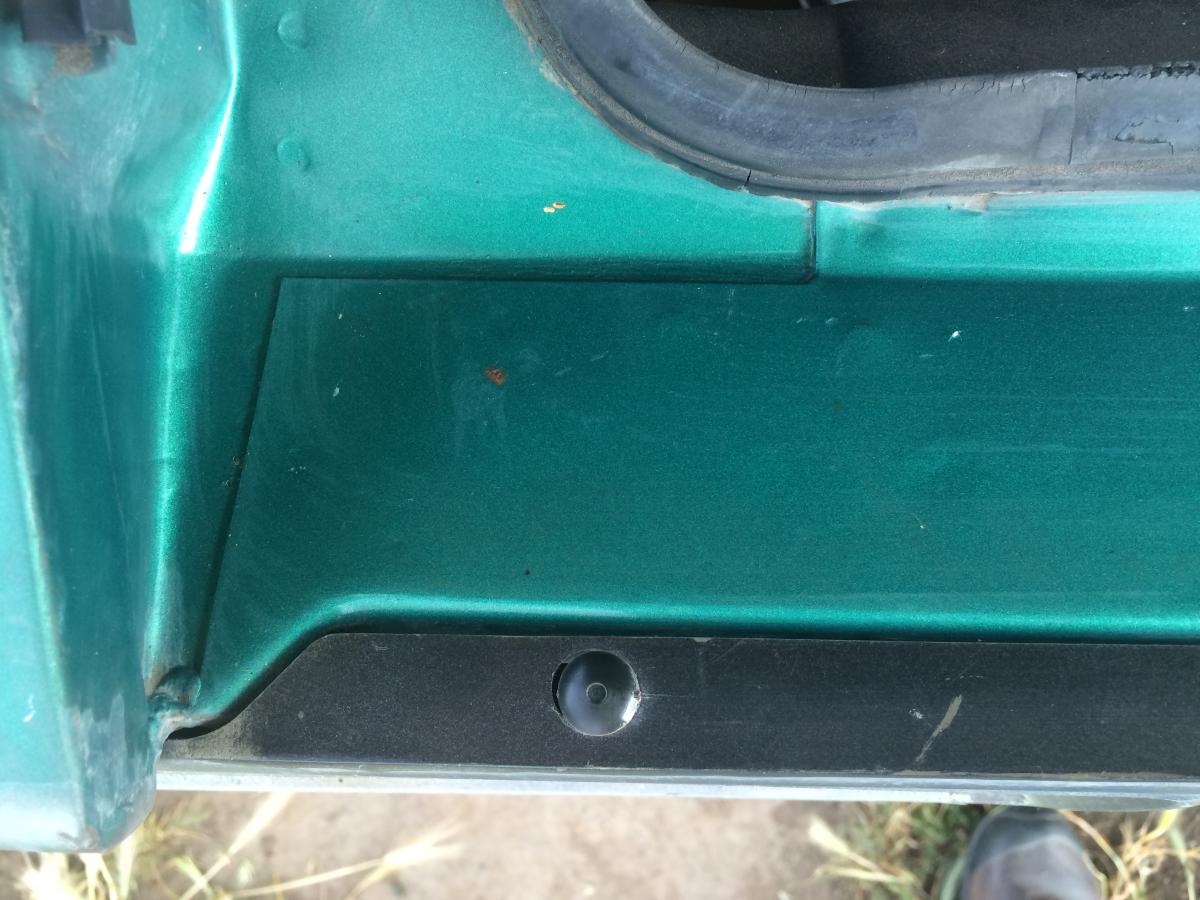

post-105219-0-98824400-1477474445_thumb.jpg After slowly peeling off the side carpet trim which was attached by some sort of light glue, it appears all is OK in the door sill area.
post-105219-0-99812500-1477474621_thumb.jpg Looking into the upper dog leg area all appears good.

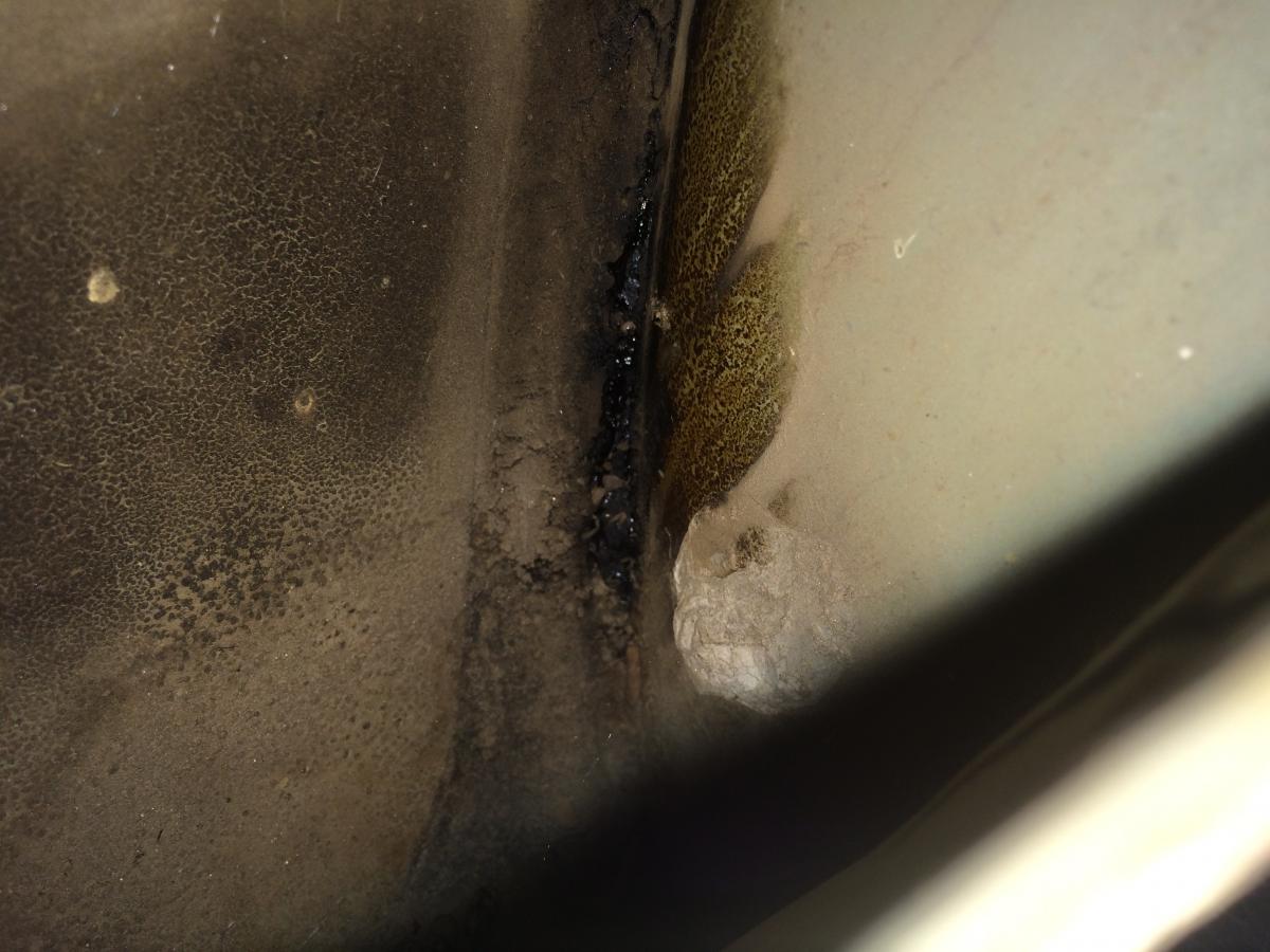

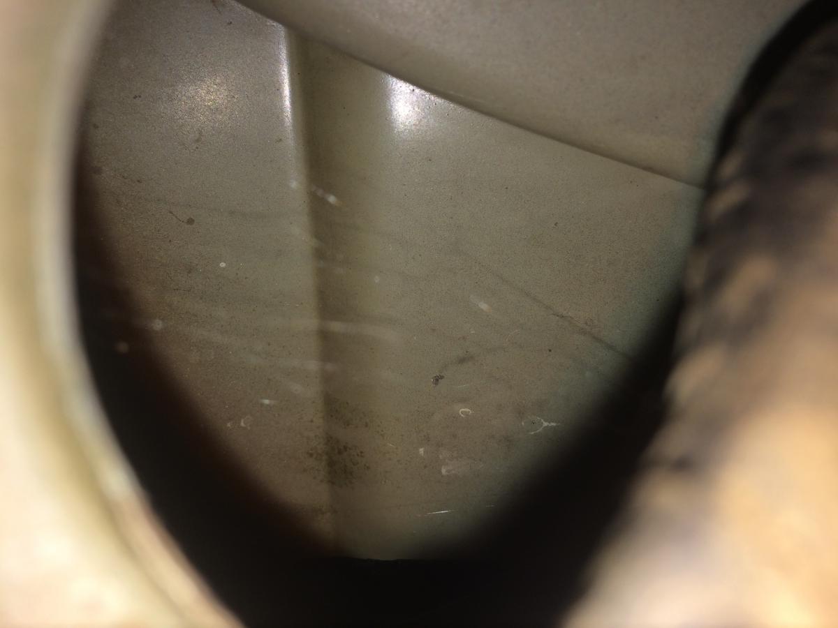

post-105219-0-05946900-1477474700_thumb.jpg Poking the iPhone camera in as far as it can go to look lower down I am not really sure what I see - some "black" seam sealer and some sprayed on ?something?

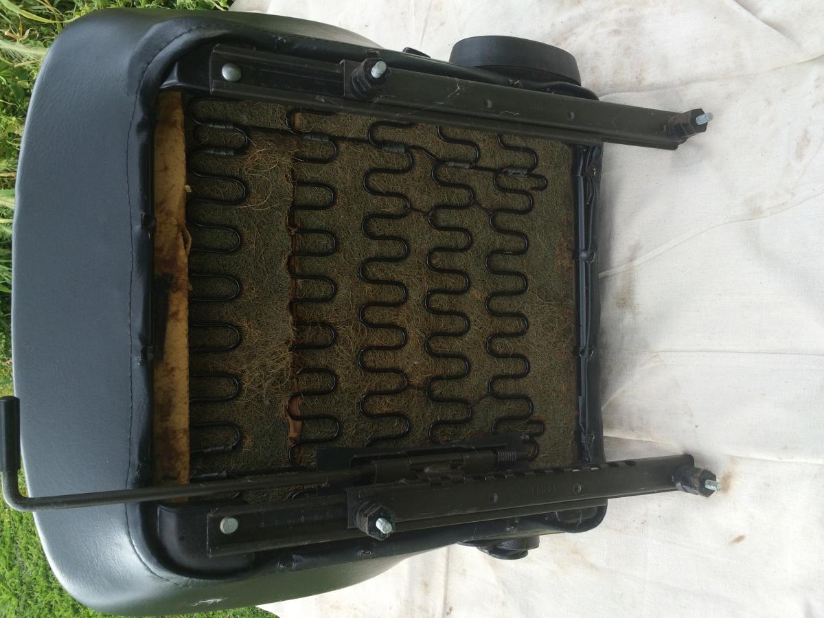

post-105219-0-50220000-1477474929_thumb.jpg Interestingly the underside of the driver's and passenger seats appear to be OK

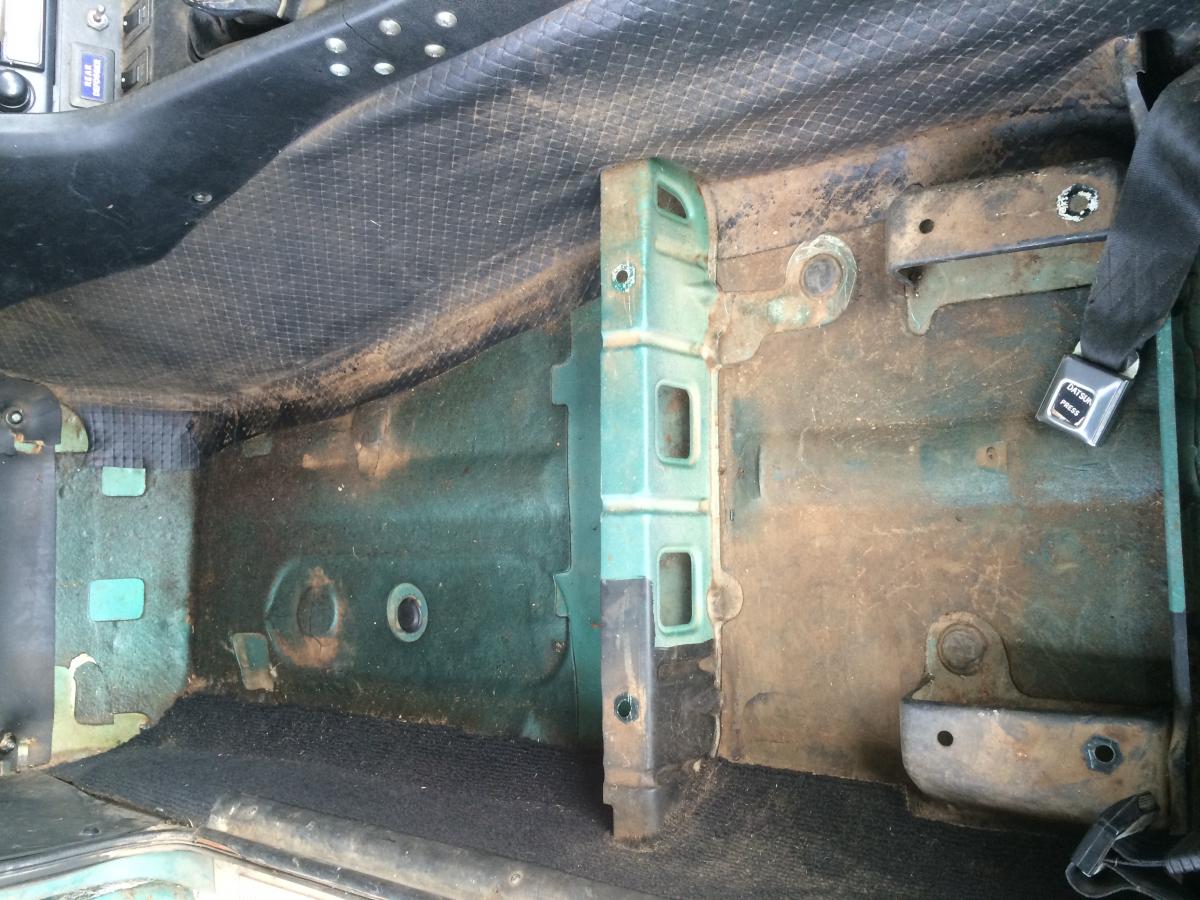

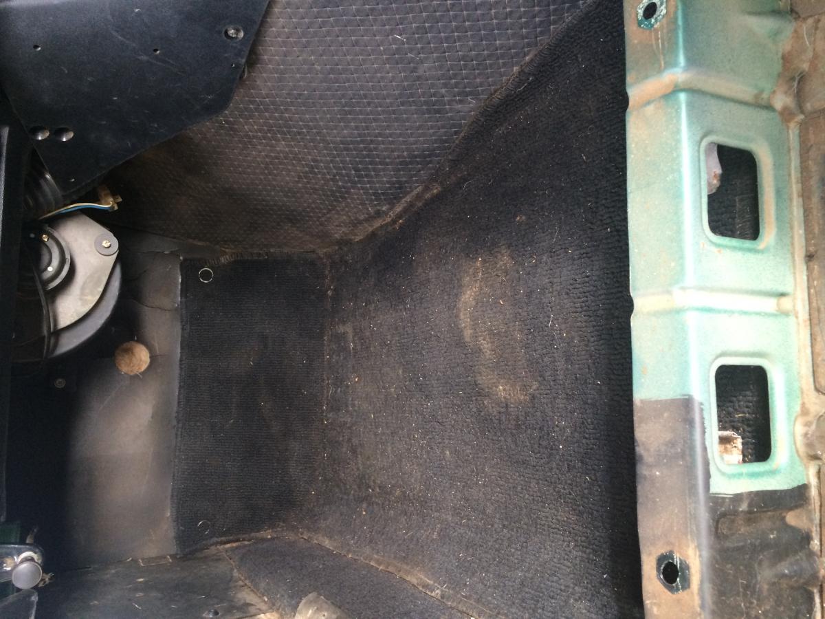

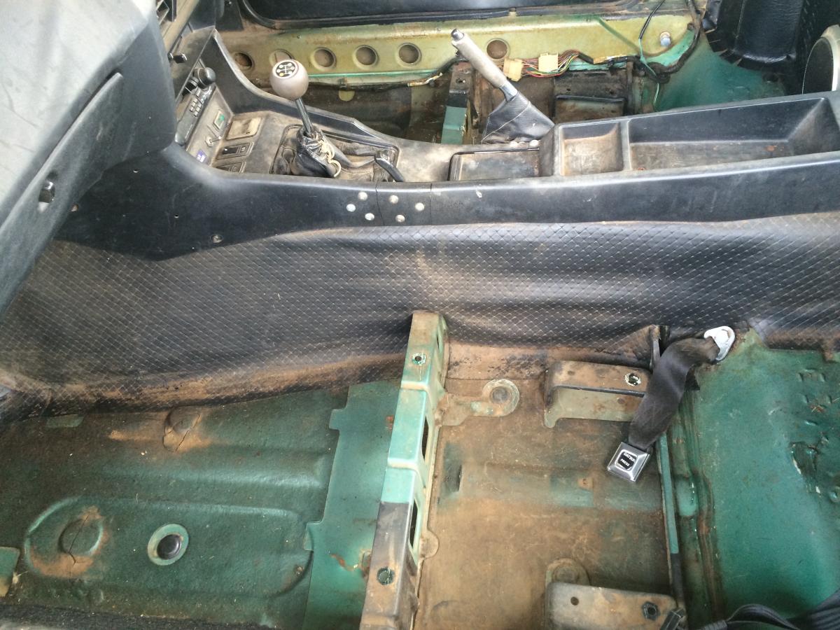

Second came the passenger side seat and floor coverings.
post-105219-0-52343500-1477475027_thumb.jpg Again behind and under the seat area was great

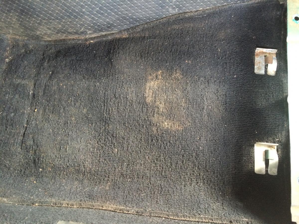

post-105219-0-16777100-1477475046_thumb.jpg In front of the seat the original carpet was in OK condition on the surface and even still had the clips to keep it in place.
post-105219-0-83957700-1477475062_thumb.jpg Side and end panel trim in OK condition as is the diamond pattern tunnel covering.
post-105219-0-49566900-1477475317_thumb.jpg Under the coverings no sign of rust however the picture hides the fact the middle of the passenger floor has been pushed up by ~2-3cms

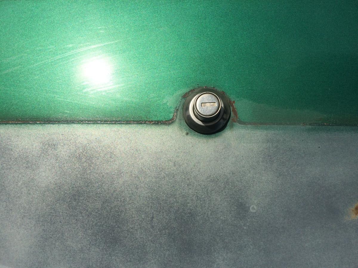

post-105219-0-28323100-1477475615_thumb.jpg Took the rear bumper bar off and you can clearly see what 42 years of sun did to the paint.

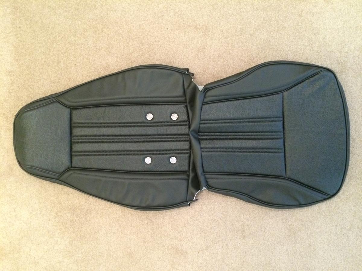

Purchased some new 260z style seat covers from the ZFactory and will attempt to fit these:

For those that do not suffer from arachnophobia - the inside of the dogleg on the passenger side was interesting :
I see you still have the spacers under the seat which is pretty rare. They seem to get thrown away in most cars. Car looks very clean.

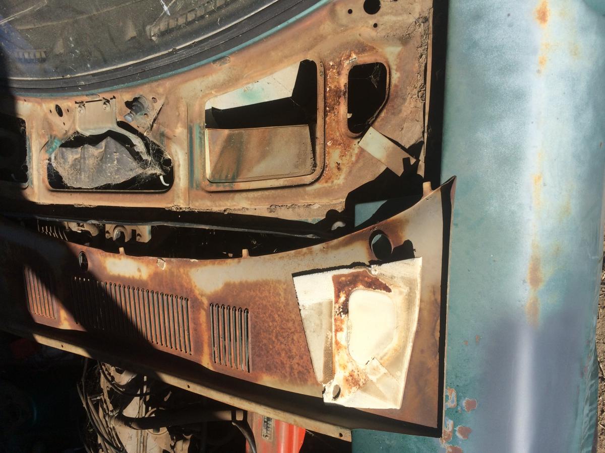

post-105219-0-02216000-1477645681_thumb.jpg : Moved onto the the front cowl and uncovered a lot of surface rust.

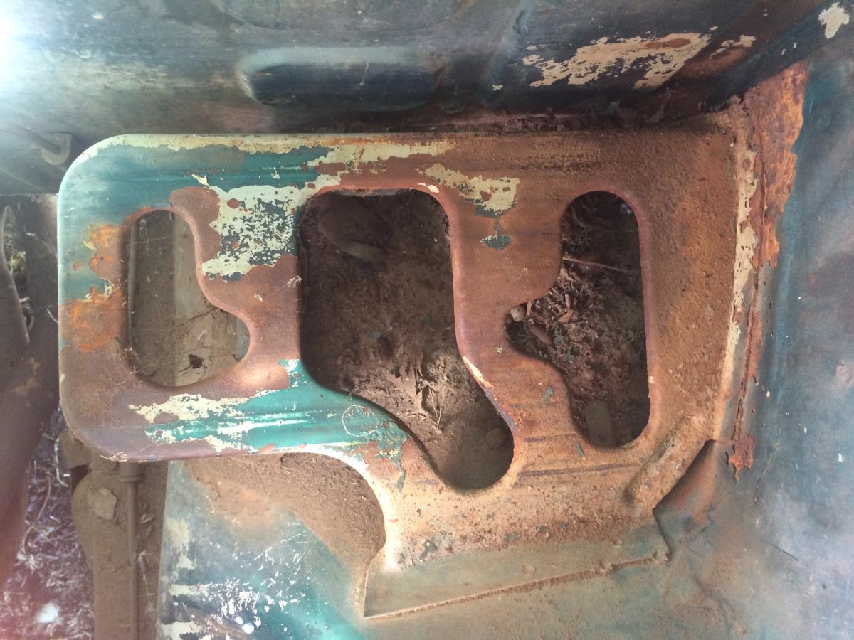

post-105219-0-16680800-1477645946_thumb.jpg : Then looked at the battery area/support - lots of dirt and again rust underneath but it appears to not be too bad.

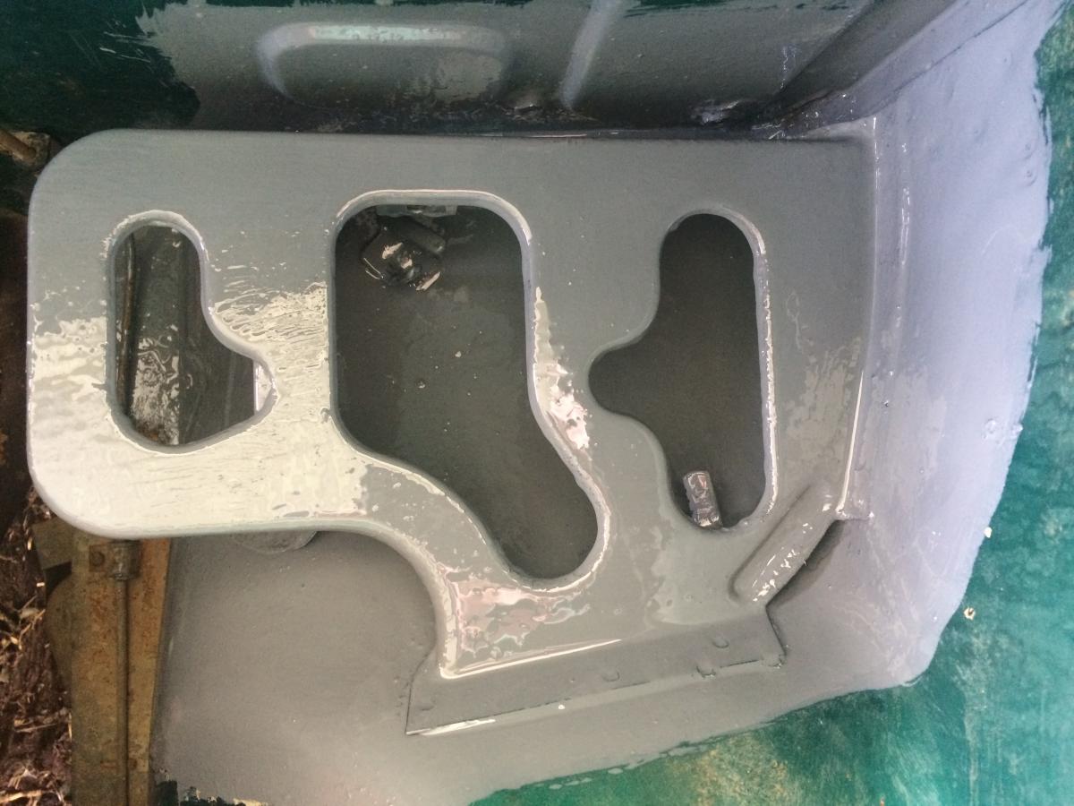

post-105219-0-94066300-1477645996_thumb.jpg : Got stuck into it with a wire wheel on a drill and a screw driver to chisel the had to reach areas. Did the Marine Clean - Metal Ready - POR-15 treatment.

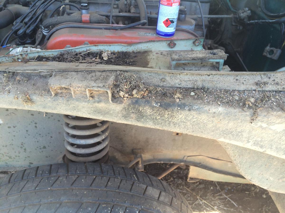

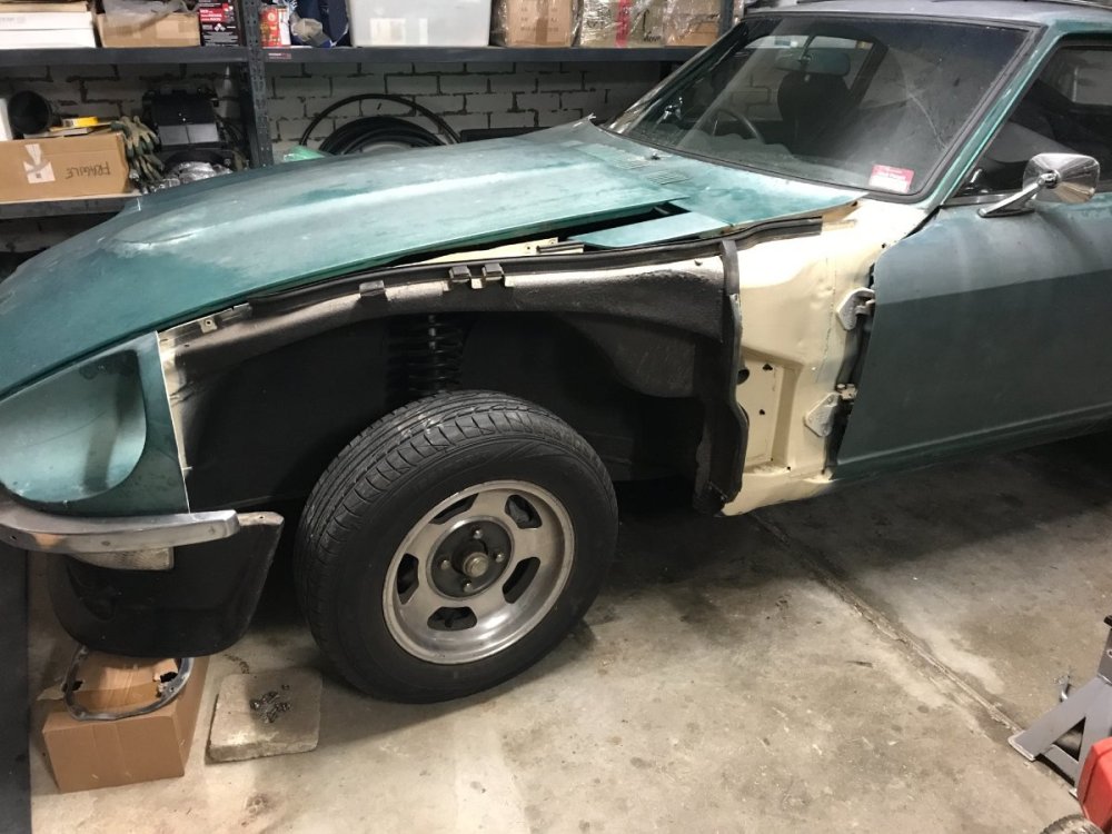

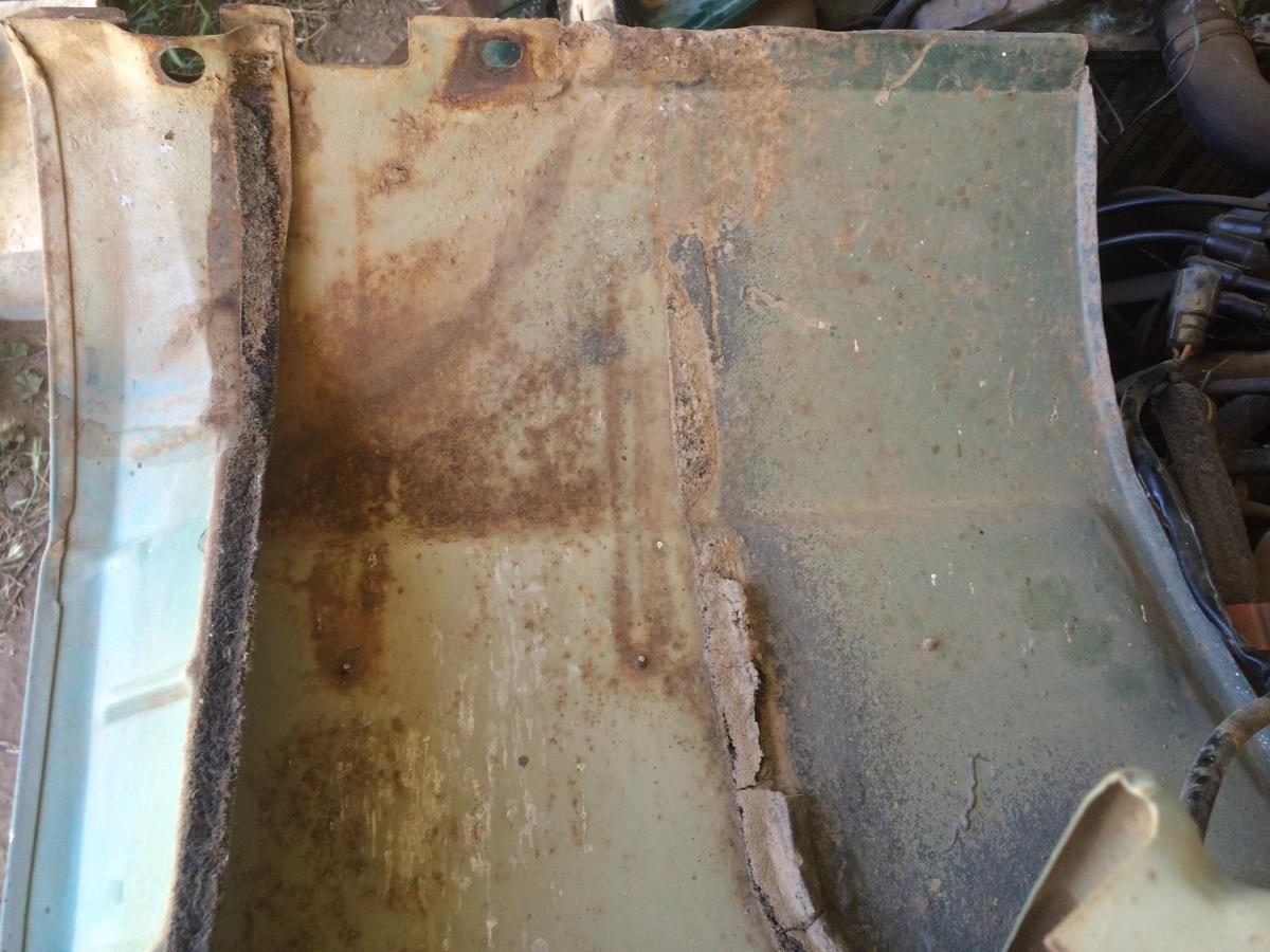

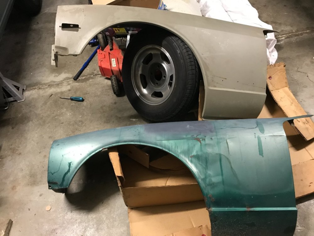

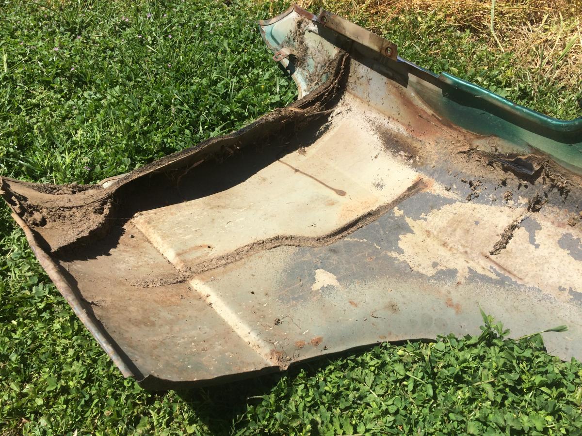

Continued on with looking for rust, took off the front fenders:

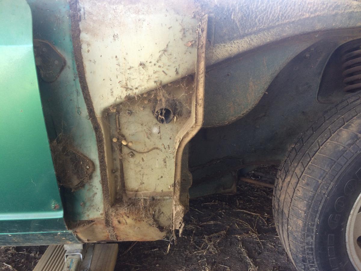

post-105219-0-91740500-1478065544_thumb.jpg : Uncovered more spider habitats.

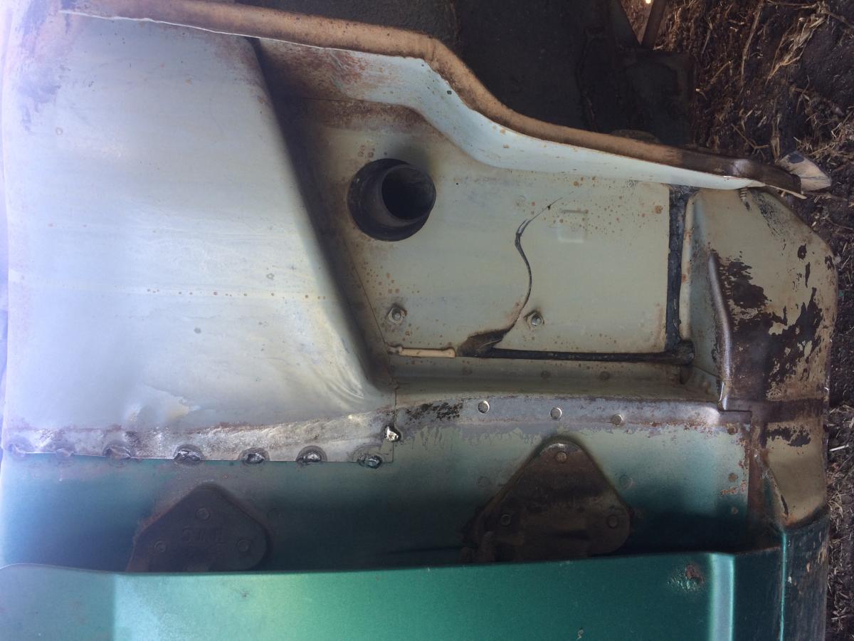

post-105219-0-68083000-1478065679_thumb.jpg : Some dirt and,

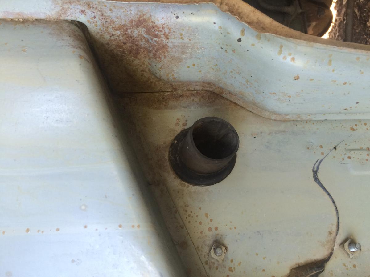

post-105219-0-38144000-1478065695_thumb.jpg : Some surface rust

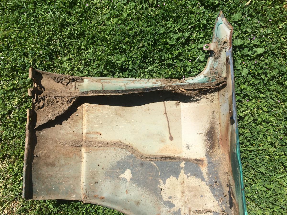

post-105219-0-07090300-1478065816_thumb.jpg : A lot of dirt in the bottom of the panel
post-105219-0-87084500-1478065836_thumb.jpg : More dirt build up at the bottom of the panel
post-105219-0-55407300-1478065943_thumb.jpg : luckily not too much rust under all of the dirt

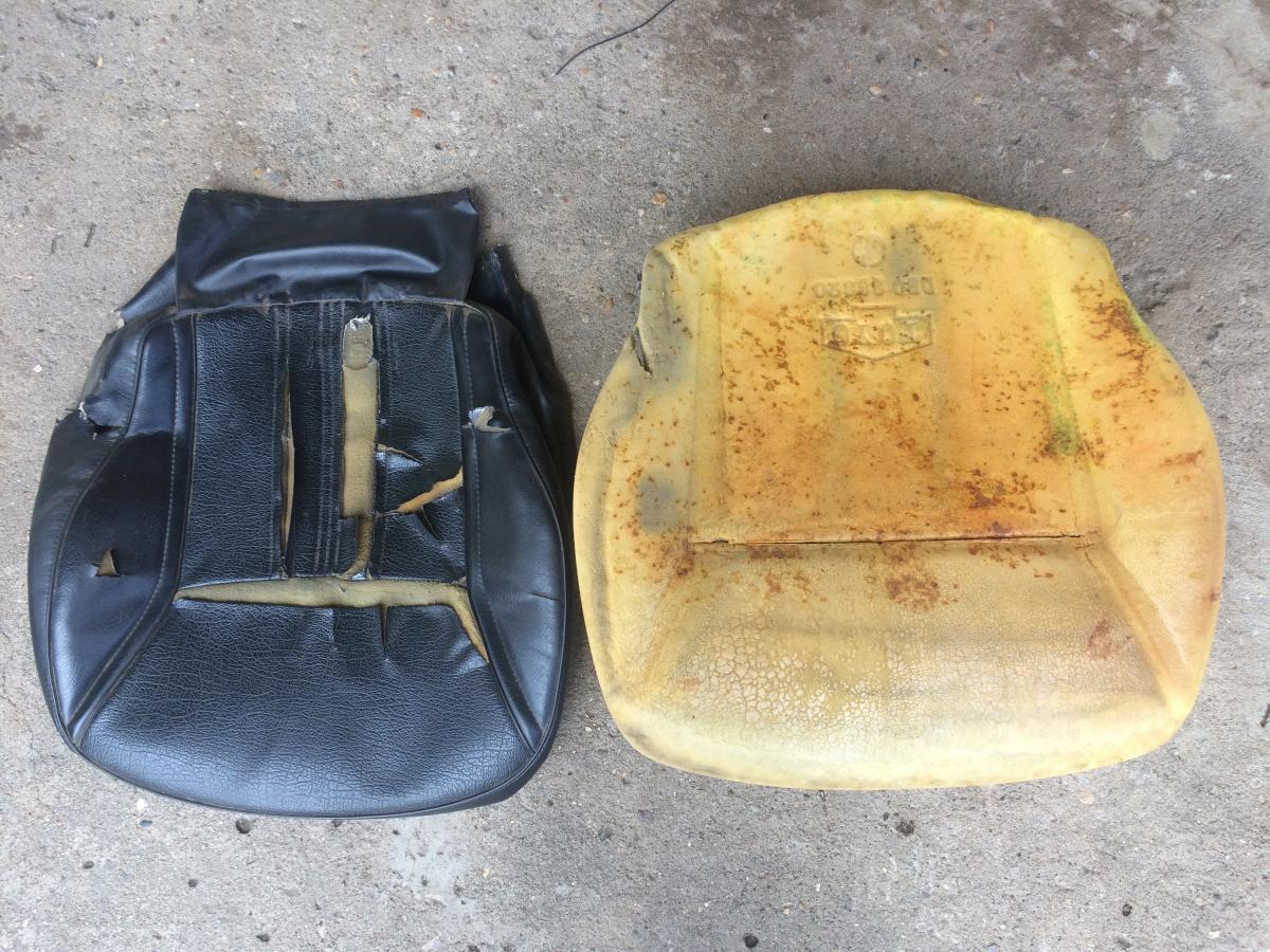

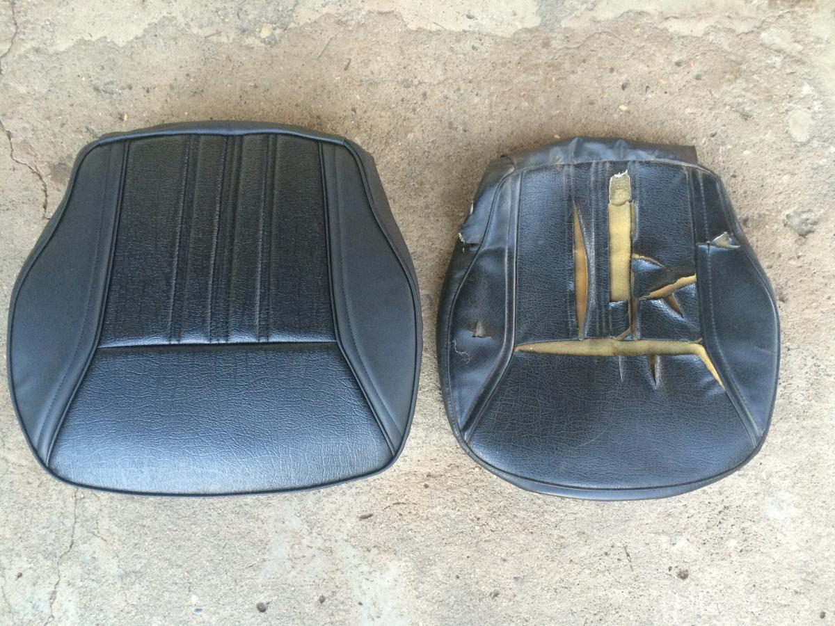

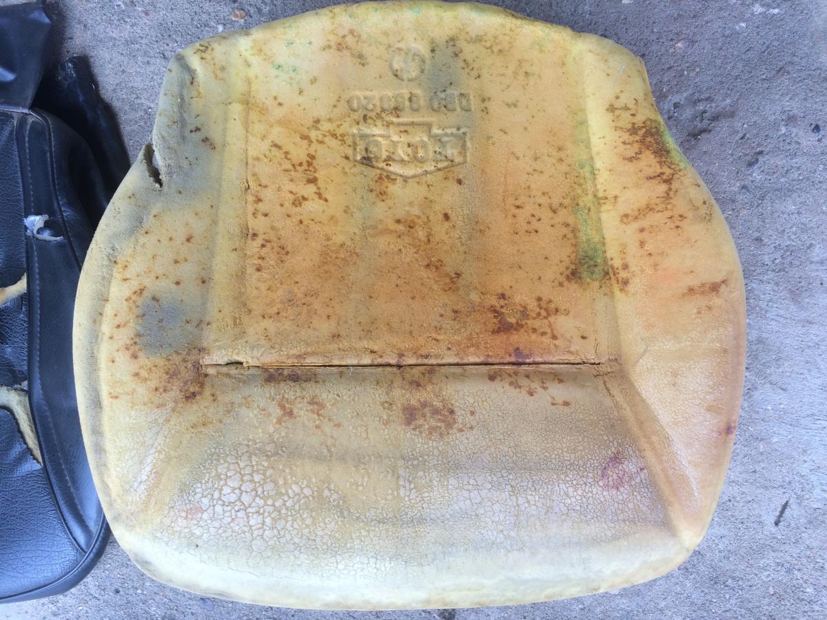

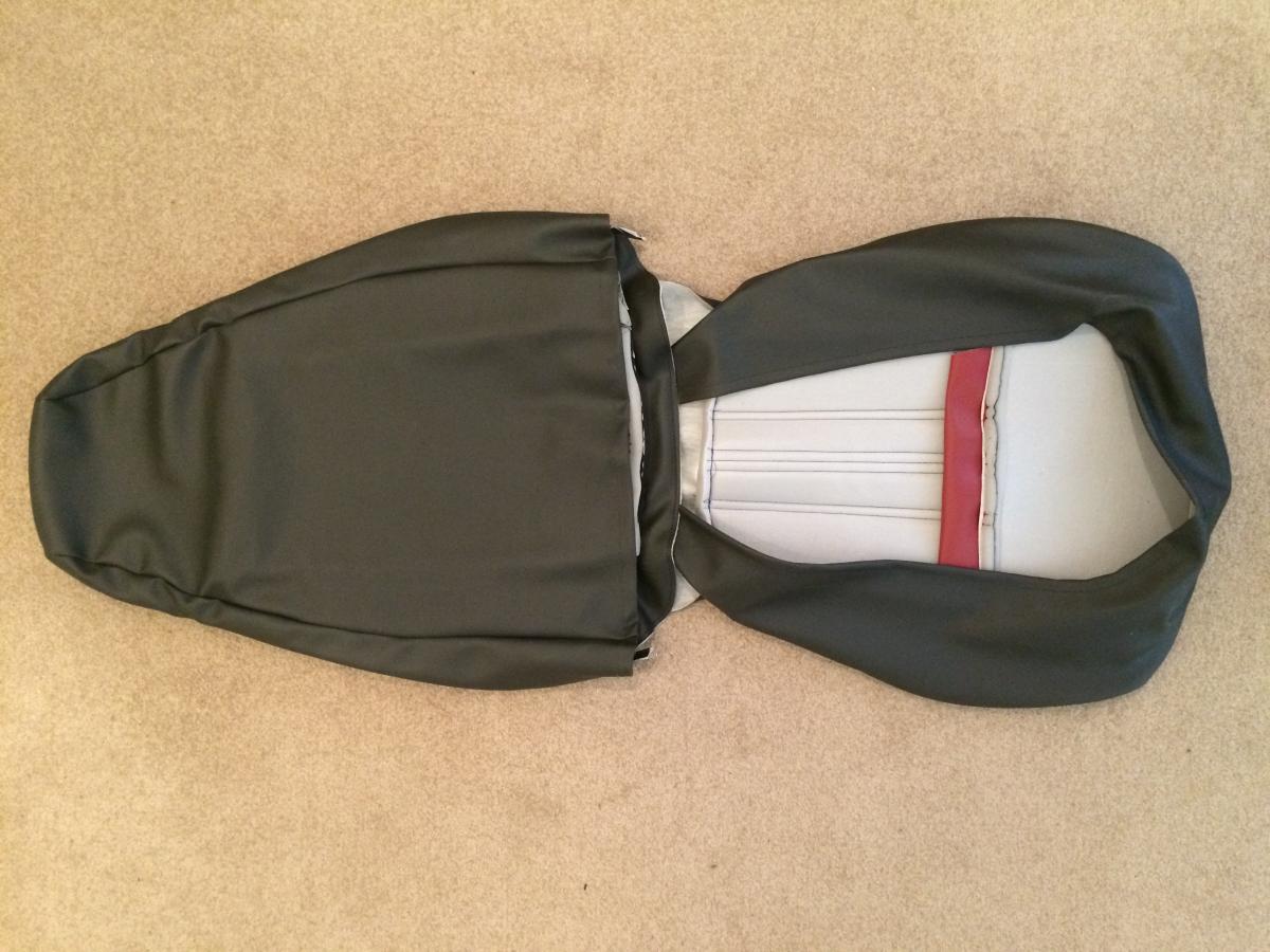

Wanted to see some improvements so decided to replace the cover on the driver's seat.
post-105219-0-65989600-1478066396_thumb.jpg : Seat foam looked OK other than a small tear on the edge
post-105219-0-10518900-1478066409_thumb.jpg : Off with the old and on with the new.
The process of removing the old cover and installing the new on the seat is relatively painless, looking at the seat back I am sure it will be much more difficult!

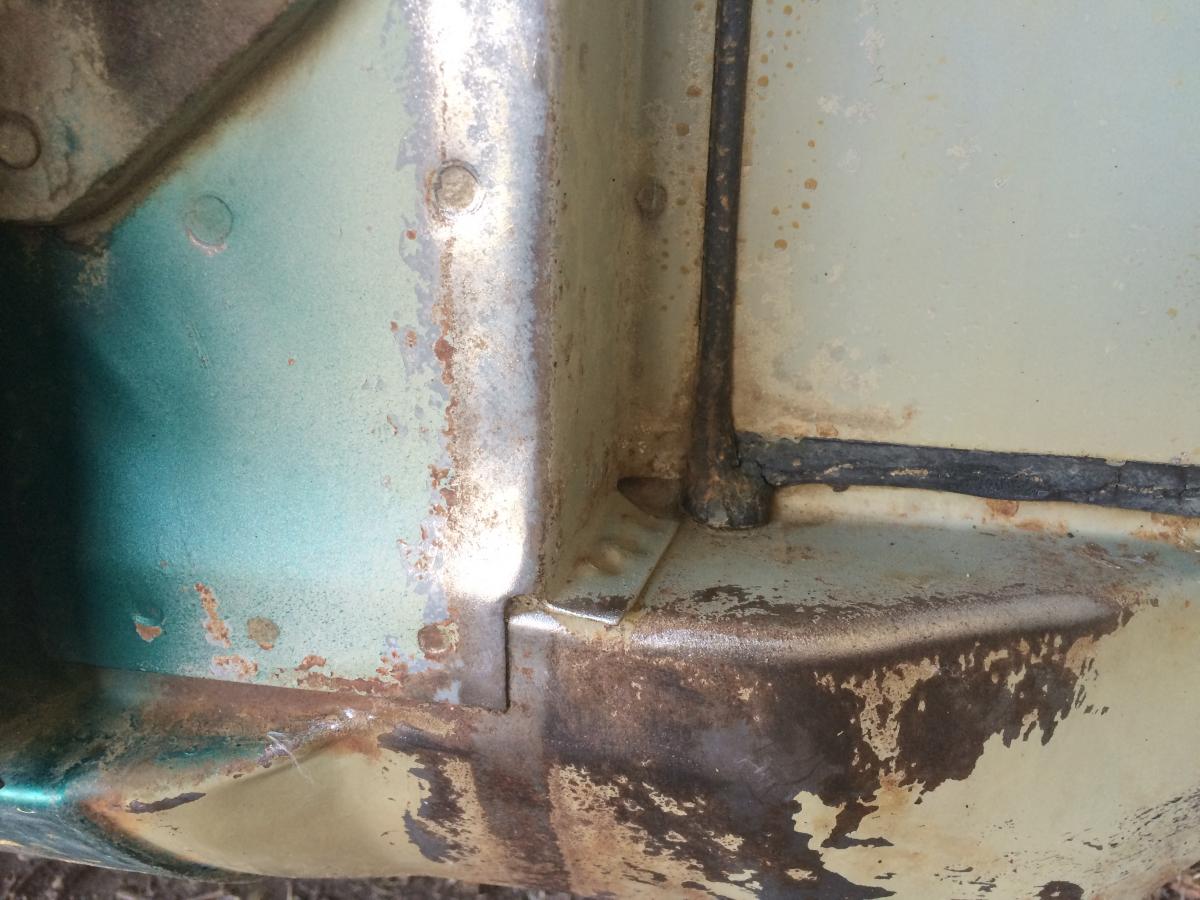

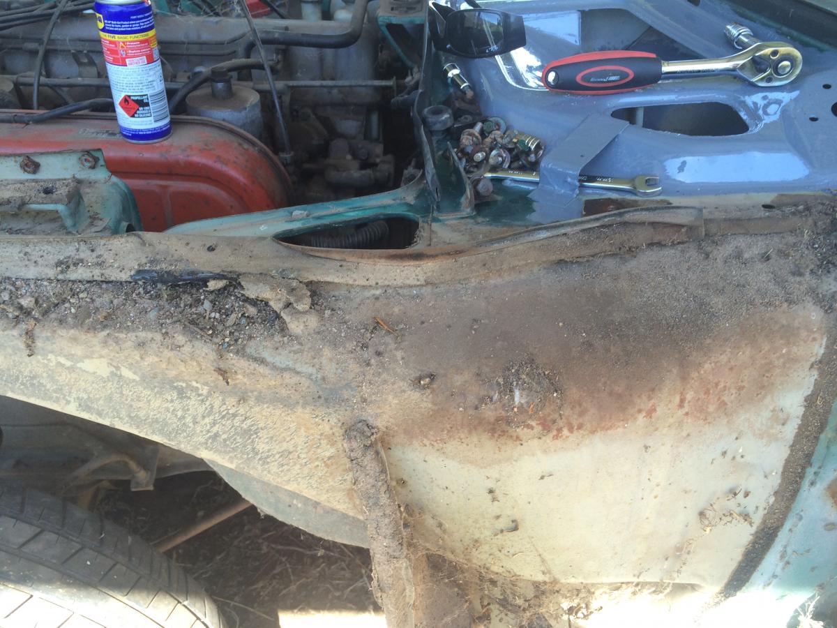

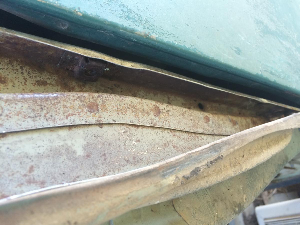

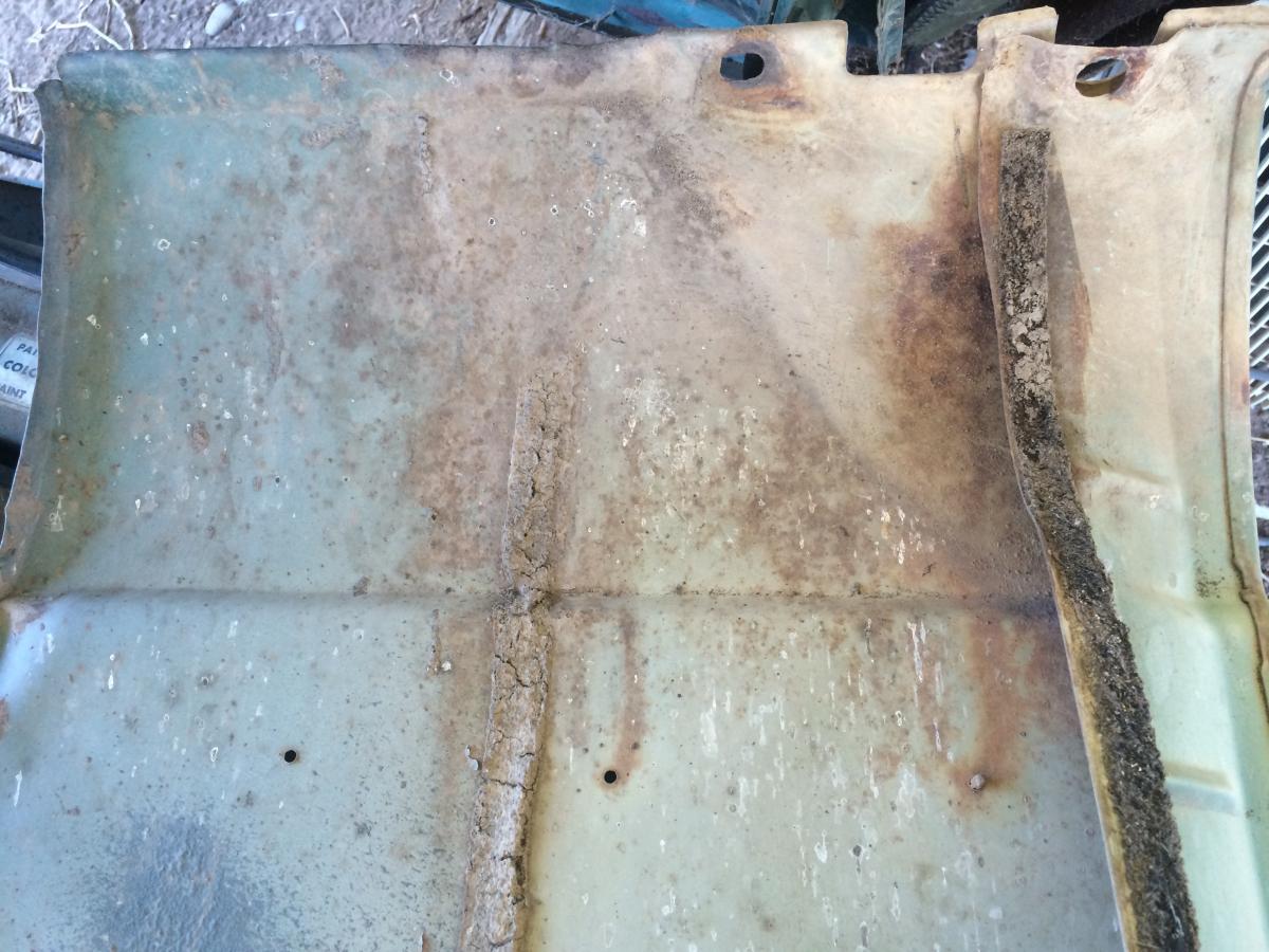

Cleaned up the areas under the front fenders/mudguards :
post-105219-0-86044900-1478066747_thumb.jpg : removed the remains of the ?foam? rubber along the seam

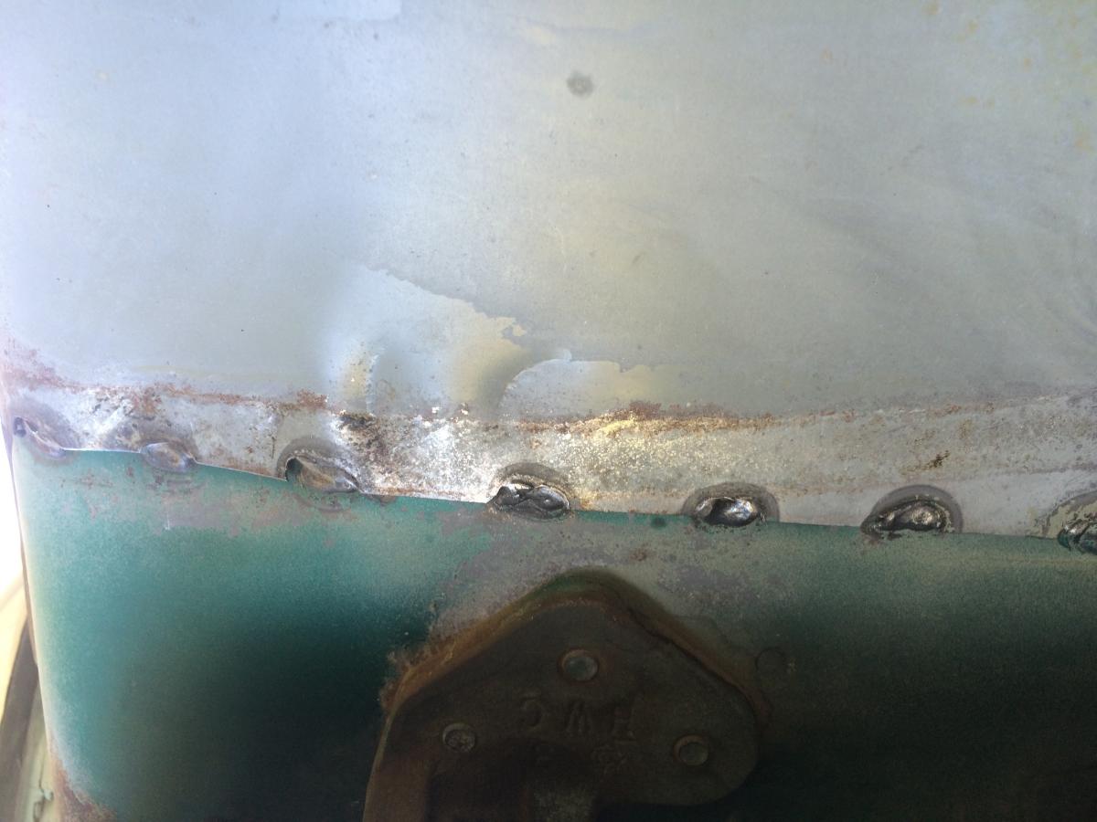

post-105219-0-90188500-1478066757_thumb.jpg : Minor surface rust, not sure why they did not fill the corner openings hera with seam sealer?
post-105219-0-76306900-1478066767_thumb.jpg : More surface rust

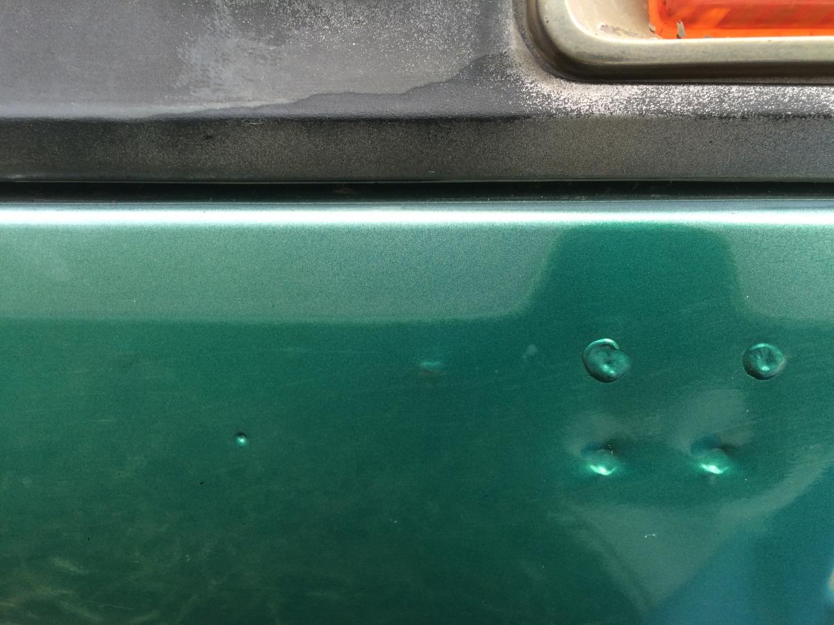

post-105219-0-45364300-1478066783_thumb.jpg : appears they had to use a hammer a couple of time to get the internal frame parts to match up prior to welding!
Those hammer marks are pretty standard, they all have them to some extent.
Your a lucky guy, from a rust perspective this would have to be one of the best chassis Ive seen for a while
O my that shell is in amazing condition. I'm with Dave you are very lucky. It's very very clean.
And yes the hammer marks are on all/most cars.
Jeff
Yep winner winner chicken dinner. All the usual spots just have some light surface rust. You can see why they rusted but in this case the car has remained dry!
You've done very well so far.
