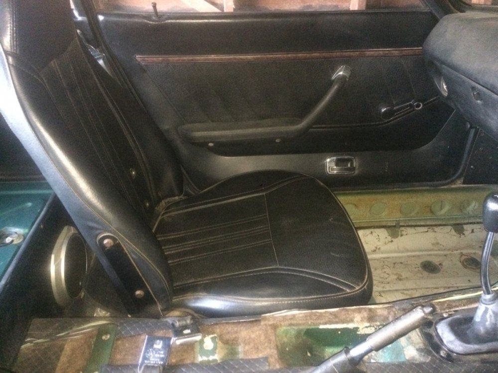

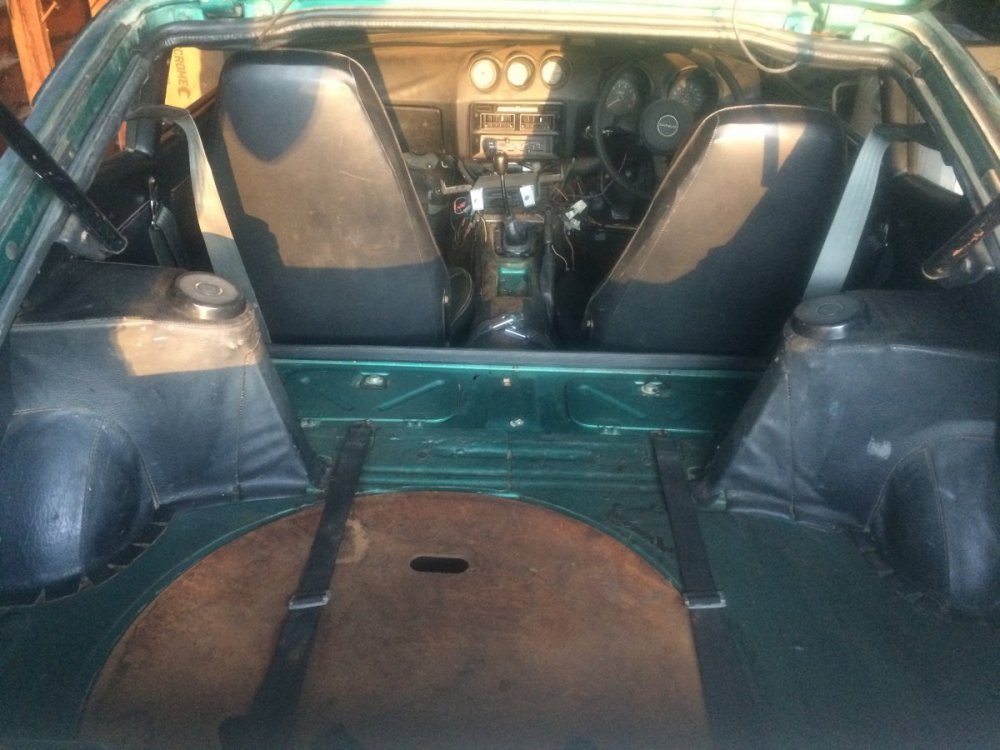

AndBir Posted May 19, 2019 Author Posted May 19, 2019 Also put back the door cards, rear lining, seats, seat belts etc. etc. Still need new front and rear carpets and to put back new center console plus heaps more "little" things. Quote

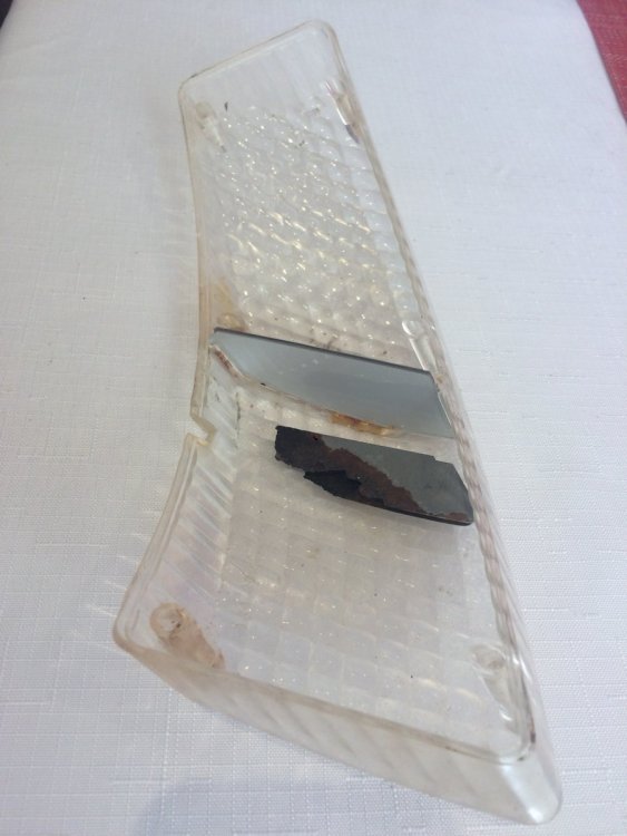

AndBir Posted May 26, 2019 Author Posted May 26, 2019 Made up a replacement part for the rusted out section that separates the indicator and parking light areas of/on the lens cover Quote

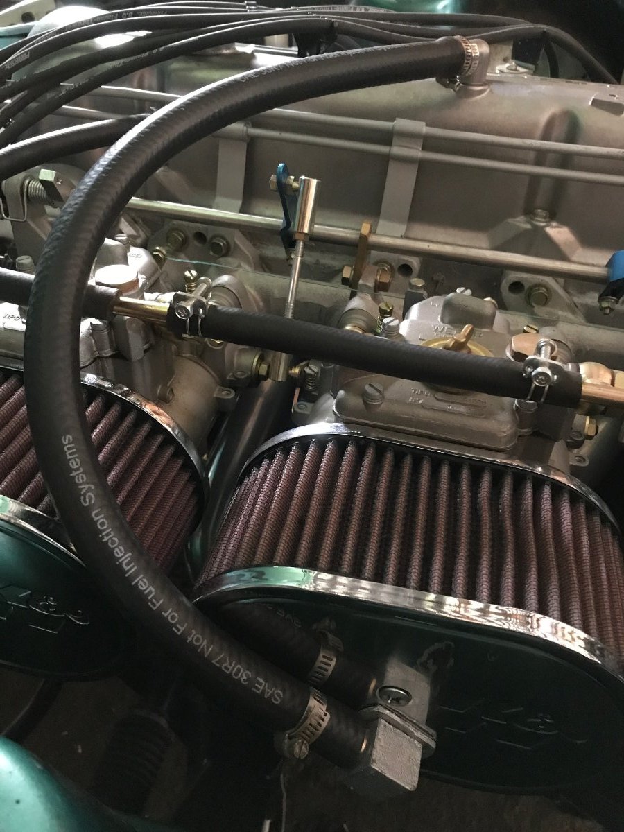

AndBir Posted September 21, 2019 Author Posted September 21, 2019 (edited) Back on the job again determined to get it running. Connected all the radiator / heater hoses and filled with coolant. Removed spark plugs / power from coil and turned the engine over to confirm there was oil pressure - all good. Connected up the fuel lines (to filter,pump and carbs) and spent quite some time getting fuel from the tank through to the carbs. Decided to use the old fuel rail with a closed loop fuel supply to the Webers. This also allows the fuel return line to remain active. Replaced spark plug and power to the coil. Test started engine and it fired up but only remained running while the key was in "Start" position but not when returned to "Run". Determined that I had not bridged the black - green wires that previously went to the old ballast resistor (now removed). Good news the tacho seems to work OK with the new high energy Bosch electronic distributor. Once this was all done the engine started and ran nicely (https://www.dropbox.com/s/e2iyeq4fni4os17/IMG_7376.MOV?dl=0) however there is a small leak of coolant from the temp sensor below the thermostat. I am not keen to tighten it up much more as previously I saw a cracked thermostat housing probably from overtightening the temp sensor - any suggestions as to fix this leak?? Installed the Xenon front air dam and bolted on the front indicators and bumper bar. Edited September 21, 2019 by AndBir added video link Quote
MaygZ Posted September 22, 2019 Posted September 22, 2019 To fix the leak: take it out and use Teflon tape on the thread when you put it back in. Quote
AndBir Posted September 22, 2019 Author Posted September 22, 2019 4 hours ago, MaygZ said: To fix the leak: take it out and use Teflon tape on the thread when you put it back in. Thanks, I will give that a go. I thought about using the tape on the tapered flange of the sensor that mates up with the thermostat housing however using it on the thread sounds better. Quote

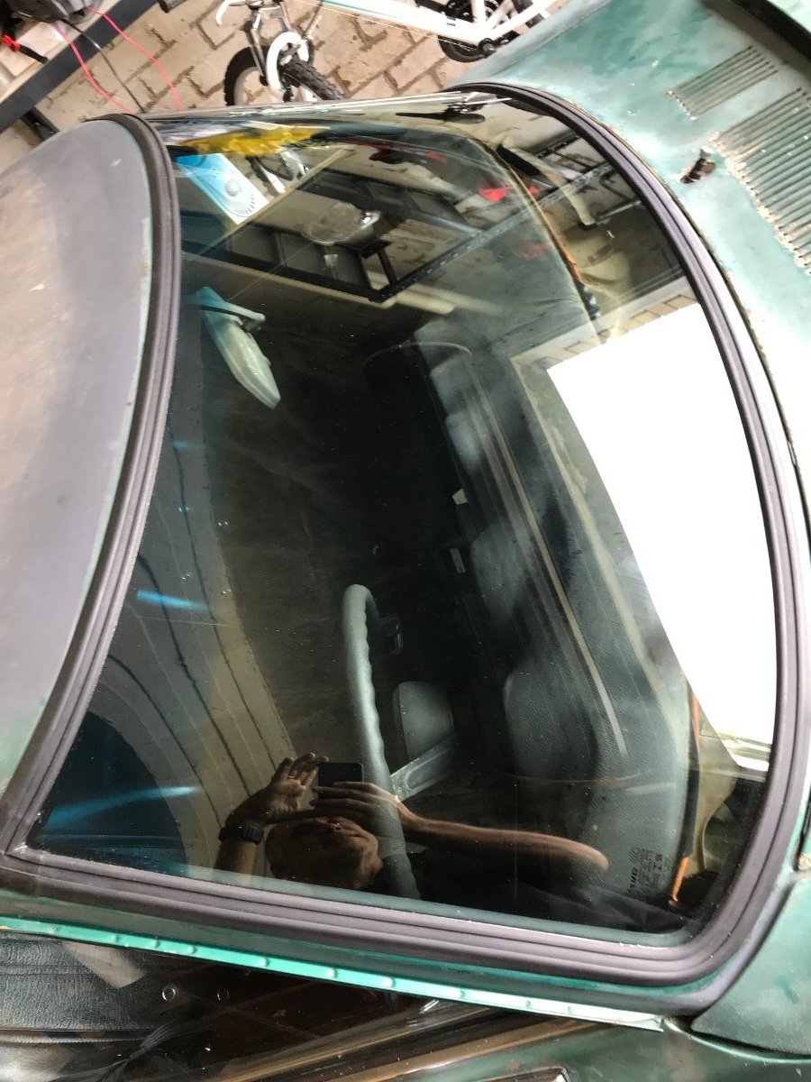

AndBir Posted February 4, 2021 Author Posted February 4, 2021 (edited) New windscreen fitted - using a new Precision seal I had. As recommended by a member on this forum I used Greg from Ace Autoglass who is in Croydon (Melb eastern suburb). Greg did a fantastic job and I would recommend him. Edited February 4, 2021 by AndBir added details KatoKid and 240ZBUILTBYME 2 Quote

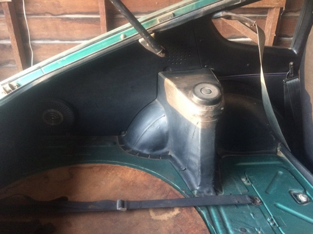

AndBir Posted May 23, 2022 Author Posted May 23, 2022 Also replaced my fuel tank vent hose - what a saga removing the RH & rear inside trim but at least now there is no fuel leak from the hose (near the tank end) when I try to fill up the tank. This enabled me to see what fuel usage was with the triple webers/L28 - was only a 70km drive to and up through the Dandenong Ranges (The Basin-Sassafras-Belgrave-Monbulk-Olinda-Montrose) but came in at around 12litres/100km. Too short a drive to probably be that definitive but it also helped me decide I need the original shock absorbers refurbed/replaced as the condition of non urban roads in Victoria is terrible. 240ZBUILTBYME 1 Quote
