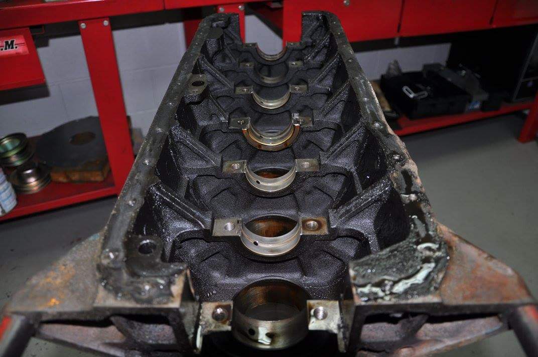

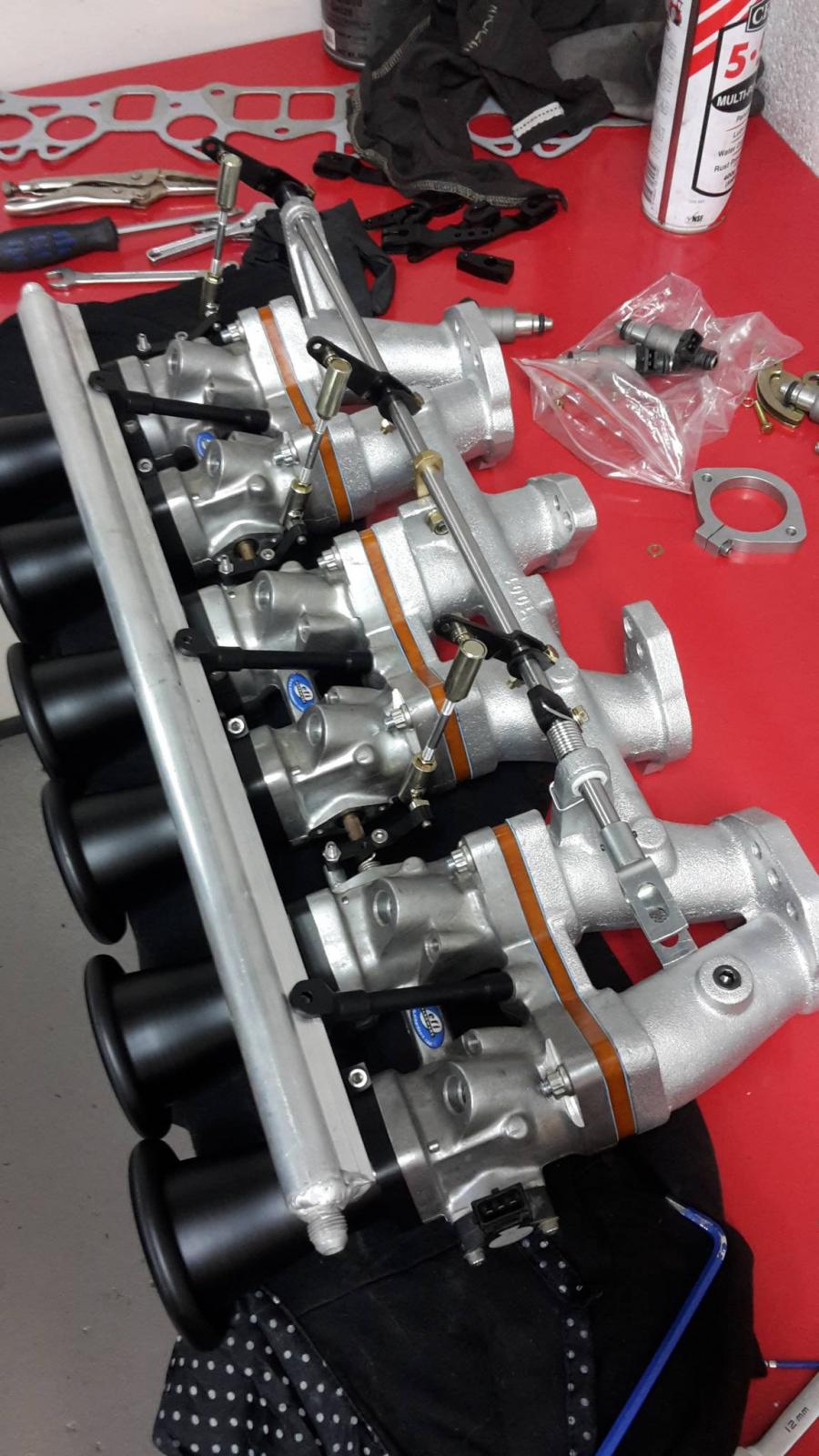

CBR Jeff Posted July 9, 2016 Author Posted July 9, 2016 Part 2 Starting Point The original matching numbers motor and E88 head from the 2/73 240z were not fitted to the car when I purchased it. The engine was sat on a wood pallet. The condition of the items was completely unknown but it was a safe bet that as they had been removed from the car and sat on a pallet in the weather, work would be required to return them to service. A new crankshaft was required along with pistons rods and most of the other internals and ancillary items. I was lucky enough to pick up a set so EFI hardware throttle bodies in almost as new condition for the project. These along with the pallet were shipped to Warragul for LCR to start stripping and confirm that the plan was possible. Les had indicated that while he was confident that the RB crank would fit in the L24 block he had actually never fitted one to the smaller block. Once the block was striped washed down and all of the old parts thrown in the bin an RB crank and rods were test fit into the block to confirm clearances. They fitted just with very very minimal grinding of the internals. The required parts were ordered and the build was scheduled. scott 1 Quote

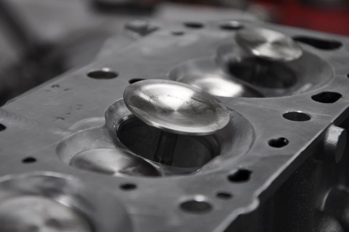

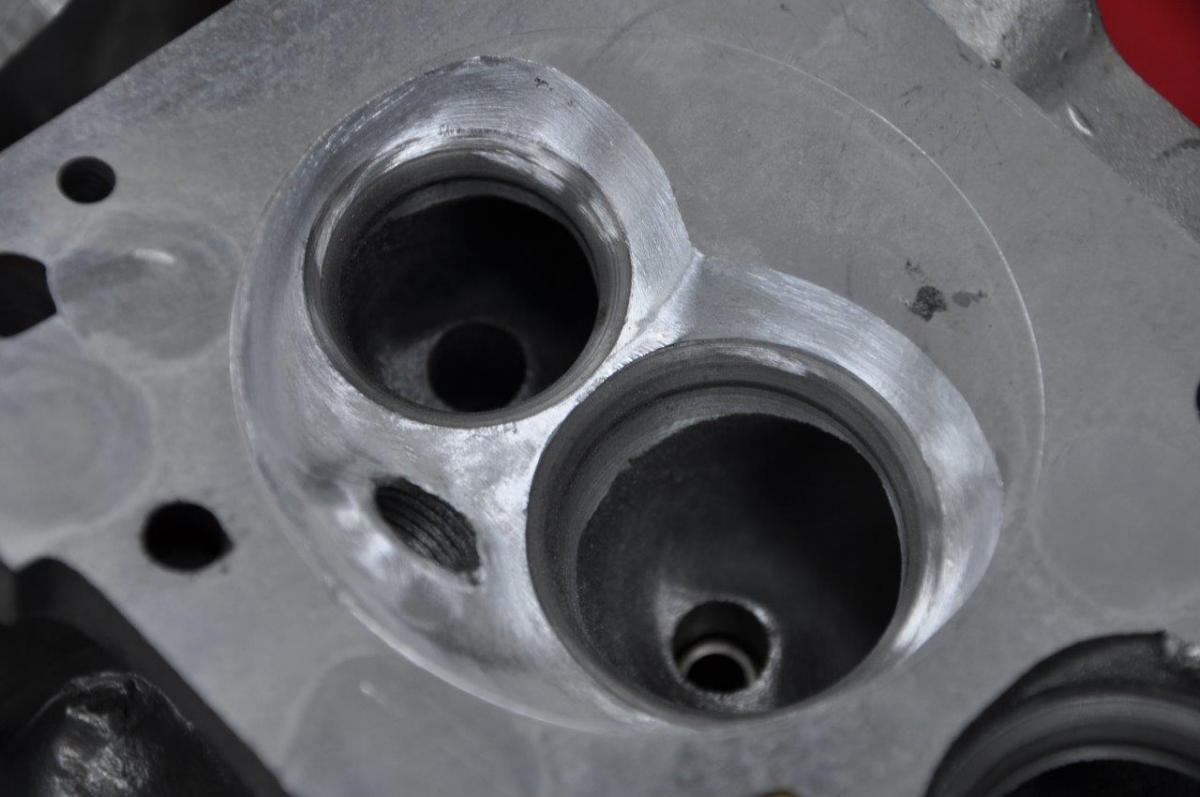

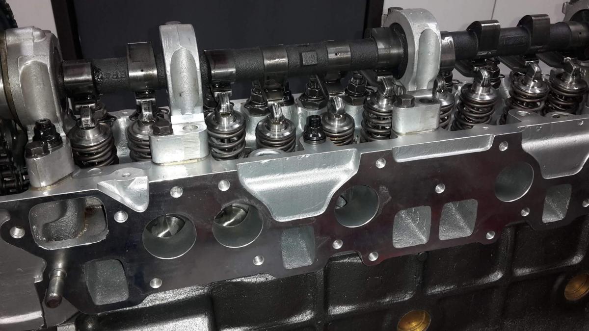

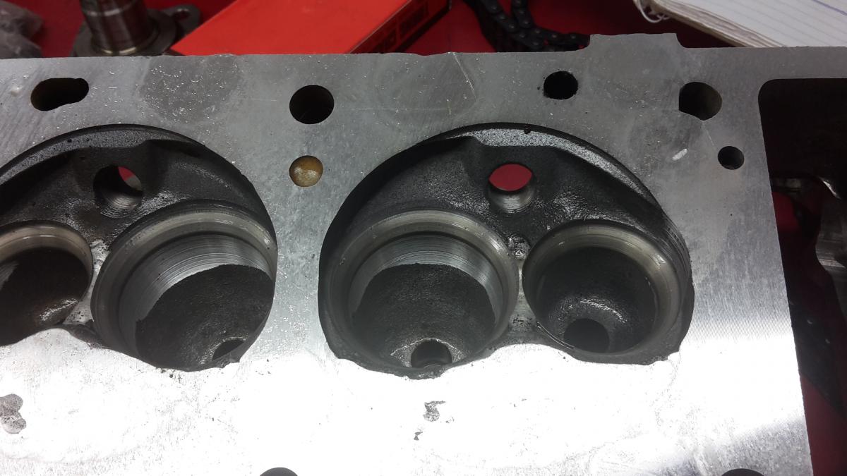

CBR Jeff Posted July 9, 2016 Author Posted July 9, 2016 Part 3 E88 Head, Top End The original head was given all of the usual LCR treatment. Completely stripped cleaned and prep for modification. The combustion chambers were welded up, ports ported to match the inlet manifold that matched EFI TB’s. As were the exhaust ports to match the extractors that would be used. Valve seats installed etc etc After this work was completed the head was water blasted and the assembled with new vales. An LCR grind cam to match the use of the car and provide good low end performance and drivability was manufactured and installed. scott 1 Quote

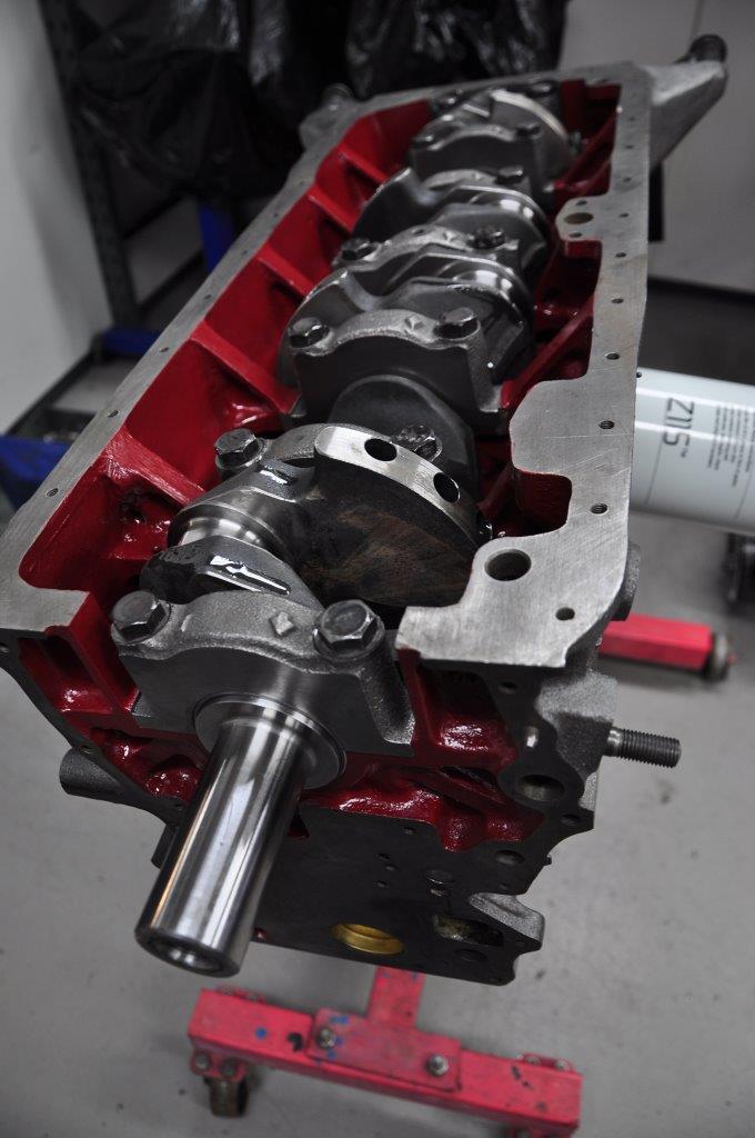

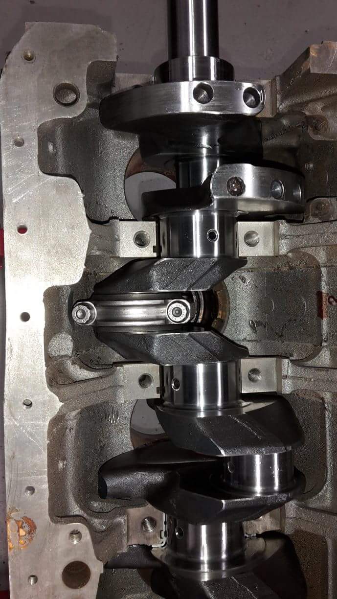

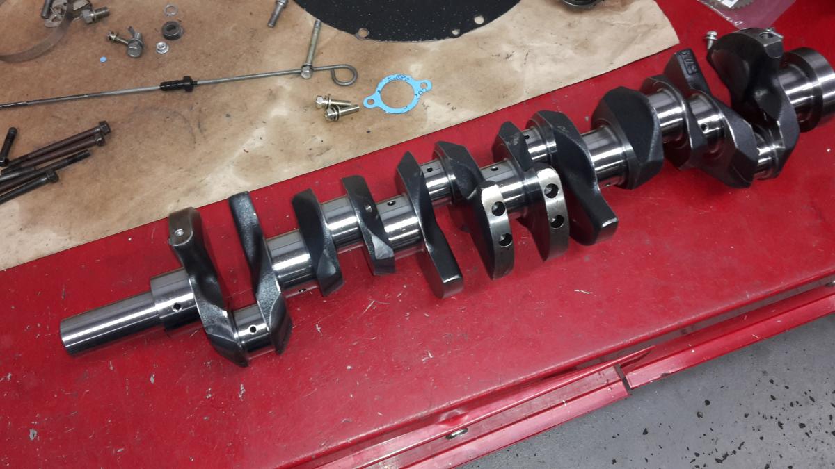

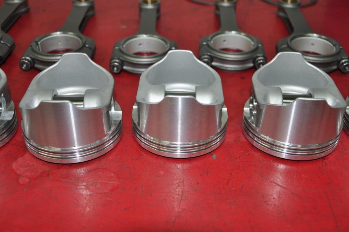

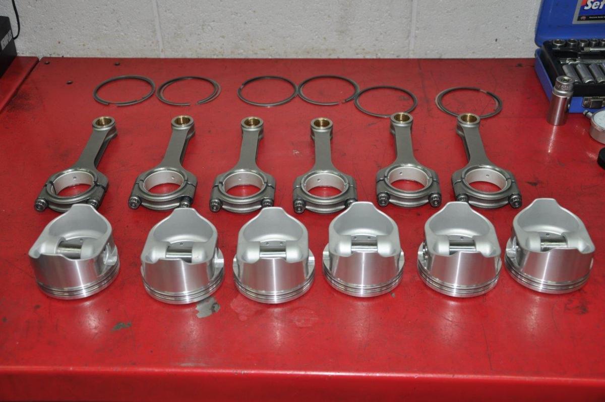

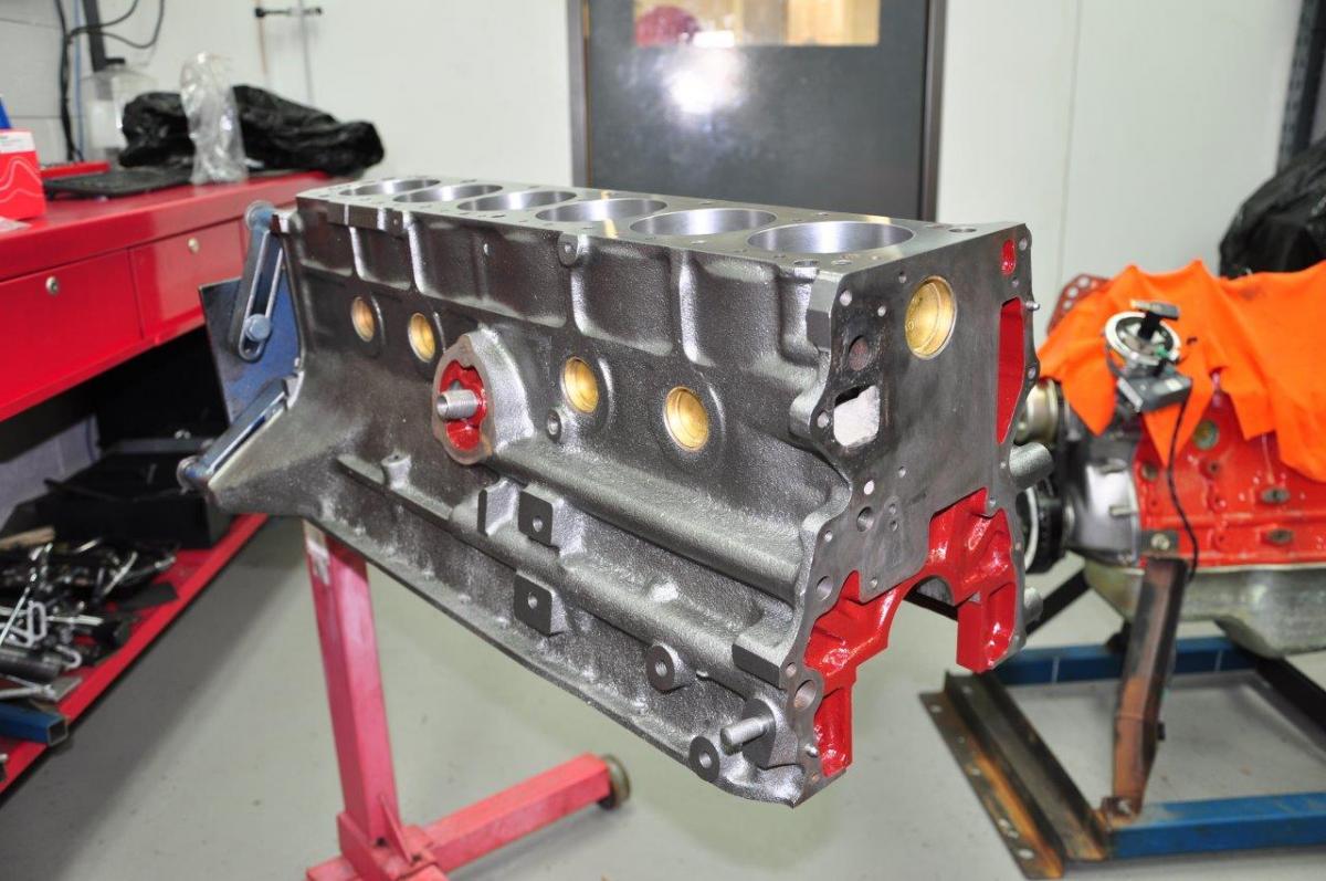

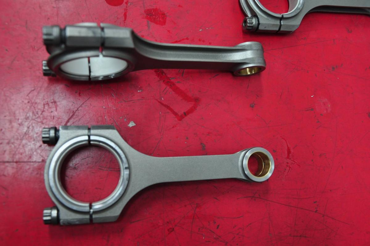

CBR Jeff Posted July 9, 2016 Author Posted July 9, 2016 (edited) Part 4 L24 Bottom End The block following stripping was subjected to all the usual tests and house keeping before having the cylinders bored to 85.5mm. No machining was required on the block to fit the crank. Rather the crank is machined to fit into the block leaving the block essentially as it was originally apart from the cylinder bore and beck heights, both would have needed to be machined with any build using this block. The RB crank was procured by LCR and sent for machining and made ready for the build. STD connecting rods from a VVTI Production based engine were ordered, believed and made ready for installation. These rods are I beam type, very strong and more than suitable for this build. Special forged Pistons were designed by LRC and manufactured specificity for the job. Rods and Pistons were balanced and assembled ready for installation. Edited July 9, 2016 by CBR Jeff scott 1 Quote

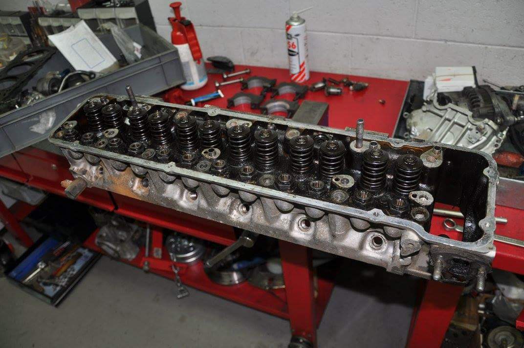

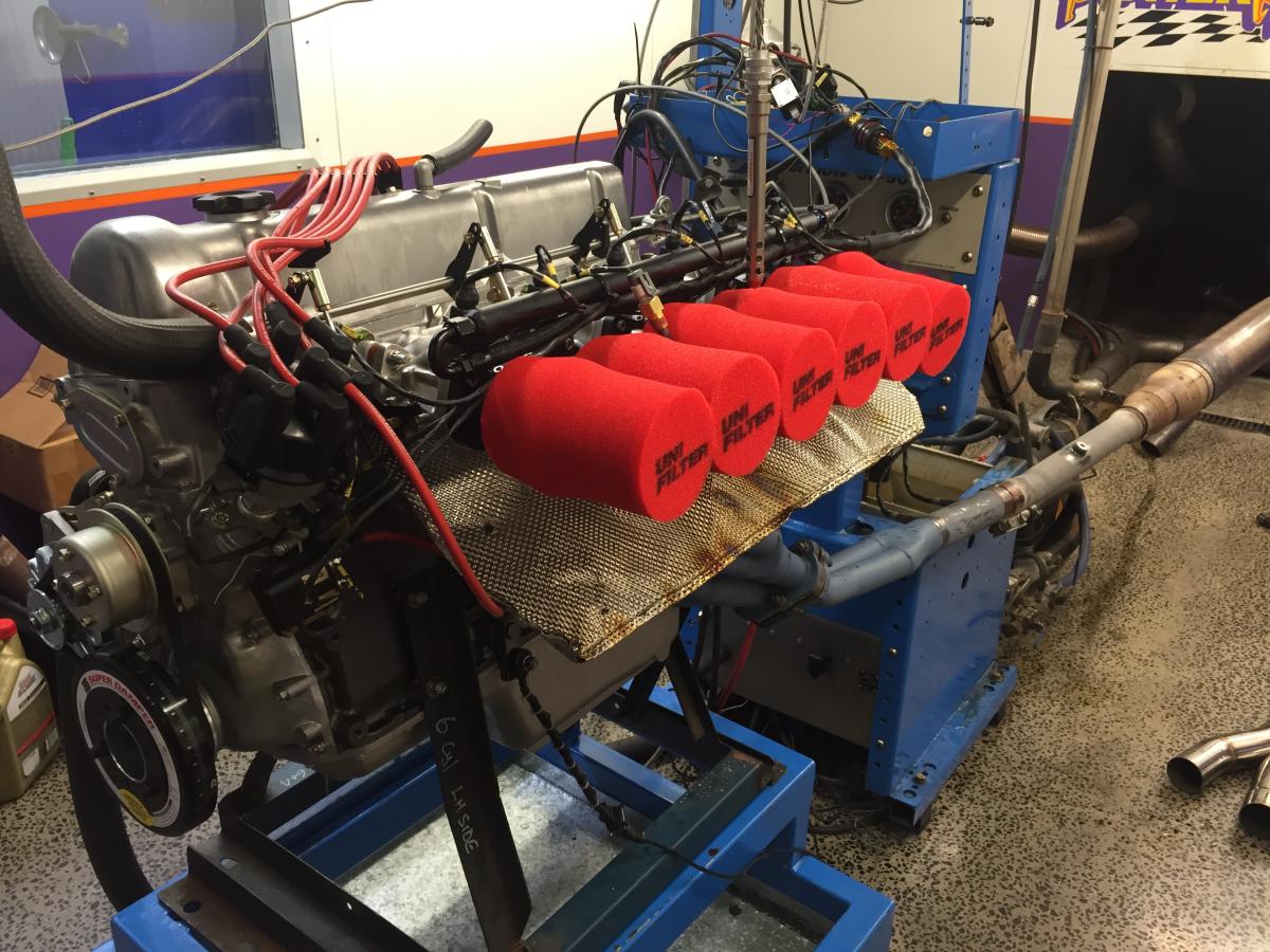

CBR Jeff Posted July 9, 2016 Author Posted July 9, 2016 (edited) Part 5 Assembly During the course of a few days all of the components were assembled into the block and the head installed onto the block. Ancillary equipment installed. Edited July 9, 2016 by CBR Jeff scott 1 Quote

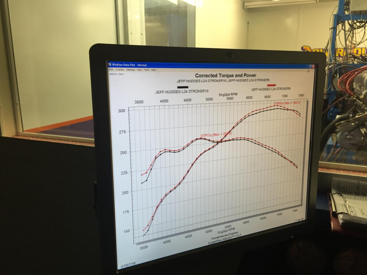

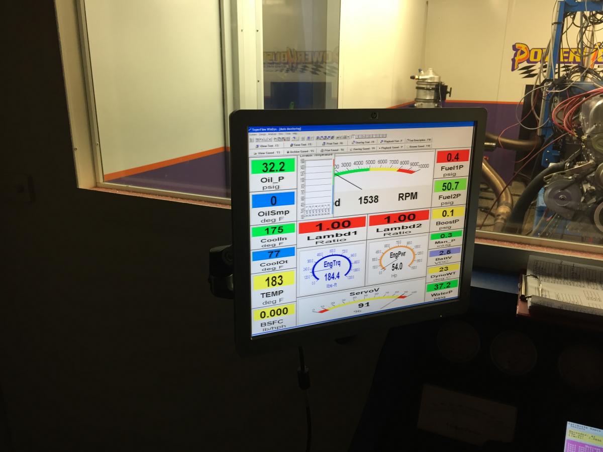

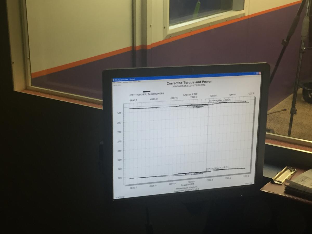

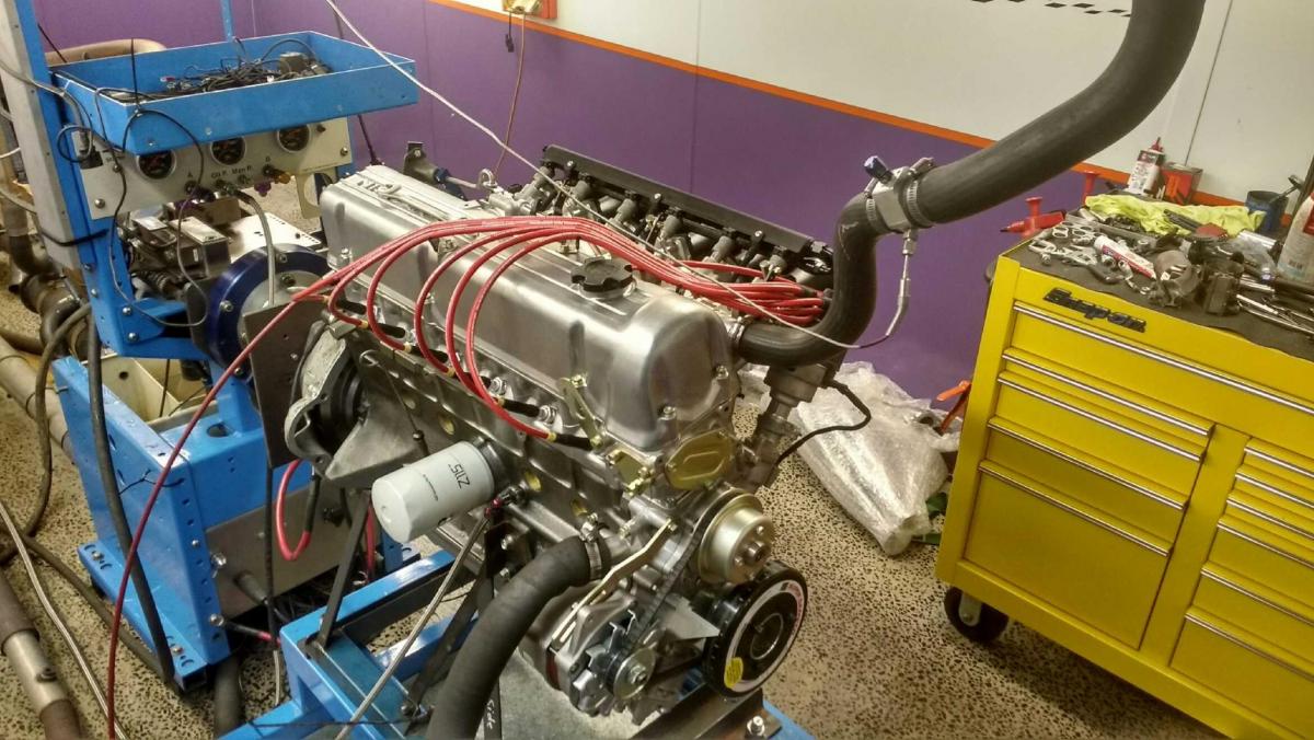

CBR Jeff Posted July 9, 2016 Author Posted July 9, 2016 (edited) Part 6 Test Day, Dyno Finally this day arrived. I had always planned to travel to Warragul to be along for the ride during this stressful, exciting and hopefully enjoyable day. It did take a bit of coordination as I needed to get to Warragul for a day, Les had to be available and ultimately the Dyno to be free for at least two days. So a Thursday early in July was scheduled and luckily all of the bits fell into place. Les fitted the engine onto the Dyno at Power House Engines in Warragul the day before. Ran the engine up and tested it to ensure all was ready for the next day. The day started at about 10am and was finally finished at about 3.30pm. The EFI is being run by a Motec computer. An initial map was installed to get the engine running. Then most of the day was spent methodically working through the rev range firstly at varaible throttle positions then at fixed throttle positioned to complete a table of fuel input rates. As the table came together it was possible to work through the outer edges of the table filling in the gaps. The set up at Power House Engines is quite impressive. They have a SuperFlow engine Dyno situated in a very well appointed enclosure/room specifically manufactured for the purpose and imported from the USA. John the owner of PHE is a dab hand at running the Dyno and coupled with the tuning abilities of Les make a great team that instilled a larger degree of confidence. The entire day was a great experience. Just sitting in the background watching people who know what they are doing do their thing is impressive. But when that thing sounds like it does and feels like it does it's a very cool experience. Listening to an L series engine at 7500 rpm if truly an experience. Video of part of the day. https://www.facebook.com/LesCollinsRacing/videos/1820750944826013/ Edited July 9, 2016 by CBR Jeff scott 1 Quote
CBR Jeff Posted July 9, 2016 Author Posted July 9, 2016 (edited) Part 7 Specifications Block original L24 Bore = 85.5 mm Stroke = 89 mm Capacity = 3066 cc (call it 3.1l) Compression = 10.57:1 Head original E88 Inlet valve = 44 mm Exhaust valve = 35 mm Chamber = 50 cc Fuel = 98 45mm EFI Hardware throttle bodies Original L24 The L24 was a 2,393 cc engine. Bore is 83.0 mm and stroke is 73.7 mm. Dyno Max power 305Hp at 6800 rpm Max toque 260 Lbs-ft at 4200 rpm Other numbers At 1500 rpm 184 lbs-ft and 54 Hp Over 200 lbs-ft from 3500 rpm Over 250 lbs-ft from 4000 rpm to 6000 rpm Edited July 9, 2016 by CBR Jeff Sirpent 1 Quote

CBR Jeff Posted July 11, 2016 Author Posted July 11, 2016 (edited) You are looking at it the wrong way, you need to look at the cost differential. If I purchased the crank you have for sale for $50. I would still need to send that crank for testing, machining, cleaning, polishing etc, so would probably need another $1200 +/- and it is still an L28 crank. Guessing total cost with freight would be about $1300.00. The RB Stroker crank all set ready to go costs between $2500 and $2750 depending on start and finish points. But if you look at the RB crank it's a very different crank. That's the only difference when building the short engine! 6 new Rods and Pistons cost what they do either way. Head work, cam, gaskets, timing chains, etc etc all cost the same to, so it's not that much of a cost increase. Admittedly getting it done professionally, including ancillary items and engine Dyno tuning has cost more than doing it myself, but it's done and it runs..... That's roughly a $1300.00 add if you need help. Money well spent in my opinion. Jeff L series cranks RB crank Edited July 11, 2016 by CBR Jeff gav240z and scott 2 Quote
