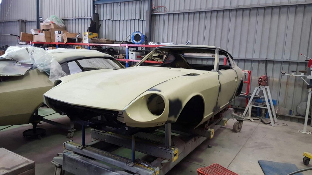

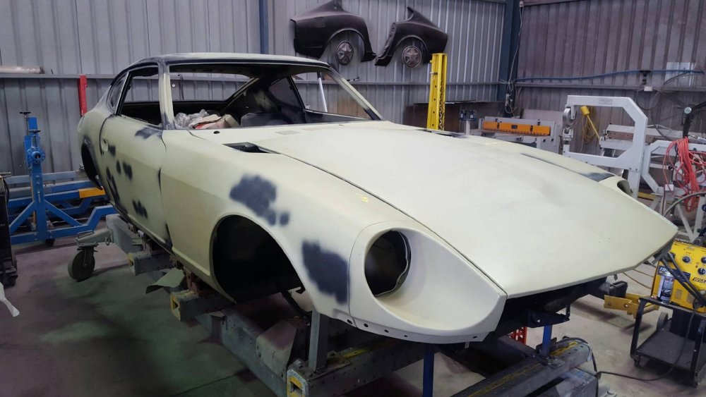

George Posted February 5, 2016 Author Posted February 5, 2016 Reached a significant milestone this week Pete... Paul has all but completed the rust repairs. There are a few small holes which can't be reached until the car is taken off the chassis bench but otherwise we are on to panel and gap work. gav240z, andyk_79, HS30-H and 3 others 6 Quote

mossy Posted February 5, 2016 Posted February 5, 2016 Considering how this car after you stripped it down, I'm very impressed, well done George and Paul! Quote
Brabham Posted February 6, 2016 Posted February 6, 2016 Excellent work guys, looks great, good to see it saved. Quote
Karljsw Posted February 8, 2016 Posted February 8, 2016 Looks amazing now can't wait to see the final product Quote
jeff43 Posted February 9, 2016 Posted February 9, 2016 Reached a significant milestone this week Pete... Paul has all but completed the rust repairs. There are a few small holes which can't be reached until the car is taken off the chassis bench but otherwise we are on to panel and gap work. Well done George and Paul. Looking really good. Better pull my finger out now - the race is on!!!!! Quote

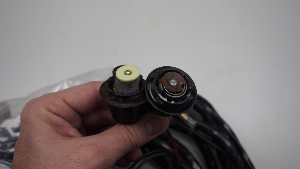

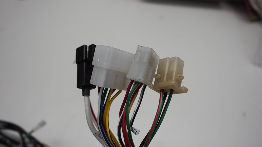

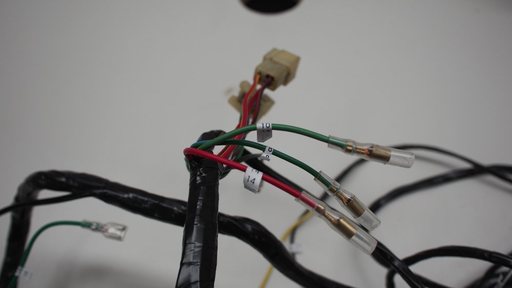

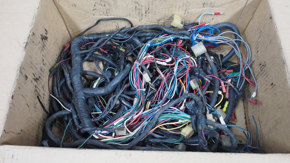

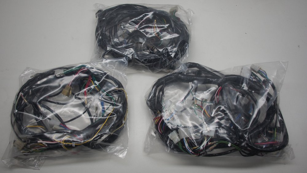

George Posted May 28, 2016 Author Posted May 28, 2016 I sent my harnesses in to Vintage Wiring almost two years ago. They were returned this week and the wait and price was worth it. Hopefully it won't take me two years to install them but I wouldn't be surprised based on the progress of this build. Below are some photos showing the old harnesses, new ones, tags, new connectors and reconditioned components. mspecr 1 Quote
Moderators PB260Z Posted May 28, 2016 Moderators Posted May 28, 2016 They say that good work takes time !! And that looks like very good work. George 1 Quote

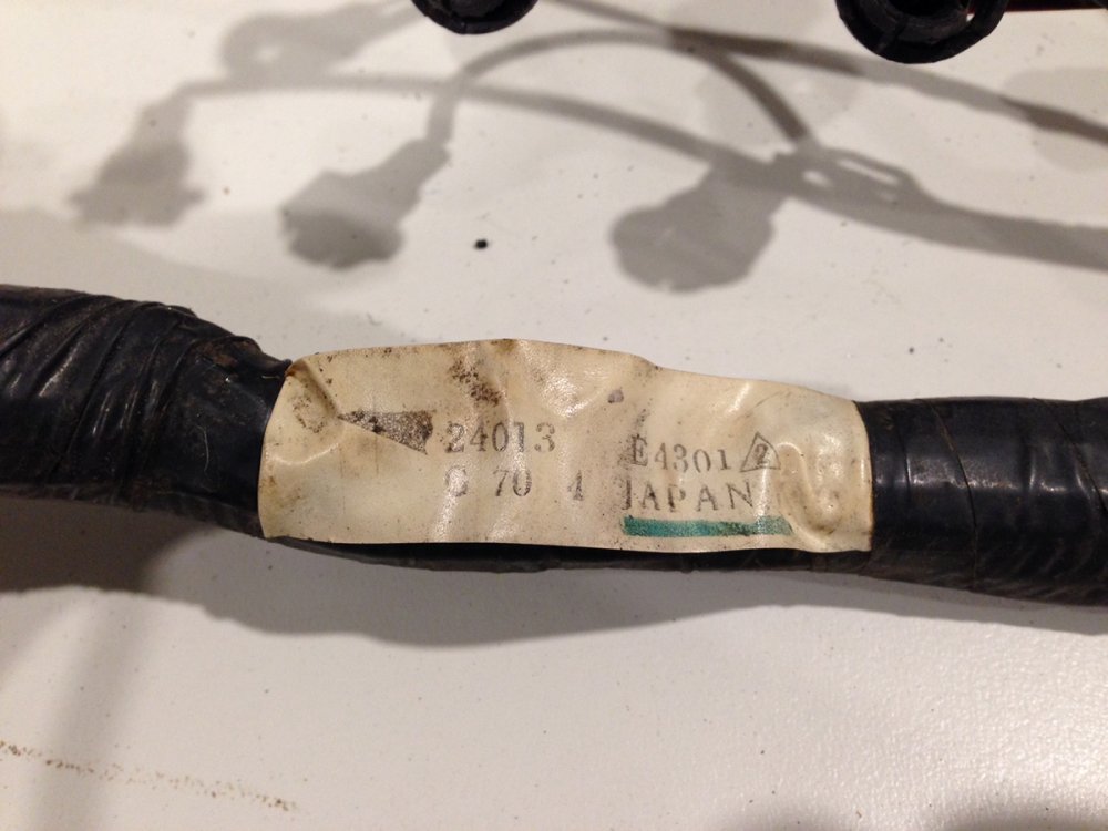

HS30-H Posted May 28, 2016 Posted May 28, 2016 (edited) For what it's worth, here is the date stamp on the dash harness. Your guess is as accurate as any I've come across. Sorry to be a bit late here (didn't see this photo until just now) but the letter 'G' on that harness section label is the MONTH letter, where 'A' = January, 'B' = February and so on. So 'G 70' indicates July 1970. Edited May 28, 2016 by HS30-H gav240z 1 Quote

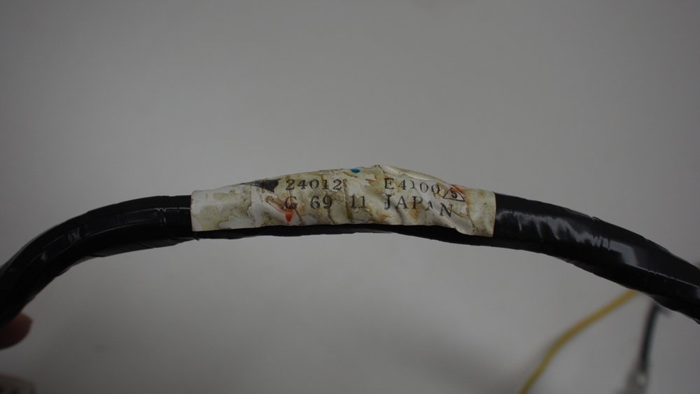

George Posted May 29, 2016 Author Posted May 29, 2016 Sorry to be a bit late here (didn't see this photo until just now) but the letter 'G' on that harness section label is the MONTH letter, where 'A' = January, 'B' = February and so on. So 'G 70' indicates July 1970. That seems to align with what I've crossed referenced on engine numbers with US market manufactured cars. There's also this on the body harness. Try and make sense of that... Quote
Administrators gav240z Posted May 29, 2016 Administrators Posted May 29, 2016 The first part 24012-E4100 is the part no. G 69 11. I dunno could it be July 1969? Quote
HS30-H Posted May 29, 2016 Posted May 29, 2016 We have to be careful with stuff like this, as the different departments within the Nissan group and outside suppliers certainly had different dating systems and QC stamps. It can get confusing. The letter 'G' should - logically - stand for the month, and the number after the year identifier should - logically - be the day? If the numbers never went higher than 12 they could be month, so I'm going to have a look around on my cars and see what I can find. I have two 1970-build cars that should be good candidates for cross-referencing. I'm getting too old to trust my memory...! Quote
George Posted May 29, 2016 Author Posted May 29, 2016 The first part 24012-E4100 is the part no. G 69 11. I dunno could it be July 1969? No, I meant try to make sense of why the front harness is dated July 1970 and the body one is dated July 1969. Just like the transition of early parts to later, there really is no sense to it and no point in trying to explain what happened over 45 years ago. Quote
