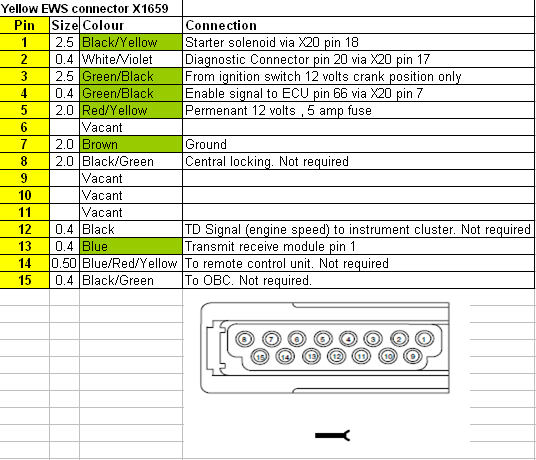

John. What Mike says is correct, you have to provide the inputs the system requires otherwise its game over. This is the pin out for the EWS module, as you can some inputs from the body module, central locking and engine speed are not required but the everything else is a must have and cannot be replicated with a dummy signal as they are integral with sending code to and from the components (key, transmit/receive, EWS and ECU).

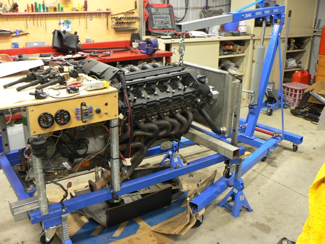

A few weeks.....I wish. I started researching what was required to run the engine with the factory ECU and security system before I even made the decision to buy the engine from the UK as going aftermarket ECU just wasn't going to be cost effective. I couldn't put a figure on how many hours Ive spent researching and pouring over the BMW wiring diagrams to get to a point where I understood how it all worked and was confident I knew what I was doing.
Thanks guys. John, this is my first YouTube effort so let me know if the sound is a problem, works on my wife's laptop fine? You need to hear the terrible sound at the first start! Was fairly sh..ting myself when I first heard it but had a good listen and was reasonably confident it wasn't a bottom end issue. Realised I wasn't going to be able to sleep until I proved it, hence the late night thrash......
Dave, probelm mate....steering wheels on the wrong side. You dont muck around...well done!
Momentous occasion for yours truly..... and I was inspired enough to post my first YouTube video. To say I was relieved when it started straight away is a massive understatement! Bit of pain along the way but lots of win in the end! Watch all about it...
