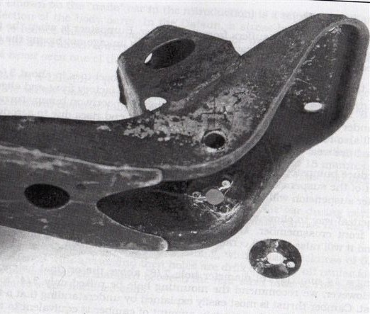

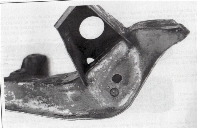

                      I already had fitted alloy bumpsteer correctors to the bottom of the struts, but these were not doing the trick. After a bit of research I removed the cross member and used a cold chisel to remove the washers on the inside of the holes for the control arm. I then used a centre punch to mark the location of the new holes. I welded up the original holes and drilled the new locations on the centre punch marks. I then fitted the control arm bolts with the new washers on the inside of the crossmember and held them in place with clamps, and spot welded them with the electric welder. Prior to removing the washers I had measured the gap between the holes. After welding the gap was a couple of mm closed up so I just fitted a bolt with 2x nuts and used this to spread the sides. I only had to drill the holes 13mm higher and out 4mm to make the control arms and steering arms parallel on my car. Then a tidy up with a file to get rid of any sharp edges and dags, and hit it with a can of paint. Off to the wheel aligner for a toe-in adjustment and hit the road. Hope that this helps. Photos to follow. Tried once but it didn't work.

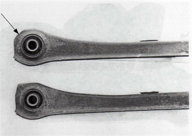

I think this is the modification David is referring to.
Note: you may have to remove some metal from the lower control arm as well (see arrow) so first check that it does not contact the crossmember before driving the car.

Good photos Peter. I only had the photos of when everything was back on the car. I didn't have to move the hole as far as yours because I had the bump steer spacers on the bottom of the struts. David.

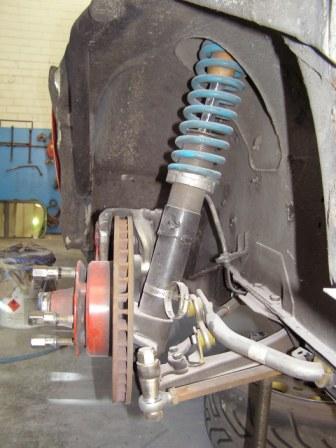

After moving the LCA on my car I installed rose joints & small spacers on the end of my steering arms per attached. Reasonably priced and my car has absolutely no bump steer. Drives like a normal car! The car is now safe to drive on those rough raods without running off into the bushes or gripping the wheel like my life depended on it. you know what i mean.   ;)
