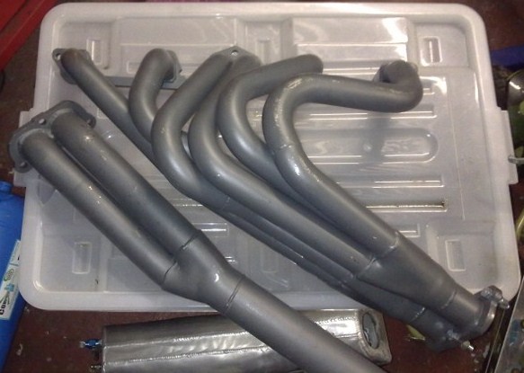

peter mc Posted July 14, 2011 Posted July 14, 2011 hi Roberto the extractors turned up today from SW , am happy to say the finish is very good Quote
Moderators Zedman240® Posted July 14, 2011 Moderators Posted July 14, 2011 Hey Peter, are they tuned length? and are you going to extend the length of the secondaries? Very nice.. Quote
peter mc Posted July 14, 2011 Posted July 14, 2011 they are tuned length, they are the same as the ones i used on the motor that made 193kw and the sec pipe are fine at this length, SW has made a batch of 10 sets so if you wont some get in quick they were $ 1500 but he has cut the price to $990 they are top extractors for strong L24s L28s Quote
Roberto Posted July 14, 2011 Author Posted July 14, 2011 I love the look of those pipes. Very slick. Not long now..... Quote
acf321 Posted July 15, 2011 Posted July 15, 2011 Agreed Roberto .. I will be extremely interested to see how they go, as these are the exact same pipes as i'm picking up next week. The welds look excellent, and speaking to Peter, the quality is extremely good too. These are the first run of 1 5/8" primaries, so it'll be interesting to see how they go on hot L motors, versus the last run at 1 7/8". Be sure to keep us posted, and stick a vid of the car running with them on. What muffler / rear pipe are you planning on using? I will use a stainless 2.5" mandrel bent pipe with mid mounted resonator and rear single sports muffler. Adam. Quote
mossy Posted July 15, 2011 Posted July 15, 2011 They look great Peter, so I take the price is for both sets of pipes in the pic, also is ceramic coating included in the price or are they just supplied in mild steel? Quote
peter mc Posted July 15, 2011 Posted July 15, 2011 yer they come like that but if you wont them ceramic coated it will cost extra about $250 get in quick mossy they are perfect for you motor Quote

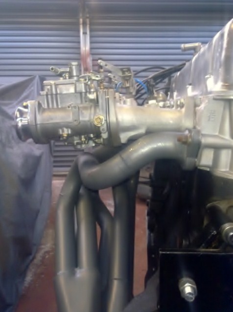

chris240 Posted July 16, 2011 Posted July 16, 2011 damn this looks the goods.... hey Peter, is that the coil mounted on the front of the block ? would heat be an issue ? Quote
mossy Posted July 16, 2011 Posted July 16, 2011 Ohh those headers look sweet with the triple carbs, lucky I got mine coming next week Quote
peter mc Posted July 16, 2011 Posted July 16, 2011 no most coils are on the motor now , but its only there for the dyno to make it easy for us. Roberto can mount it anywhere on the car . Quote
