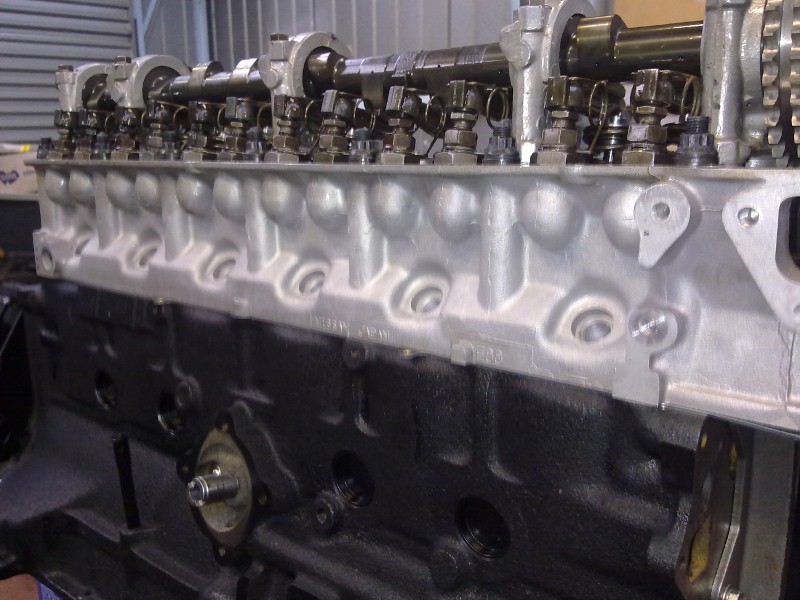

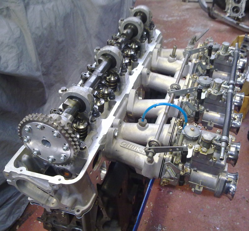

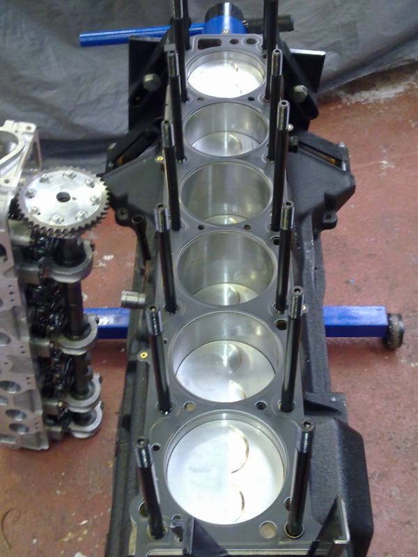

peter mc Posted May 22, 2011 Posted May 22, 2011 have been checking your E88 out and its as good as any i have tested .. .. and they are your rods and pistons in the background Quote
Scoota G Posted May 22, 2011 Posted May 22, 2011 Dang they look nice like that, shame to install it Quote
NZeder Posted May 22, 2011 Posted May 22, 2011 have been checking your E88 out and its as good as any i have tested very nice - is that a EFI E88 from the L24E power 240K sold in Oz or the older E88 with a weld/work - either way look very nice. Quote
peter mc Posted May 22, 2011 Posted May 22, 2011 its a efi one with the port welded. SW had it cnc ported Quote

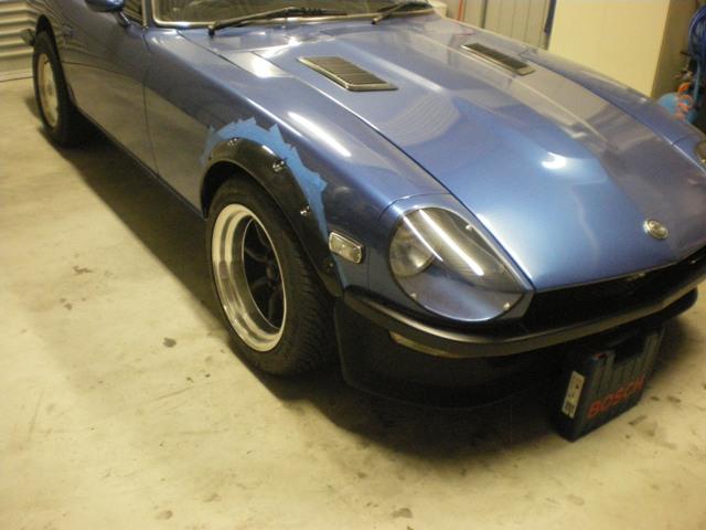

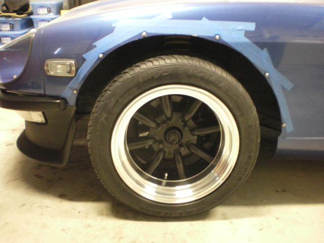

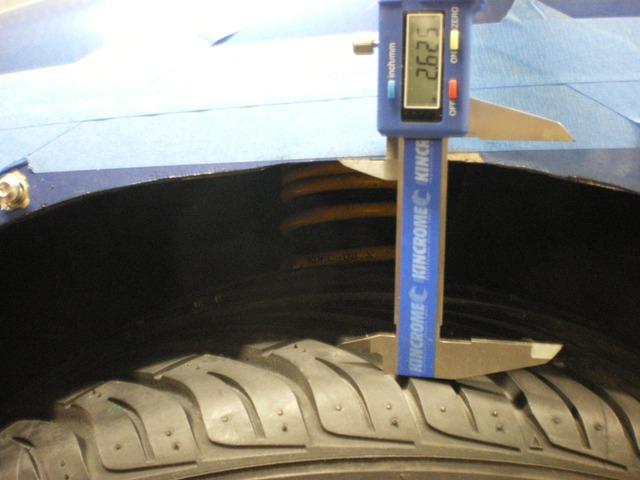

Roberto Posted May 22, 2011 Author Posted May 22, 2011 Looking great Peter. Thanks for the update. I have finally been able to test mount my new front wheels and flares after needing to trim back the front spoiler even more due to the 245's rubbing when turning. I have about 2.5 inches of clearance between front tyre and fender, so i hope there will be no rubbing over big bumps. Fingers crossed. Quote

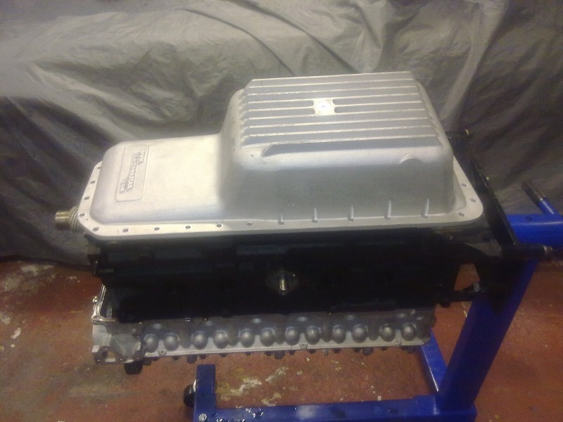

peter mc Posted May 29, 2011 Posted May 29, 2011 a big day in the shed its nearly finnished and then on to the engine dyno Quote
garvice Posted May 29, 2011 Posted May 29, 2011 I can't quite make out the name on the sump peter, but it is a beautiful piece. Who makes that? Quote
peter mc Posted May 29, 2011 Posted May 29, 2011 it needed about 3mm of porting to match on big deal all looks good will match the extractors when sw makes them Quote

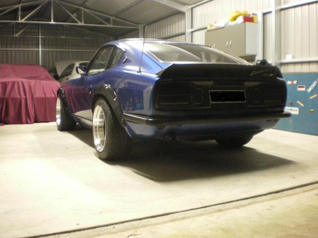

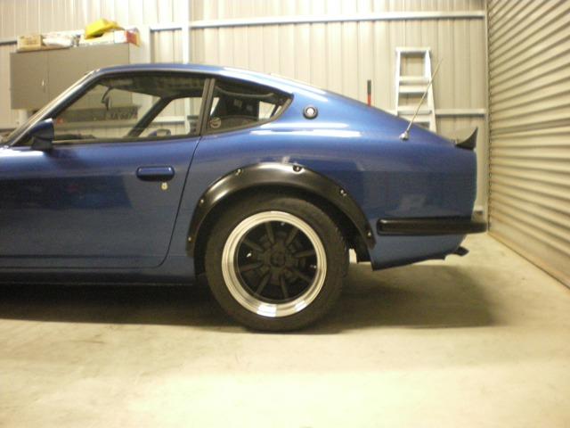

Roberto Posted June 9, 2011 Author Posted June 9, 2011 Whilst Pete has been busy on the engine, I have finally completed my flare installation...... They fitted very well and I am happy with the results. Thanks for the help Mick. Quote

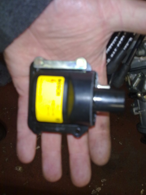

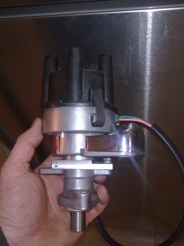

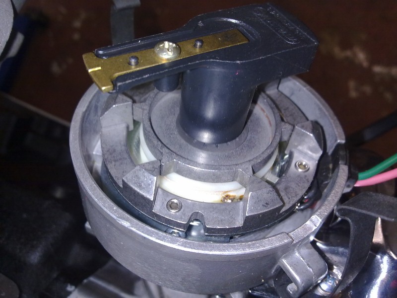

peter mc Posted June 27, 2011 Posted June 27, 2011 hi Roberto just finished the distributor its been set up for your motor timing numbers are 14 deg base timing and 28 total with no vac advance , will have the pipes at the end of the week and then of to the dyno can not wait Quote
Moderators Zedman240® Posted June 27, 2011 Moderators Posted June 27, 2011 Nifty little coil setup there; should make the engine bay a bit tidier with that! Do you get a good spark with those? Quote
peter mc Posted June 27, 2011 Posted June 27, 2011 ahahah good things come in small packages its the latest from the germans Quote
Roberto Posted June 27, 2011 Author Posted June 27, 2011 Oh cool. The coil is very "subtle" isn't it? What brand is it? Quote
