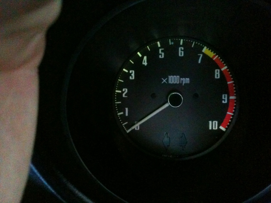

Riceburner Posted April 5, 2011 Author Posted April 5, 2011 Just got the tacho back. It's been stripped out, new face made, new modern internals so it can hook straight up to my MSD6AL-2 ignition. Plugged it in this afternoon it's super smooth when revving up or down, only thing I'm missing is one of the two lights that plug into the back of the gauge, it has been cut off...... Just in time for Winton, woohoo! While tuning the new engine over the weekend I kept scratching my head and wondering why it would miss and stop revving at 6900rpm. In the end I gave up frustrated, when day dreaming later on I thought to myself could it be the rev limiter?? Nah I was certain it was at 7200rpm, curiosity got the better of me and I checked it...... sure enough set for 6900 DUH! problem solved. Set it for 7300rpm Quote
Administrators gav240z Posted April 5, 2011 Administrators Posted April 5, 2011 Just got the tacho back. It's been stripped out, new face made, new modern internals so it can hook straight up to my MSD6AL-2 ignition. Who did this for you? It looks great and 10,000RPM? They got the Typeface spot on, looks stock love it. Modern internals would be awesome too, since my 1 bounces around a bit. Quote
luvemfast Posted April 5, 2011 Posted April 5, 2011 Looks great mate, but how does she go at 6,900RPM? Guess I'll find out Sunday We're not in the same group though Down to the clock then........... Game on Quote
Riceburner Posted April 5, 2011 Author Posted April 5, 2011 The work was done by an instrument shop in mulgrave called 'Hit300' really top notch work, recommended by GV260. I got the picture from an old post on HybridZ, Alan (HS30H) posted it as an factory original 10,000 tach, even has the peak power dots and the 'kanto seiki' writing at the bottom of face plate. I saw the groupings Simon, Mark said he couldn't do it cause of your multiple entry, so blame your dad! haha. Goes great at 6,900rpm and even better at 7,000rpm. Quote

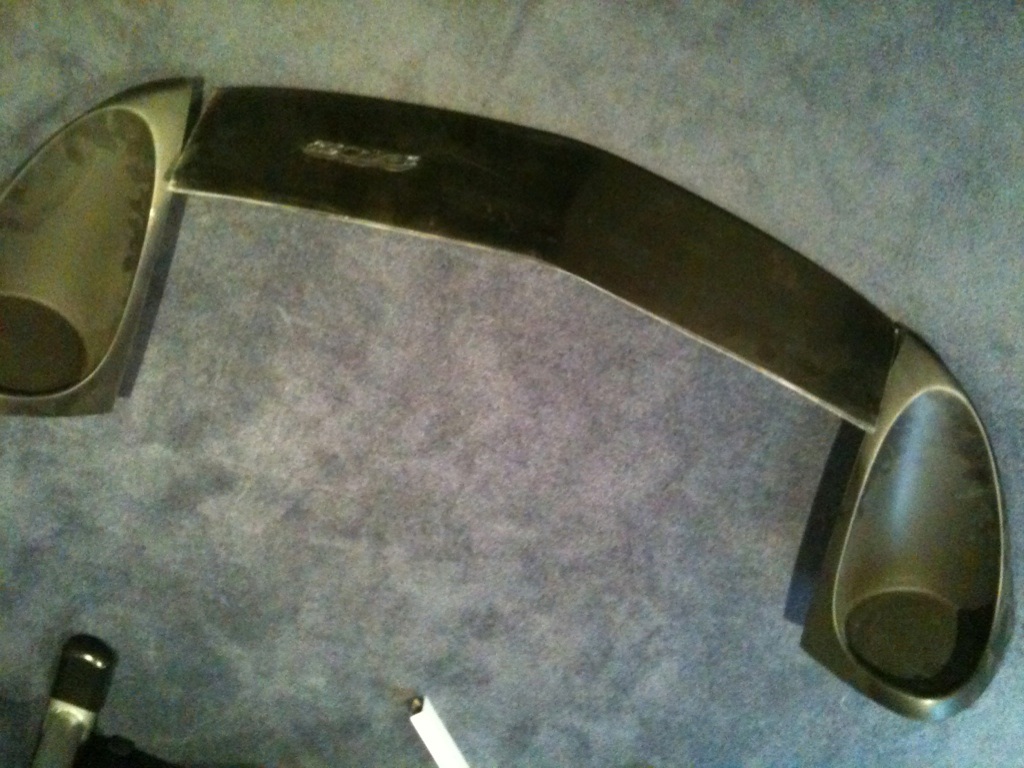

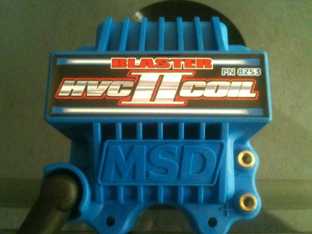

Riceburner Posted May 18, 2011 Author Posted May 18, 2011 Well, it's time for another front end change............ Some would call it a nose to rival Gerard Depardieu I got a few spare bits from Freddie at Top Stage, but I also have a 5 piece kit in pretty good condition. The changeover could take a while though as I want it to be a pretty neat fit. I'd love it to look like the print I recently ordered! Also picked up a new coil as my old one had started to leak a bit of oil from the lead connection. It's the latest from MSD and the most powerful I can run on the MSD6AL-2. It's huge at 10cmx10cmx10. It might also come in handy if anyone needs a defibrillator, just need to make up some paddles Quote
Moderators Zedman240® Posted May 18, 2011 Moderators Posted May 18, 2011 Has Freddie finished the moulds? Last I heard he was finishing the lower front part. Better drop in tomorrow! Quote
Riceburner Posted May 18, 2011 Author Posted May 18, 2011 Dimitri, he has finished the top parts but I didn't see any lower sections apart from the original siver one that was for sale. Quote

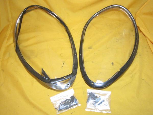

Riceburner Posted May 20, 2011 Author Posted May 20, 2011 Just found out I got a set of NOS ZG headlight covers! I'm stoked and think they will really complete the look of the G-Nose when I get around to doing it ;D Quote
Moderators Zedman240® Posted May 20, 2011 Moderators Posted May 20, 2011 Well done Gareth! how did you score those? I'm curious as to find out how much? If you want to pm me the price.. I'll need a set when I put a ZG nose on my 240 Quote
Administrators gav240z Posted May 20, 2011 Administrators Posted May 20, 2011 Awesome mate, I really like the Gnose and I think it's really under appreciated. You have to see a proper version of it in person. So many cheap copies have destroyed the look. Make sure you go with the original colour scheme too, it won't look right all white. Has to have that 2 tone. It will look amazing I'm sure. The dilemma going with the Gnose was expense of getting a good 1 and using ZG flares. Still not sure I want to chop up the guards on the old girl yet. Quote
luvemfast Posted May 20, 2011 Posted May 20, 2011 Just found out I got a set of NOS ZG headlight covers! I'm stoked and think they will really complete the look of the G-Nose when I get around to doing it ;D Who just happens to find they have NOS ZG headlight covers laying around? Think I need to come have a look through your stuff! Quote
