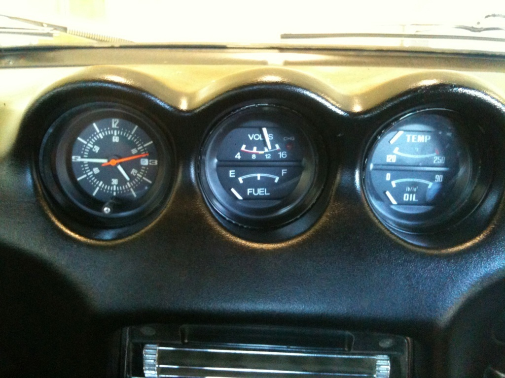

I finally did the amp/fuel gauge to volt/fuel gauge swap in the dash, was straight foward. Thanks Dimitri  :)

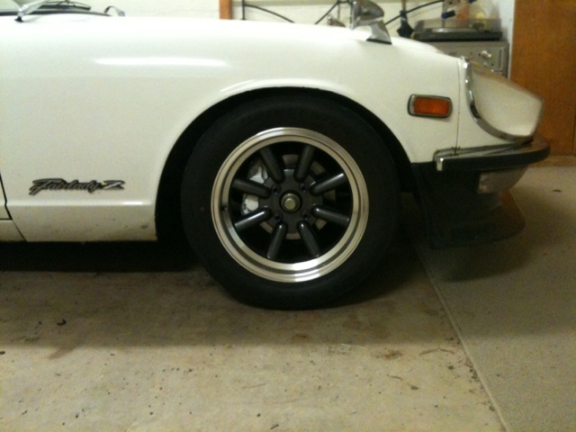

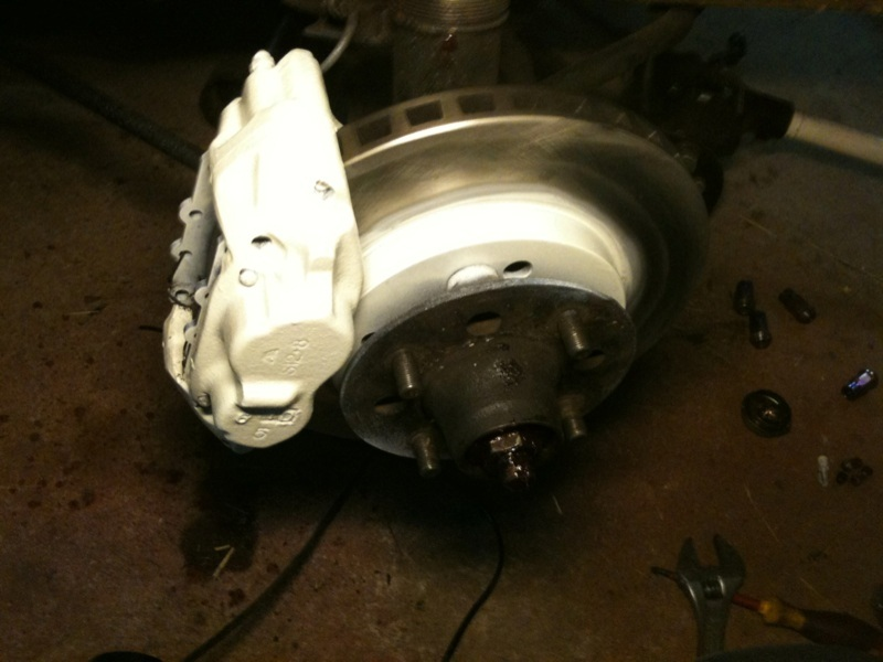

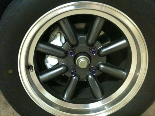

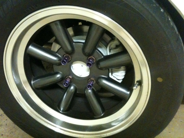

Also fitted some TP Mangna vented rotors and fully rebuilt Hilux S12+8 calipers to the front end, this required 260z hubs to give correct offset and no spacers were used. I had to replace all seals in the calipers so I separated/stripped them down and machined out the rotor groove from 22mm to 27mm. Bolted back together and fitted new pads. YAY, no more brake fade......... I hope!
I color matched all calipers and rotor hubs to car color, which look pretty sweet I think  8)

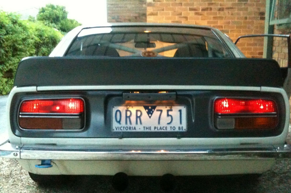

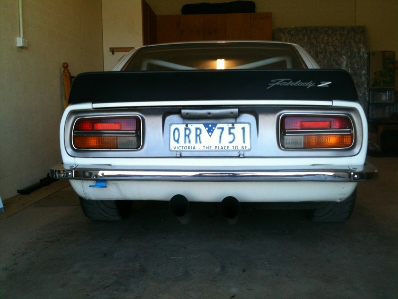

Last was the easiest, just put a badge on the rear spoiler and color matched some of Lurch's top notch metal work. Just wanted it to look ok until final repairs/paint are done.

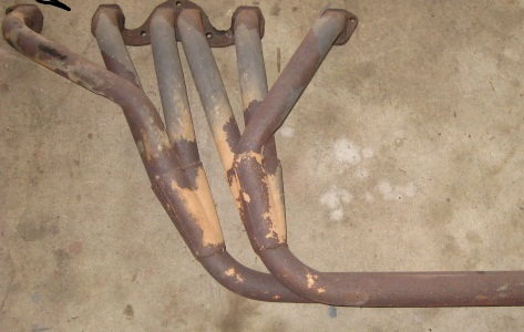

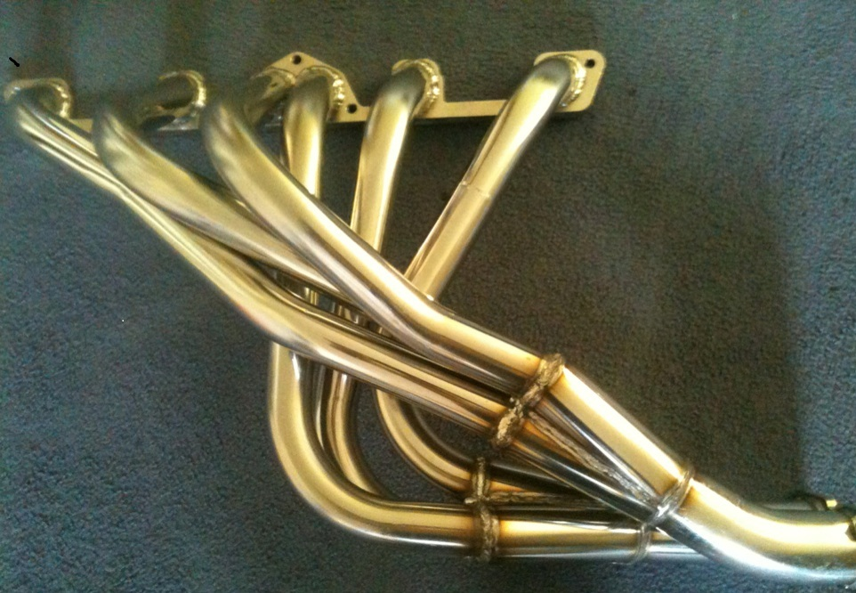

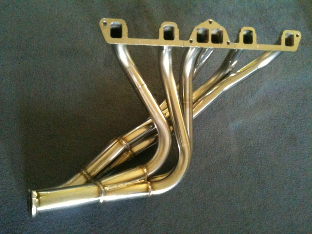

I am tossing up getting an new set of extractors as the new ones were on my parts car when I got it and maybe arent up to the new engines capabilities. Feeback wanted........ Peter Mc especially?????? New Header dimensions are 42.7mmx6, 45mmx2, 60mmx2.
First pic is the current set. Second is the new set.

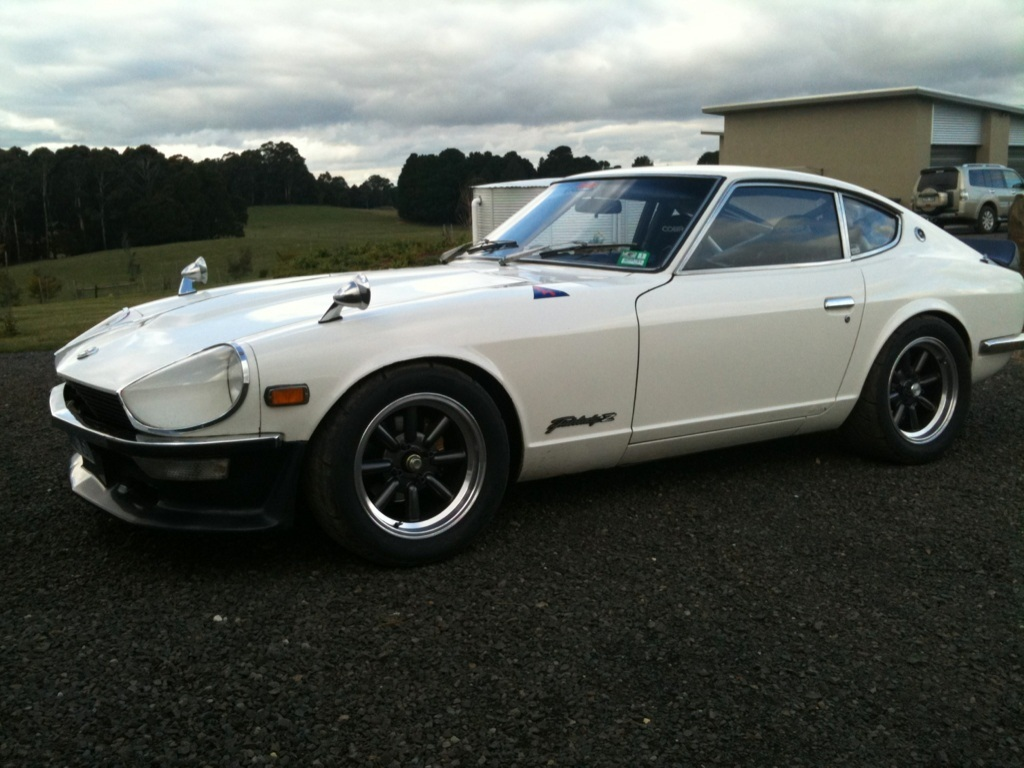

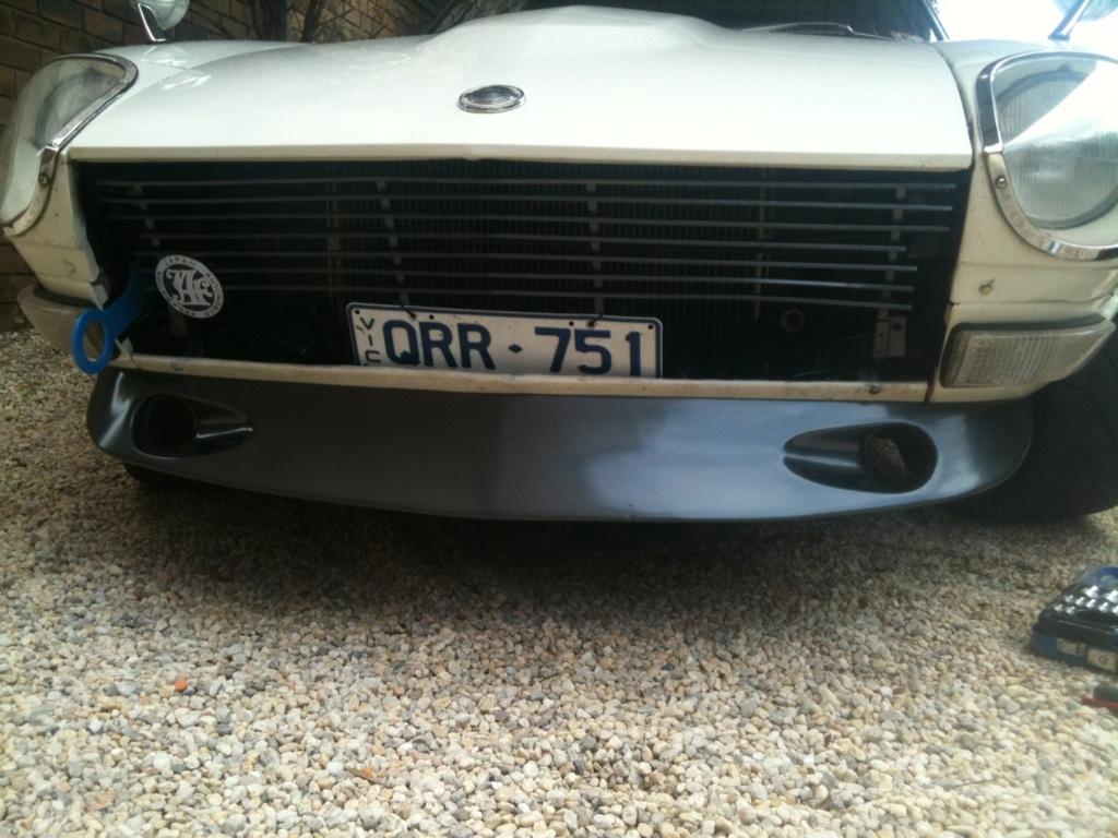

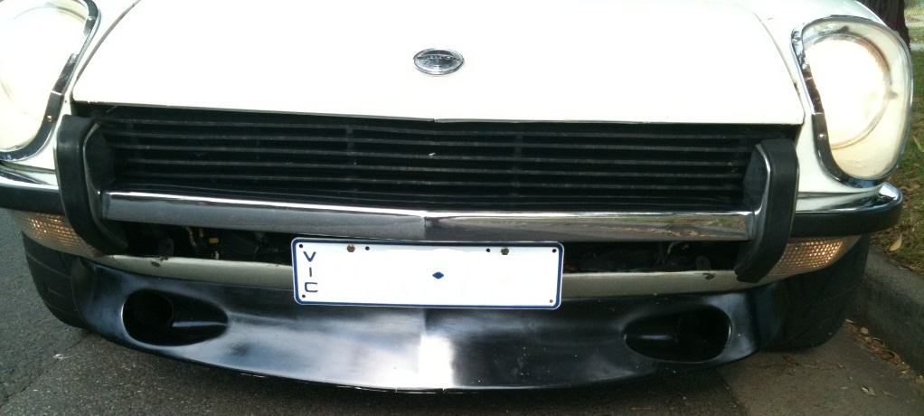

Did a few changes last week, New front end look. It's a rare JDM spoiler and the bumper has been removed, looks more menacing and classic at the same time. With the help of my bro we color matched front and rear spoilers and the rear light surround using BMW087 metallic gunmeatal.
I may refit the bumper, but it's not quite true and pushes the left gaurd/headlight bucket inward. It's always been a little wonky from accident by previous owner.

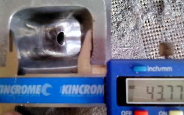

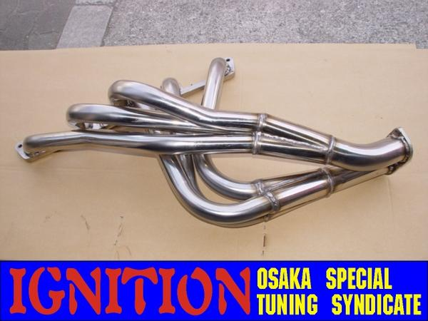

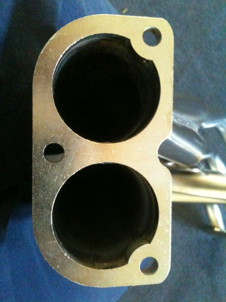

Had some goodies arrive in the mail, big and small. The big, my Ignition Dragon Headers, equal length primaries and all in STAINLESS  8) Oh Yeah! Pretty please Peter can you match port these to the head (they are 35x41.5mm roughly atm)  :-*

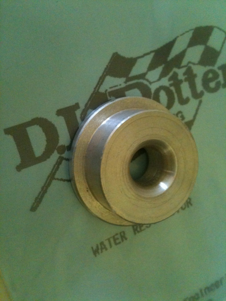

The small was a water restrictor from the late, great Don Potter... It's welded into the t/stat housing outlet and used with 190t/stat and deisel water pump it provides maximum cooling and optimum temp for the engine. These were used in the Bob Sharp racers in this configuration  :)

Here's the water restrictor too.
