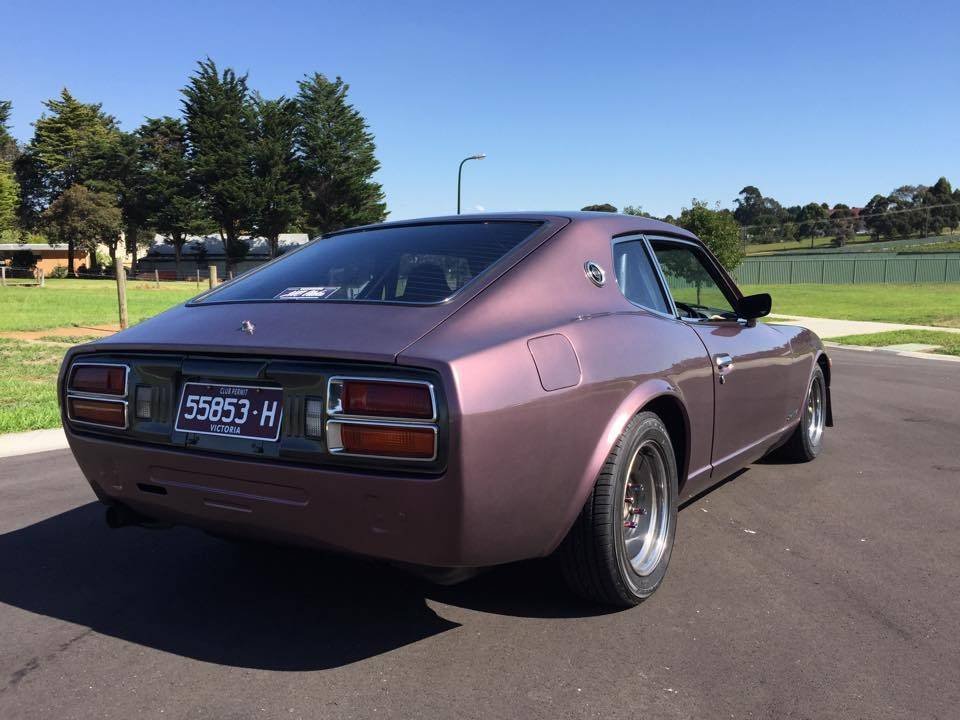

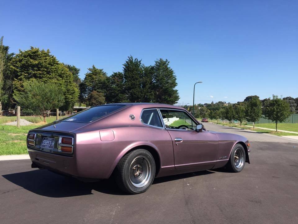

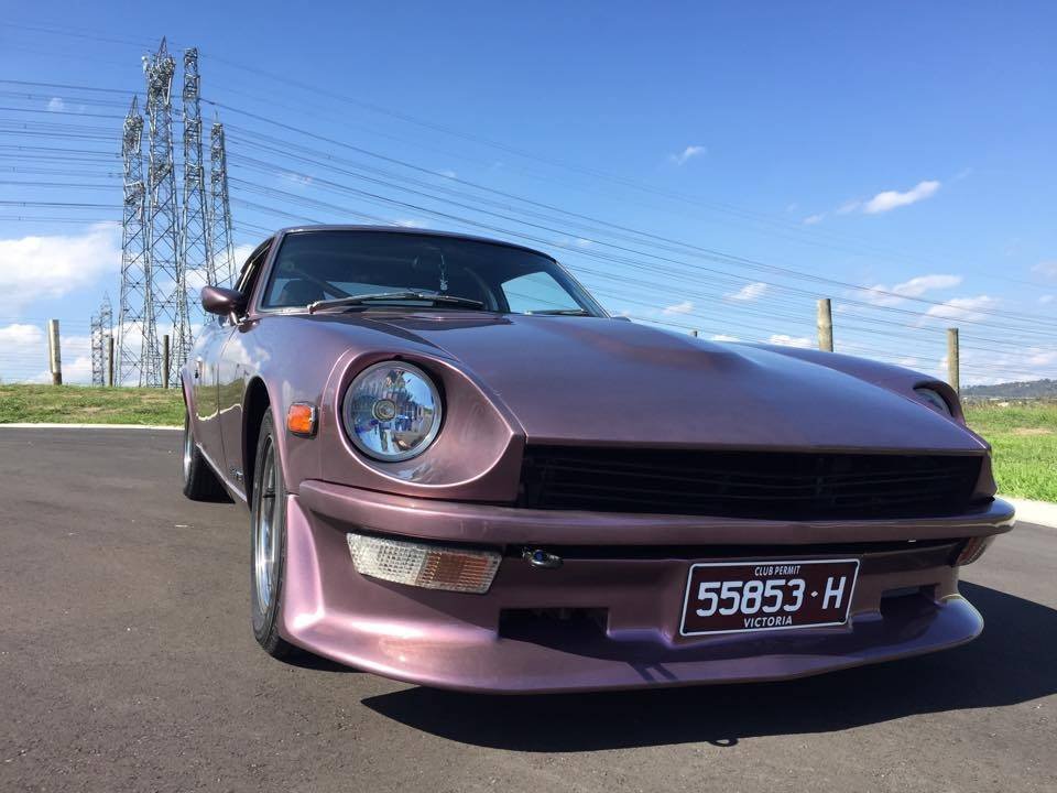

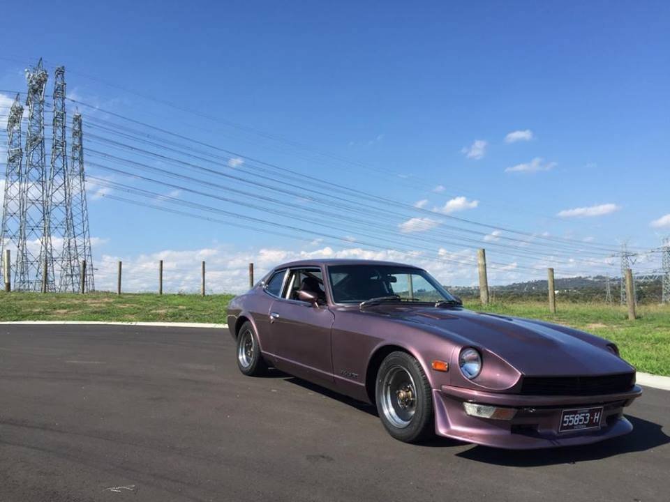

Administrators gav240z Posted March 10, 2015 Administrators Posted March 10, 2015 Cool good to have them on the road isn't it? You forget how fun they are and the attention they grab. Quote
reverendzed Posted March 10, 2015 Posted March 10, 2015 Looks awesome Bryan - great work! Who did you do your club reg with? Quote
bryan3976 Posted March 10, 2015 Author Posted March 10, 2015 Cool good to have them on the road isn't it? You forget how fun they are and the attention they grab. it is the best feel i waked up 100km on it that day .every one looks or trys to race you Quote
bryan3976 Posted March 10, 2015 Author Posted March 10, 2015 Looks awesome Bryan - great work! Who did you do your club reg with? its at djm getting a tune up atm .team tuffcore its just a group of mates that drift who opened a club so every one knows each other. Quote

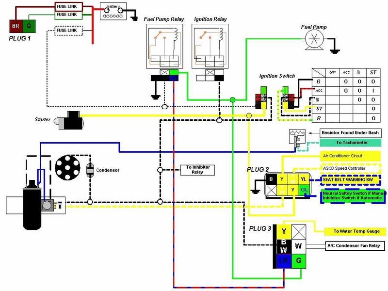

bryan3976 Posted June 4, 2015 Author Posted June 4, 2015 Some new shoes in 15x8 +20 front has nankan semi slicks and rears are skiders atm till i get some 255 60 15s mikys Im going to attempt fuel injection conversion this weekend as i have all the kit siting there. will be all stock kit then upgrading to a tunebale ecu with ls1 coils and bigger tb sr or xf with cable throttle. Thinking of upgrading my diff theirs a 4.64 ratio diff for sale atm would that be street able ?? Heres a diagram i found hopefully it helps but if any one has better info pls link me Quote

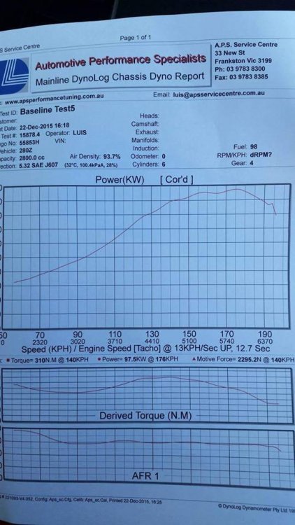

bryan3976 Posted December 23, 2015 Author Posted December 23, 2015 was time to get a tune on my frst engine build l28 n42 head with 68 deg works copy .40 over bore with dished pistons high flow oil pump stock manifold and cheap extractors i wasnt to happy with the power out put but was my firsst attempt at building a motor plan to try some new things in the new year with a modified intake and suggestions or tips would awsome .car drives amazingly now. Quote
Administrators gav240z Posted December 23, 2015 Administrators Posted December 23, 2015 Well done, home built motor? Quote
