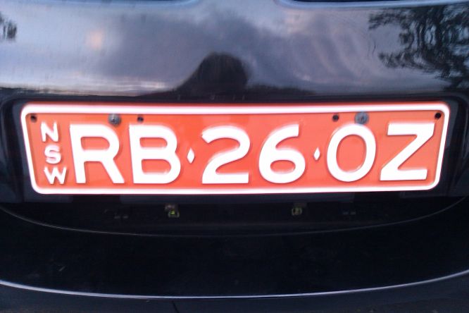

FLEXZED Posted August 31, 2011 Author Posted August 31, 2011 Hey guys received my birthday present from my kids yesterday, i think its quite appropriate for the car Quote
Sirpent Posted August 31, 2011 Posted August 31, 2011 BIRTHDAY ! How could I have missed that ! Happy Birthday Bro ! P.S. Nice Plates ! Quote
