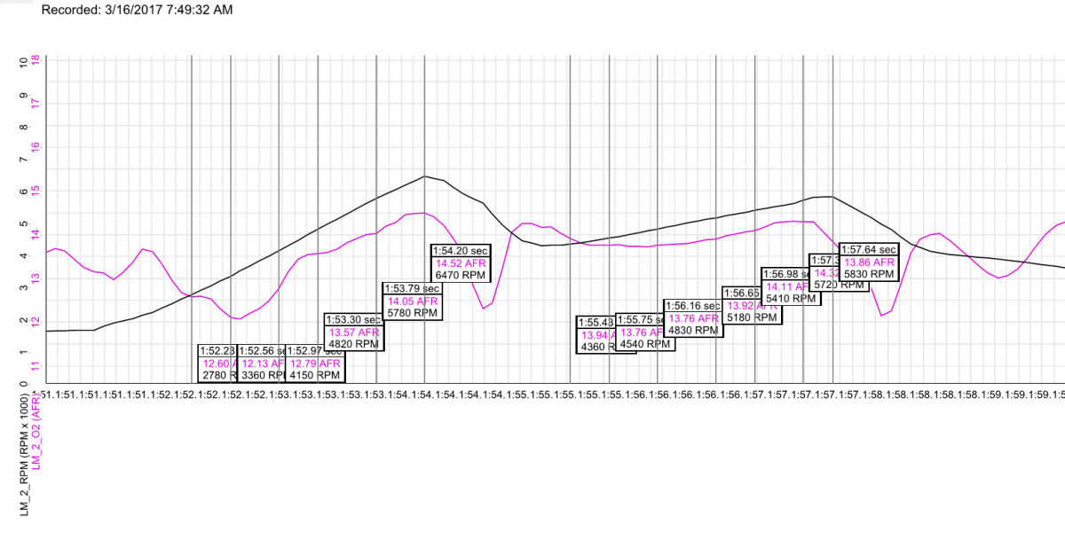

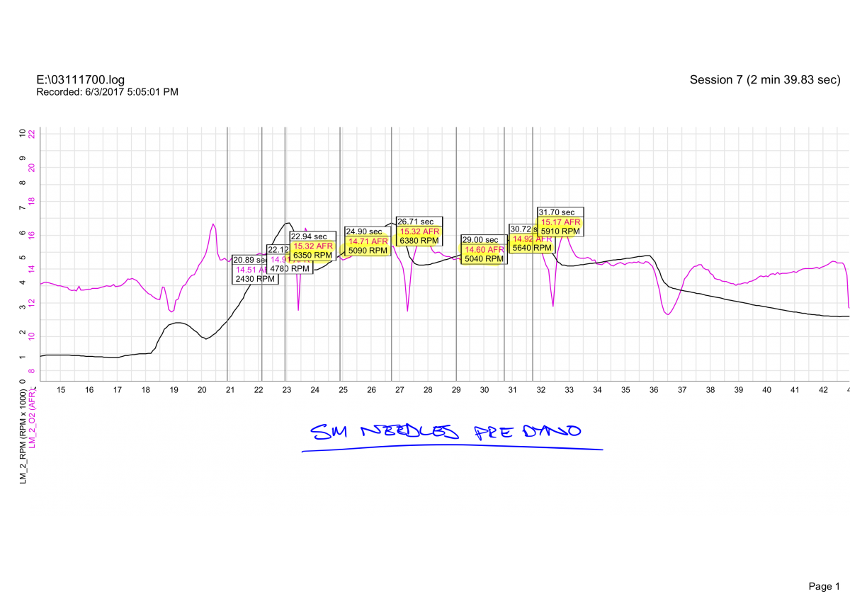

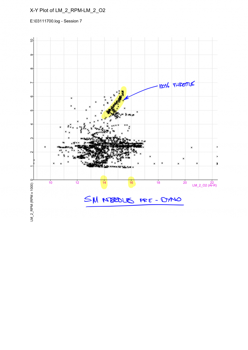

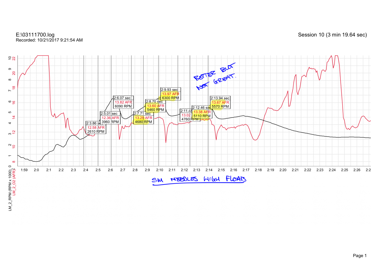

Aaron Neubauer Posted March 24, 2017 Author Posted March 24, 2017 I recorded a WOT run with the WBO2 and I'm pretty happy with the SM needles. I had the expectation that it would be rich as all buggery but it was little on the lean side which is not totally great for power but a fair compromise. Now all I need is to organise that dyno run! Quote

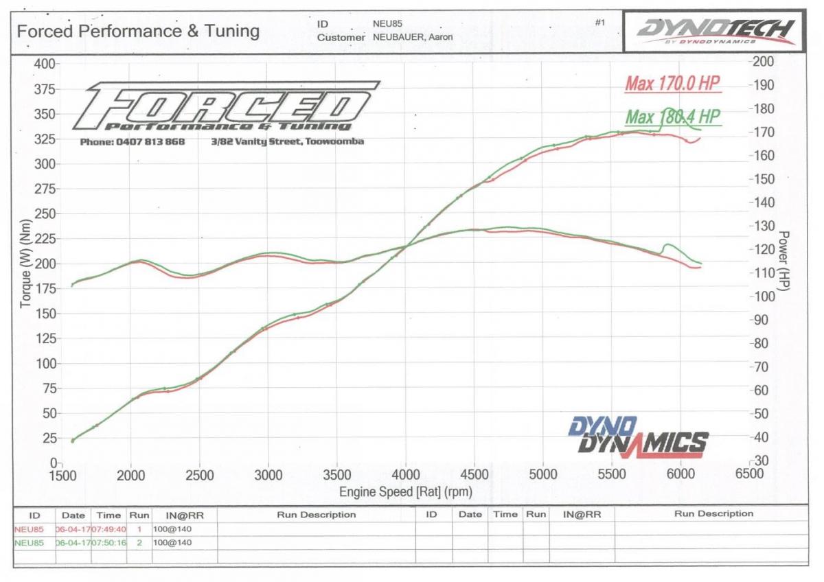

Aaron Neubauer Posted April 5, 2017 Author Posted April 5, 2017 170hp @ 5600. Not bad for a home built $5k stroker on stock carbs! Video to follow. Quote

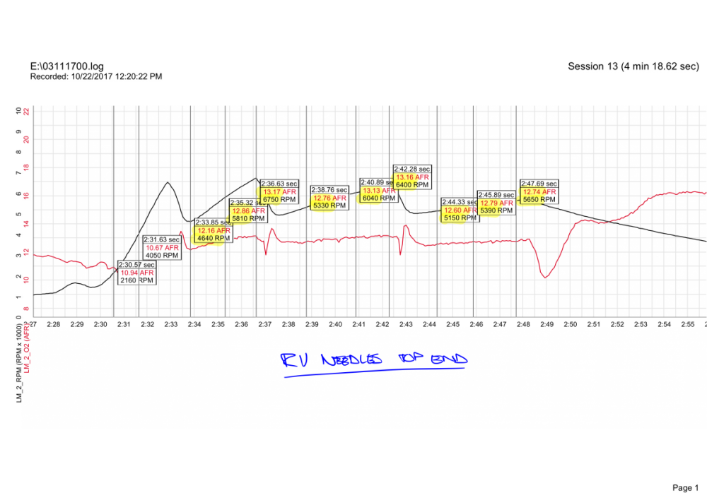

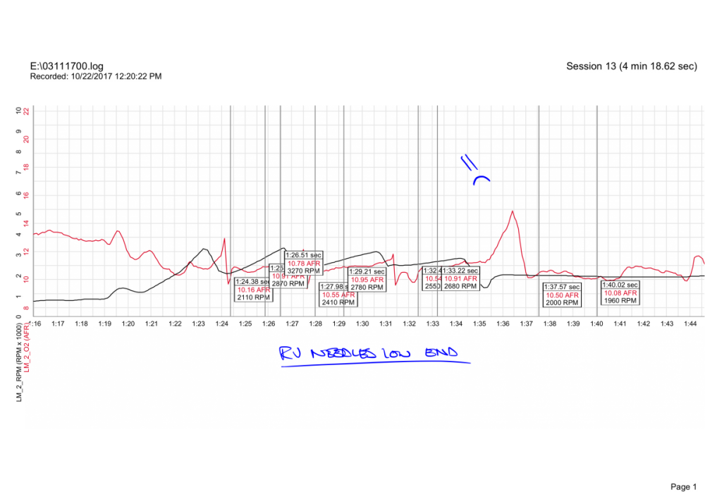

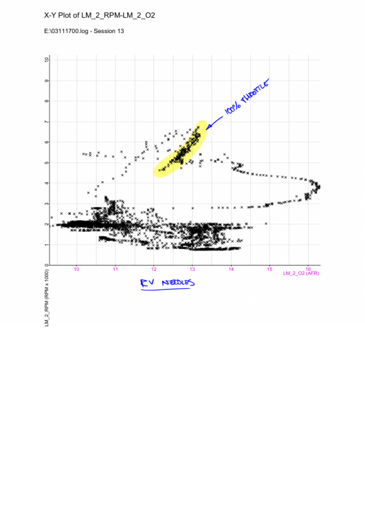

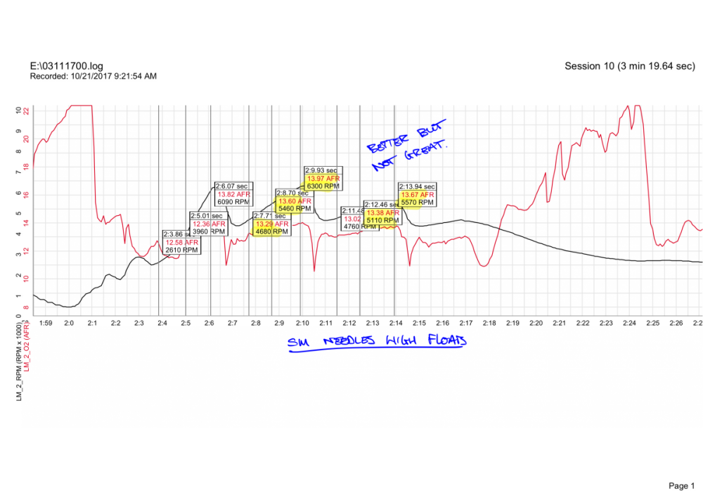

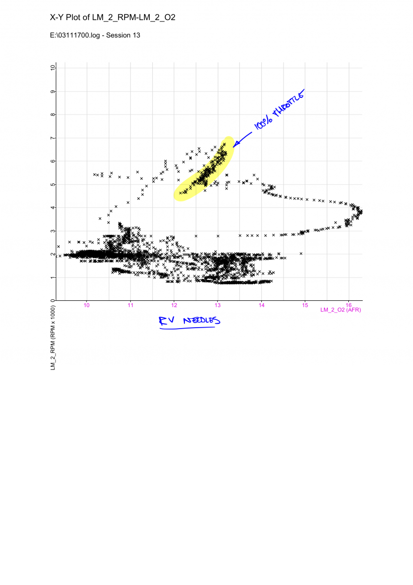

Aaron Neubauer Posted September 8, 2018 Author Posted September 8, 2018 Phew! What a hiatus! Since the last post only small changes have been made. The car survived the 4.5 hour drive from Toowoomba to Bundy in one continuous run back in April 2017. It used about 10l/100k which I thought was odd but put further investigation on the low priority pile. Upon checking with the LM2 the cruise to WOT section of the needle was indeed running very lean. I promptly ordered RU and RV needles to see if that would fix the problem. The RV needles got near perfect AFR at top end but cruise sat at about 10:1. Humph! I settled on a half baked band aid measure of lifting the floats up a few mm and sticking the SM needles back in. This made things a little richer (13.5:1 approx at WOT) but is not the long term solution I desire. If you plan to maintain the Hitachi SUs on your car yourself I can not recommend enough getting a ‘Float-sync’ tool. I’m not sure if they are still manufactured but they are bloody helpful when setting the floats! I got mine from here: https://zcardepot.com/carburetor-float-sync-tool-su-240z.html That was around October 2017. Fast forward to now, I am able to ‘donate’ more of my time the ol’ girl. I have set a goal to aim for 200RWHP on the SUs without opening the engine. I have a spiel on the plan on my YouTube channel which can be seen here. The three areas to focus efforts are: - Removing the recycled section between the Zstory headers and muffler and putting something better flowing in - New or custom needles for the carbs to get the AFRs where they should be - Muck with the advance profile in the dizzy. Currently the ‘all in’ advance is far to low. I’m thinking MSD 6AL-2 with locked dizzy or repurpose the MS1 I have on the shelves with a CAS. After all this is done it’ll be off to the dyno. If I don’t get 200 aitch pees I can always bust open the motor and port the head to the buggery, swap in a new cam or just admit defeat and put triples or EFI on it! gav240z and RAP260 2 Quote

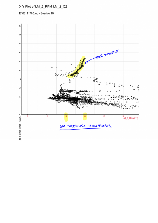

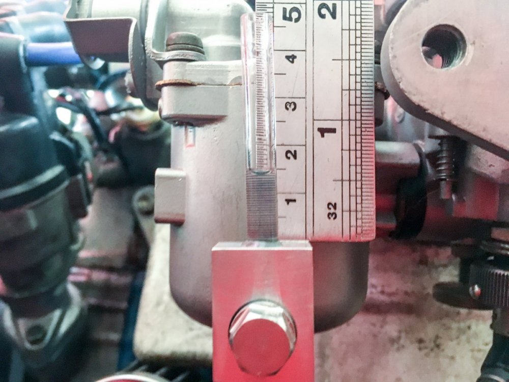

Aaron Neubauer Posted November 9, 2018 Author Posted November 9, 2018 (edited) Following on from the SB needle install I decided to adjust the float level to factory. Previously I had the float level a little higher as a band aid fix to richen the top end mixture of the SM needles. The rear float bowl gave me grief. I think I had the lid off 20 times before the geometry of the float was massaged so it wouldn’t stick in the bowl not closing the jet properly. I got there in the end. When you bending little metal tabs minute amounts you need a good swag of patience. Using the float sync tool and a trusty bit of clear pine dressed down to 9/16” thick the floats are set to the same level. The Nissan workshop manual suggests making one float higher than the other, presumably for G forces under acceleration, but I’ve never done this. Working on the 240Z is not the highest priority in my life (although I wish it could be!) so road testing and datalogging with the Innovate LM2 wideband will have to wait. Video below. Edited November 9, 2018 by gav240z Fixed embed. RAP260 1 Quote

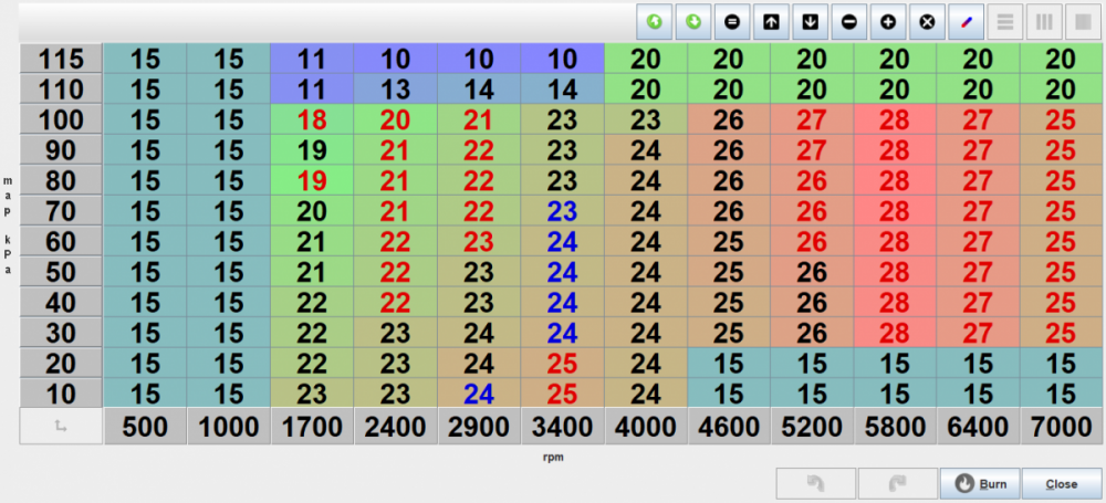

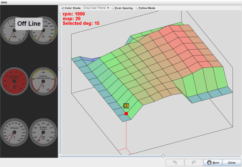

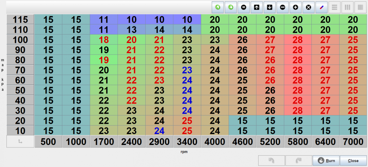

Aaron Neubauer Posted January 17, 2019 Author Posted January 17, 2019 I was able to play home tuner using Tunerstudio to set put the parameters and rough in an ignition table for the MS1. There wasn’t a lot to set up with an ignition only configuration, the ECU is pretty under utilised as far as it’s overall capacity. Even though the hardware does not exist for the injector circuits, I zeroed the injector table data. To bench test the MS1, I used the Megastim board and a syringe with vacuum tube for the MAP. A 60ml syringe wasn’t big enough to generate enough vacuum to get to the closed throttle parts of the map but it was helpful still. I had help from Godzilla Raceworks who saw one of my Instagram posts and offered up an example tuning file from an MS2 used on a similar engine. I’m very appreciative for their assistance. https://www.godzillaraceworks.com/ There are a few items I need to address before attempting to start the car with the MS1 and new SU needles. The vacuum line for the MAP needs a home on the intake manifold and the signal wires from the Pertronix unit need a little tweaking to introduce voltage because the Pertronix unit doesn’t generate its only power, its only a switch essentially. gav240z 1 Quote

Aaron Neubauer Posted February 9, 2019 Author Posted February 9, 2019 So the little niggling issues continue. While travelling to a local informal coffee and cars show I discovered a problem with the ignition timing. It felt like an ignition ‘wall’ at around 3,400 RPM. My first thoughts were it was something other than the ignition advance. I’ve had 36 degrees in this motor when it ran the tripled 45DCOE152s years ago. I just assumed the engine could take the same again. I was going to check the signal form from the Pertronix in the event that signal noise was causing interference. I wasn’t real sure how to condition an I/O type signal. In the end it was the ignition advance. When the table ramped up to 31 degrees at 3,400 RPM, the engine couldn’t take it. Trialing lower advance in the same areas of the table allow the engine to rev properly. I’m glad it was an easy fix and I am surprised that with running the SUs with SB needles that the engine characteristics changed. A new chapter has been added to my ‘book of Datsun’. Anyway the ignition table has been revised to lower advance levels and hopefully this will be a suitable base for some road tuning. If anyone has come across changes in ignition behaviour with different setup ups, I’d love to hear it. Quote
