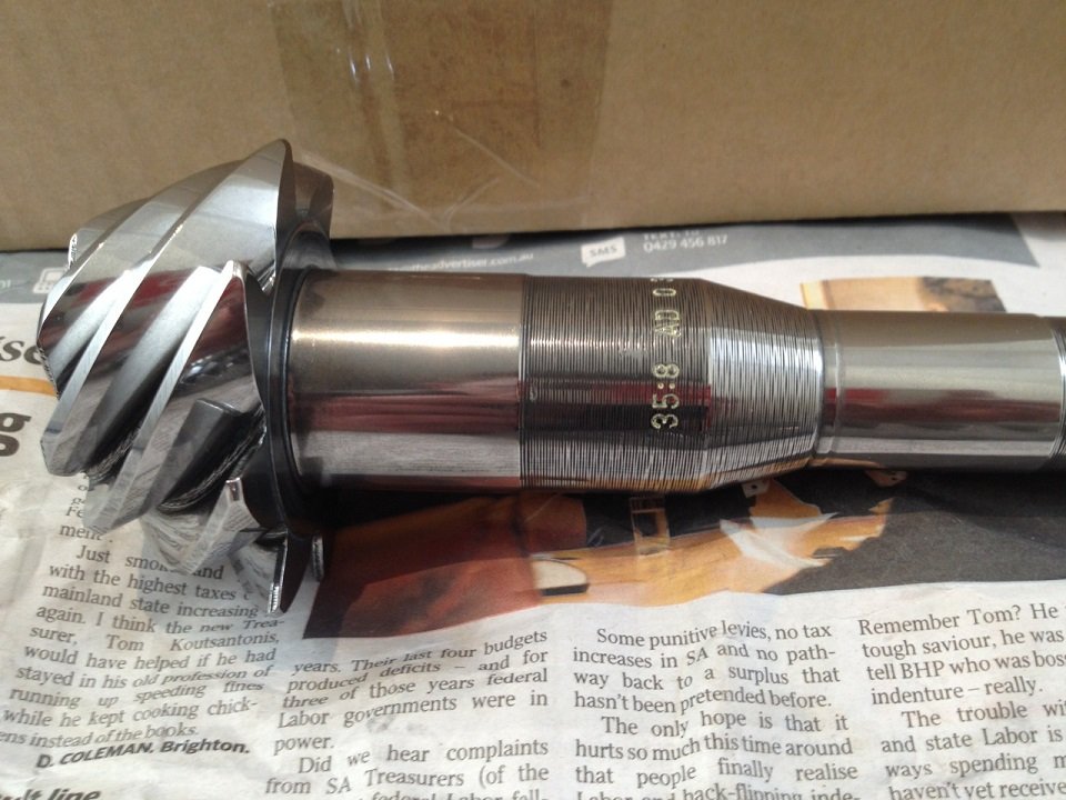

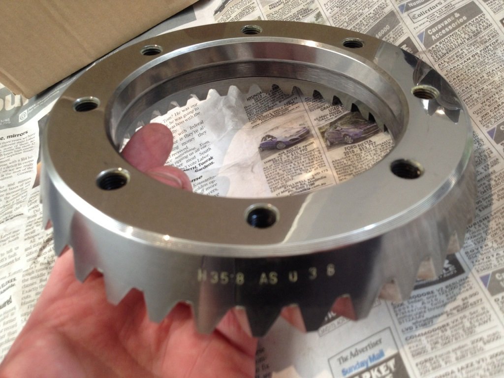

Riceburner Posted August 6, 2018 Author Posted August 6, 2018 Already got the crown wheel and pinion isotropic super finished. Makes for a whisper quiet diff. Ok WPC not required then, let the install begin, thanks chaps! RAP260 1 Quote
