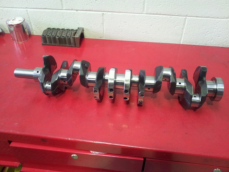

Riceburner Posted January 26, 2016 Posted January 26, 2016 It's probably one for Lurch. Looks as if the counterweights have had a little taken off the ends. gav240z 1 Quote
C.A.R. Posted January 26, 2016 Posted January 26, 2016 I don't actually know. At a guess: 1 - 2kg or so? Quote
Administrators gav240z Posted January 26, 2016 Administrators Posted January 26, 2016 Apparently an LD28 crank is 1 kg heavier than a standard L28 crank.Edit found this post from Nzeder.http://www.viczcar.com/forum/topic/5359-l28-crank-weight/?p=60553 So anything lighter than that has gotta be an improvement. L28 Crank = 20KG LD28 Crank = 22KG Modifed L28 in my old L30 = 19KG Quote
Riceburner Posted January 26, 2016 Posted January 26, 2016 Last two cranks I weighed were virtually the same, both cranks were standard size journals etc. The LD28 crank was 800 grams heavier. LD28=22.8kg's F54 L28=22kgs http://forums.hybridz.org/topic/100131-weight-ld28-crank/ Quote
Riceburner Posted January 26, 2016 Posted January 26, 2016 I don't actually know. At a guess: 1 - 2kg or so? That's pretty good considering the extra stroke! Quote
C.A.R. Posted January 26, 2016 Posted January 26, 2016 That's pretty good considering the extra stroke! Indeed, but the engine acceleration rate these motors have with the bigger stroke makes it inconsequential anyway. Quote
