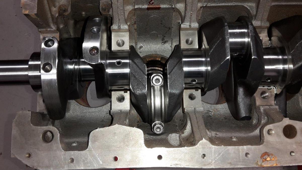

d3c0y Posted January 27, 2016 Posted January 27, 2016 What you actually need to take into account with any build is the incidental increase in cost for an item. To say an LCR modified RB crank costs $2700 is correct but the true cost is the biffetence between this price and the other option. In most cases this is reconditioning an old crank. By the time it's crack tested polished balanced checked for alignment etc etc (properly) the price difference to the RB option is probably not as much as it seems. Remembering also that you get a new crank. Another of the advantages of the 89mm option is the availability of very well priced high quality rods that retain a big end journal size that is robust. But each to their own. Not only that but the cost of all supporting components and machining required to fit such a radical crank... Quote
CBR Jeff Posted January 27, 2016 Posted January 27, 2016 Not only that but the cost of all supporting components and machining required to fit such a radical crank... Actually very little machining required. Nothing that a grinder in the correct location would not fix. The cost of (new) 6 forged pistons and 6 rods is much the same for a std build. That's the advantage of this option, the rods are commercially available and very reasonably priced. They come from a standard modern day high revving production engine that will rev easily past 7.5K. On the surface it seems quite complicated and the perception is its expensive but its actually not. Quote

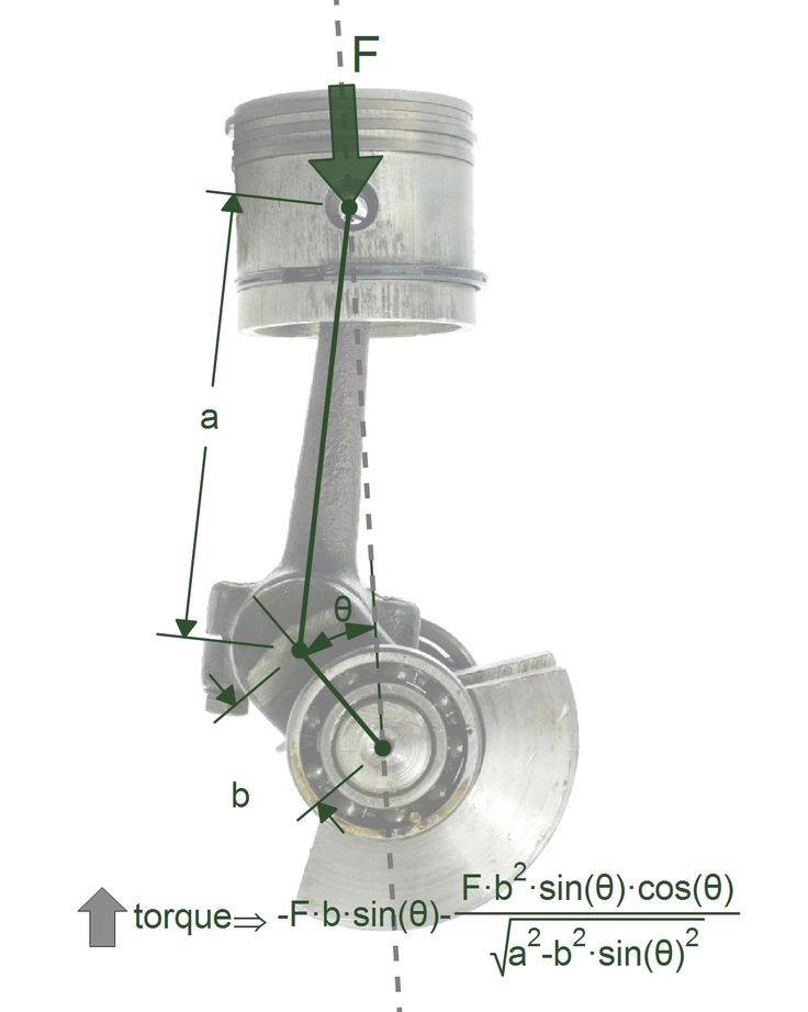

dat2kman Posted January 27, 2016 Posted January 27, 2016 Long/bg stroke = lazy truck motor. Ie torque mnster. A short stroke (79mm) with very lng rods, and "short" bggish bre pistons = fast response RPM demon. Two totally different ways to get a good result. If you study the diagram, and comprehend Rod length to crank stroke ratios, the resultant answer will indcate at where in the RPM scale, peak power will be generated, anything above that is pure in-effcency, e, change up a gear Quote
C.A.R. Posted January 27, 2016 Posted January 27, 2016 What are peoples thoughts on using a matching number L24 for a stroker build, use another motor and store the matching numbers away? CBRJeff is doing just that Mark - Les is building his matching numbers L24 into a 3ltr I was about to build something similar with mine, but Les had other idea's... If someone who has done this is willing to share what is a rough cost including labour and all that Of a block with said RB crank ? Minus induction, around $22k to $23k depending on options. Ask me how I know... d3c0y 1 Quote
d3c0y Posted January 27, 2016 Posted January 27, 2016 Actually very little machining required. Nothing that a grinder in the correct location would not fix. The cost of (new) 6 forged pistons and 6 rods is much the same for a std build. That's the advantage of this option, the rods are commercially available and very reasonably priced. They come from a standard modern day high revving production engine that will rev easily past 7.5K. On the surface it seems quite complicated and the perception is its expensive but its actually not. OK, yes just fitting the crank isn't that much more and it's a no brainer in my point of view to do that instead of a V07 as the costs are similar. But 50mm carbs, bigger exhaust, bigger intake manifold, billet flywheel all that stuff that goes with it to really take advantage of it. What are peoples thoughts on using a matching number L24 for a stroker build, use another motor and store the matching numbers away? This is what I did. Quote

d3c0y Posted January 27, 2016 Posted January 27, 2016 So that's a complete motor with cylinder head, extractors, sump etc. All you need then is 50mm carbs or injection, say +5k for a drop in engine? Mine was a lot more than that by the time it got to my door... and the Green Hornet is a step up from mine. Don't forget engine dyno time and all the other little extras that go into it. Plus then you will instantly destroy your stock gearbox and then you need to upgrade your tail shaft, UNIs diff etc, etc. I thought that the stock gearbox would be ok for a bit, but when I say destroy i mean the engine literally destroyed it in basically 10 outings, none of which were in the hills or at a race track and more like test and tune trips around the streets to iron out the bugs. Les said the box would have suffered catastrophic failure at any minute if I had kept driving it and the internals were completely unservicable when i sent it down for exchange. Quote
