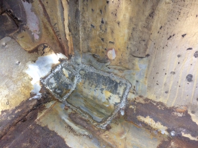

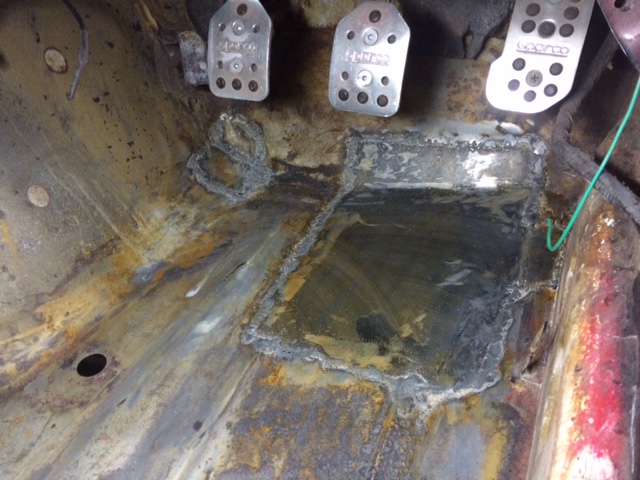

Found any rust in the floor Rev?
Pretty happy with what I have found - yes some rust in front passenger and drivers side but pretty minor - I will cut it and plate - everything else is 100% solid.

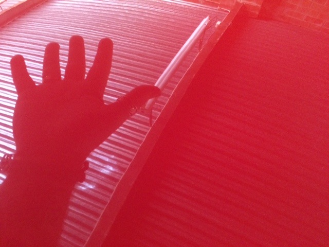

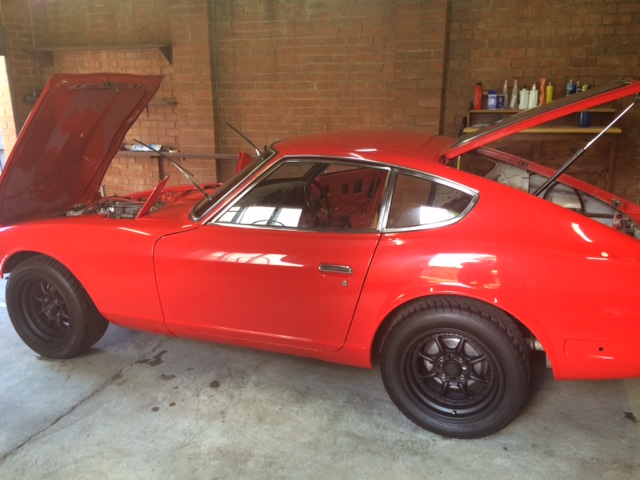

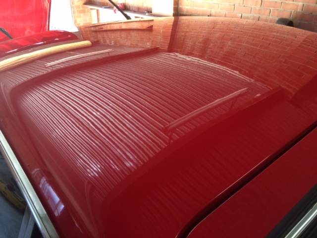

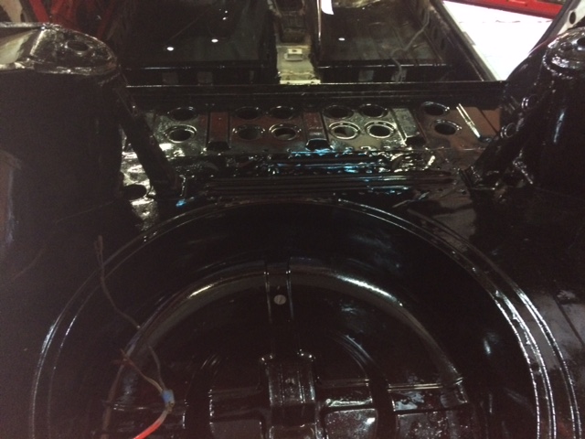

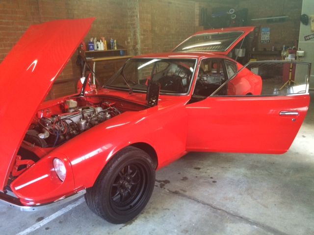

Getting the Zed ready for a 3 stage polish - should lookalike glass when it's finished - Got all of the POR15 done so interior is nearly ready to install!

@Rev - it already looks polished? :)

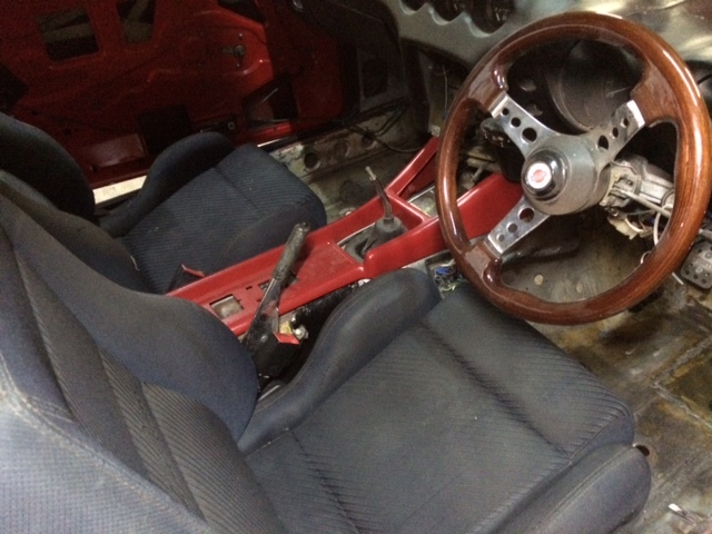

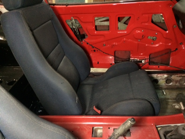

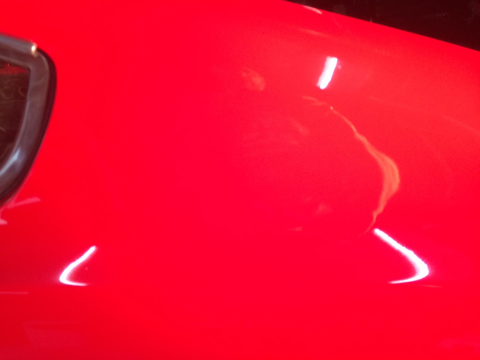

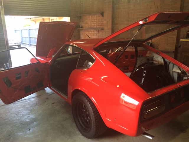

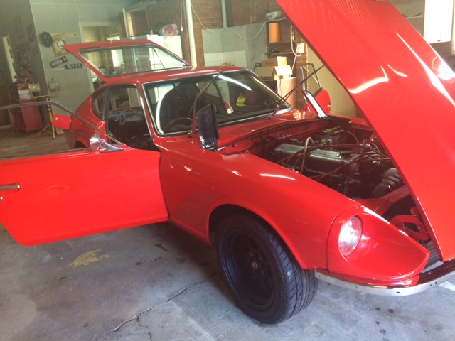

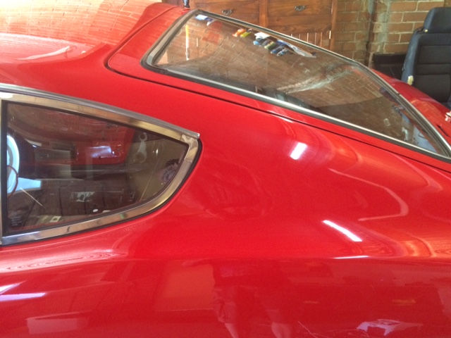

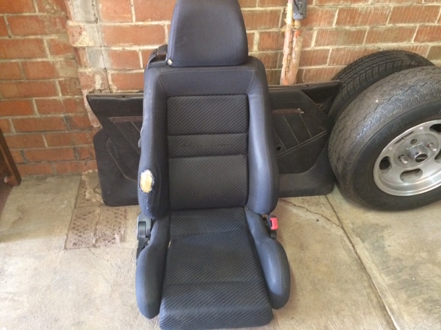

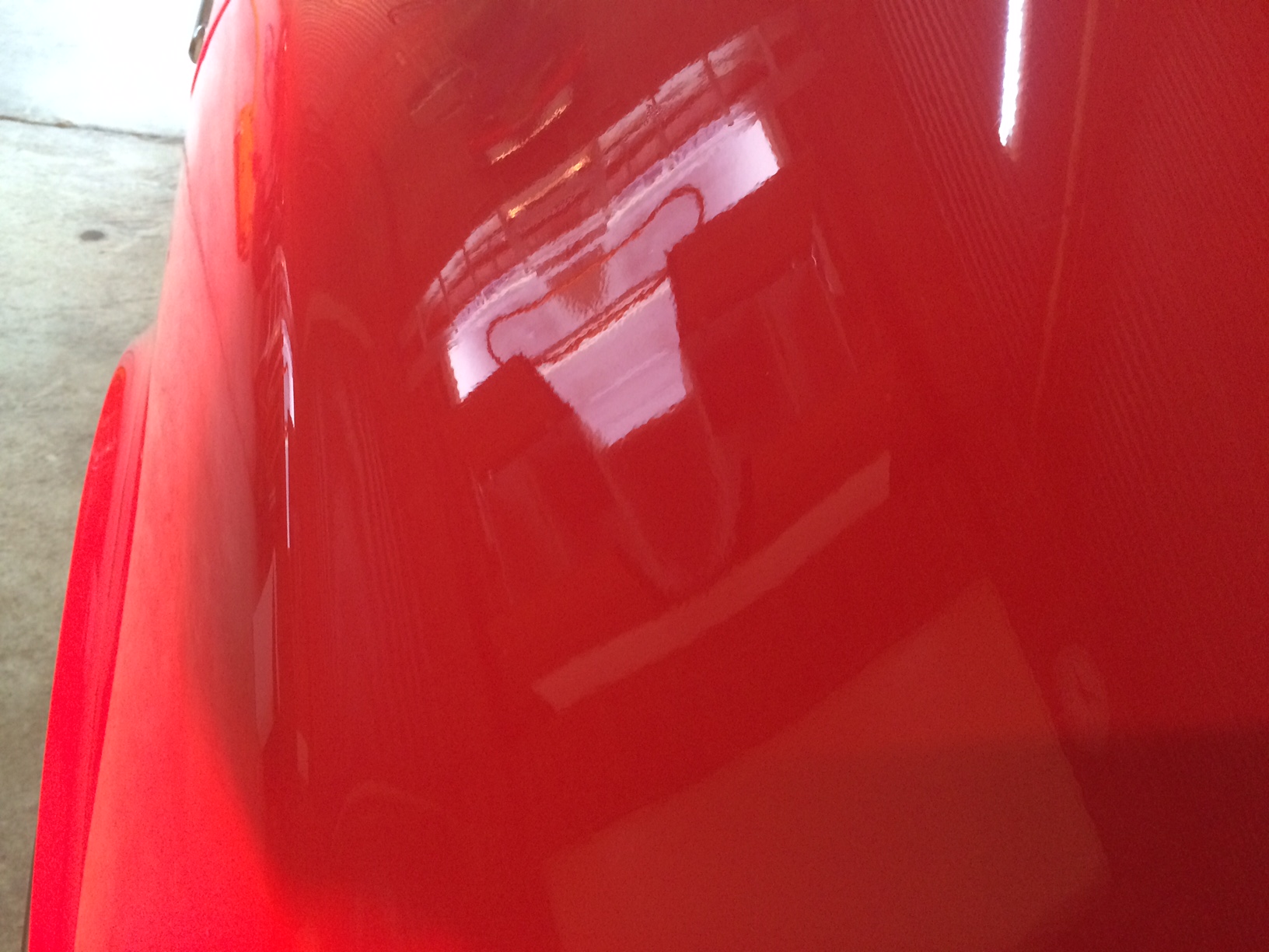

Few more polish pics and just picked up some seats from an Alpha GTV Spider which are a perfect fit - just need to make some adjustments for the rails and get them reupholstered in black leather with diamond inserts.
Love your work Dave, that finish is awesome. I recently bought some P21s and was amazed at the difference when I waxed the Pulsie compared to the Meguiars stuff I used to use.
Yes I'm curious to know what products and techniques are used also.

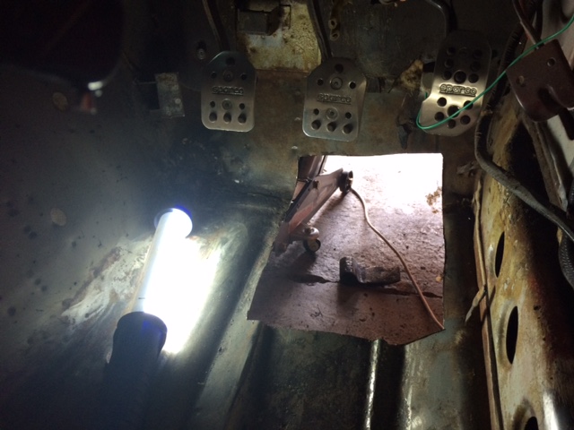

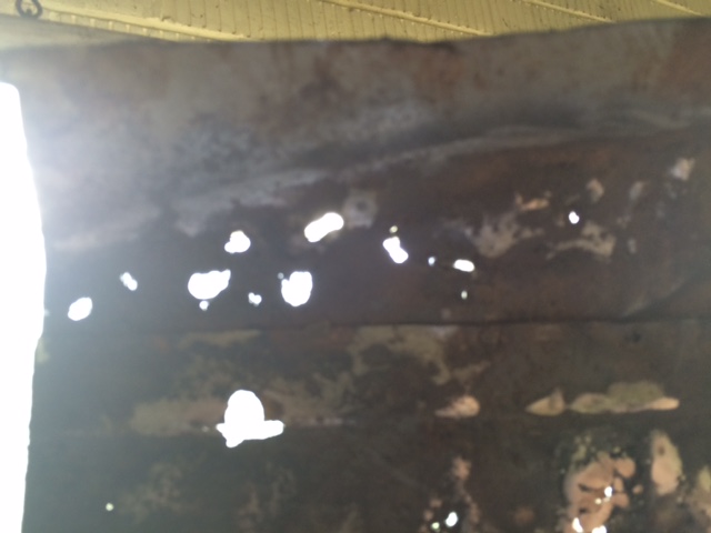

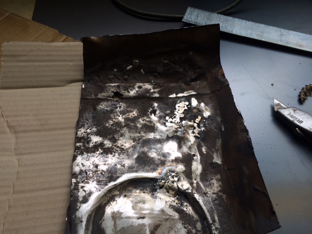

I've been battling some pretty significant health issues lately - but today i had a better day so thought I would tackle the nemesis of rust in the both the drivers and passenger front floors - once I started I just knew I had to finish!  Also had a quick test fit of both seats and they are perfect size for the Zed - just have to re-engineer the rail placement.  Next is interior, seats retrimmed, diamond vinyl, carpets and reskin dash (that one might have to wait!)
