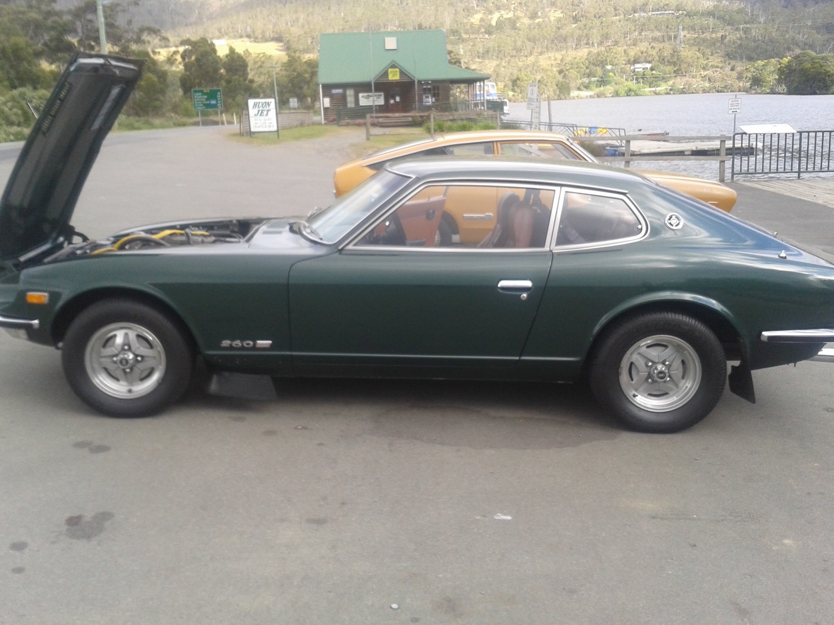

WogsRus Posted December 15, 2014 Posted December 15, 2014 Well it has been 5 years search but finally i found my zed. Ok so its not al original but more on that later. Is a two owner 1976 2+2 with an ex Targa race prepped L28 with early E88 head and a cam. It use to run triples but has stock SUs on it. The car has been resprayed after a restoration and is immaculate for age. I have been through the whole car and its just superb. I know it has the wrong bonnet but hay, so be it. It goes like scalded cat and over all supper happy seeing as i paid what i believe to be a bargain price. I have been over and under the car and it has no rust issues, original pristine floors and rails, guards etc, even the original rubber mat near the filler cap. Even has original books and tools. So anyhow, just saying hi and i am back. So now the Z will join the ranks of my little 120y coupe in the garage. Quote

Administrators gav240z Posted December 16, 2014 Administrators Posted December 16, 2014 Why do you say the bonnet isn't correct? Seems correct for that year to me. Looks like a great example, whatever you paid was cheap compared to the cost of restoring 1 to that level. Good colour combo the biscuit and green combo. Quote

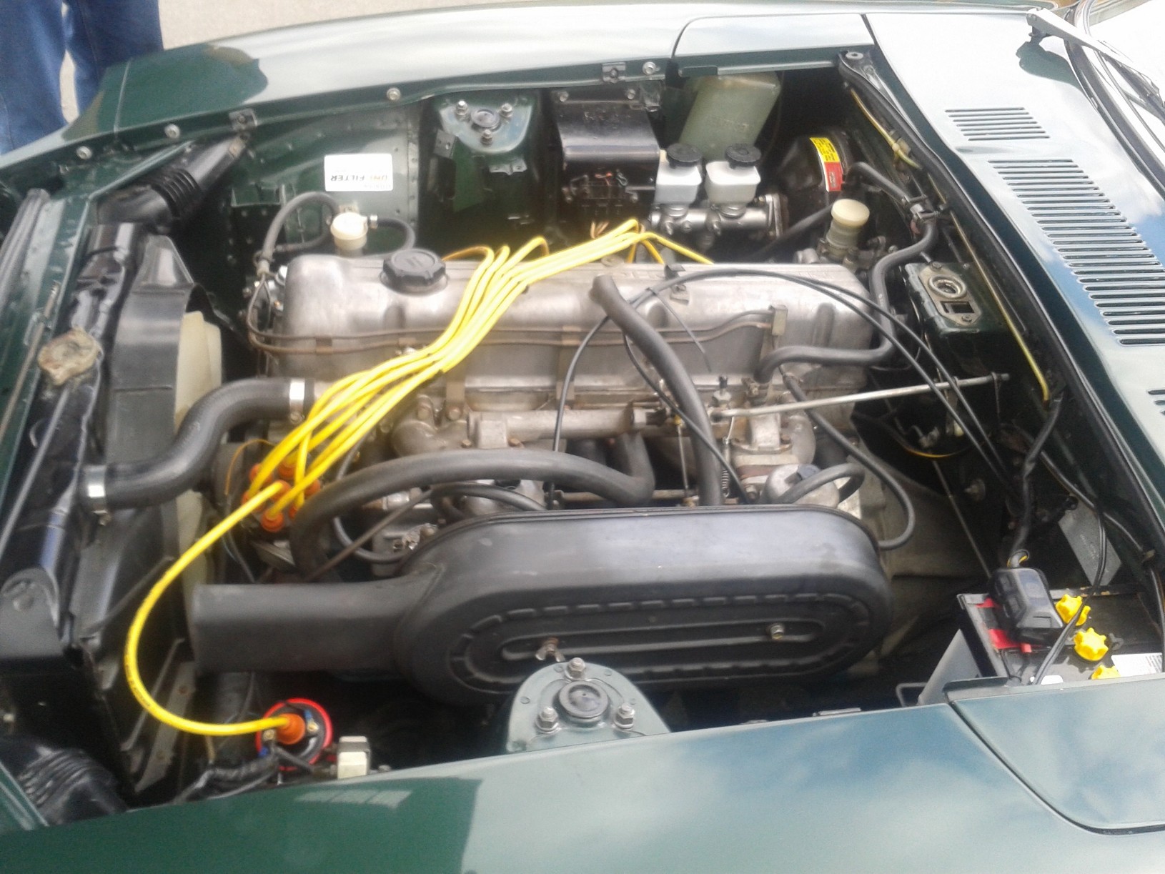

WogsRus Posted December 16, 2014 Author Posted December 16, 2014 what do you recon its worth and what i should have paid for it? So far i need to get on top of a weird miss that happens, like ignition but literally the whole ignition is new, all of it, new coil, leads, sparks, points, rotor, capacitor you name it, all new. One thing i found, it runs like 18 deg static timing by the timing light, i think it might be re curved dizzy when the engine use to run triples? What should i look at. I did check the plugs, clean but a bit lean i think, i have three bolt early carbs, how do i richen them up? Quote

Moderators Zedman240® Posted December 16, 2014 Moderators Posted December 16, 2014 Great purchase there for 10k. Work alone on a body done properly is more than that! I'm with Gav, bonnet looks to be correct for that year; late 76-77 cars got the fluted bonnet and later door latch / catch. Is it a miss or flat spot? Does it cough and splutter or just drop in power? If the SU's don't have the larger needles, it may be running lean when it needs more fuel? Perhaps get a youtube video of it to help explain what you hear... Quote
WogsRus Posted December 17, 2014 Author Posted December 17, 2014 Zedman240 The car coughs and shudders like instant stop, i will see if i can get it on the phone and then post it up on youtube. I have no idea about Su and the like, other then they are 3 bolt. I will do my best and thanks for the assistance Quote

oldmates260z Posted December 17, 2014 Posted December 17, 2014 The SU's do not look like the ones off a 240Z, they do not have the long neck. May be there is a setup issue. There was another thread a few years ago with the same issue but I cannot find it. May be a partially blocked fuel filter. Quote
WogsRus Posted December 17, 2014 Author Posted December 17, 2014 so i went through the whole ignition, wd40 everything, re-gaped and checked wiring., I found that the ballast resistor wiring was cracked at the terminal wire thus when hot it could have broke down. The coil seams nice and cool now to touch which i don't recall being last time. Took car for a drive,seams ok bu down on torque so spark must be less. I am installing a brand new L24E dizzy from my brothers old car he has, its a genuine Nissan one so that might help. In regards to the carburetors, they say SU on them but who knows. Quote
WogsRus Posted December 17, 2014 Author Posted December 17, 2014 Also, the timing marks are 20 deg at 1000 rpm it wont really idle lower steady, no idea why. if i set it to say 7, it simply does not pull and brakes down a lot, simply will not drive, ideas Quote

Lynton Posted December 18, 2014 Posted December 18, 2014 Check the fusible link is not letting you down, that is one sweet machine, lynton Quote
