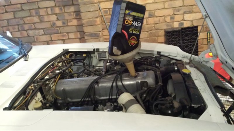

New blood

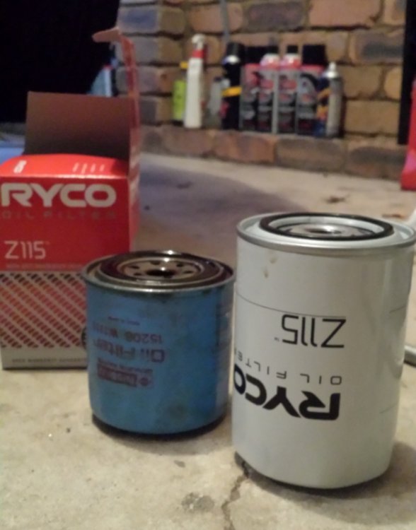

New filter, you can see the size difference

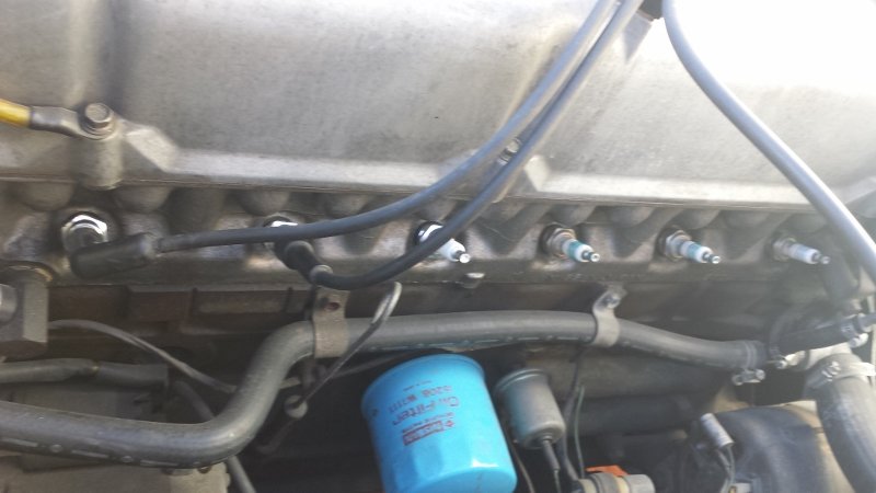

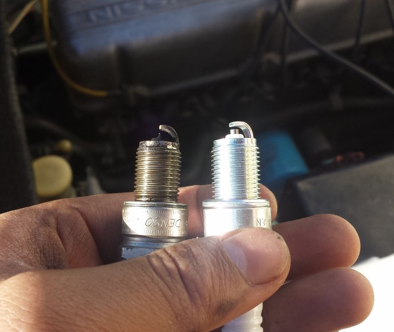

New sparkies
Purring like a kitten

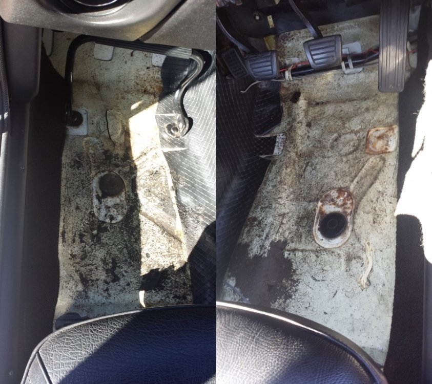

Surprise surprise, found some notable rust on the floorpanels
Driver's side has a little surface rust but seems ok otherwise. Passenger side has big crack in the paint, looks fine from the undercarriage, does this warrant some preventative action?
Also, is it worth getting those fancy blue ignition leads I see people get?
That stuff on the floor is sound-deadening, you wouldn't know how bad the rust is (if anything) unless you removed it. It looks pretty minor if you can see under the car - you should be able to check how solid the floor pan is. As for prevention, if the car is garaged I wouldn't worry. If you want to be really thorough you could remove the sound deadener and rust proof floors.
As for fancy leads, it is up to you. You probably won't notice any difference in performance. NGK leads are the best if you can get them, they also fit on the little tabs on the valve cover properly (Top Gun leads don't fit the plugs as snugly and are a bit fat for the spark plug holders on the valve cover).
You could look at the ones Eiji from Datsun Spirit has that routes them around the front of the cover.
http://datsunspirit.com/?wpsc-product=dsi-spark-plug-wires
If you're looking to 'dress it up'.

While the Penrite HPR15 is probably fine to use - I would recommend HPR30 for your future changes :)
Cheers mate, will do :)

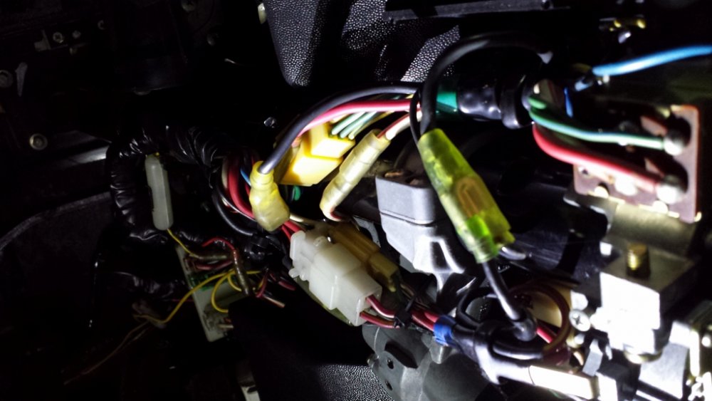

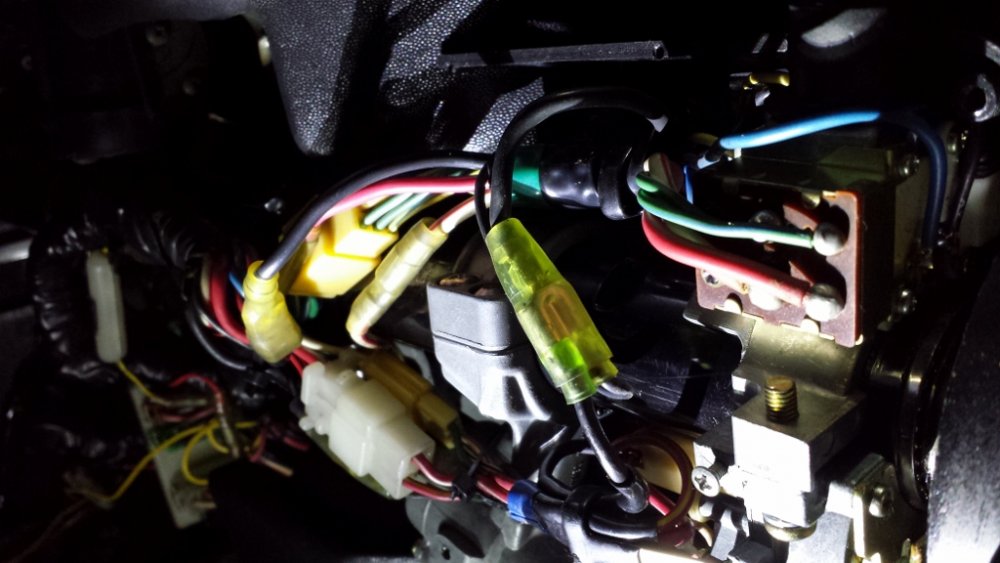

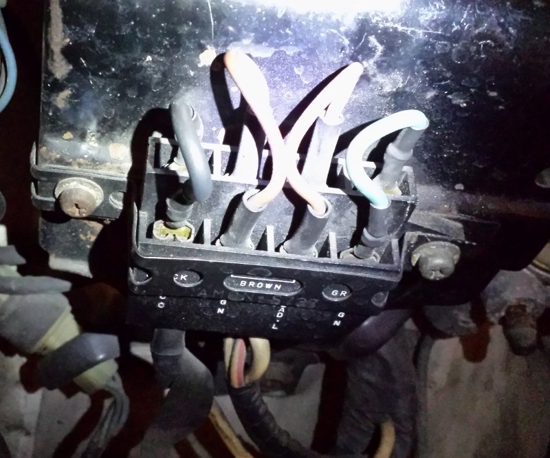

I took a photo, Jiggling about the switch didn't work :(
I think the lights might have come off after I pressed the flash to pass button, both headlights & hi beams do not work. Should I take out the switch altogether? Which wires & connectors should I be checking?

I don't have a test light unfortunately. I only checked under the steering column so far. I'll get to the fusible links next. If still giving me grief I'll buy a multimeter for more troubleshooting.
just popped out to the garage to take a photo of my fusible links next to the strut tower
are these the ones I should be testing?
yep should see power on both sides on the terminal post might need ign on they can look alright but no good inside one of them is the headlights
