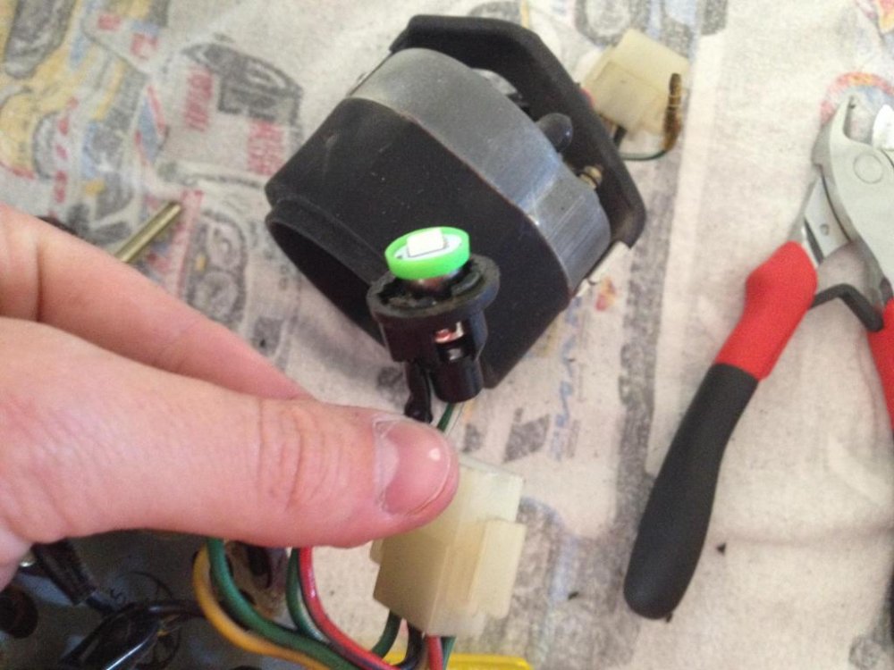

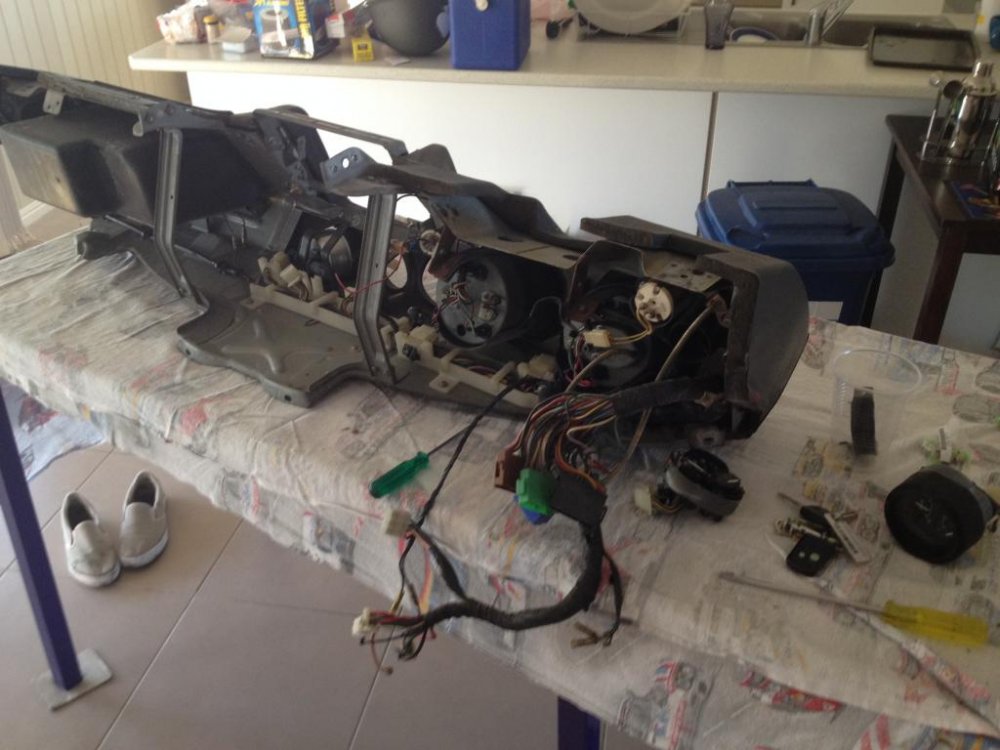

but in the mean time i have started my LED light upgrade for my dash. and agood time to chase up mystery wires and also wire in my hazzard light switch also.

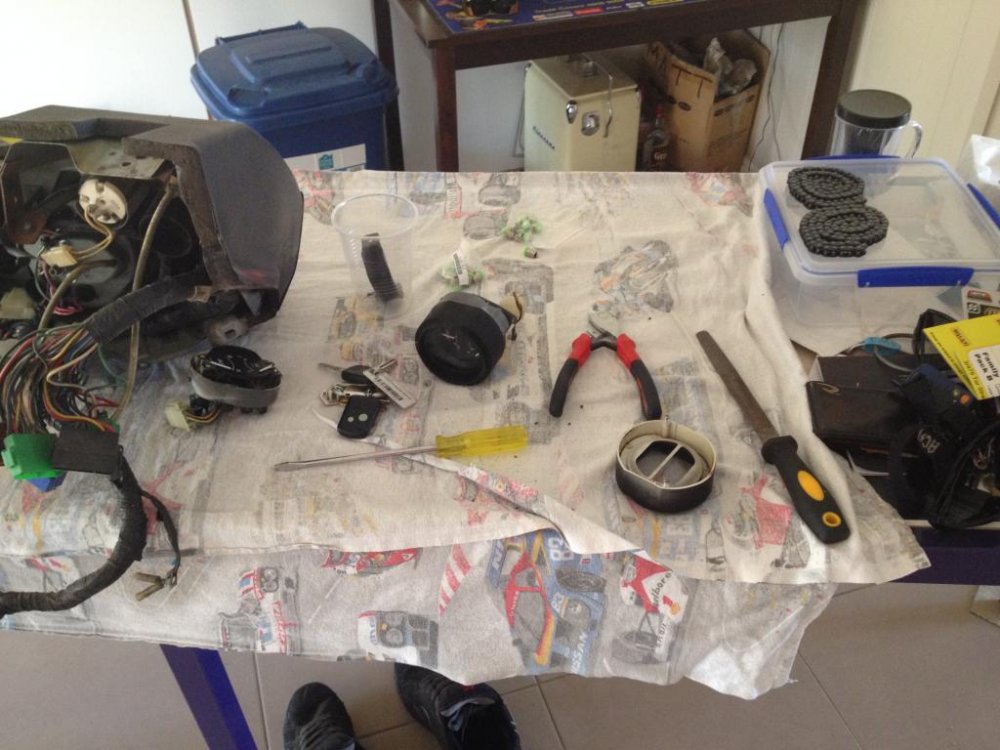

I needed a decent work space so i moved my operations in to our entertainment room and use my beer pong table.

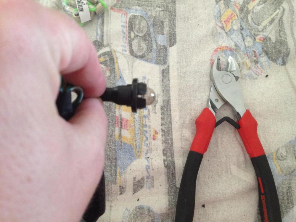

Now the new LED bulbs fit but the housing/clip needs some modding to make it all fit together, this is what i started with.
And this i what i ended up with, it looks like ive cut too much off but i couldn't push the bulb into the socket properly so it had to be done, i plan to use alittle bit of hot glue to hold the bulb in the rear of the gauge properly.
so hopefully it should all be done sometime thru the week and it will work, fingers crossed!
i went with green Zedman even though ive got the green lens cap on the gauge. had thought white but im trying to keep it some what period correct. my last plan of LED stripping didnt work as the remote to select the colours was stuffed but for 20 bucks i wasnt expecting much. im hoping ill have it shorted by friday night so ill chuck some pics up then

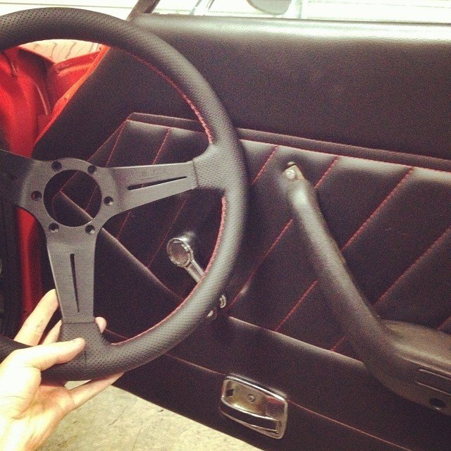

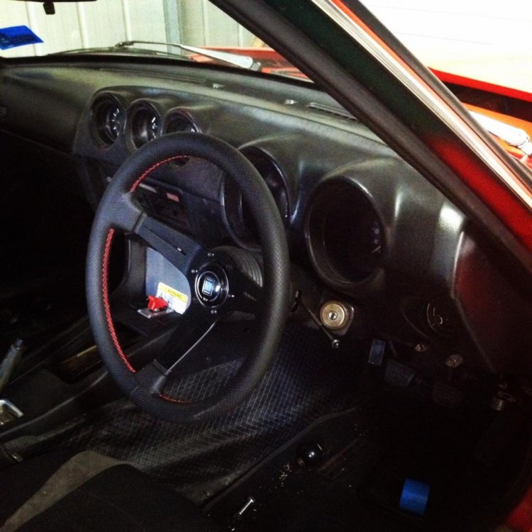

well i finally got back around to the zed with my nardi steering wheel a friend picked up for me whilst he was in japan for $285 all i need now is a boss but it should tie in well with my door cards
i still have yet to get her tuned proper so i can actually drive her again, for once my missus is actually giving me shit for the zed just sitting there and not spending enough time on it but hopefully its soon

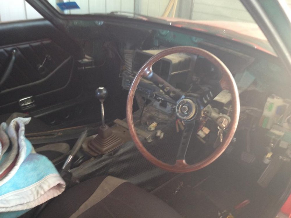

Then what happend next i didnt expect. i turned the key on and no dash lights and some of the gauges werent working( no big issue really as i want to replace them wirh newer ones)but i had no head lights indicators or brake lights. so for the third time the dash came out and the dash wiring inspected as well as the loom under the dash and a multi metre was poked and prodded to double check all seemed fine. with the dash back in it appeared now we had majority of the dash lights and cluster lights for high beam and all that. upon closer inspection we found the plugs to the steering coloum were loose and the ignition barrel was in upside down  :-[
after fixing that we had both head lights and brake lights working and indicators when they wanted to work  :-\  every thing seemed to be all perfect till i noticed the bushes on my shifter are a bit past her used date so i might replace her with a solid nylon piece to eliminate play. i also noticed that it seems to be missing bushes either side of where the gearstick bolts up to the selctor but i can all sort that when she drive able and work out the best combo that suits me.

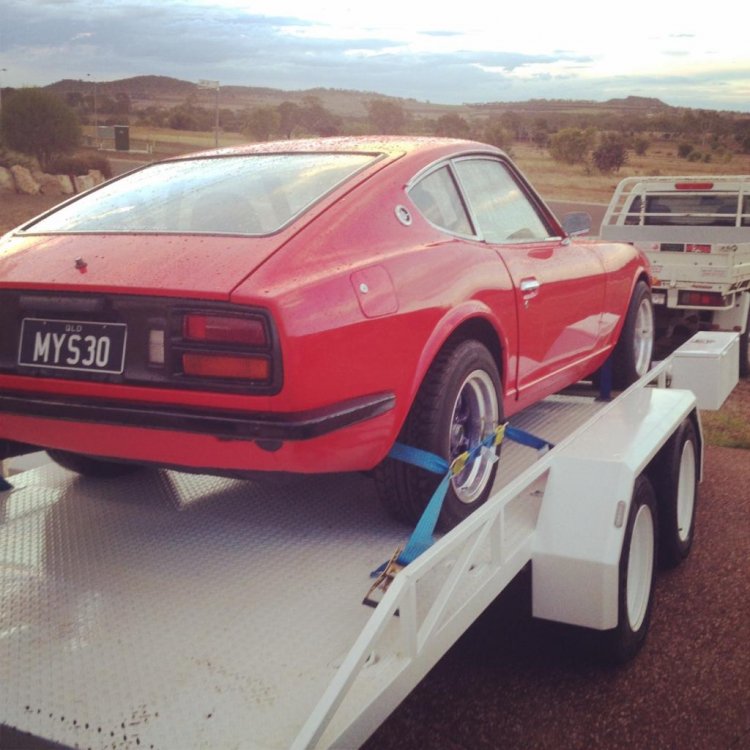

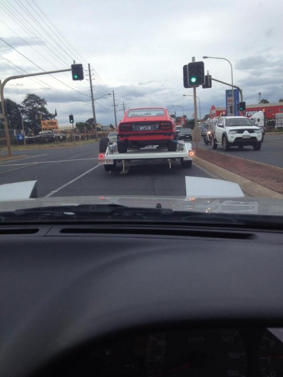

after finishing up saturday arvo i get a call from my mate with the car trailer, it appears the axles have been spinning on top of the leaf springs cause the flat plates werent welded to the axles.... so you can guess how i spent my sunday morning :( but in the end we got her fixed and sorted and the Zed was on the trailer in no time.
This picture i took here
is the second time and last time i will ever see my Zed on a car trailer  ;D

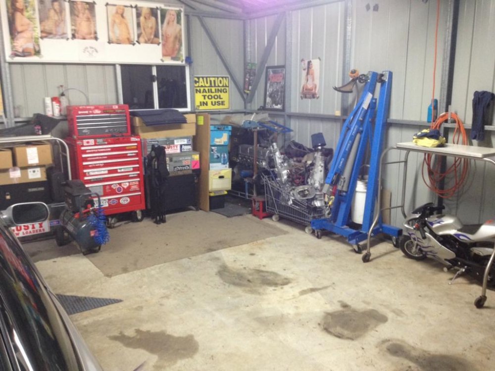

they only benifit with the zed away was i got to sort out and clean up the brothel i call my shed hahaha
doesnt look clean but its a shite load better than it was.

I love the Nardi wheel matching the door trims - should look a treat, keep us updated on the outcome of the tuning session.

pretty easy Gav but it makes it a hell of a lot easier to do with two people. i think we had the dash out and back in in around 15-20 mins thats with out the cowel and fan vent facia but. dunno bout your factory looms but mine were pretty easy to identify once extra wires were removed. just a matter of making sure i pluged it in the right way lol

but the nardi...
just looks the part, ive only got the nardi horn button just sitting there as the clips need modifying to fit but i love it :D

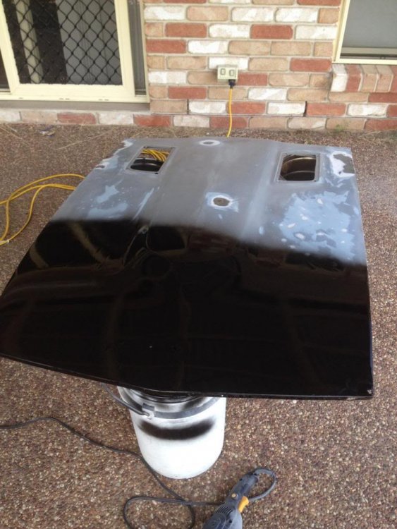

I also picked up a series 2 260z bonnet from a guy who's friends with another mate of mine who just happens to have a 240z with a L28 stroked to 3lt and simply wanted to get rid of the bonnet as it was only going to be chucked out any way
it's got a bit of cancer in the front and towards the rear corners but is easily fixable.... dont know what ill do about vents at this stage but when ive finished repairing and painting the bonnet ill go from there.... i know shes not much but give me a few weeks and she'll be like a stream line butterfly  ;D
