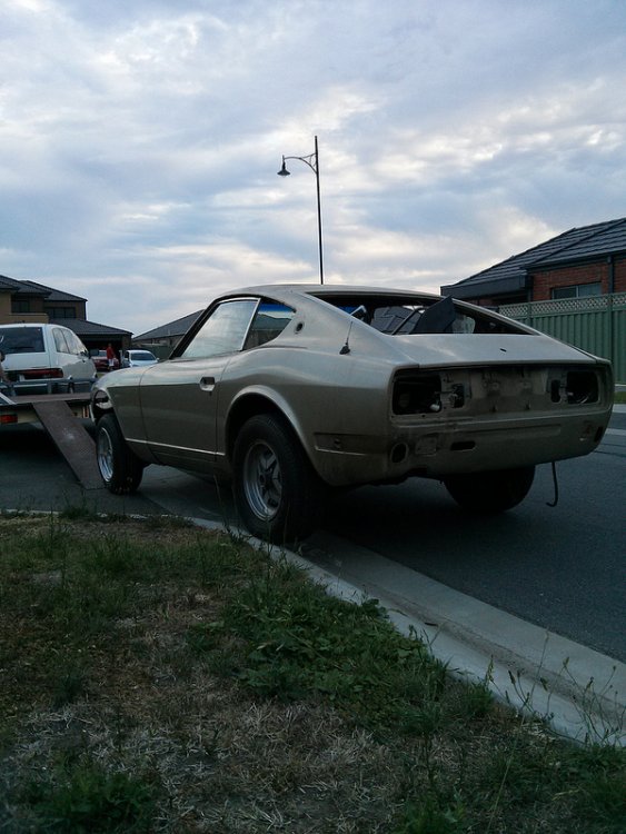

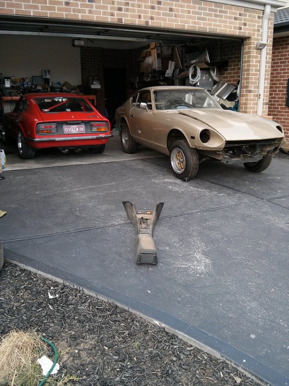

Welp, first off big thankyou to Dimitri for selling it, my friend for somehow being enough of an idiot to drive with me from Adelaide, to Melbourne, pick up a car, turn around and head straight back, and everyone around Adelaide that I asked for their thoughts.
I will be posting detailed photos to my flickr at:
So there will be much more detail there, but too boring to post everything to the forum
Sitting with Dimitri's 240z:
Ready to head back:
Who said a 4cyl can't tow a car trailer?

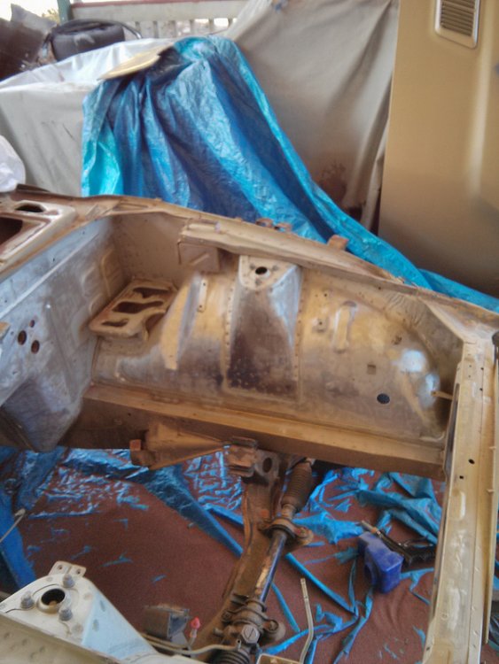

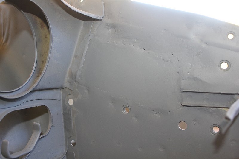

Had a good poke around back home. Very good on all accounts, here's the worst of it:
And from the inside:

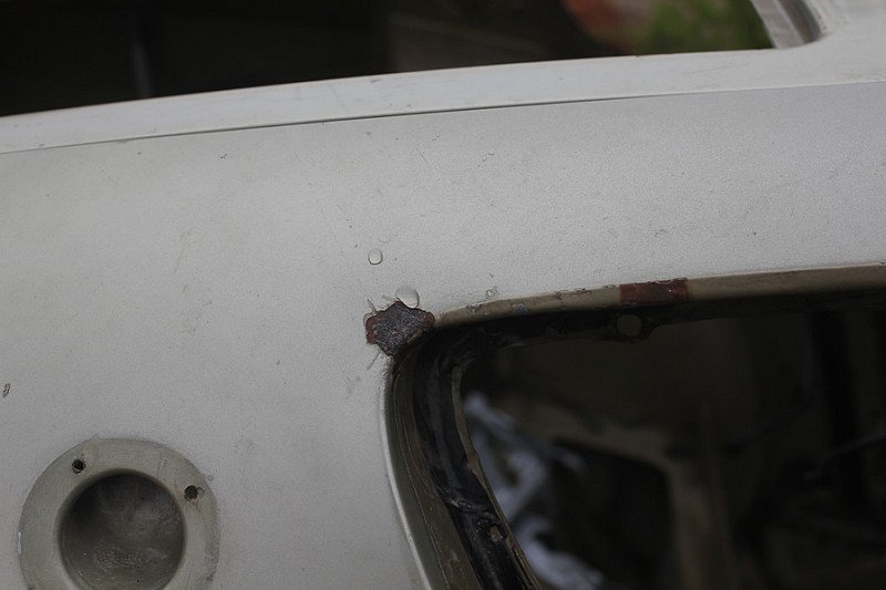

Doglegs have been previously repaired. Not sure how the inside of here will look. Probably worth finding out before paint gets done, just in case. Anyone have a camera that can fit in here or something?

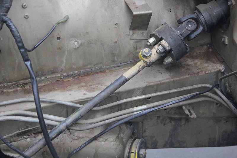

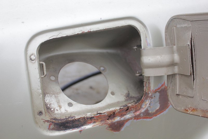

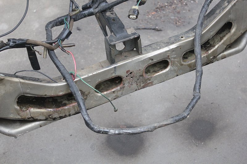

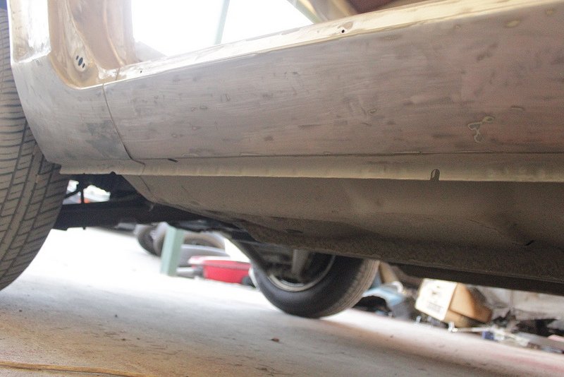

A few spots like this around the place
And a bit of surface gunk on the rail
Can see a few holes appearing in the middle of the lower section, so will chop and replace that area

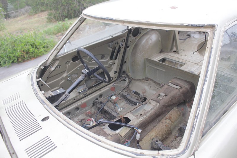

Windscreen seal area is sweet

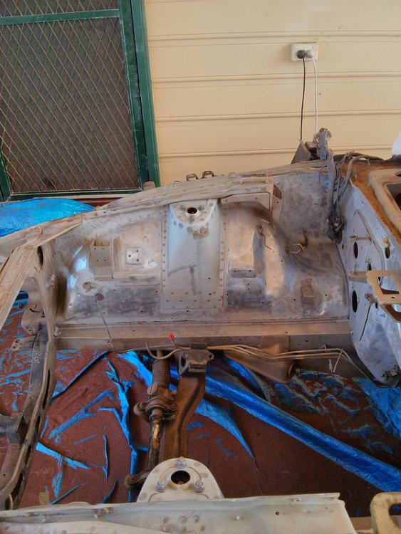

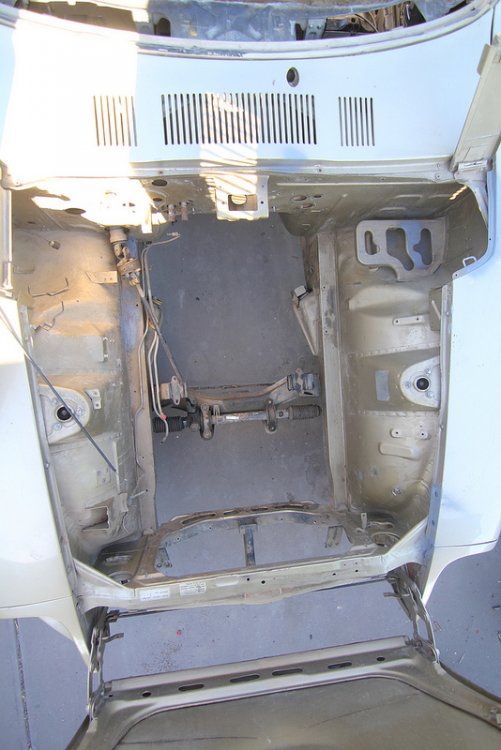

Engine bay overview
All those surface spots have been pulled back to bare metal and just hit with some primer for now.

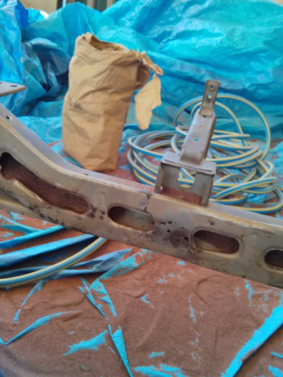

Bought a little sandblasting gun and a bag of media and got to work. Mostly used strip-it discs for the flat areas because my compressor struggled to pump out much more than 60psi consistently. So going was slow. Can't touch it again till the weekend because I stay away from home during the week to save me like 10 hours commuting to uni.

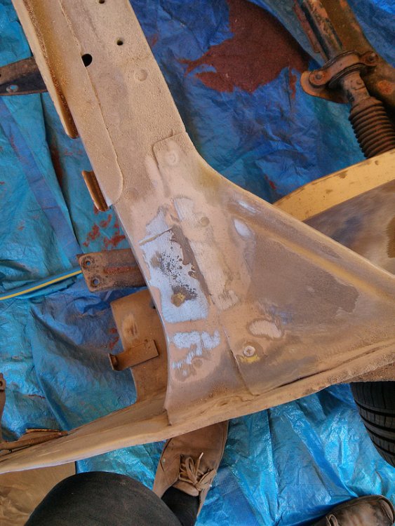

Uncovered two nasties, one of which needs attention with an angle grinder and new metal so a little bummed about that but it was to be expected.
Some bog was covering this, looks like it has been dormant for quite some time. Looks like surface crud that has pitted.
Here's the area that'll need cutting and replacing.
Need to finish stripping the rest of the rad support, a bit left on the rails, the windscreen cowl area and where the fender bolts onto (stupid nissan plugging up that single drainage hole there ... wtf). Then etch prime all that.

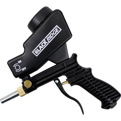

seems to go well post a pic of the blasting gun. Where did u get the media from and ow much? seems bit courser than mine.
Nice work, overall looks like a great car. Very little rust really. Oh and those Toyota Tarago's have more torque than you would think, my mum used to have 1. Carried all kinds of car parts in the back lol, 2 motors at 1 stage.
Blaster is one of these bad boys
Media is pretty course. Though due to the relatively low pressure, very little heat is made so I don't think any problems with warping will happen whatsoever. Will be using strip discs carefully for big flat areas anyway since they're a lot faster/less mess. Blast just in those inaccessible areas. Got a big heavy bag of it for $40 from a blasting place about 5 mins away from my place. Go through it so damn quick though! Not much fun. Won't complain about blasting prices ever again heh.

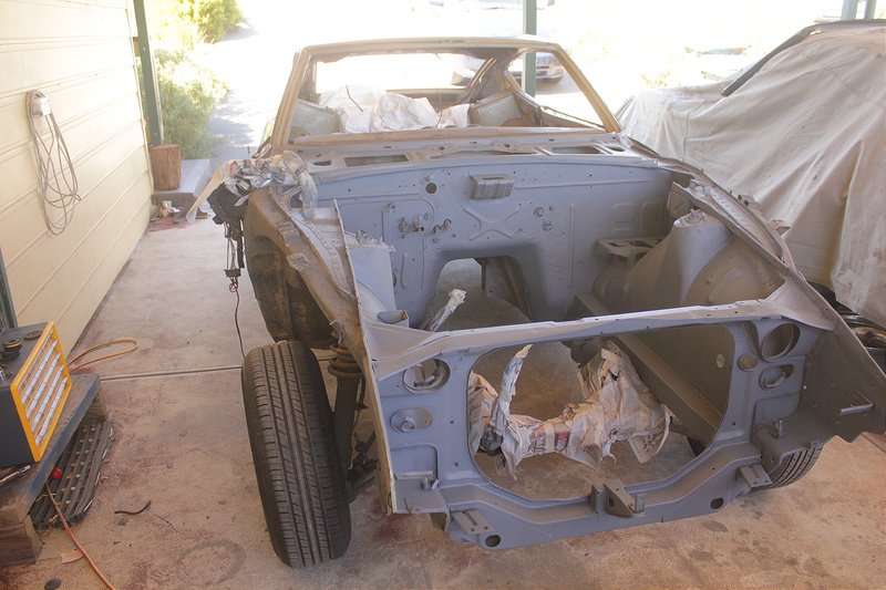

Bought me some wattyl super etch on many recommendations and the engine bay is now etch primed.
From here, will need to cut and repair that section on lower rad support, cut and replace that part on upper rad support:

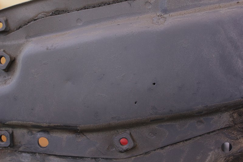

Not sure how well I trust them. There are some pinholes poking through as you can see... Might be worth pulling it apart and making sure everything is sweet...?

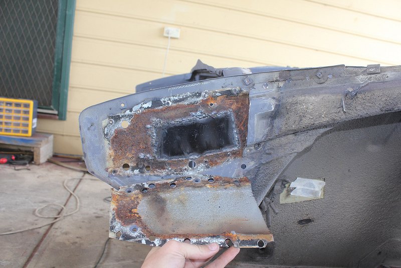

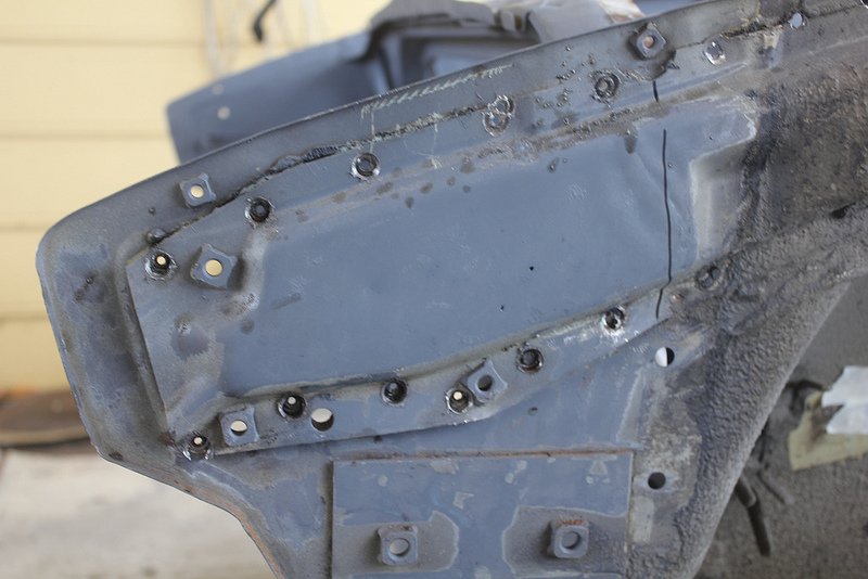

Noticed the underside of this had some surface rust. That coupled with the rust under the bog had me worried so I tried unpicking spot welds for the first time! First 3 or 4 were a bit of a mess and will be a pain to get back together. Most annoying thing will be that they won't look like factory spot welds :( better than rust though. Glad I did.
Most of it hasn't pitted, but will be good to clear out the surface rust before it develops into something severe.
Also did the same to the other side of previous repairs.... Wish I didn't... blehhhhh! I also was about 10cm too short, the rust extends about 5cm further than where I cut this panel off. There also appears to be very slight surface rust along the channel where water runs a bit further up.... Really don't want to pull the whole lot off. Might run some phos. acid down there or something. Or POR-15 on one of those super extended nozzles? Any ideas? Will definitely be chopping the doglegs off just to make sure there's no nasties under there in future.
Previous repair:
Spot welds undone:
Pulled off  :o
Also a note to any 'new guys' (newer than me) looking to buy a cheap Z with the mindset that it will need no work... Don't!  Even if you can't see rust, it's almost definitely still there. Get full photo documentation of any repairs & take along a fridge magnet to look out for bog etc. Take off the fenders, windscreen cowl and everything too if the seller will let you.

Regarding that rust under spot welds. 99.99% of monocoque bodies out there even new car will have that. The cars are welded prior priming.
I Guarantee you u unspot any section it be the same.its due to welding process. Only way to avoid is to glue it lol.
Porsche and german up-market (bmw,merc etc)  cars put special glues or some sort of guey stuff between panels prior to welding. Its conductive so it still welds through and seals it so moisture cannot get in.
If even wondered why these cars cost so much this is one reason.
I have never came accros jap or any other manufacturer do this besides BMW,mercedes and i got a porsche manufacturing dvd that they use glue to increase strength of the chasis and to reduce corrosion where welding happens. Its not just a pretty body with powerful engine and big brakes that demands cost body manufacturing is lot more stringent and higher quality.
Stupid fords and holdens these days dont boter even sealing the folded joins on the panels. They be rusting like crazy in few years. Cost cutting. At least jap cars still do that.
So dont get too concerned over that otherwise start unpicking the entire car and use the german process to re-build it. You be around 50y old but time you restore your z and say 100% rust free and will never rust again.
Though saying that ill be using similar guey conductive thing on my rails and under car and wherever ill be replacing panels.  I noticed on s15 around rear wheel arch they used some sort of rubberised sealer And still welded through. So they do it but not entire car just on strategic locations.

Won't get too carried away unpicking more stuff, just if there's any evidence of pinholes coming from the other side would be safest to double check. Glue sounds cool! Typical of the Germans to do something like that hah

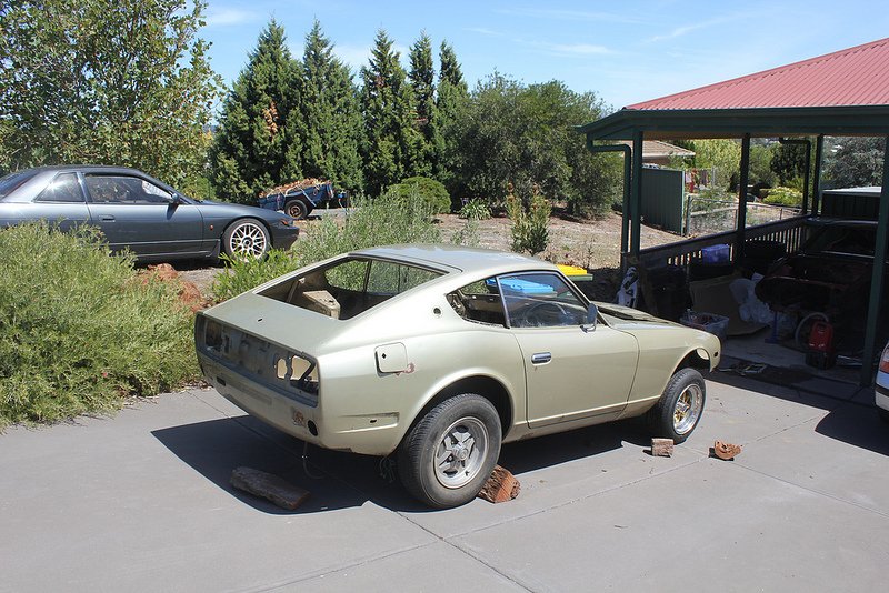

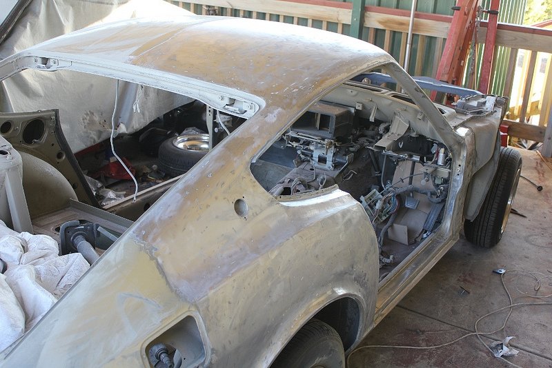

Well took a break over easter to head to P.I. Cool stuff. Back into it this weekend, aim of the game is to have a fair chunk of the car stripped, etched and primed. then soon I'll get some color made up, have a few test runs on some old panels and have a go in the engine bay.

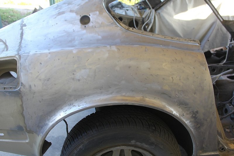

Need to give a few spots a bit of a zing with the sandblaster before I can prime them though, haven't come across anything else that needs replacement yet which is good. Just veyr light pitting. Most of the car seems to be 2mm deep under bog, which is...weird. And very messy. Haven't come across any evidence of crazy hailstorm style dents yet. Just a few here and there that i'll deal with later.
As you can see there's a fair few little dents around roughly the 2 oclock position of the wheel arch
Hey nice to see these cars build up from scratch! And i like the S13 in the background, whats that got in it?

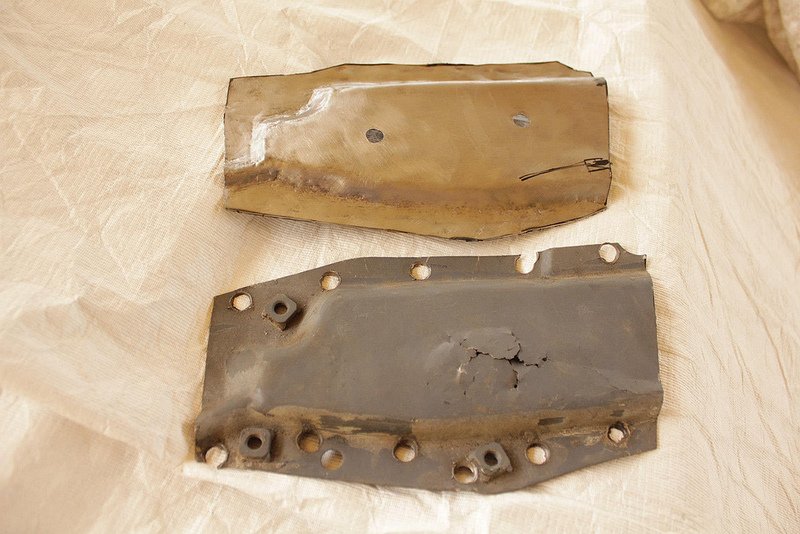

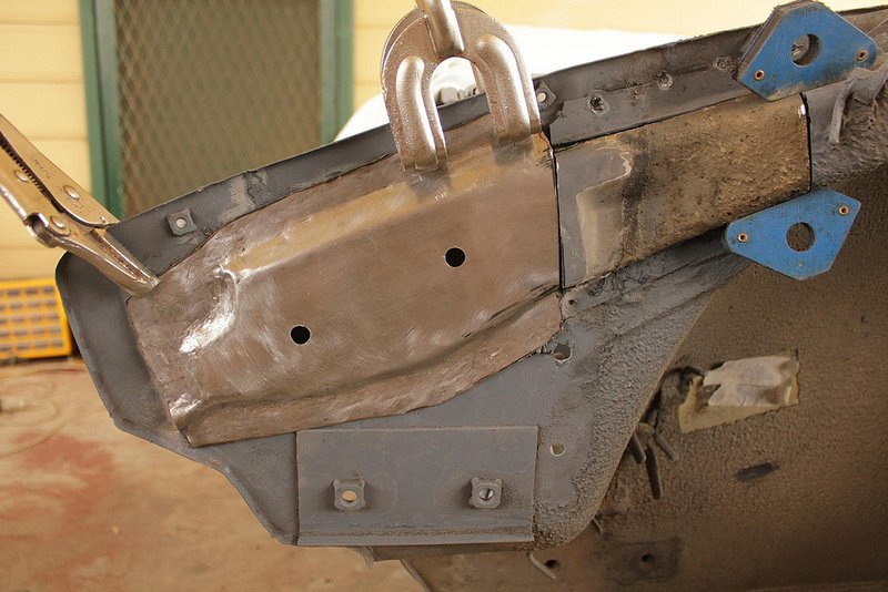

Spent the morning kneeling on the floor smacking the shit out of a little piece of metal with a hammer hahha. Didn't turn out too badly...
Still need to weld the nuts on and then we're good to go.
Fit is not 100% perfect so need to spend a little bit of time until I'm really happy with it.
Really need to invest in a dolly, sandbag and a nice hammer... One day!
Also any word on treatment of the inside of panels before welding them on?
Well done,
Full marks for having a go yourself. Before you know it you will be making all sorts of bits.
