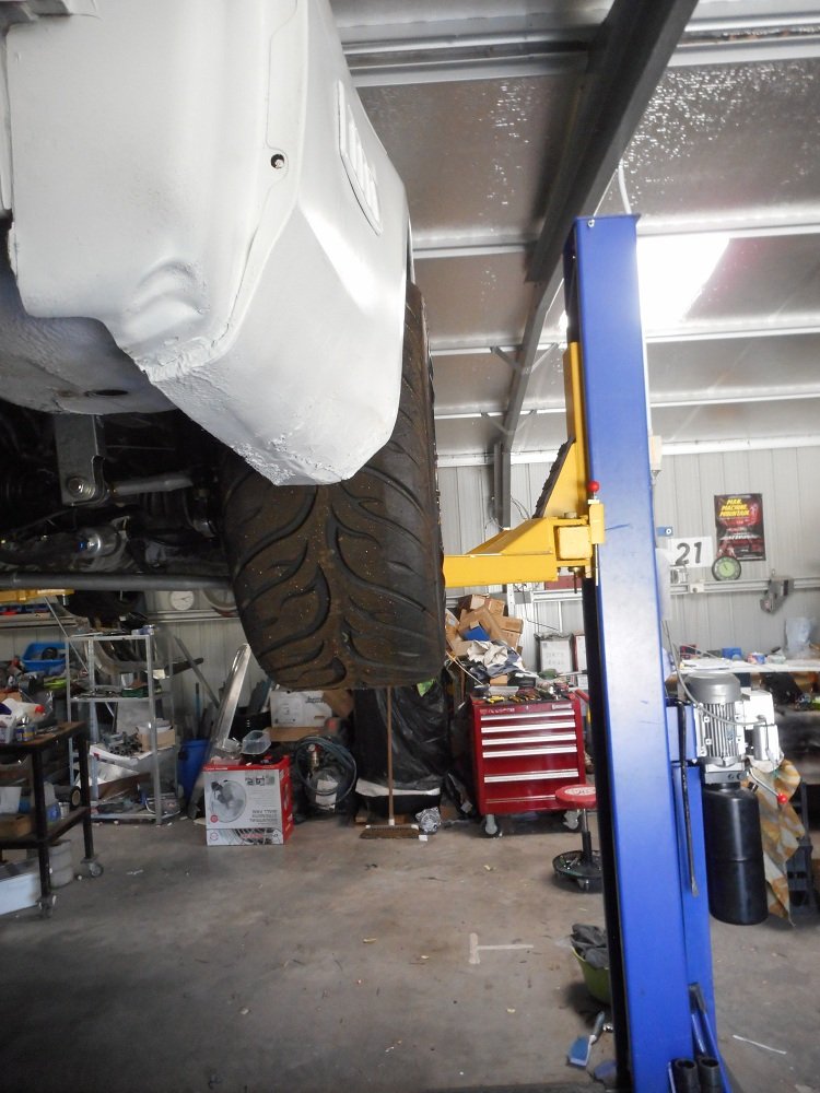

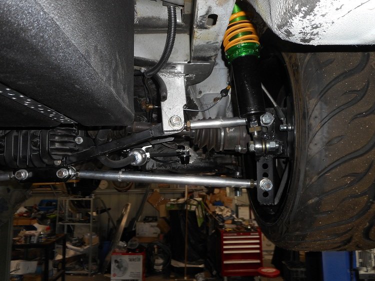

260DET Posted January 5, 2019 Author Share Posted January 5, 2019 More hold ups which are par for the course, everyone gets them so no boring details here. Car was up on the hoist when I decided to have a good look at the special rear suspension on full droop which is about 50% of total travel. The static negative camber is 1-2 degrees negative so I was pleased to see at full droop she is about zero, see the pic showing the outside tyre wall vertically aligned with the iron wall channels in the background. See also the lateral link angles, more on the lower links later because something special is planned there. Car goes in for a new exhaust job in about a week by which time the electrics should be close to completion, then will come the start up and dyno tune, yay. Quote Link to comment Share on other sites More sharing options...

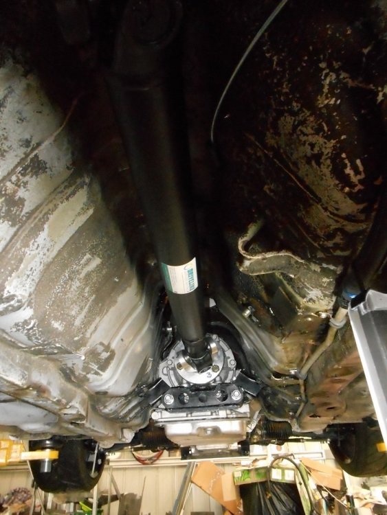

260DET Posted February 8, 2019 Author Share Posted February 8, 2019 After so many false starts and associated delays it's all finally coming together, hard to believe sometimes. The entire power train is in at last, the pics show the special adaptor at the back of the transmission required to delete the standard rubber bush setup. Unfortunately this means that a truck spline type tail shaft is required which adds considerably to the rotating weight but there is nothing to be done about that except use a carbon fibre tube instead of steel. But that can be problematical if not done properly and anyway I don't know of anyone who makes them. It's not rocket science, a business opportunity for someone. But for a big boo boo by yours truly the electrics are finished which means that once boo boo is put back in his cage the interior can finally go together, it's already been trial fitted. Then it's off to get the entire exhaust made then down the road to the dyno and all round fixer upper bloke. After all this time .............. AndBir 1 Quote Link to comment Share on other sites More sharing options...

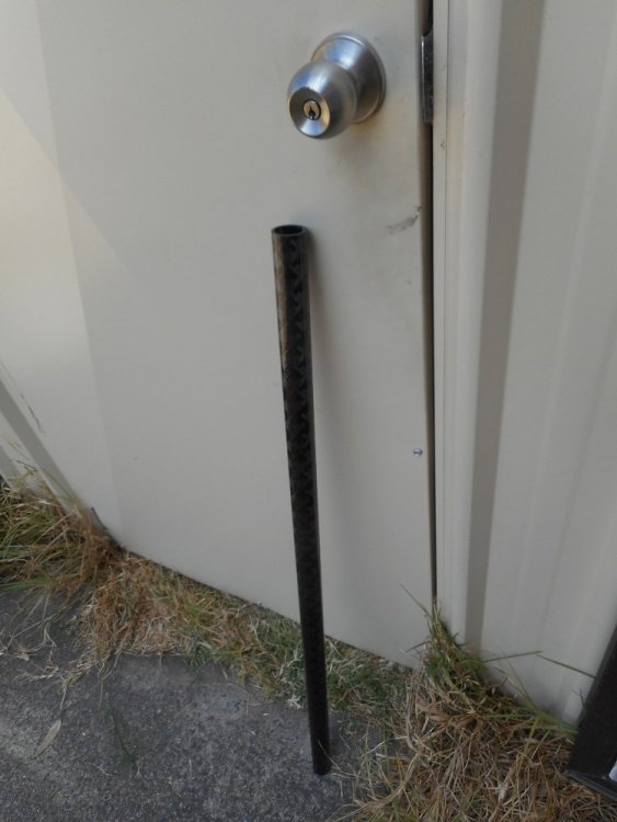

260DET Posted February 8, 2019 Author Share Posted February 8, 2019 What just arrived is a length of custom made carbon fibre tube. Quiz: what is it going to be used for? Tip, has to be cut in two to use. Quote Link to comment Share on other sites More sharing options...
smugley Posted February 8, 2019 Share Posted February 8, 2019 A walking stick ? andyk_79 1 Quote Link to comment Share on other sites More sharing options...
260DET Posted February 8, 2019 Author Share Posted February 8, 2019 2 minutes ago, smugley said: A walking stick ? Close, sort of like two walking sticks for the car Quote Link to comment Share on other sites More sharing options...
KatoKid Posted February 8, 2019 Share Posted February 8, 2019 Strut to firewall brace Quote Link to comment Share on other sites More sharing options...
260DET Posted February 9, 2019 Author Share Posted February 9, 2019 5 hours ago, KatoKid said: Strut to firewall brace That's an idea but, hot tip, suspension. Quote Link to comment Share on other sites More sharing options...
KatoKid Posted February 9, 2019 Share Posted February 9, 2019 Pull or push rods? Quote Link to comment Share on other sites More sharing options...

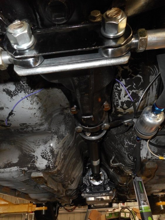

260DET Posted February 9, 2019 Author Share Posted February 9, 2019 Close enough, pic below shows the R aluminium lower lateral link, I was a bit concerned that they may flex under racing conditions so they are being strengthened by sliding a cf piece over each and using epoxy resin glue to internally bond them in place. It may be overkill but at least I'll know than any rear end problem will not be due to flex there. Quote Link to comment Share on other sites More sharing options...

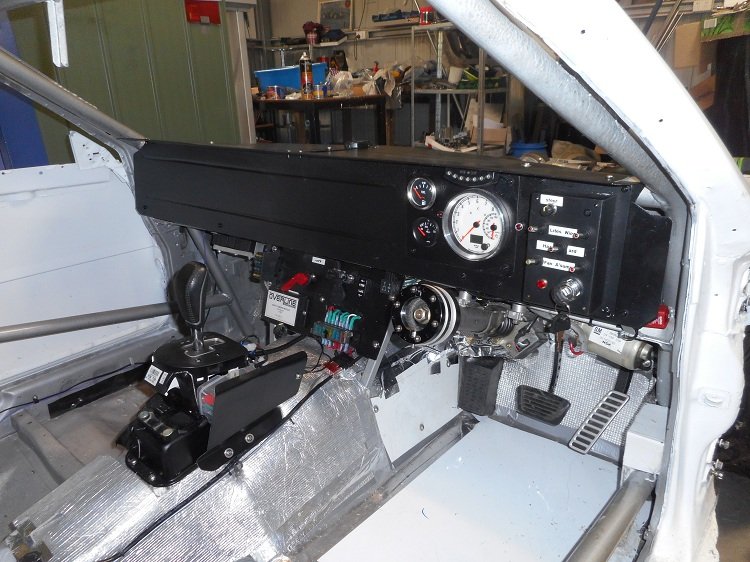

260DET Posted February 12, 2019 Author Share Posted February 12, 2019 Getting close now, pics are pretty well self explanatory, the tacho has a 260kph gps speedo on the right side of the face, hope that the car is not too fast and breaks it Steering wheel has an extension to get it closer to the driver, the electric steering is working as are all the accessories and the fuel pump so hopefully no problems there when the car gets on the dyno. RLY240 1 Quote Link to comment Share on other sites More sharing options...
260DET Posted February 14, 2019 Author Share Posted February 14, 2019 She's ready to go to be exhausted Pretty pleased with the driving ergonomics, shifter is level with the steering wheel centre laterally and about the same height as the centre, with the steering wheel spacer the seat did not have to be located too far forward so the pedal distances are good. And, surprise surprise, I can get in and out fairly easily if not slick and cool like a pro OdinZ and Gordo 2 Quote Link to comment Share on other sites More sharing options...

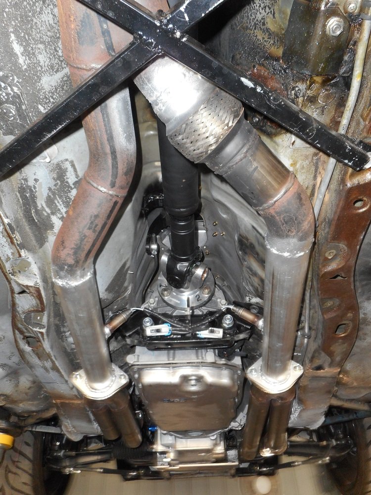

260DET Posted March 2, 2019 Author Share Posted March 2, 2019 The price you pay for a V8, extractor and exhaust complexity, cost, weight......... But the local bloke did a beautiful job which needs a video to capture properly. But stills, best I could do. Too expensive to get it all ceramic coated but some heat paint should do something. Quote Link to comment Share on other sites More sharing options...

260DET Posted March 3, 2019 Author Share Posted March 3, 2019 Yeh Dave, my point is that it's not part of the cage and forms just another point in addition to what CAMS requires to tie in with the chassis but we will see, the local logbook bloke is pretty realistic. As far as I'm concerned it's ready to go to the dyno bloke now. A better pic of the pipes looking from RF. Quote Link to comment Share on other sites More sharing options...
