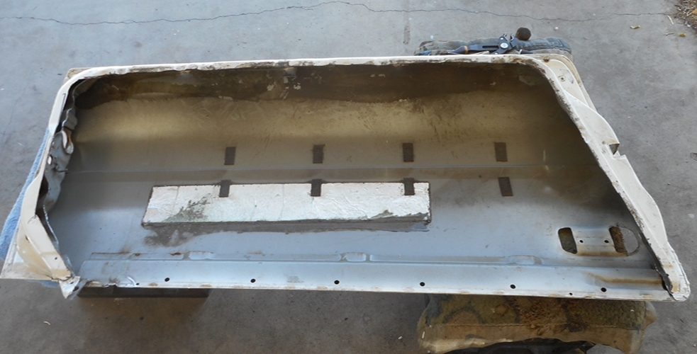

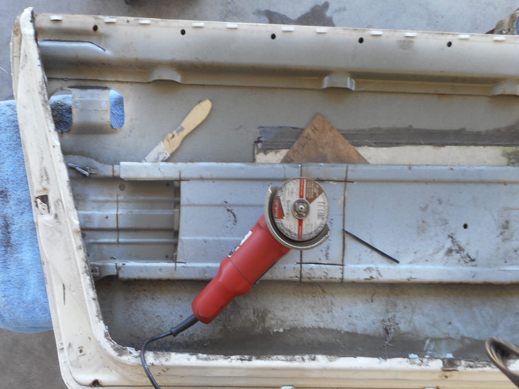

260DET Posted September 10, 2017 Author Posted September 10, 2017 (edited) Doors, big heavy long doors. Make f'glass copies or gut 'em? As usual there is no info around on the Z31, my thoughts were that f'glass ones would be a hell of a job and perhaps the time and cost would be better directed elsewhere. That turned out to be the right decision, one bare door weighed 22kg, gutted just 9kg, happy days! Then there is further weight to be saved, fixed plastic windows with sliders cut into them to replace the glass, plus delete all the electric winder stuff. Pics, working out how to get the intrusion bar out, the bits removed pile and the gutted door itself. Edited September 10, 2017 by 260DET Quote

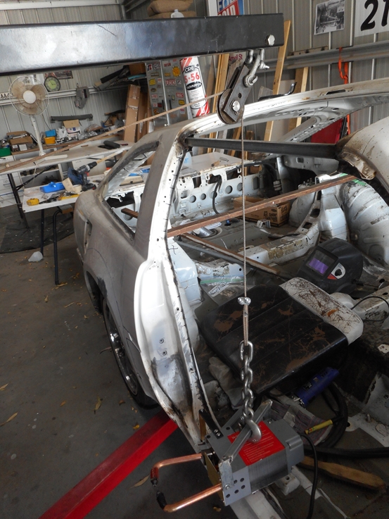

260DET Posted October 5, 2017 Author Posted October 5, 2017 Getting there, been doing some fibreglass work including a mould for a bonnet and two infills for the targa tops, they will be bonded in when the cage is done. Before the cage can be done I have to finish double spot welding the door openings which is proving a bit tricky. For the welds to stick the welder has to be held steady, it's a heavy bloody thing and one hand is needed to work it while the other has to support it and keep it still. A bit much so a counter weighted pulley support using the engine crane has been made as well as a side handle for the welder so it can be neutrally supported and held at the right angle. Welds are good now but some done before will have to be redone, the welder was moving during the welding process. The other structural thing is a removable radiator upper support panel to make engine fitting easier and incidentially stiffen the panel, three bolts each end. Pics of it and the spot welder setup below. Quote

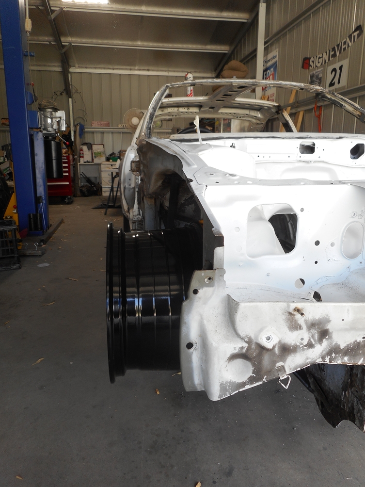

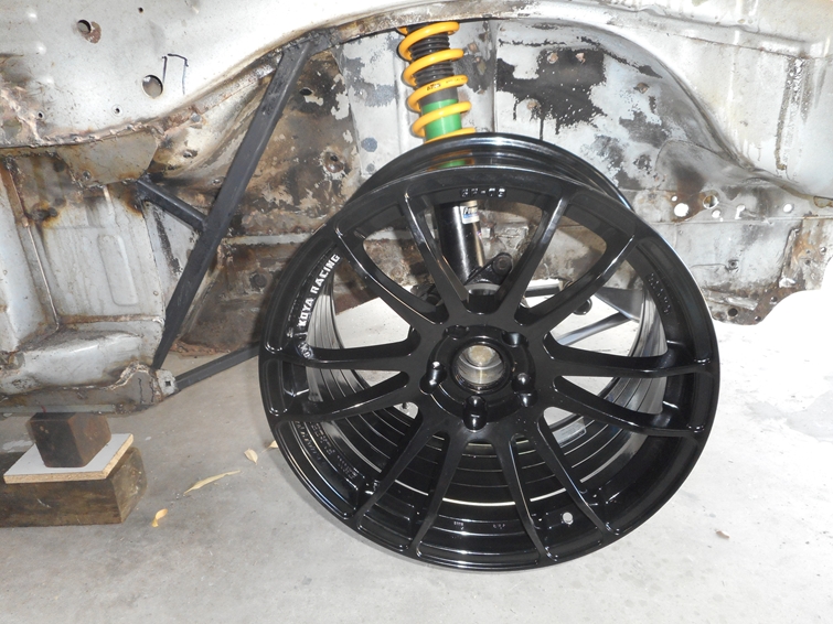

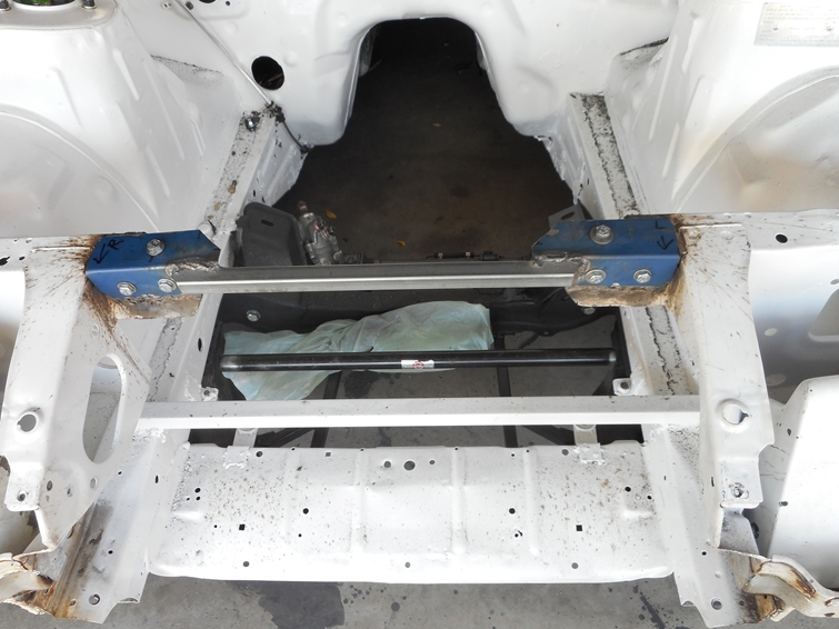

260DET Posted October 10, 2017 Author Posted October 10, 2017 Both door openings have been double spot welded so she is now ready to be caged which should be done this month. Meanwhile there are wheel clearance problems at the front, who was the smarty who said 18 x 10" wheels were the go for the front, eh. See the pics, the black brace behind the wheel is the culprit, not by much but enough, The rim inside clears the spring by 10mm, nice. Quote

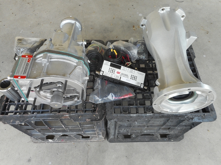

260DET Posted October 19, 2017 Author Posted October 19, 2017 Another parcel received, another few thousand $. This is the Gear Vendors overdrive kit for the intended two speed Powerglide, it's mechanical not hydraulic so can go behind a manual box too, it effectively doubles the number of gears of the main transmission. The next thing to be done is to send it to the chosen Powerglide builder so that it can all be assembled together as one unit. Then it has to be worked out how to shift in all gears with a single electric switching sequential lever. Anyway, pic. Quote
Cozza Posted October 19, 2017 Posted October 19, 2017 Cool, do they offer a variety of ratios? If so how do you pick the one you want? Interesting drive coupling from box to OD unit. Who you gonna get to build it all up? Quote
260DET Posted October 19, 2017 Author Posted October 19, 2017 (edited) Just one ratio, it's about .75 which is fine for mine. Yeh the coupling is splined both ends and is blanked off in the middle to keep it in place, I was thinking about drilling a small hole through the blanking off piece to aid lubrication of the splines but that's probably overkill? The bloke in Warwick who does some of my work will get the Glide done by a specialist, he's a racer with lots of experience with autos and knows what's needed. One thing I hadn't realised until now was that this setup is going to help weight distribution as well as being a much lighter setup than the 4L90E in the 280ZX, the overdrive unit itself will end up a third way down the transmission tunnel. Nice short tailshaft too which is always good. Edited October 19, 2017 by 260DET Quote
Cozza Posted October 20, 2017 Posted October 20, 2017 So your shift will go: 1 1+ 2 2+ With the OD unit switching on or off for every shift? Is it designed to do that? Quote
260DET Posted October 20, 2017 Author Posted October 20, 2017 That's the sequence Cozza and that's how it's designed to operate. The switching is yet to be sorted but I have a kit that shifts the Glide electrically so that's a good start, the GV shifts electrically too. Only catch is that the GV is not supposed to be used for engine braking, at this stage I don't know how much engine braking the Glide will give so it's all a bit of an unknown right now. But in any case the project is going to have big brakes so engine braking will not be relied on for outright retardation although engine braking alone can be useful in certain situations of course. Oh and that coupling you mentioned, machined from one lump of steel, cool eh. Quote

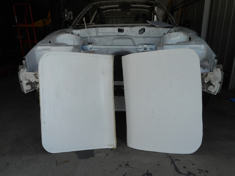

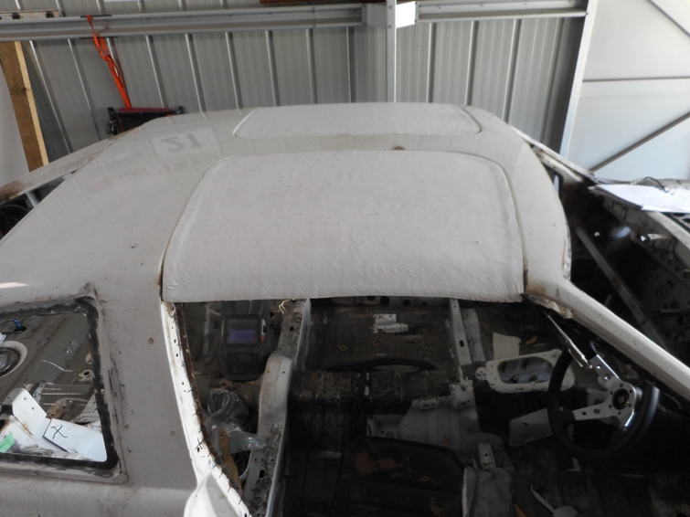

260DET Posted October 26, 2017 Author Posted October 26, 2017 Removed the targa top inserts from the moulds, they were moulded directly off the glass T tops to give a smooth interior surface as the outside has to be finished to blend in anyway. Trimmed them up and in all modesty they are ace, light yet rigid. After gluing them in the tops will be blended in using a light weight filler I'll make up myself. Any glue recommendations? Car is still waiting to get the cage done but waiting for this is apparently traditional anyway. Have started to prepare the bonnet mould, making a bonnet incorporating big vents is the next big job, then the front spoiler which will involve some extensive plastic surgery. Anyway, pics of the top inserts. krizza 1 Quote
PZG302 Posted October 26, 2017 Posted October 26, 2017 To glue the targa tops in I would use sikaflex, whichever one that the perspex mob I bought my window kit from recommends. Quote
260DET Posted October 26, 2017 Author Posted October 26, 2017 My thinking is that a flexible adhesive may lead to cracking of the filler used to blend the tops into the body work. Bunnings list lots of Sika products, Super Grip 30 Minute Adhesive seems to tick the boxes, has anyone used it? Quote
Cozza Posted October 27, 2017 Posted October 27, 2017 It’s still a flexible adhesive however, T Rex Power is one of the go to construction adhesive/sealant products these days. Sticks like oop to a blanket as they say. http://soudal.com.au/trexpowerbond/ Quote
