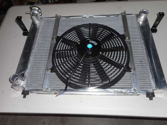

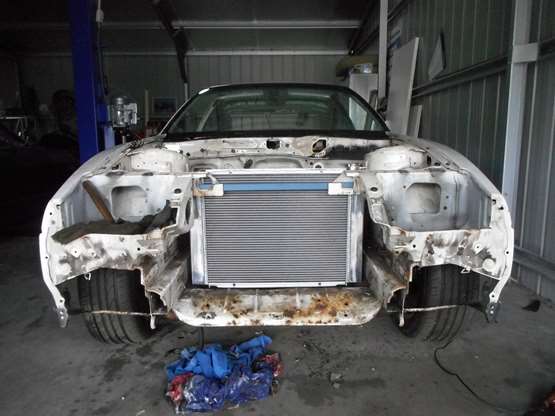

260DET Posted September 4, 2016 Author Posted September 4, 2016 Seeing that the body is at rest it's a good time to cut things so some of the top radiator support panel has been removed, mainly to lower it for easier engine removal purposes, the replacement is some 25x25x1.6 square tube which will be welded into place. New radiator is a V8 Commodore all aluminium replacement which will be mounted vertically and not at an angle like the original. It's a little bit smaller in size, not much though, but the core is about twice as thick so with proper venting it should do the job. Quote
260DET Posted September 10, 2016 Author Posted September 10, 2016 Radiator and fan mounts all done so that can be put aside until assembly time, next job is mounting the DBW accelerator pedal and modifying the pedal box so the electric steering mechanism clears. Pic shows the fan which came with the radiator properly mounted not using those plastic retainers which thread through the core. Pads on the bottom sit inside cups welded to the body while the arms near the top bolt on. Yay, the first fabrication job is done, progress Gordo 1 Quote

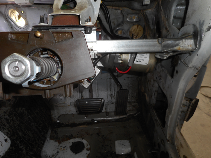

260DET Posted September 17, 2016 Author Posted September 17, 2016 (edited) Electric steering is now mounted internally using some fabricated parts including a new 30x30 dash bar and retaining the stock pedal box, drive by wire accelerator pedal is also mounted. The supplied steering assistance variation adjuster will be dash located eventually, the supplier wired that. In all one of those awkward, time consuming jobs that at the start is a bit of a 'will it all fit' adventure. Now to remove it all, finish welding and paint the OE unpainted pedal box. Obligatory pic shows the steering motor in the middle right behind the dash bar.. Edited September 17, 2016 by 260DET Sirpent 1 Quote

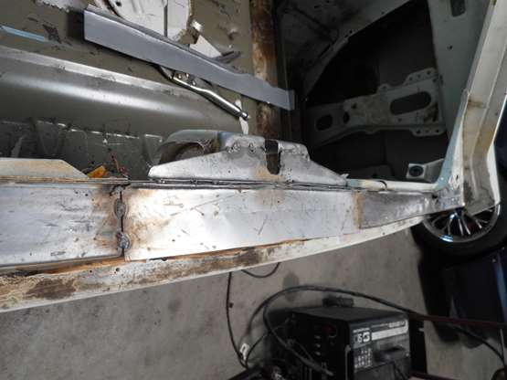

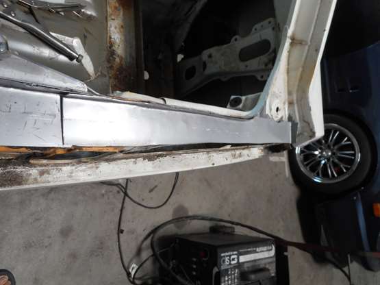

260DET Posted October 8, 2016 Author Posted October 8, 2016 Rust 'repair' race car style. If the part is non structural, like a front guard, then just fix it up the easiest but permanent way possible. If it is structural then my procedure is to clean the area removing all loose rust, hit it with rust neutraliser then work out if the part should be made stronger/stiffer during the 'repair' process, always keeping weight to a minimum. On the Z31 the top of the rear panel that meets the bottom of the hatch was significantly rusted in several places, it's certainly a structural piece so the decision was to plate the entire panel using stiff zinc plated 1.2mm sheet. I avoid using plain mild steel for any structural part. Pics show what was done and the procedure, note that the back edges of the plates will be welded when on the rotisserie and the whole job will have a final dose of fish oil. Quote

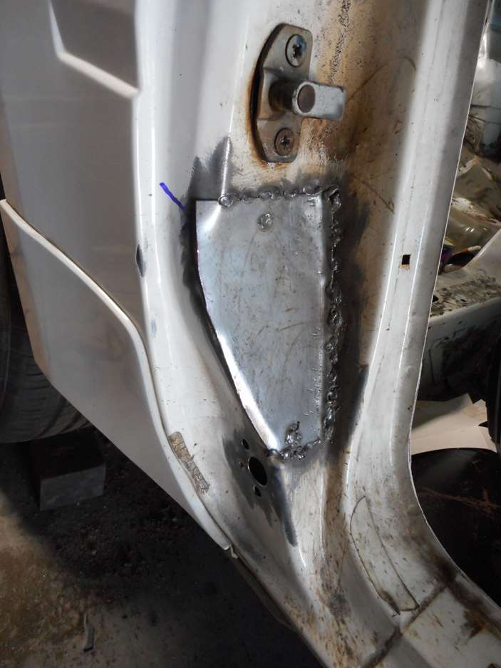

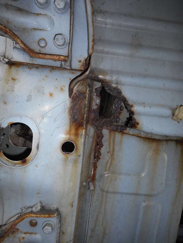

260DET Posted October 11, 2016 Author Posted October 11, 2016 As well as rust repairs these bodies have some large openings for various purposes, my idea is to weld all but the few essentials up. Pictured are before and after shots of a vent opening in the lower B pillar which had weakened it so much that both sides were cracked at the top outside corner of the opening. Also shown is a large hole rusted through both inner and outer panels just forward of the A pillar door hinges on both sides, caused I suspect by the car being parked facing up hill so water could not get out the drain holes. There are a few bits like this that need repair and which could not be seen when inspected, the bodies on these cars have lots of double panels and are way more complex than a S30's. Quote

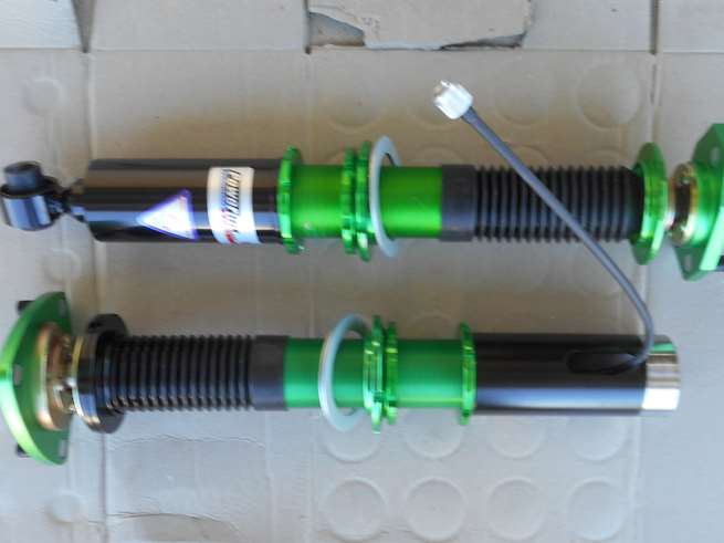

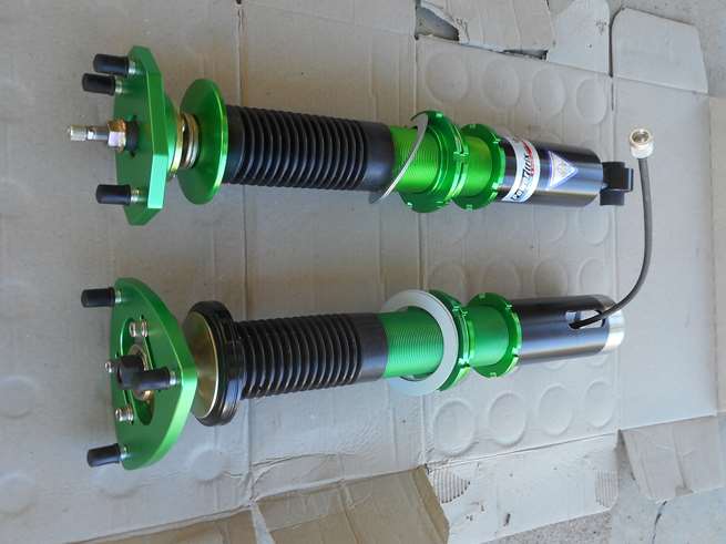

260DET Posted October 14, 2016 Author Posted October 14, 2016 OK, a break from my dodgy looking but effective welding, the coilovers have arrived and are presented to you in all their not Tein green glory. Imported without springs, Kings will be used and when changes are likely it's best to stick with the one brand. Quote
