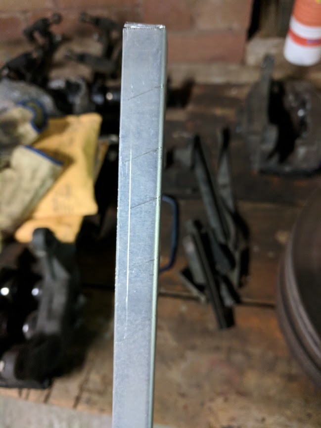

Administrators gav240z Posted September 21, 2017 Author Administrators Share Posted September 21, 2017 Started to make replacement brackets... Original.. Still need to drill holes and cut slats in.. Wonder if there would be demand for these? George, KatoKid and Ponyo240z 3 Quote Link to comment Share on other sites More sharing options...
Brabham Posted September 21, 2017 Share Posted September 21, 2017 Good work Gav, maybe make up a mitre box so you get the angles right. I suspect there might be a demand as the brackets always break if the grille gets hit and can't be welded. Cheers taylor and gav240z 2 Quote Link to comment Share on other sites More sharing options...

gilltech Posted September 25, 2017 Share Posted September 25, 2017 (edited) Nice work Gav. Is that an electro-galv steel channel section you're using (has that 'splangled' look in the photos)? The original uprights on mine are aluminium, so soft and easily distorted, steel sections would be an improvement. Edited September 25, 2017 by gilltech Quote Link to comment Share on other sites More sharing options...
