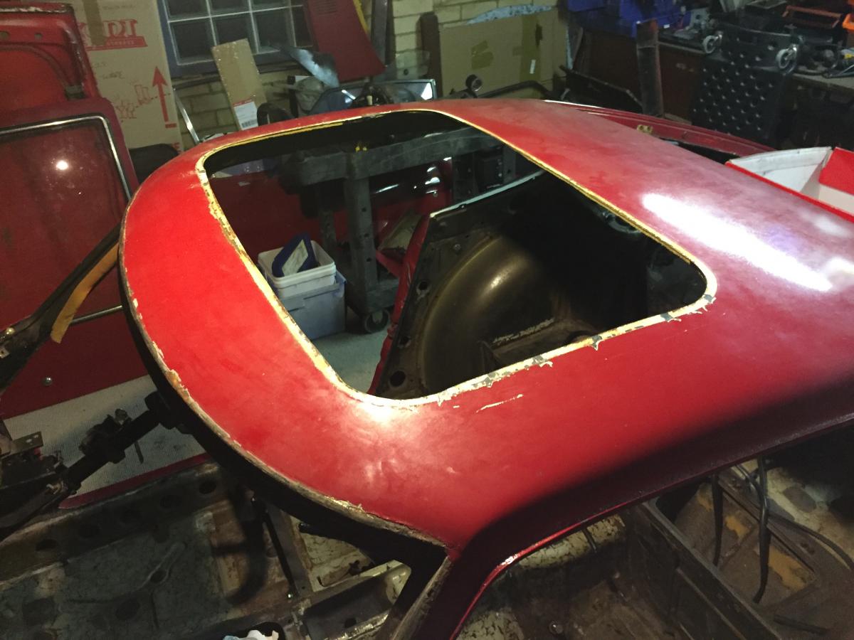

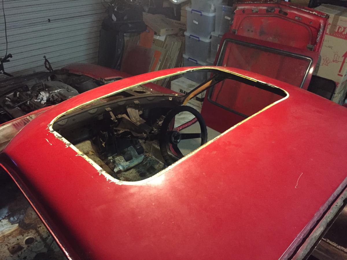

Scotty_Rah Posted October 12, 2015 Posted October 12, 2015 Tonight i removed the sunroof that was fitted to my 260z 2 seater. I wanted to ask for some advice in how to go about making the roof 'normal' again. is it possible to weld in a section? or could i fibreglass the hole up? i'm trying to avoid replacing the the whole roof as i believe its pretty good apart from the hole in it.. see pics what are my options? Quote
locklock Posted October 12, 2015 Posted October 12, 2015 I have the same issue for my rs 260z. According to my workshop, he says find a donor roof and cut to the exact size and weld it. U need to find a very very good welder. A shoddy job will show in years to come.. I haven't fix it yet, as im restoring another 240z. Let me know when u do it ya.. Would love to see the outcome. Quote
Retro Z Posted October 12, 2015 Posted October 12, 2015 Find another complete roof skin and spot weld it from the rain gutters like how its done from factory. It would be quite difficult to just weld a filler piece without warping the roof. Quote
Administrators gav240z Posted October 12, 2015 Administrators Posted October 12, 2015 The best way is a complete roof turret but you can weld them up with a bit of skill. Ledge has described the process before. He advised using an oxy welder as it is more pliable and you can reshape the weld with hammer and dolly. You will need a skim of filler with this method. Rob at Z-Factory can also do it. I'd say it wouldn't hurt to unpick the roof anyway as the frame can be rotten underneath especially near the rear 1/4 lead join area. I still haven't decided what I'll do with mine yet. Hope to get an Oxy welder soon for more practice. Quote
C.A.R. Posted October 12, 2015 Posted October 12, 2015 (edited) I wouldn't put a welder near it, unless you are going to replace the whole roof panel. IMHO, your options as I see it: Opt 1. Replace the entire roof skin - IF you can find a skin. Opt 2. Make an infill piece (that's been shaped in an wheeling machine to match the compound roof contours) with say a 20mm overlap that can be made into a lip by jogging or swageing a recess into it. Then urethane (Sikaflex) it into place. A thin skim of filler will finish it off. Edited October 12, 2015 by Lurch ™ PeterAllen 1 Quote
Administrators gav240z Posted October 12, 2015 Administrators Posted October 12, 2015 Lurch - will regard to this statement. I wouldn't put a welder near it, unless you are going to replace the whole roof panel. Are you saying this from a non-professional perspective of tackling this job? As in you wouldn't advise an amateur to attempt this sort of job? Or even as a professional do you think it's a bad idea? I understand the sentiment, regarding avoiding heat. However if you had access to a TIG welder for example wouldn't you be able to exercise a lot of heat control and be able to get a good result? Quote
1600dave Posted October 12, 2015 Posted October 12, 2015 (edited) With 30 years of amateur mucking around with restoration work, I would personally be wary of welding up a job like this. Is it possible ? Yes. Will it be cheap ? No. Will it require a lot of skill ? Yes. Nothing wrong with a "cut'n'shut" of a replacement roof, or a roof skin. Probably won't be anymore expensive than paying a good panel guy to make up the replacement section and weld it in. Or lurches suggestion of using adhesive to fix a replacement section (but you'll still need to get someone to make up the replacement section). Edited October 13, 2015 by 1600dave Quote
PZG302 Posted October 13, 2015 Posted October 13, 2015 To do the fill in of the sun roof on my charger, it took 40 hours to do complete with a few robust discussions with the panel beater to get to the standard where I didn't need to put a vynal roof on. As said above by Lurch, Dave and Gav, either do the full roof or fill in and sikaflex Quote
locklock Posted October 13, 2015 Posted October 13, 2015 Lurch, sorry for the noob question.. whats the reason of using sikaflex instead of welding? Quote
1600dave Posted October 13, 2015 Posted October 13, 2015 (edited) No heat. Heat causes distortion. You don't realise how much until you do a bit of welding. I made a rotisserie for my car, welded a "T" shaped bit out of 50mmx50mmx4mm RHS with oxy welding equipment. Simply welding the two pieces together (so running a bead of weld around the end of the 50x50 piece to join it to the centre of the cross piece) pulled the 4 foot long cross piece of RHS so that it was bent by 10mm. Edited October 13, 2015 by 1600dave Quote
Administrators gav240z Posted October 13, 2015 Administrators Posted October 13, 2015 Yes by far the best most seamless repair is a new roof turret, but they are getting more difficult to source. I am currently in the US for work, I am hoping to meet with a fellow Z-nutter in San Francisco shortly. I will see how feasible it is to start importing panels from the US, apparently there is a swap meet on for Datsun's this coming weekend in SFO so I'll suss it out. Even if a roof turret costs $1000 AU to supply, it is still much cheaper than filling it in. After all why did Nissan make all those 280z's if not for spare parts? Quote
260DET Posted October 13, 2015 Posted October 13, 2015 An alternative would be to make a mould from a good roof and then use that to make a composite panel. Bonding it to the metal would of course be crucial but there would be suitable structural adhesives available, get advice on that from the adhesive suppliers eg Dow, Sikaflex, 3M. Carbon fibre plus another fabric to resist abrasion could form the basis for a suitable composite. Filling in sunroofs seems to pop up regularly, there could be a market for composite repair kits. Quote

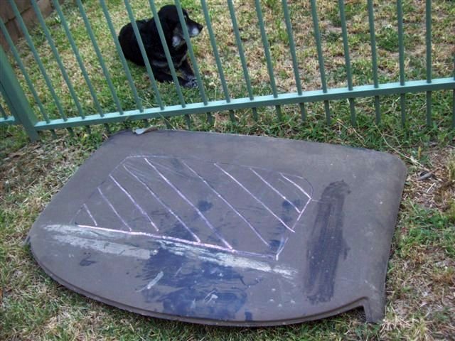

PeterAllen Posted October 13, 2015 Posted October 13, 2015 (edited) Like this one! NOT FOR SALE. (but the dog is!) Yay... 1000 posts. Edited October 13, 2015 by PeterAllen Quote
Scotty_Rah Posted October 13, 2015 Author Posted October 13, 2015 Thanks for all the info gents! This gives me a lot to consider. I like the idea of putting a new skin on it. I'm sure it requires a great deal of skill and talent, so I might be best to get a professional to do this for me. Peter - you sure it's not for sale? Quote

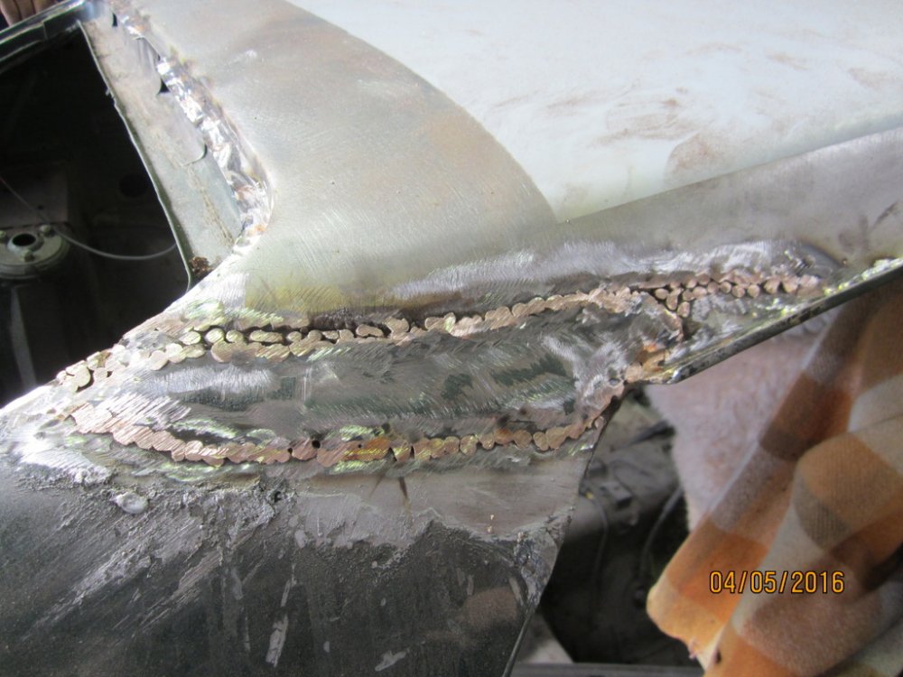

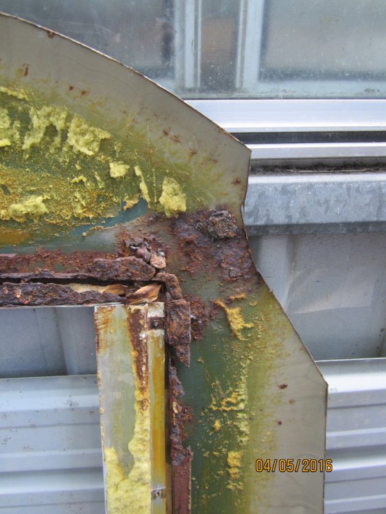

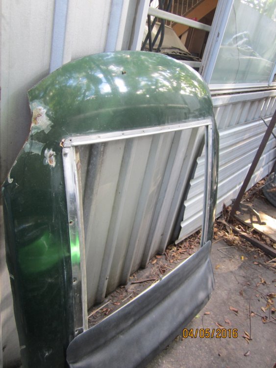

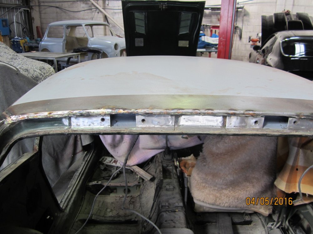

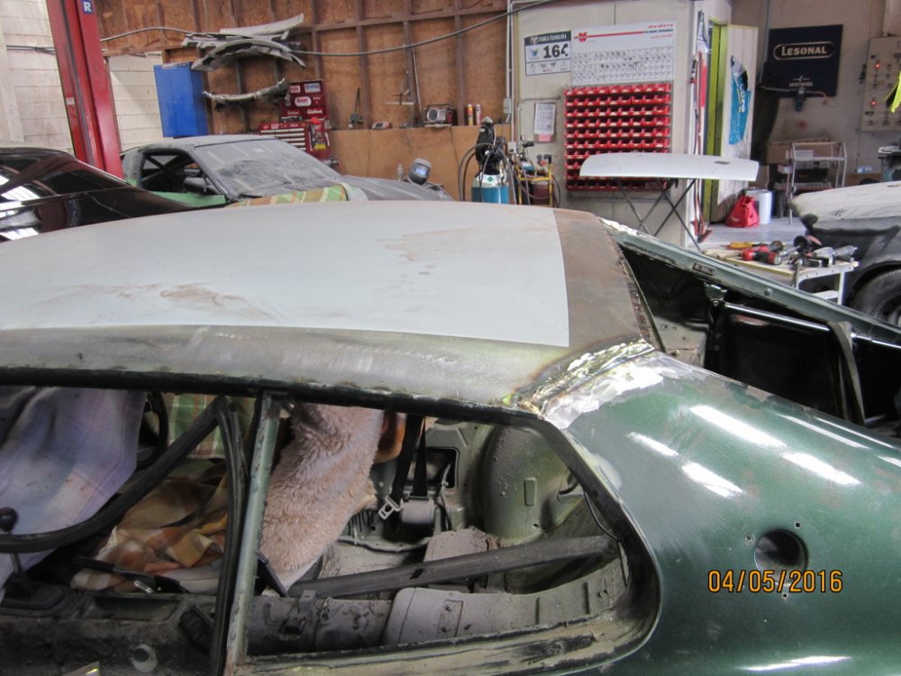

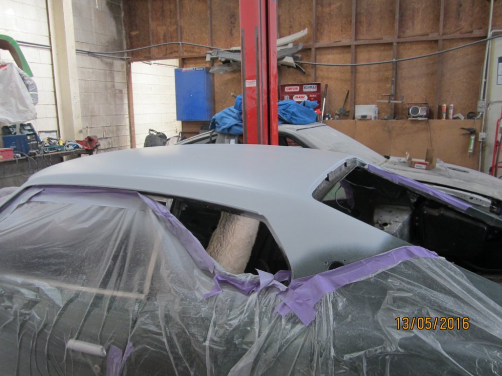

Groundhog Posted May 4, 2016 Posted May 4, 2016 (edited) Bye bye rusty old roof courtesy of Webasto!.I should have trusted my instincts when I bought the car and the carpet smelled musty.Being repaired by a panel shop old school panel beater as I had one shot at getting the roof repairs right, and I didnt trust myself for this.Still, I'm happy with the repair progress so far as it allowed for rust prevention underneath and the work is happening fast. A couple of work in progress photos. The donor roof. I only noticed once it had been unpicked and removed that the rear hatch hinges had been repaired previously. Note the bog and filler in the top corner. The donor roof needed repairs here also so it looks bad atm. Will be tidied up some more. Edited May 13, 2016 by Groundhog GongZ 1 Quote
