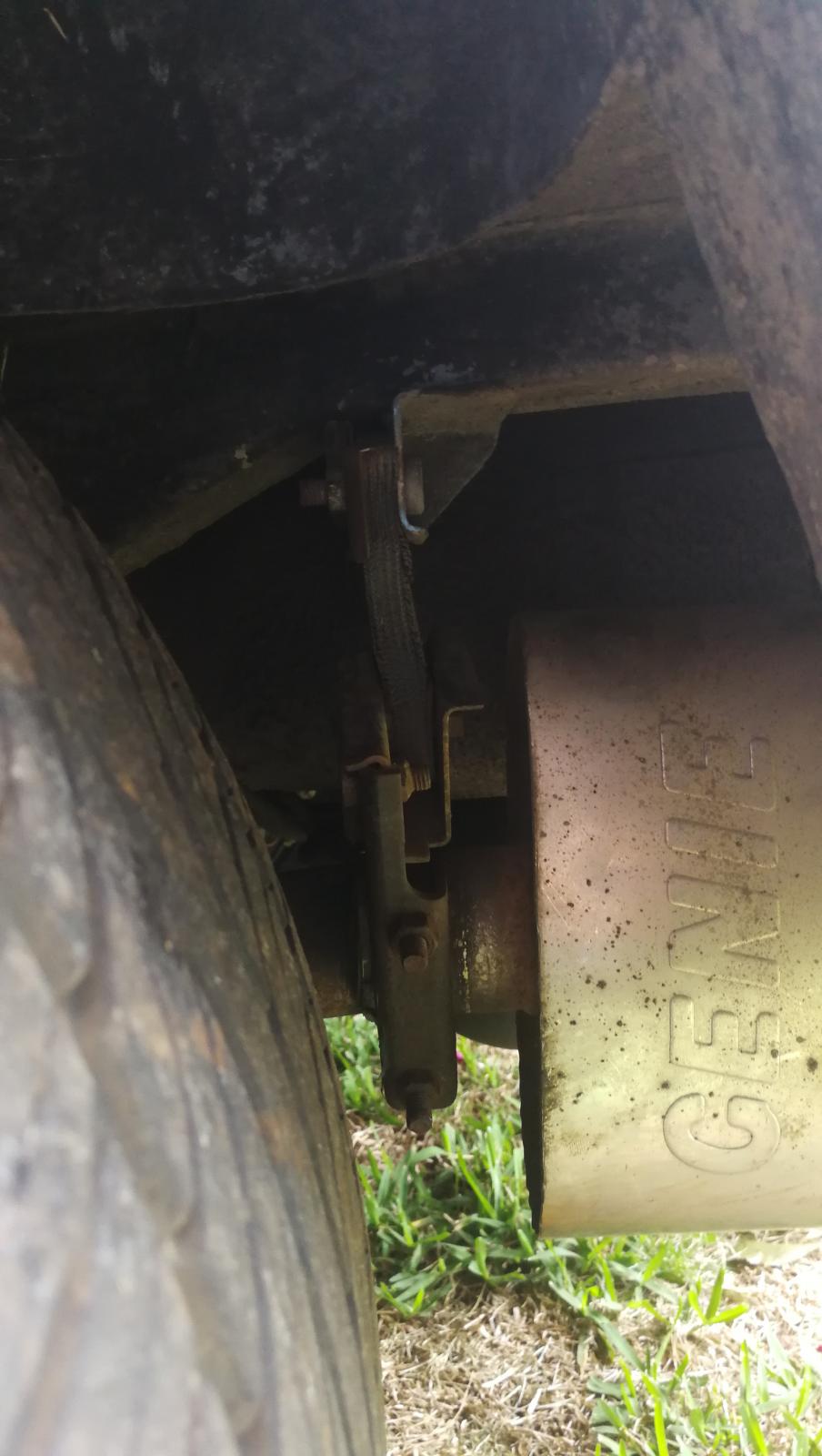

Yea, she's a bit of a mess underneath. Bits of older and newer stuff. Headers, expansion chamber and muffler, all connected up at different stages of work. I've managed a ghetto fix for now, to stop it rattling, lol. Just trying to save up a few dollars to get the lot replaced. Hopefully only a few more weeks.

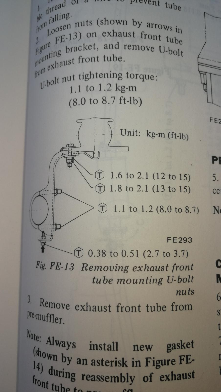

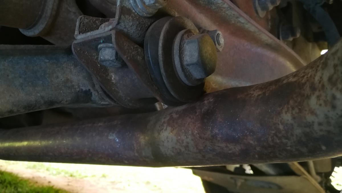

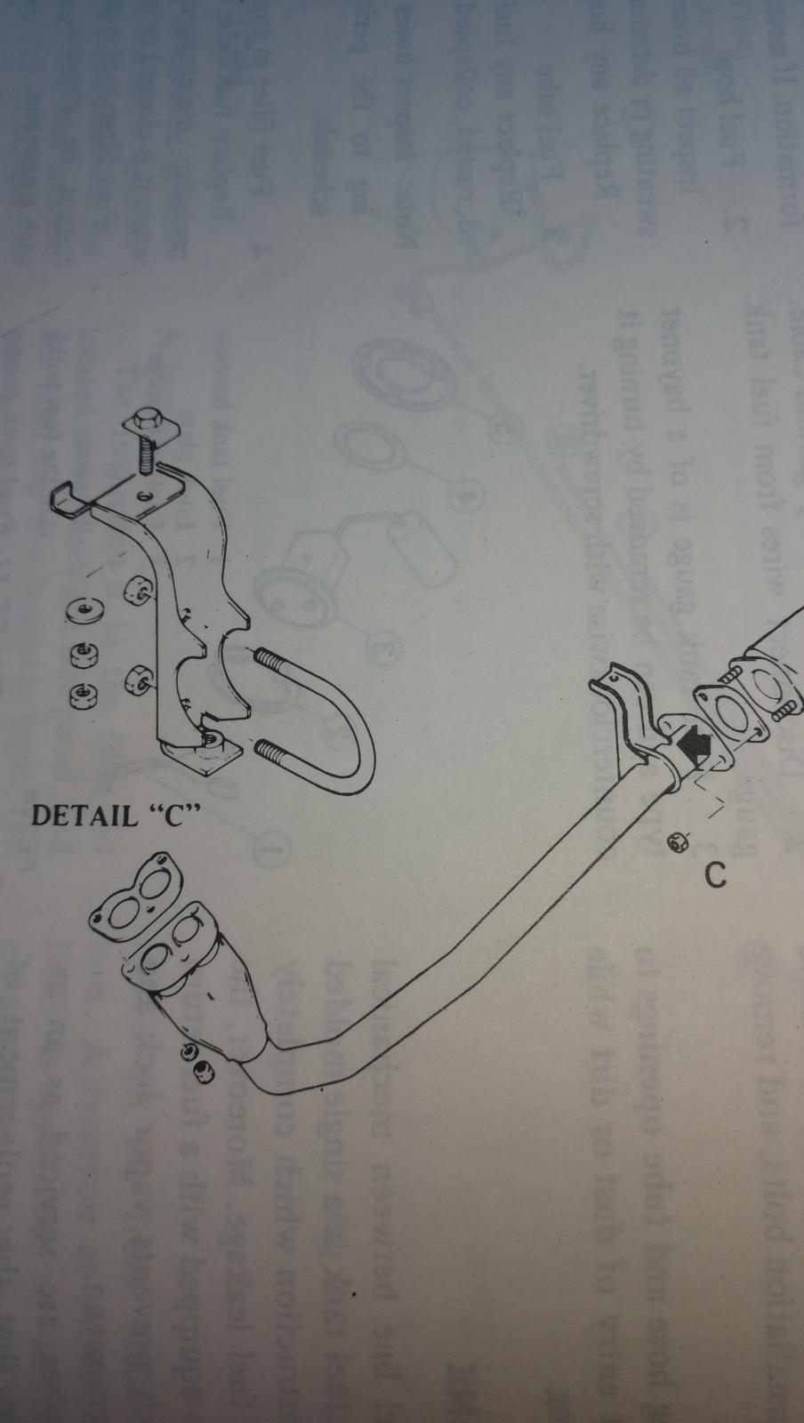

Cheers Gilltech, you've helped me zero in on the front mount. The first two images relate to the rear hanging points. The front mount hangs off the gearbox, it seems. The image of the nice shiny gearbox, which isn't mine, shows the connection lugs, just under the shifter. The following images are from the manual, and show the bracket and connection. I'm now confident that I can tell the exhaust shop where to hang the system from. Cheers, Rob
Cheers Andrew. It looks like my setup is exactly the same as yours. I couldn't find that diagram online, my googling skills need improvement.. Lol. Only just remembered I had the original service manual. Which basically shows the same thing. But my issues have sort of escalated since looking for that. My muffler has always been on an ugly 45 degree angle. Now I know why. Straightening it produces the attached photo issue. Didn't want to fit a new exhaust just yet, but.....Mmmmm Cheers, Rob
Howdy all, My exhaust system is currently only fixed at one point. The flexible strap near the exhaust. Surely there must be another hanging point under the car? I'm trying to poke my head under there, as best I can, but I'm not seeing anything obvious. The cut away in the cross member for the rear suspension seems like the only obvious location. Any input appreciated. Cheers, Rob

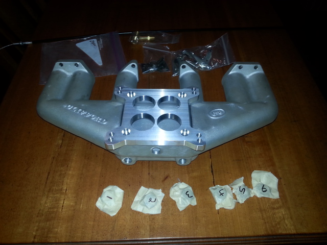

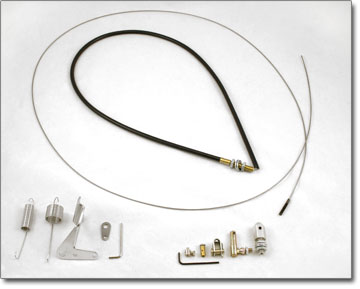

Hi All , Due to fact that I am about to change the carburettor setup on my car ( again ) I thought I would relay my experience with having a 4 Barrel Setup. When I initially set out, to do this conversion, I found that the amount of info out there is limited. This wont be an exhaustive review/analysis, but I hope it can help provide a little additional info to anyone looking to do this. While many people do frown on this particular conversion , I would like to begin by saying that it has treated me well. A solid performer that makes for a good daily drive. After re-jetting it has produced a solid AFR of around 13.5 ( which seems to be my motors sweet spot ). The Setup Clifford Water Cooled Intake Edelbrock 500 ( An Edelbrock ?? , will explain shortly ) Cable Conversion ( from The Z Store ) My Engine Recently rebuilt L26 ( About 4 years ago , less than 5000km ). Flat tops , Mild Camtech Cam, Mallory Distributor / Ignition Controller, Electric fuel pump & Radiator Fan. Basically nothing exceptional. Jetting / Tuning Why the Edelbrock 500, when most run 390 Holley's ?, primarily the cost ( that turned out to be a joke..lol ). After a little research I realised the Primary Throttle body sizes are the same ( Venturi is slightly larger on the Edelbrock ). And, as you spend most of your time driving on the Primaries I decided this wasn't going to be an issue. I can't recall the exact rod/jet combo , so I'll come back and fill in this section with my exact rod/jet sizes ( after I have removed it from the car ) . But every car is going to be different , so my setup isn't necessarily going to be meaningful to others. But , you are going to need to lean the Edelbrock from it's standard setup. It ran very rich out of the box. But, as I stated initially, I now get an AFR reading ( in car gauge ) of around 13.5 at cruise & 12.5 under acceleration. If I had to do this over again I would go with the Holley 390, as I understand this will work out of the box ??. The Clifford Manifold The water pass-through manifold ?. Honestly I'm not sure how I currently feel about this , as I only have the triples to compare this with , and they would start and run without choke ! I feel it has a very slow warm-up period. Now i'll preface this by saying that the oversized carb on a single plane manifold may contribute to this . But I'm looking at around 2 minutes ( with full choke / 15 deg ambient temp ) before I don't have to ride the throttle , and then another 5 minutes before I can fully disengage the choke. Is this comparable to SU's ?? , dry 4 barrel manifolds ?? Performance Ok , unfortunately I have never had this setup dyno'd. I did have the original triple Webers ( 40's ) dyno'd when the engine was rebuilt and got around the mid 120 rwkw mark. I think it was 123??. Does this setup feel as if it has as much torque ? , definitely not. The triples would pull like crazy from 500rpm. This need to be driven into the 1.5-2k range , but then it goes like crazy. My butt dyno can't tell the difference , lol. Would it have less HP than the triples ? , I suspect so. But, it is far more drive-able in traffic , for me anyway , than the original triple setup. Maybe my triple tuning wasn't optimal ?? Cost A lot more than I expected....Isn't that always the case...lol. Including all the AN fittings, new hoses ect. , I spent over 1.5k on this setup. Final Thoughts Fitting the manifold was tough , really tough. Due to the fact that the manifold has to slope downwards , to accommodate the carb height , there isn't enough room ( in some cases ) to get your hand in to fit the nuts/bolts. I also had to remove the bonnet vent cover/cowling, that normally sits under the bonnet on the left hand side ( to stop water dripping on the carbs ) , as the air filter would rub otherwise. Otherwise I am very glad i decided to try this. It was a fun experience. If anyone want's to know any additional info, has anything to add , or would like additional pictures ( as I'll have the setup for maybe a couple more weeks ) , let me know Cheers, Rob A couple of links to old videos I put up. https://plus.google.com/u/0/photos/photo/104716928338032625573/6215375660745769906 https://plus.google.com/u/0/photos/photo/104716928338032625573/6225049601407320498
