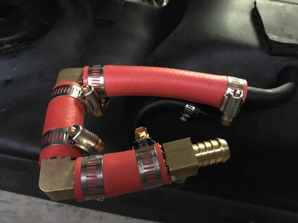

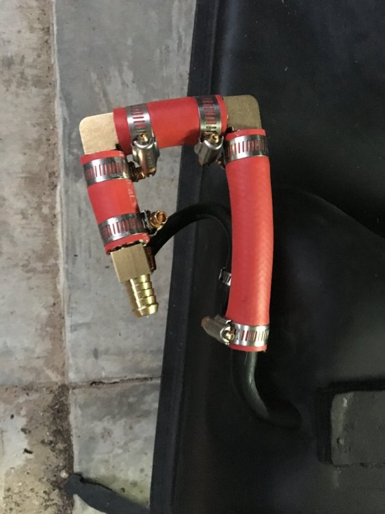

The main issue/reason I had to modify the vent hose was that my original tank only had one vent... all the photos I have seen of the original 240z tanks had two vents... generally 1 being at the top right (rear) and the other being middle on the far left of the tank. Thus the system was always meant to have two.. not sure why mine did not. I'm open to ideas and suggestions on this - whether other peoples 240z fuel tanks have one or 2 vents and what size they are?? Lurch - does yours have an evaporation canister that the system all plumbs to or straight to the rubber fuel filler hose?
Quick update on this one. Firstly I never mentioned I was doing this as my 240z tank was only 40L... I think many are but all the sites I see mention it's a 60L tank (but mine definately was not). The installation itself would be difficult to use an original fuel vent hose, because of the additional fuel vent coming from this tank. There is limited room, and to cut the original vent tube squeeze in the additional brass section with T piece etc was going to prove tricky. The only thing missing from the photos is an additional 90 degree brass elbow which connects the tubing back into the car to the fuel filler. I also angled the vent tubing in the photo below slightly downwards (not the way it is in the second photo), to line everything up correctly as the vent hose from the car comes through a metal "tube" so it is already angled as it comes through to the fuel tank area... hope that makes sense. So so far it all seems to fit and mount correctly, I might need to play around with the position a little to get it just right. The only thing that seems to have been just a little off was the short strap on the left hand side. Larger tank = larger straps, but the one of the left was almost a little too long and the original strap wouldn't reach. I've used a thicker piece of rubber insulation (between the tank and the metal strap to correct this). Let me know if I've missed something out or questions if I can answer I will.
