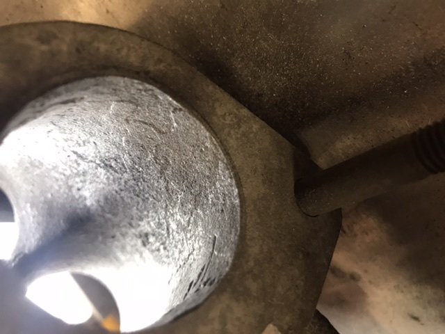

  6. Started a new little project with my bro to install the two spare FCR41’s I have to his newly rebuilt 510. He sourced a Nissan SU manifold for only $50. I spent time yesterday sand blasting and cleaning up the ports with a dremel lol. My first try at porting, so hopefully it’s ok. It’s going on a stock L20B with a brand new V912 head running a 72 degree cam. Mikuni couplers will need to be ordered but I think they’ll bolt straight on to the manifold studs. We might also have a look at port matching the manifold now it’s been buzzed a little. Looking to run it with the gold Keihin ‘power blade’ velocity stacks. They’re 50mm long, 65mm at the opening and run a blade half way through the stack. It’s meant to improve air speed at low to half throttle. The hardest thing will be fuel supply as the FCRs run plastic T pieces that are held in by the adjacent carb, now the spacing has changed we need a new solution.

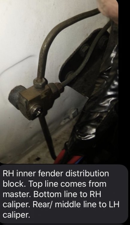

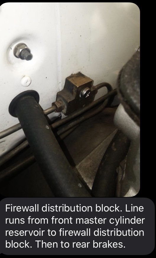

  14. Attached pics and info on how he ran lines. Ok so maybe the residual pressure should go back in once the issue is fixed? He is double checking the push rod length, he did have to adjust that at install. EDIT: One thing he wasn’t certain of was how tight the front caliper nut with the split should be.

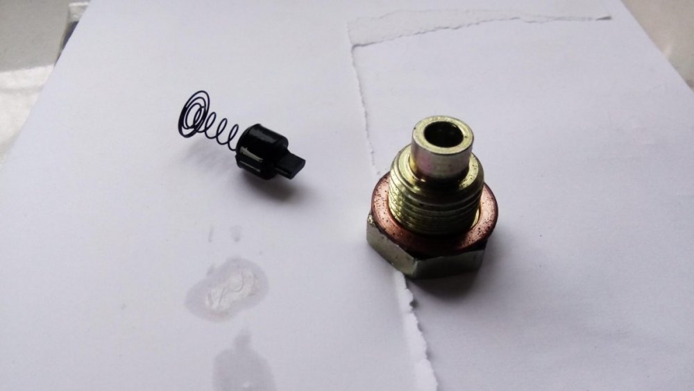

  15. Hi Dave, I’ll have to check if there’s been any other mods other that the twin reservoir master. Initially it was holding pressure all the time, rock hard peddle after a few applications, brakes red hot. He opened up the master and removed this (see pic). Following that is seemed ok, now it’s started doing it again. A short drive to the local servo with half a dozen brake applications, the fronts could not be turned by hand and were red hot. After 30mins you could doing them half a turn. Front calipers have been tested and they moved freely.
