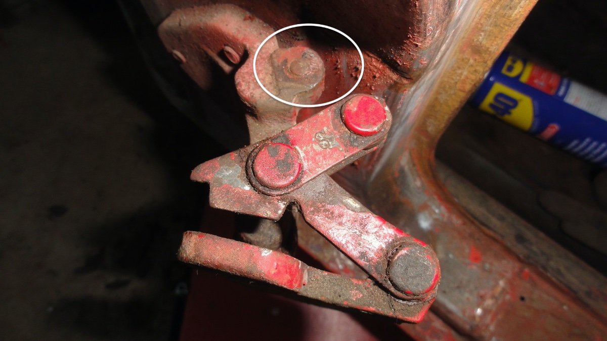

  1. Car now stripped to the A pillars some rust top corners of roof but not to bad. repaired passenger side. Removed passenger side lower door hinge and ordered a couple of rebuild kits as I was missing the springs and the rivet attaching the strap to the hinge was bust. Removing the pins was pretty easy just drifted out, the only problem was the pin attaching the strap to the hinge was too big so drilled out and all good, refitting pins bushes and spring was straight forward,

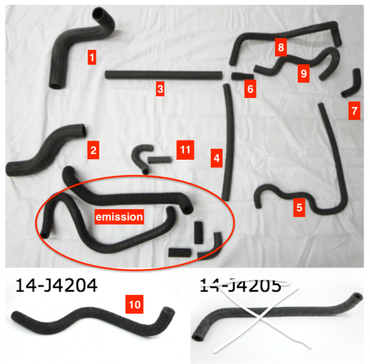

    What Hoses needed
    Do I need the lower hose in emission set for the water heating for carbs or can that be blanked off. Thanks

    What Hoses needed
    Thanks for your input a bit confused now one of these for the vacuum hose slide in a coat hanger wire bend to shape and leave wire in? so that goes from booster to manifold 1,2 radiator hoses 6 little reducer under carbs 3,8,9,7 heater hoses 5 vacuum hose 4 valve cover breather 10 vacuum hose 11 bypass so I don't need the vacuum hose and what others Any one got any old wire hose clamps willing to sell??? Thanks again for your help Nick

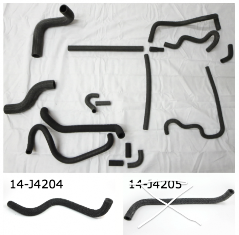

    What Hoses needed
    I have to replace all engine bay hoses can get a full set but has emission hoses that I don't need. So which are the hoses for early 240Z Also are the fuel hoses plain rubber? Also asked earlier after pics of decals and where to place. Thank you

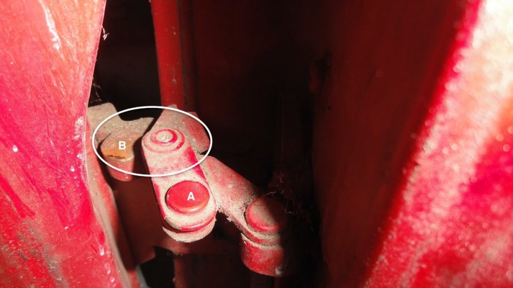

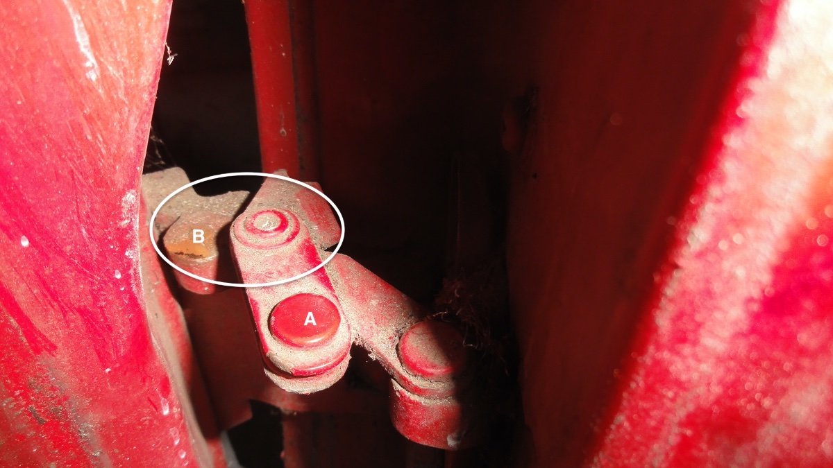

    Hinge help
    On removing the doors noticed that the springs were missing and that one of the pins was broken this was the same on both doors I assume that pin A should be longer and push in to B The drivers door is subtly different to passenger side the pin is peened over? Also should there be a spacer between A and B? Thanks
