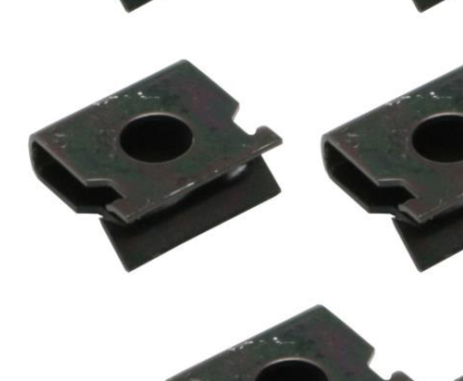

  22. Try to modify something like this?

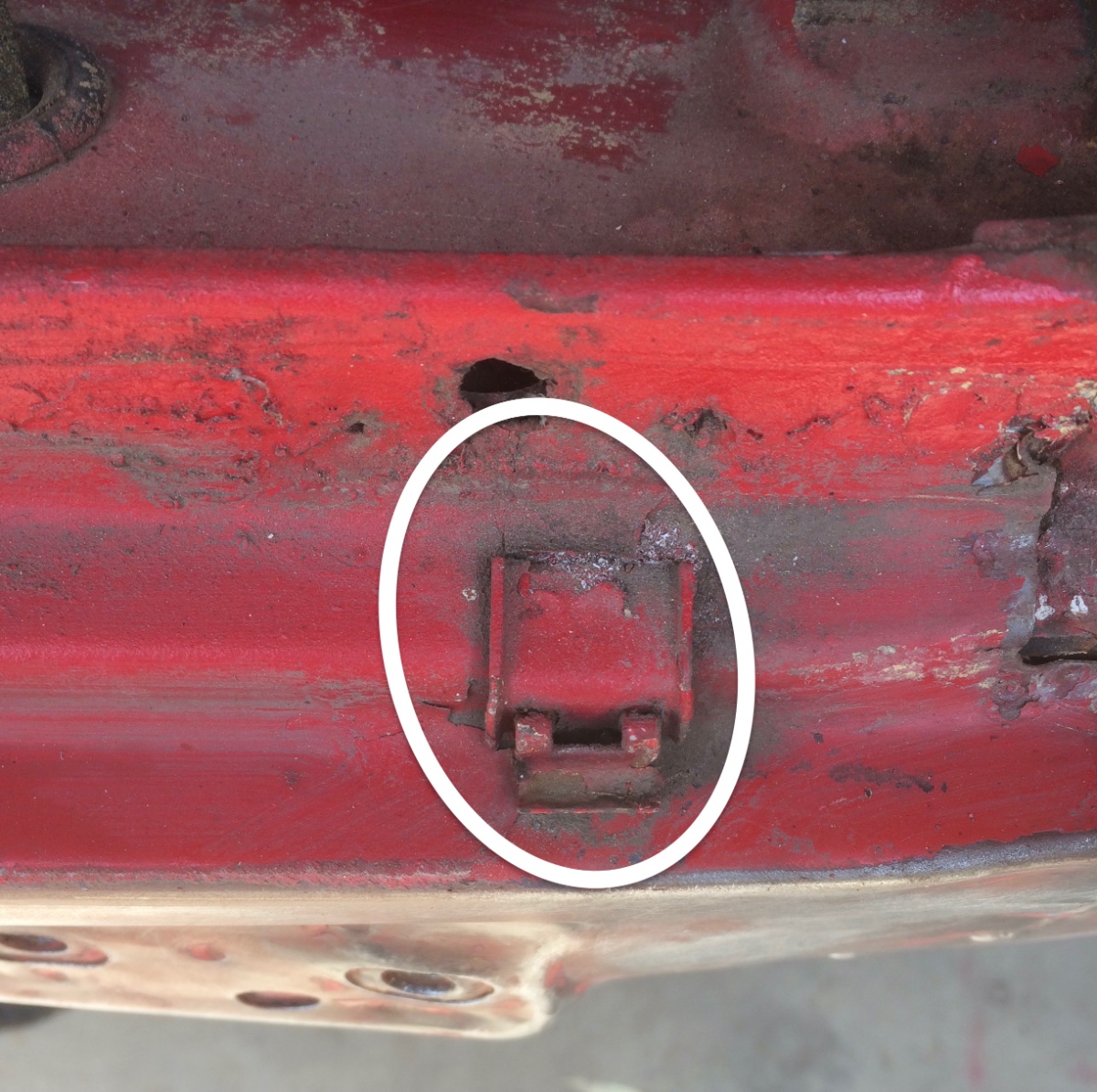

  23. Thanks but wrong clips need these

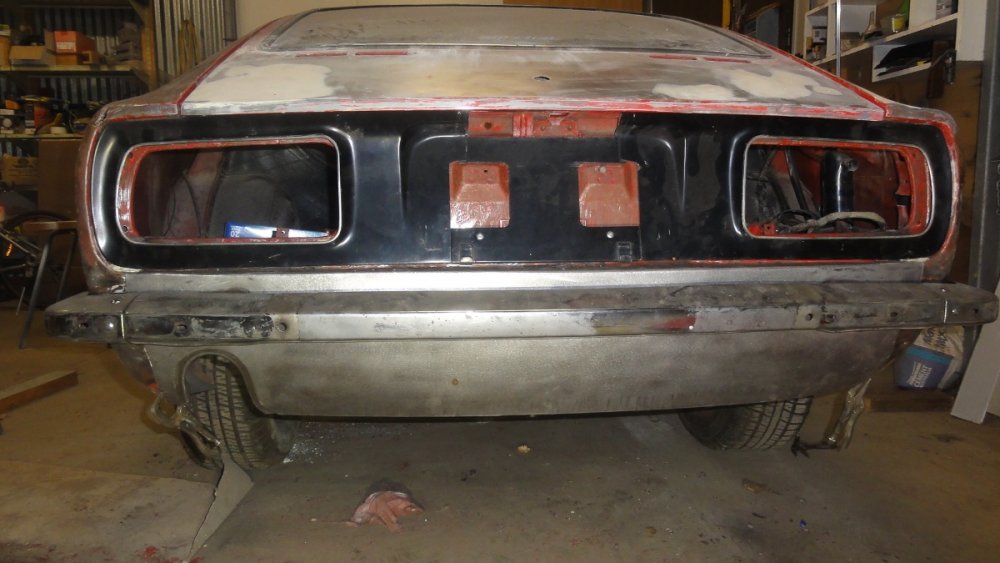

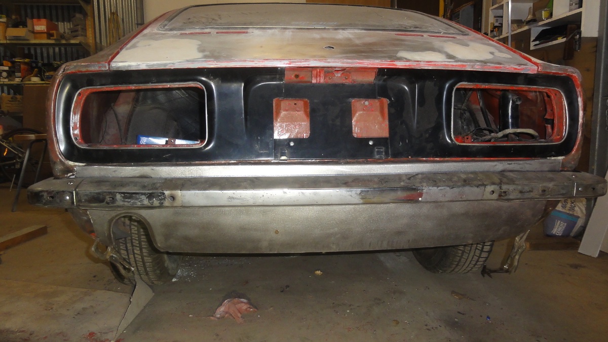

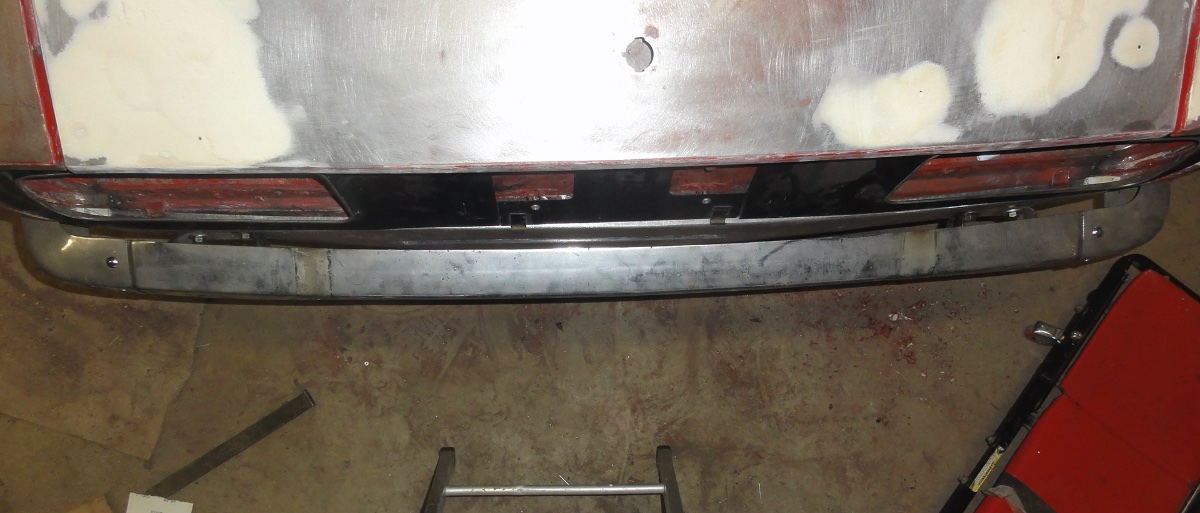

  24. After a lot of putting on and taking off valance, trim panels and bumper finally got it almost right or completely wrong I think the gap under the tail light trim is too big and the valance should be straight along the top The gap between the bumper and valance is almost uniform and the bumper needs to move to the left a little A big problem is how to attach the tail light trim panels as I do not have the required clips and don't really want to import them from USA So do the gaps need to be closed up and any ideas how to attach the trim Thanks
