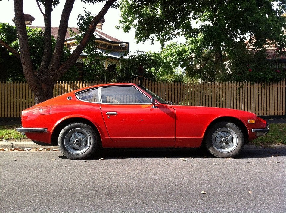

Herbonius Posted November 13, 2012 Posted November 13, 2012 Continuing my introduction thread - http://www.viczcar.com/forum/index.php/topic,11939 I picked up my red/orange 260Z from a bloke in QLD who unfortunately had a run of bad health just after he spent a significant amount of cash on restoring the car. This is the car I have been lusting over though for as long as I can remember so at least it's going to a good home. I have a cafe racer that I ride during the week so this will mostly be only used on the weekends. This is how the car currently looks: I has a L28 bored out to 3L. I couldn't be more happy with the condition of the body and interior. It's essentially flawless. I do have some things on my to do list though. [*]Switch to 240Z carbies -- The car is currently running extremely rich on the 260Z flat top carbies and I have no hope of getting a RWC in this condition. After talking with a couple of local Z experts, they have convinced me that I need to switch to 240Z carbies. I'm currently in the market if anyone is looking to sell. I need to do this as soon as possible [*]Switch to chrome mirrors -- The plastic mirrors don't do the car any justice at all. I've already ordered some mirrors that use the stock mounts from ebay. [*]Fix the locks -- Not happy with the hatch lock. [*]Switch to manual -- An auto doesn't do this car justice at all. Currently in the market for a manual transition. [*]Install larger wheels -- I know that the stock rims are highly sought after in America but I can't say that I'm a fan of small wheels. I like the looks of the 17" Simmons OM wheels as seen here: http://www.viczcar.com/member-rides/nigels-stunning-1973-datsun-240z or the 17" CCW Classics here: http://www.viczcar.com/member-rides/jared-cullops-retro-lime-green-240z [*]Install a stereo. -- I'll probably just make up a panel to fit over the tail light assembly and put some 6x9s in there. It currently has a non-working stock stereo. [*]Possibly fit an air dam. -- I like the look of some air dams but I want to see how the car looks with the new wheels before making a decision. I'm sure I'll have plenty of questions as I haven't owned a car in about 7 years so please bear with me! Quote
MaygZ Posted November 13, 2012 Posted November 13, 2012 Great find. I don't think I've seen an interior that clean on a Zed .... EVER! Quote
boyblunda Posted November 13, 2012 Posted November 13, 2012 Sensational shots. I hate to think what the previous owner spent to get the car to this stage and suspect that you have an exceptionable buy. Another possible example that supports the argument that it is better to buy someone else's project rather than embark on a project for yourself. I really like the outline of intentions you have prepared for your car. With regard to thoughts for the mirrors, I have just purchased and received a pair of BRE mirrors whichI hope to soon fit to my own project (along with a BRE front carbon fibre spoiler). My first impressions of these mirrors is that they are very well made and robust, and will suit the car nicely. My fall back position for this issue are the XB ford mirrors. You are off to a great start. Please post more pics or post a thread about your car, how you came to find it etc. Regards Dave Quote
Administrators gav240z Posted November 13, 2012 Administrators Posted November 13, 2012 Make sure to keep all the original bits you remove like those flat tops are the best ones I've seen in a long time condition wise. I also like ford tear drop mirrors or OEM door mirrors. I have some bullet mirrors but can't decide if I should fit them. I like the originals a lot. Wheel choice is a winner and please keep interior white. I had that combo on my first 240z love it. Quote

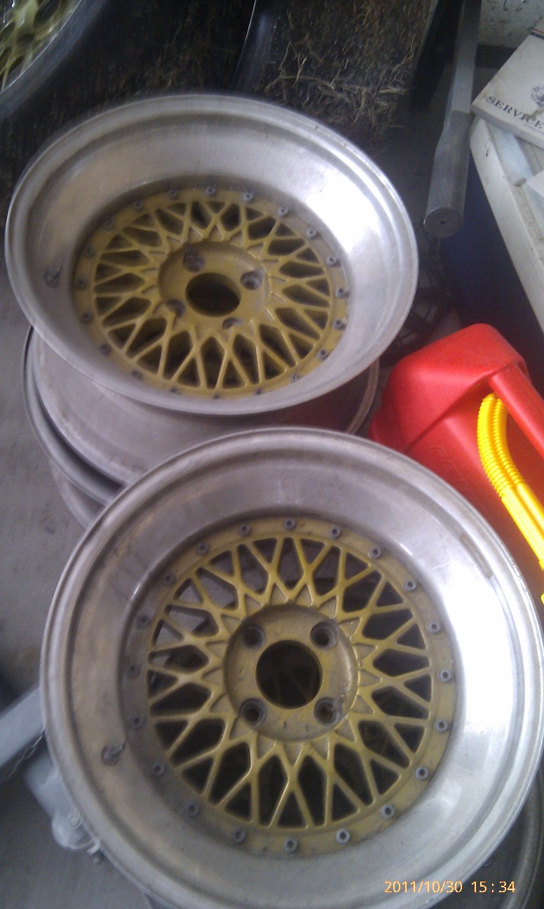

PZG302 Posted November 13, 2012 Posted November 13, 2012 If you want to step up to 18"wheels i have a set of 3 piece Oz wheels for sale of my old race car. they would need to be pulled apart and resealed and given a polish, but apart from that I think would suit the colour nicely. Quote
Herbonius Posted November 14, 2012 Author Posted November 14, 2012 If you want to step up to 18"wheels i have a set of 3 piece Oz wheels for sale of my old race car. they would need to be pulled apart and resealed and given a polish, but apart from that I think would suit the colour nicely. They are nice but I'm concerned about the size. I don't want to roll the fenders if at all possible and wont be installing flares. I can't find any pictures of a stock Zed on rims that large. Do you have any photos? DMed. Quote
