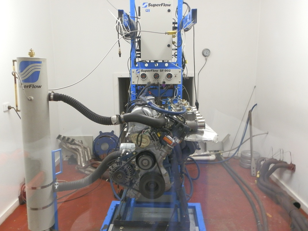

C.A.R. Posted April 3, 2012 Posted April 3, 2012 Has made a run this morning to 6000rpm - 320fwhp! Quote
d3c0y Posted April 3, 2012 Posted April 3, 2012 Lets just hope it makes another 50hp in the last 2000rpm Quote

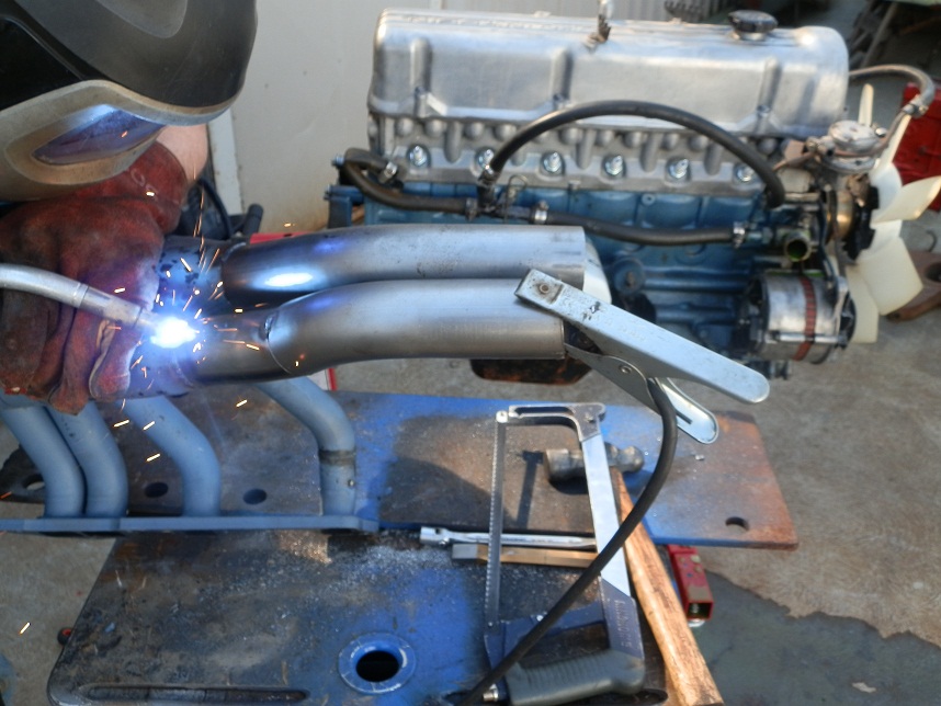

peter mc Posted April 3, 2012 Author Posted April 3, 2012 well its been a long day and its not over we will be back tomorrow with new pipes , we found the SW motor sport pipes stop at 330hp so we cut them off at the secondary pipe and run them up and made 344hp so we have to make bigger pipes and try again tomorrow . so far torque is better than any L28 at 4000rpm so its a good thing but we wont lots more so more tomorrow Quote

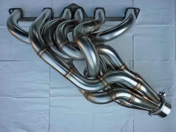

d3c0y Posted April 3, 2012 Posted April 3, 2012 so far torque is better than any L28 at 4000rpm so its a good thing but we wont lots more so more tomorrow Just to make this a bit more clear, it makes more torque at 4000rpm than an L28 at 8000rpm. Took me second to understand it over the phone lol. Looks like there might be some Kameari 6 into 1 octopus headers on the next container from Japan... oh dear... Quote

Administrators gav240z Posted April 3, 2012 Administrators Posted April 3, 2012 Yeah this is the most exciting thread of the year for me. How does it idle? It doesn't sound like it's too lumpy. I have a naive question, but generally speaking when you rebuild an engine there is a run in period. When you put it on a dyno like this, what is the run in process? Do you have to run it for several hours at different RPM's etc..? Quote
d3c0y Posted April 3, 2012 Posted April 3, 2012 Yeah this is the most exciting thread of the year for me. How does it idle? It doesn't sound like it's too lumpy. I asked Pete if i had to pull a spark plug lead off to give it cred at the lights. He said it should be able to do fine with all 6 on. Quote
peter mc Posted April 3, 2012 Author Posted April 3, 2012 Well its a long story after it starts and timing is set and carb balance is set its run at 3000 rpm for 30min , its lode is moved up and down and we check all mixtures and check to see the rings are bed in , you can see it when the rings are right as the engine stops brething and the torque comes up . then we run it up a bit at a time to see the ARF are right and make small changes like the tapets and timing . and then we get on it and see what happens . we also change oil and filter after a hour Quote

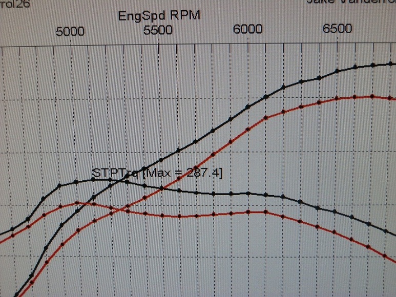

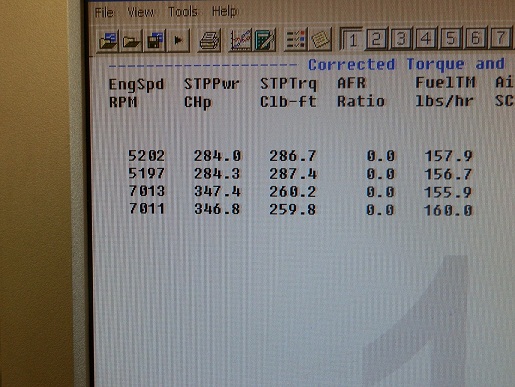

C.A.R. Posted April 4, 2012 Posted April 4, 2012 Made 350fwhp at 7000rpm. Time to ship your Zed down so Pete can fit the motor Quote
d3c0y Posted April 4, 2012 Posted April 4, 2012 Let's not forget 290lb/ft of torque! I'm going to be fitting this thing - I want some of the fun! It's still limited by the cam and headers Think some of these will be in the next container from Japan: Quote
saxon Posted April 4, 2012 Posted April 4, 2012 Awesome work guys! What about this one? Looks even more awesome. Quote
d3c0y Posted April 4, 2012 Posted April 4, 2012 It just looks super expensive and I cant find where to buy them I thought Kameari made them couldn't find one in the catalog though. Quote

peter mc Posted April 4, 2012 Author Posted April 4, 2012 gordo its over 200kw atw it was such a long day , we removed 6in out of the primary pipe and made larger sec pipe and made a new merge collector and first pull it made 10fts more from 4500 to 8000rpm ,,, we tyred so many things, but we know the pipe is to small at 1.5/8 , so it is what it is 290fp at 5000 is mad and power all the way to 7500 ... Quote
