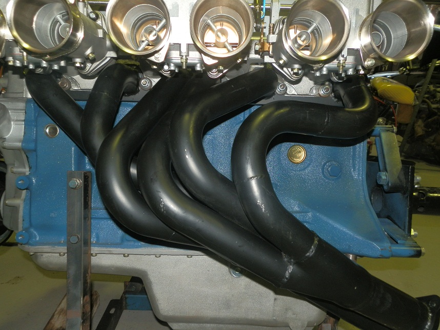

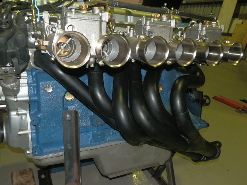

peter mc Posted May 14, 2012 Author Posted May 14, 2012 we made some big pipes for Jake's beast 13/4 primary pipe 21/4 secondary we will have it on the dyno this week Quote
luvemfast Posted May 14, 2012 Posted May 14, 2012 Look pretty good to me, kind of like my pipes Quote
d3c0y Posted May 14, 2012 Posted May 14, 2012 I think they look pretty darn awesome and always go before show! After they are HPC'd, have a heat shield over the top and put it the car, no one is even going to be getting that close to them so who cares? 48mm primaries must be frigging insanely huge, again i'm getting a bit more perspective on what we talk about on the phone regarding 6-1s and sill drag headers. Quote
handsandwhich Posted May 14, 2012 Posted May 14, 2012 I reckon they are pretty good for someone who doesn't weld/fabricate for a living. It's nice to be able to do things when you need them done and not have to rely on others to do it for you. Wish I could have built my own motor instead of farming it out to some jack of all trades know it all. <---- That's a joke BTW..... sort of. Quote
dat2kman Posted May 14, 2012 Posted May 14, 2012 Pete, when you run this up, have a play with continuing the two secondaries at the flange, into say, two long pipes say 1400 mm long, before they merge into a single 2.5" tailpipe, then progressively shorten the extended twin secondaries by say 150 mm a time, on each dyno pull. Watch the change in torque, you'll hit a "sweet" spot, then it will drop away. You know what it pulled rpm wise at peak torque before, run the comparisons! Keep the info to just you and Les, but I reckon Les will know already!!! BTW you two coming to Eden for the Bega Rally? I'm taking the Y to have a gentle rip on "those" roads!! Quote
peter mc Posted May 14, 2012 Author Posted May 14, 2012 your on the ball mate i have made adj sec pipes and that's the plan its the only way to get it right and i hope to get up there for the rally should be fun Quote

nizm0zed Posted May 15, 2012 Posted May 15, 2012 Absolutely stunning build, pete, for what its worth i think that exhaust is excellent. i'd happily pay good money for that, and thats saying something because im a bit of a tightarse I notice that you have the breather for the crankcase blocked off with a welsh plug. How do you find that affects the engine overall? I realise that if there is blowby past the piston rings it indicates a problem that needs to be addressed anyway, but i would think that the single breather in the rocker cover, and the associated 'vent/drain' hole in the head would be a bit on the small side once the engine was singing up near full power? Do you anticipate extra 'emissions' from using one breather? or is it in the grand scheme of things sufficient to work with what will be produced during normal running conditions? (do you plan to plumb it into the inlet? or vent to atmo? i would assume atmo.) Quote
