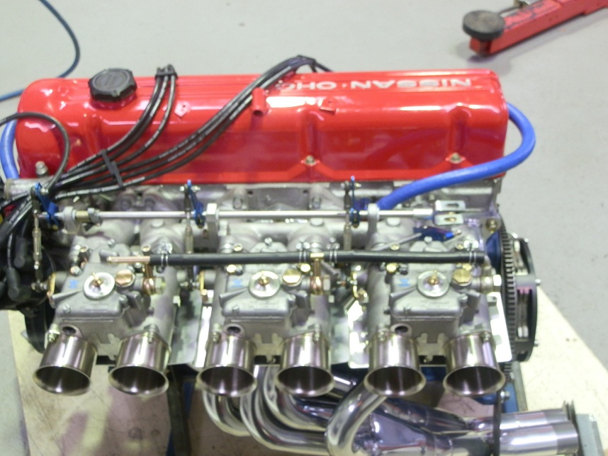

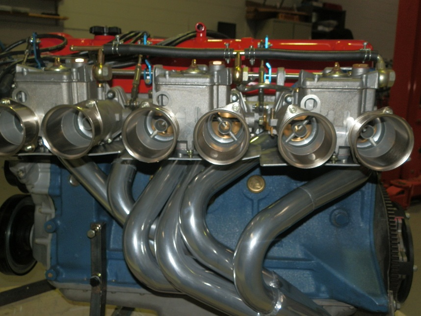

peter mc Posted July 6, 2012 Author Posted July 6, 2012 all done and boxed up be there soon jake Quote
luvemfast Posted July 6, 2012 Posted July 6, 2012 Mate look at that thing! The pipes look great and look at that f'ing clutch! Road car my a$$ But the highlight has to be that sump. Quote
RB26DETT Posted July 6, 2012 Posted July 6, 2012 DROOOLLL, look at that engine!!!! What a work of art. Jake is one lucky bugger.... Quote
