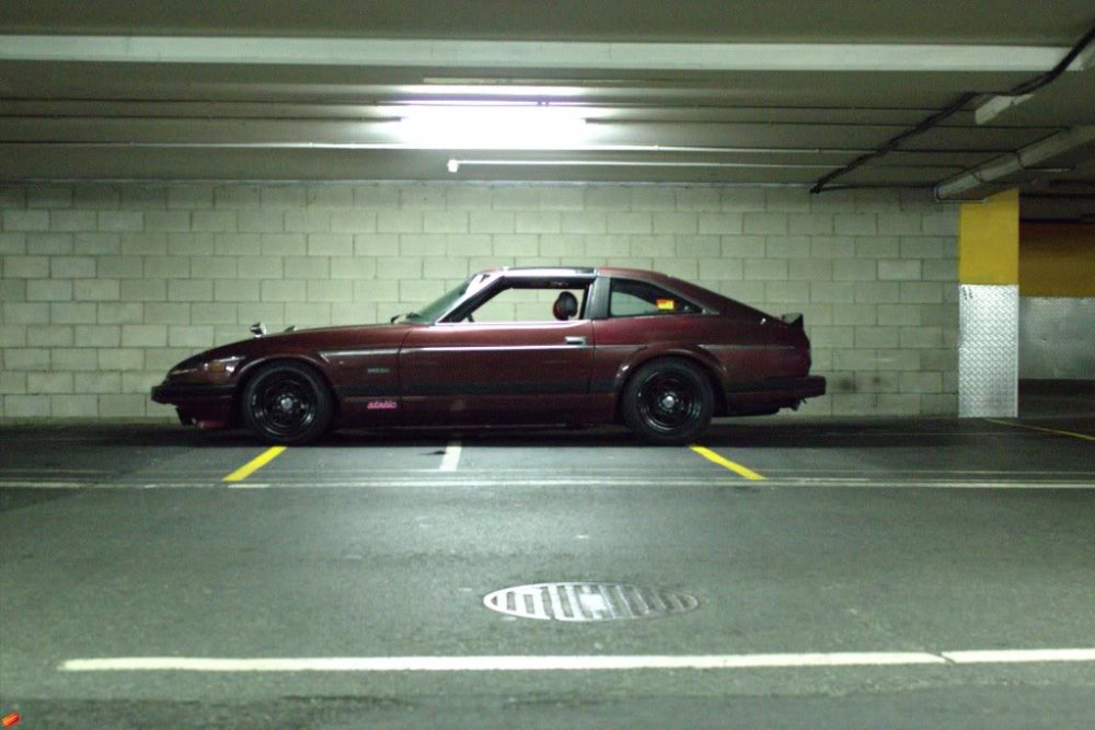

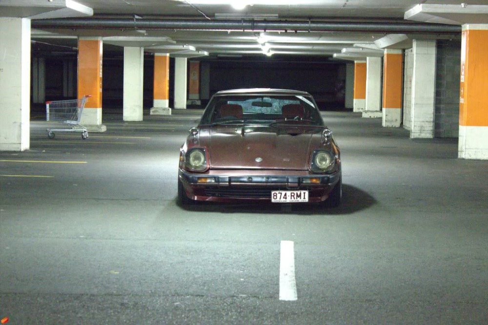

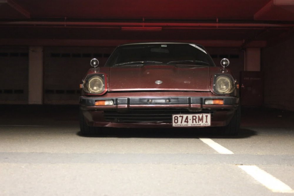

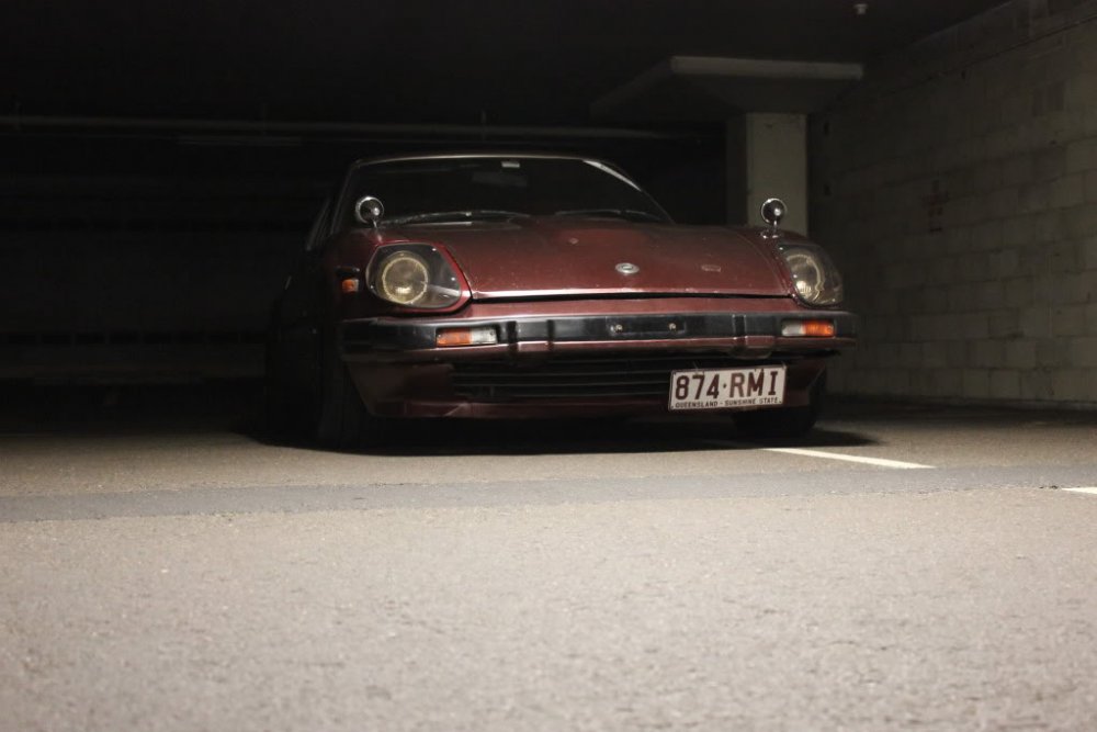

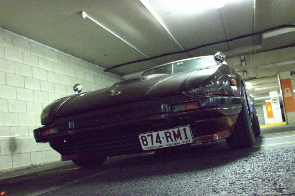

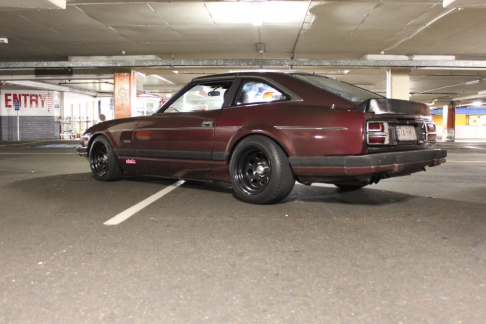

bullzed Posted February 27, 2012 Author Posted February 27, 2012 We took a photoshoot in the Indooroopilly underground car park last night, here is the fruit of our labour! I managed to get the stock 280ZX series 2 alloy centre caps onto my steelies and I refreshed the paint on them and the hood emblem. I'm considering another 5mm of drop to get the wheels closer to the guards! Quote
Stivva Posted March 21, 2012 Posted March 21, 2012 Looks awesome bro! I am digging the steelies. Still not sold on the tail lights though. Carbs are a manly touch! Quote

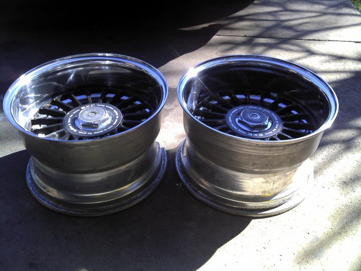

bullzed Posted July 3, 2012 Author Posted July 3, 2012 Oh wow I never knew... freaking australia huh? Well they're already 2 piece as they've been machined and bolted into bigger barrels. It'll have to be a custom barrel as I want such a negative offset! Quote
