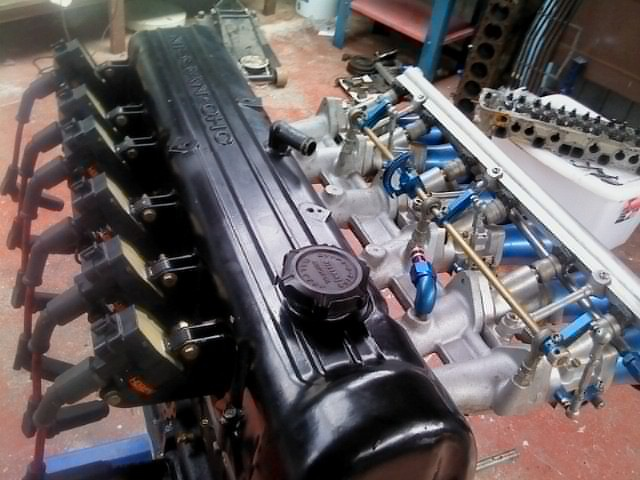

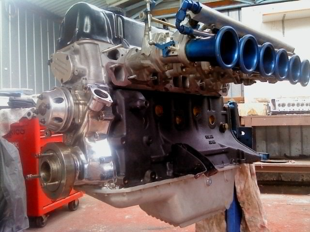

peter mc Posted February 12, 2011 Posted February 12, 2011 It has been slow going the last week with work, but have been very full on in the shed with this: It's is a L28 race motor, 13to1 CR, 600 th 300deg cam, fuel inj monster! Can not wait to test it! Quote
KatoKid Posted February 12, 2011 Posted February 12, 2011 Mmm...mmmm yes please. Dyno sheets to come??? Quote
peter mc Posted February 12, 2011 Author Posted February 12, 2011 yer there will be as it will be racing next week at sandown i will be fitting it to day and dyno in the next day or so Quote
Moderators Zedman240® Posted February 12, 2011 Moderators Posted February 12, 2011 I like the coil setup.. Are they the LS1 coils? Quote
NZeder Posted February 12, 2011 Posted February 12, 2011 Are those tappered bore EFI Hardware items Quote
bluerat Posted February 13, 2011 Posted February 13, 2011 Another question Pete, what the sump? Finned alloy? Quote
NZeder Posted February 13, 2011 Posted February 13, 2011 Another question Pete, what the sump? Finned alloy? My guess is the AZC item see http://www.arizonazcar.com/pan.html but I am sure Pete will confirm Quote
peter mc Posted February 13, 2011 Author Posted February 13, 2011 ok the engine ... has ls1 coils and the sump is from Arizona and the efi has tappered bores 48-45-42 the coils are fired by haltec the distributor is a Rb30 unit made by myself ,the rods are fj20 length pistons are custom to suit p90 head ,head is one of the best ones i have tested 230cfm inlet 155ex springs from japan kameri adj timing gear, cam from wade is a one of will be the first to try can not wait . crank has been lightend and de-stressed and heat treated .it runs a light flywheel and clutch also from Arizona. it will make about 180kw atw... Quote
KatoKid Posted February 13, 2011 Posted February 13, 2011 Damn, that Arizona sump is cheap for what it is. Expected much more $$$ Quote
mossy Posted February 13, 2011 Posted February 13, 2011 Damn, that Arizona sump is cheap for what it is. Expected much more $$$ Good with the aussie dollar too, picked one up for myself for when peter builds my l28 Quote
peter mc Posted February 13, 2011 Author Posted February 13, 2011 yer the sump is grate value and Dave at Arizona zcar is nice bloke and loves the z Quote
PZG302 Posted February 13, 2011 Posted February 13, 2011 Peter, how do you go with the injectors so far from the ports? My understanding is that with the revs the L series does you want the injectors as close to the ports as possible. I know that the 2 litre supertourers had the injectors at the air inlet but they were pulling over 9000 rpm and had bugger all torque in comparison to the power they made. Quote
peter mc Posted February 13, 2011 Author Posted February 13, 2011 the motor idles nice and pulls all the way with no flat spots in the curve peak power is at 6500 and only drops of about 4hp at 8000 lots of work on the exh to get it this way Quote

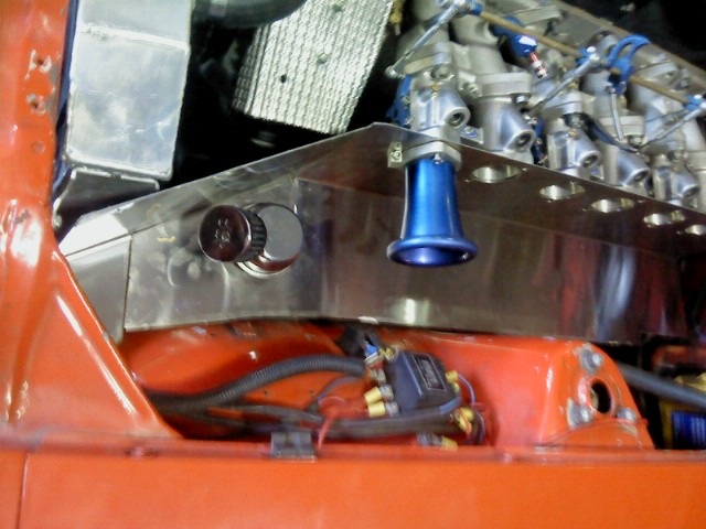

peter mc Posted March 17, 2011 Author Posted March 17, 2011 not my car but it feels like it as I'm always thinking about making it faster .on the dyno this week found air temps going up more than i would like so i made this nearly finished... Quote
RB30X Posted March 17, 2011 Posted March 17, 2011 How does it sound? And where are the injectors? Quote
peter mc Posted March 17, 2011 Author Posted March 17, 2011 had to take them of to get the heat shield in it sounds mad Quote
Moderators Zedman240® Posted March 17, 2011 Moderators Posted March 17, 2011 Looks like EFI hardware throttles.... Fuel rails hang over the trumpets heh? Peter, can u make another one while your at it? hehehe Quote
peter mc Posted March 30, 2011 Author Posted March 30, 2011 Just a bit more on the heat shield on the dyno to day found a 30c drop in air temp very happy all so very happy with The power 193kwatw best l28 I have put together can not wait to get to pi and test it Quote
