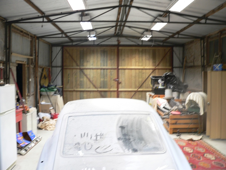

MaygZ Posted October 2, 2010 Posted October 2, 2010 Due to popular demand I have decided to begin my build thread . I have gained so much information, knowledge and courage from other members build threads that it only seems fair to start my own. My thread will amuse and mystify as I stumble from error to error and hopefully, with educated and constructive input from others, will also educate. Firstly some disclaimers: This will not be a fast build!! EXCUSES: 1. - I have a full time job that involves shift work, including weekends; 2. - I run a small unviable farm in central Victoria that requires constant management in such things as fencing and livestock management (and eradication of Onion Weed!!) 3. - I'm married and whilst my wife is very supportive of my need for a hobby, she doesn't like the shape of the Zed and therefore doesn't understand my fascination with it (She found me an LH Torana!!) 4. - I'm not a wealthy man 5. - I have skill/equipment and experience limitations that combined with my natural fastidiousness, create a slowness of it's own. These excuses will be added to as required. On with the story ..... My wife and I bought a very tired farm in Central Victoria about 2 years ago. The wife loved the house and I loved that it had an old shed, so in we moved! The shed had a dirt floor and was full of mouldy Hay, 30 years of accumulated junk from the previous owner and numerous birds, several snakes and assorted rodent nests in the roof sisilation! It had large wire mesh doors, that let wind and the above rodents/birds/snakes in! It had 2 GPO and two Flouros, so at least it had power!! Three 8 metre skips of rubbish out and a concrete floor poured in we were on the way. EBay provided some lights and a sparkie mate who helped me rough in some more power and I now have light and GPOs everywhere (even a 15Amp outlet!). I found a caravan and annex, so the annex, made of freezer panel, was attached to the side of the shed to create an office/bar/thinking/planning/relaxing area (Bloke's room). My daughter and I then came up with a somewhat unique fix for the breezy door problem. She learnt to use a drop saw as her first power tool! (measure twice ....Thumbs always stay .... etc) This was my first shed (larger than a garden shed), so I had very few tools (toys). Much time and money has been spent accumulating some basic tools. All the while hunting for a project car. Now I will be honest at this stage and admit that it wasn't always going to be a Zed. The Zed was one of four possibilities (Mark 1 Escort, Datsun 1600 and Ford Capri made up the others) but as I scoured the internet looking for cars and information, it was the discovery of this forum that knocked the others cars out. the information and community hooked me in. (My wife says thanks - she liked the Escort more!!) zoe280 1 Quote
benny Posted October 2, 2010 Posted October 2, 2010 Hey Brother love the shed..... much nicer then salty's ;D got some more pics of the beast?? Quote

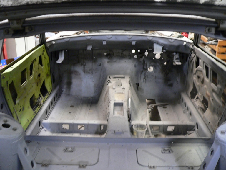

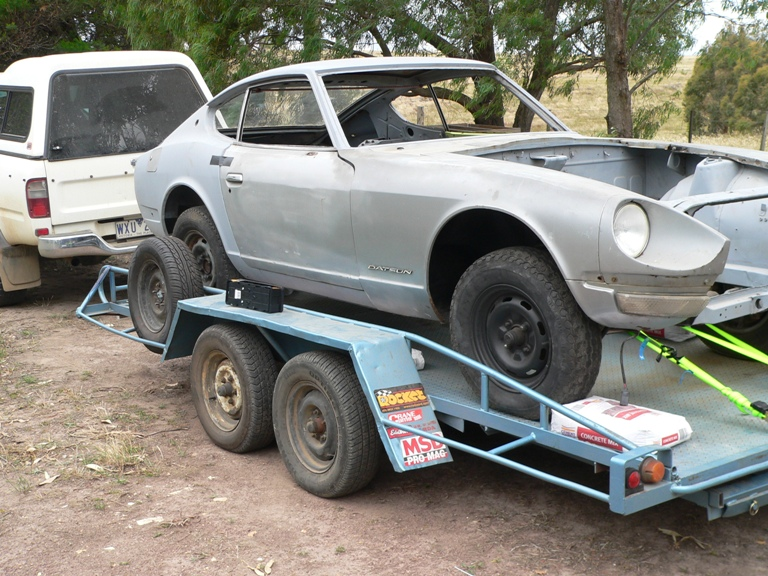

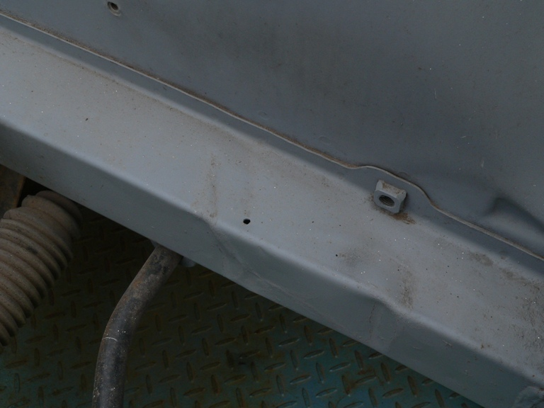

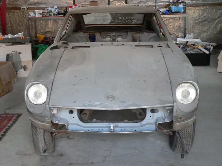

MaygZ Posted October 2, 2010 Author Posted October 2, 2010 Then in December 2009 I found a 240Z bare shell on eBay. I had a look at it and it didn't look too bad and it wasn't ridiculously priced. I had looked at several before this one and they had varied from terminal to dead! The owners wanted from silly to ridiculous money! I was getting desperate and this one looked pretty good through my rose coloured glasses. It was bought and towed home. The PO kindly threw in some spares including a dash, steering column and a few other bits. Now the shell was in a combination of very tired silver pain't and primer. It had some collision damage to the front left. This had bent the front rail and twisted the radiator support. Some rust repairs had been started around the battery tray that consisted of simply cutting the whole area out!! The bonnet didn't fit due to the damage and was in the car. The floors had rusted out and the bottom rails had been cut out and it appeared that a rail had been welded back in one of the holes upside down to fill the hole. The doors frames were pretty good, but the skins were badly rusted. There was small spots of rust in the doglegs and bottoms of the front guards. The PO also dropped off a 240Z half cut a few days later, to help with the repairs. I was assured that these were not major problems, but I had no idea what I was doing. Back when the 280ZX was a 'new' car, I was an apprentice motor mechanic. You know back when cars were simple machines, so I am confident that I can deal with most mechanical problems I find, but I had never used a MIG and had no idea about body repair. So I did TAFE courses in both - I highly recommend these courses - so now I have enough knowledge and confidence to get into trouble! Quote
MaygZ Posted October 2, 2010 Author Posted October 2, 2010 Some more .... The rest looked pretty good really. Quote

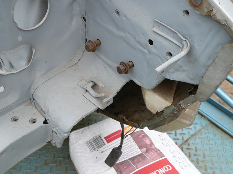

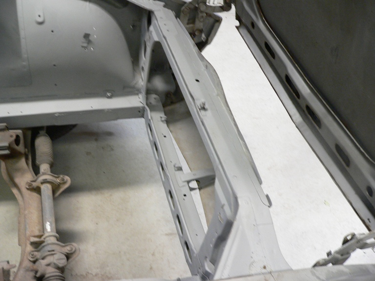

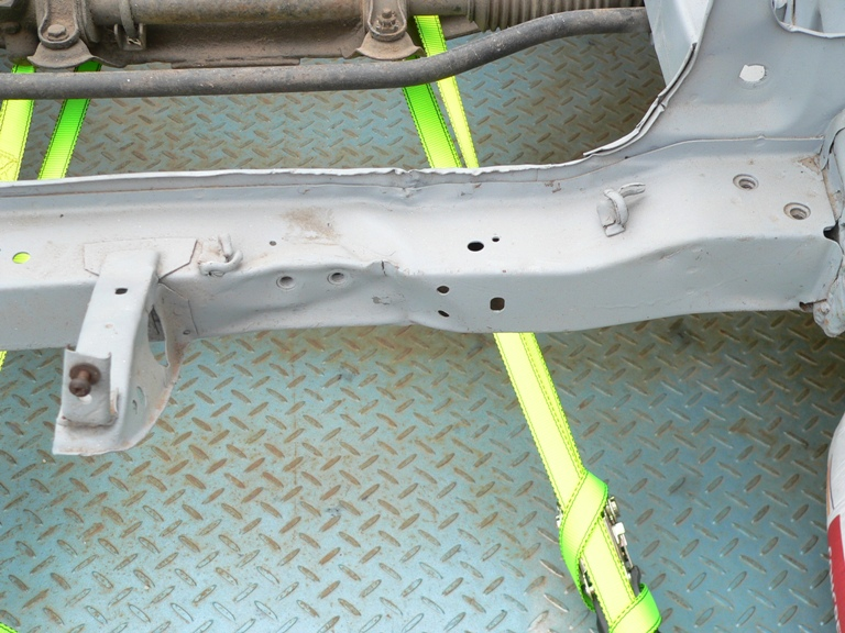

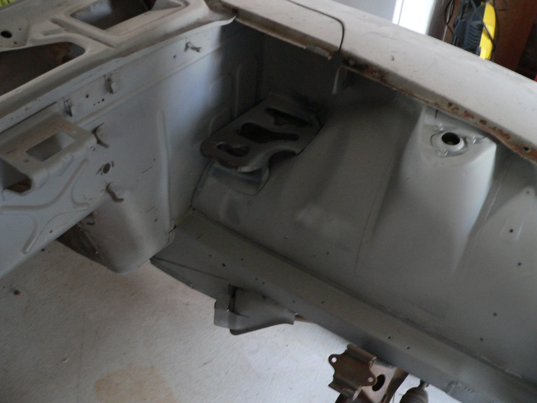

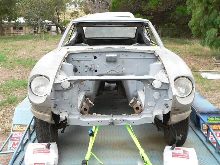

MaygZ Posted October 2, 2010 Author Posted October 2, 2010 So I started to run out of excuses to get started - and an obnoxious member of the forum was ragging me out - so first things first ... I needed to get the front rail straightened. This was beyond the scope of my basic course and my basic tools so off to the professionals. They set it up on the jig and pulled the rail straight. They were a little concerned about how thin the rail material was and even more so at the kinks in it, but the worked slowly (not in comparison to me) and got it straight. Then they needed to pull out the firewall a little to square of the front and the rail tore as they did. Bugger. But all was not lost ... in came the half cut. They cut it up and used the whole front tower and rail from it to replace the now limply hanging original. The half cut also provided the radiator support and the bottom rail. They were still concerned about the value of the replacement bits, due to possible concealed rust. they didn't want to cut up the original, weld on the replacement, only to find it was no good due to rust. we were standing out the back discussing this problem, when I looked over at the factory next door and saw the owner sandblasting, so a quick chat and he was now sandblasting my replacement parts. They came up well and were welded on. The bloke fitting it all together finished it quickly, but wouldn't stop apologising as he couldn't get it spot on. He was 1.5 mm out in the diagonal from 'A' pillar to radiator support!! I told him I forgave him and took my car home. The bonnet, that wouldn't go on as it overlapped the guards by more than an inch, now fitted beautifully. With this done, I now started stripping paint and bog (lots of bog) off the back. Now I find that it has been hit in the back left and has a fair bit of rust in the rear arches. Oh well nothing's perfect. It would have been boring if it all just bolted up together easily. Nothing to hard to to repair, so I'll keep stripping to get the big picture, spraying etch primer as I go. Quote
MaygZ Posted October 2, 2010 Author Posted October 2, 2010 And more?? So now I've got a battery tray and it's all nice and square(ish) Quote

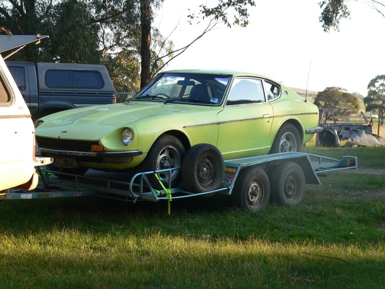

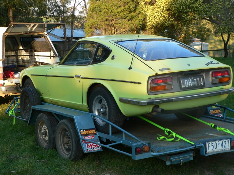

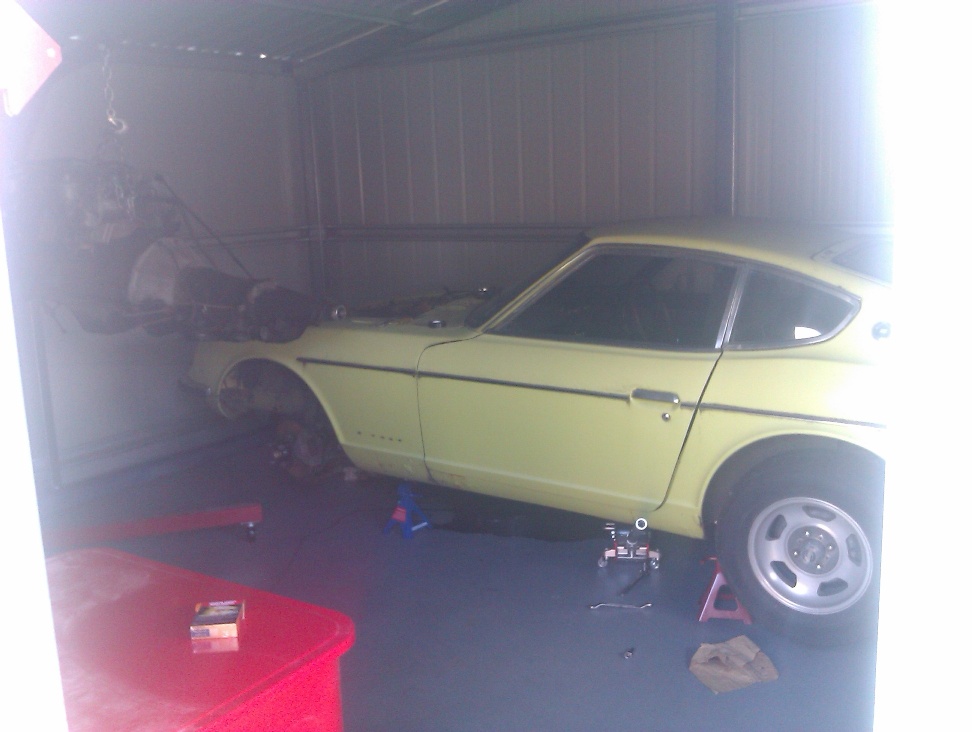

MaygZ Posted October 2, 2010 Author Posted October 2, 2010 Some of you will have noticed that there are lots of bits missing from this build. Many of you will know that I have been hunting very hard for a donor car. There don't seem to be many 240Zs out there that fit the category of 'Donor'. Most are either fully schmick or they just don't seem bad enough to cut into bits to build my car - and of course most are priced to high for what they are. I had all but given up and was looking at a 260Z that fitted the bill, allbeit and bit pricey. Then one of the guys on the forum contacted me - have I metioned I love the community of this forum? He knew of a rusty, but otherwise complete 240Z that was for sale. Contact was made. A reasonable price negotiated - pretty basic negotiation really; he said how much he wanted and I beat him down by saying OK!! So it got trailered home today. My gosh she's rusty. The rear hatch has rusted shut! It's easier to say the body sections that aren't rusted beyond repair and as soon as I find one I'll tell you!! BUT, it's complete! Seats are in good nick, the interior (with the exception of the throw away carpets) are all in a good state of repair - even the door trims are good! Jelly bean wheels with centre caps intact and with roadworthy tread - they were still inflated after more than 12 months in the front yard of the PO! L28 with P90 head! Round tops with filter box. As you can tell, I'm a bit excited. The only downside that I know of so far is - it's an auto, so eventually I'll need the bits to convert to manual - but that's just more fun!! Quote

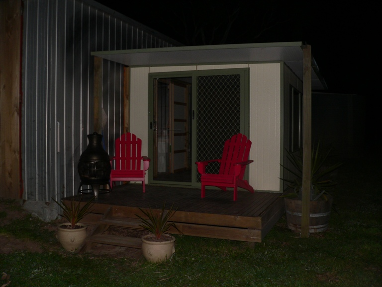

FLEXZED Posted October 4, 2010 Posted October 4, 2010 hey mate awesome write up, you have a great work area/shed there ( my rotissere would look good in there ) might have to came down and sit on that deck and enjoy the chimera and a few beers well done mate looking forward to the build now that you have a parts car Loui Quote

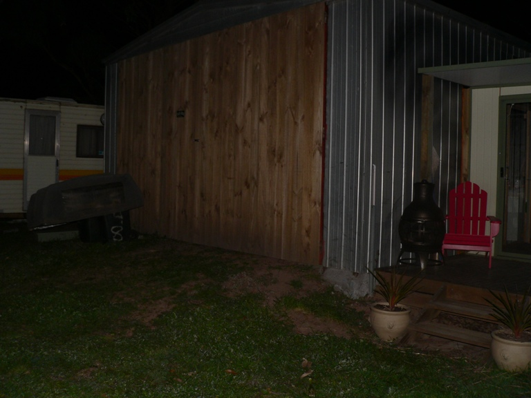

MaygZ Posted April 4, 2011 Author Posted April 4, 2011 Well something's happening. There has been a lot going on in the last couple of months. Not much of it on the Zed. For those that don't know, I've changed jobs, moved from near Kilmore to Bairnsdale. The new house has a small shed, as yet with no power :'( but as you can see from the first photo it's possibly a good move. The second photo shows my Lab, Jake, who has just had a shoulder reco @ $1600 and the next photo shows my Kelpie, Teddy, who had a fight with a Hilux. He's currently in ICU at Werribee @ $800/day. He'll cost about $5-6000 to get back now. This has cut into the budget more than a little. The next photo shows a man wedged tight into Martin Brundell's F1 car. Took nearly 10 minutes to get him out even though he wanted to get out. No they wouldn't let me start it Quote
benny Posted April 4, 2011 Posted April 4, 2011 two words..... nice shed try to keep it on topic simon!! Quote

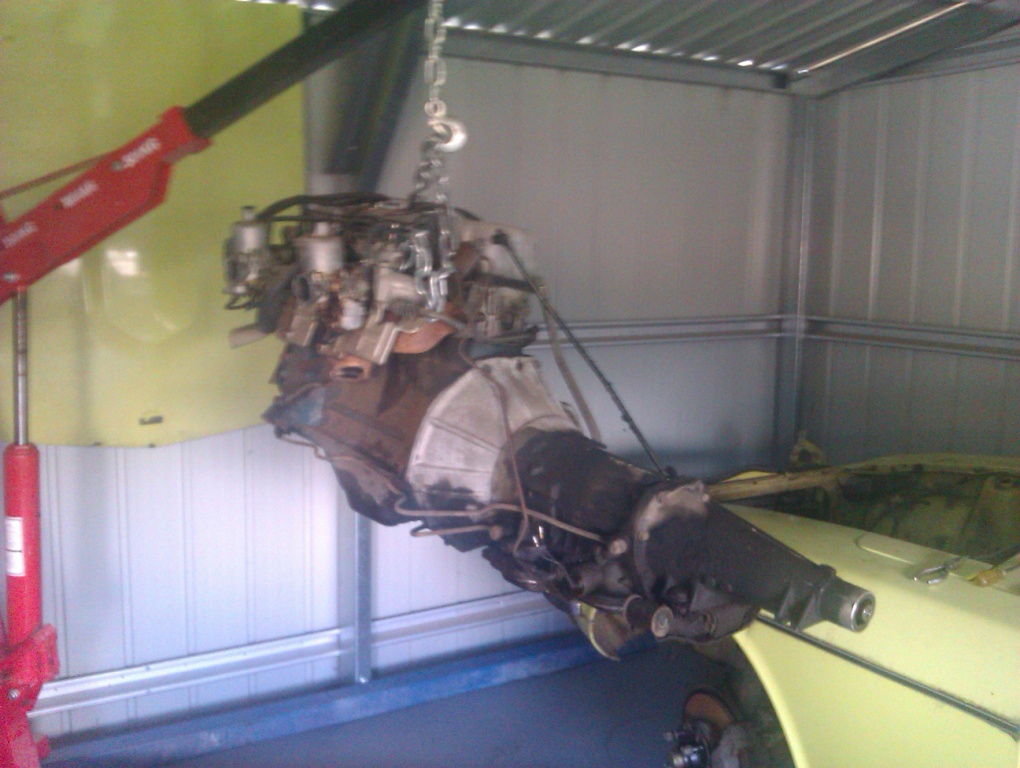

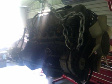

MaygZ Posted April 4, 2011 Author Posted April 4, 2011 But I have managed to squeeze in a little work on the Zed between work and trips back to the farm. As you can see the shed has shrunk :'( The engine and auto are out of the parts car. I forgot how much oil comes out the back of on of these boxes, so a bit of clean up to do. The block is a 54 and the head is a P90. No idea of the engine internals as yet. It will be interesting to see. The box is an auto, so who cares about it. I'll give it a clean up and then it can be an artificial reef! Everything looks good so far. Quote

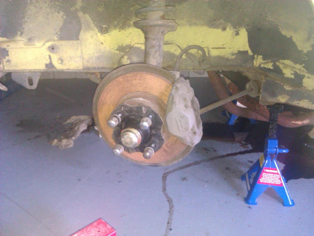

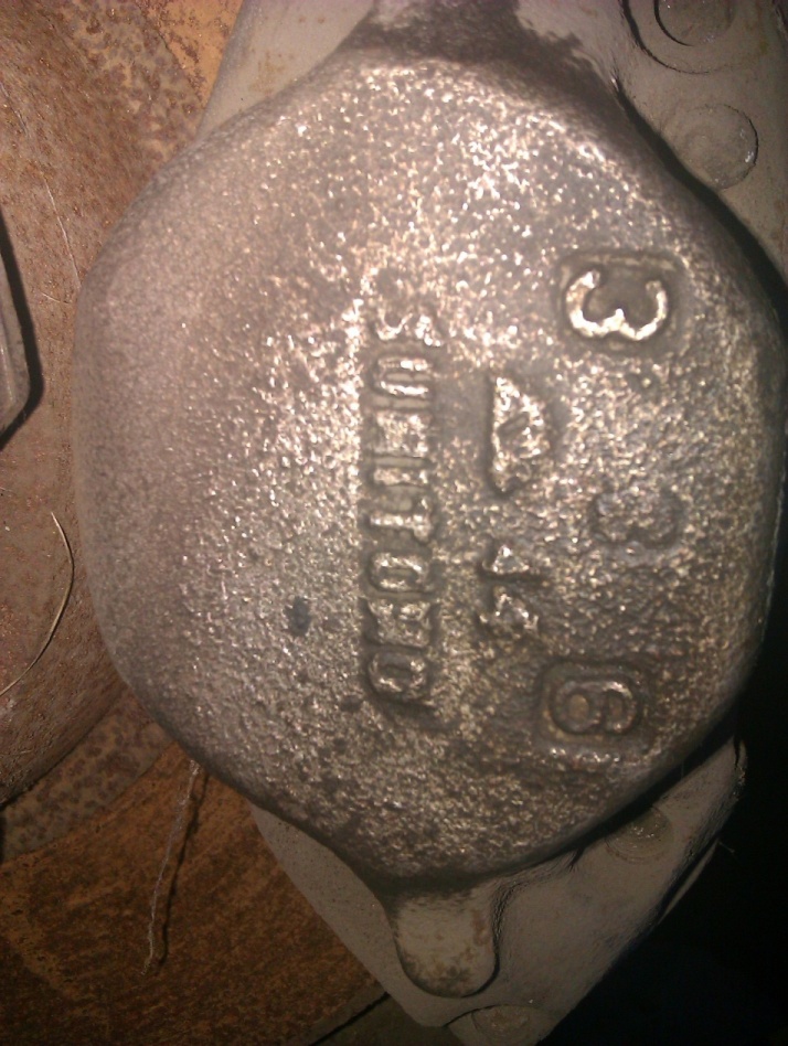

MaygZ Posted April 4, 2011 Author Posted April 4, 2011 Can someone tell me if these are the standard front calipers? Quote
benny Posted April 4, 2011 Posted April 4, 2011 they look the same as the ones on mine, so standard!! Quote
