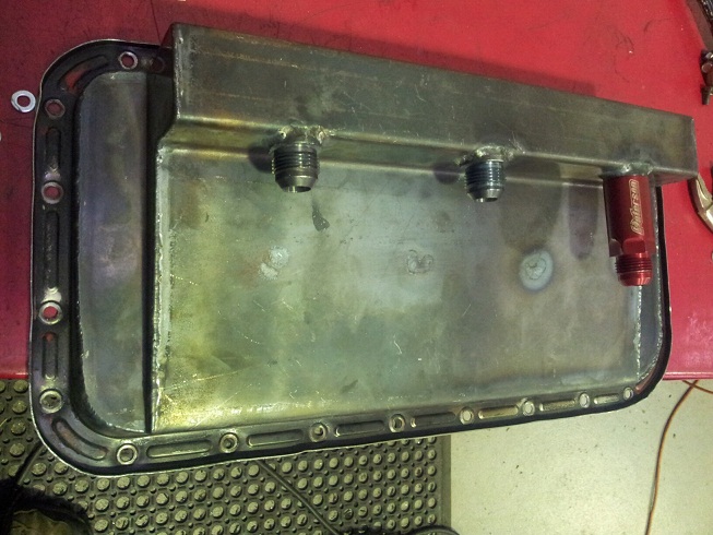

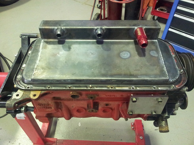

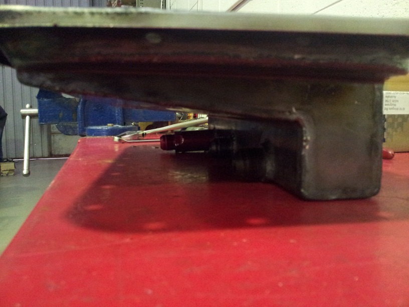

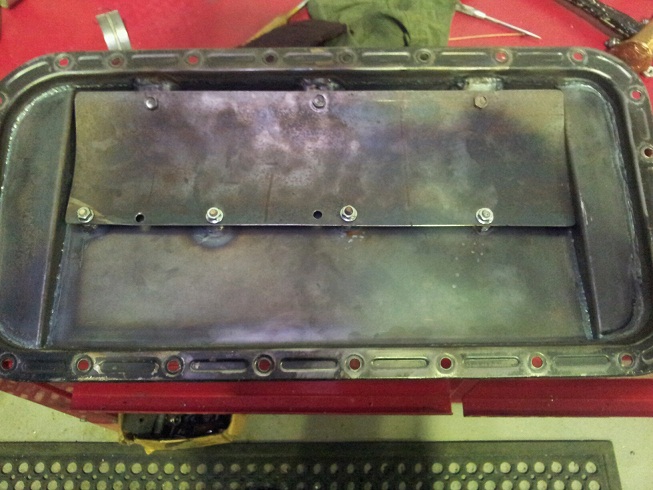

peter mc Posted March 1, 2012 Posted March 1, 2012 hi well its still in the shed ,heheh so i started to work on it ,, iv made my mind up im building the fj20 turbo , the first job make the dry sump and mount the pump and make the frunt drive , there are no parts you can buy so i have to make all of them . Hear is some pics of the sump Quote

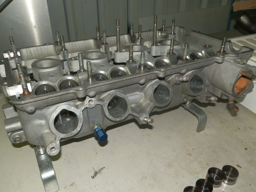

peter mc Posted March 1, 2012 Posted March 1, 2012 yep that's the plan Simon , Les is helping with the fab work so we can get the FJ low and back as far as it will go , I'm working the head and manifolds over and making the crank lighter should be about 600hp and lots of fun to drive Quote
Scando Posted March 1, 2012 Posted March 1, 2012 Great to hear you're keeping the car and continuing on with it. It will be a rocketship with 600hp and a 4 cylinder mounted up against the firewall. Quote

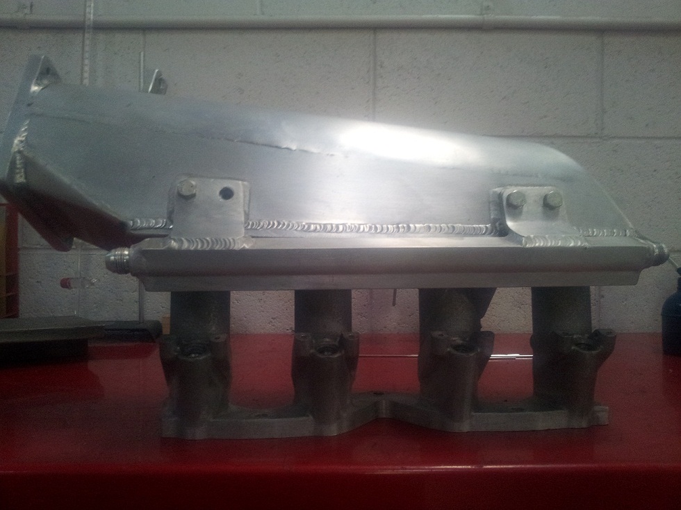

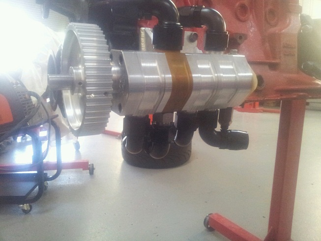

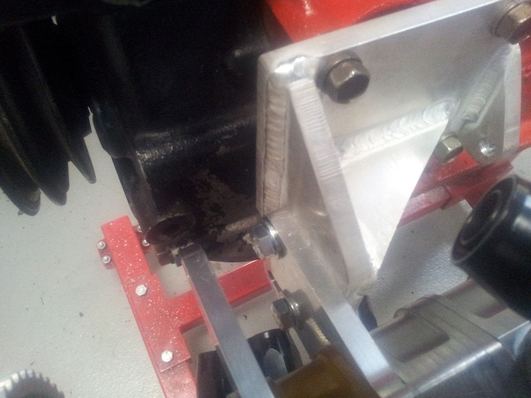

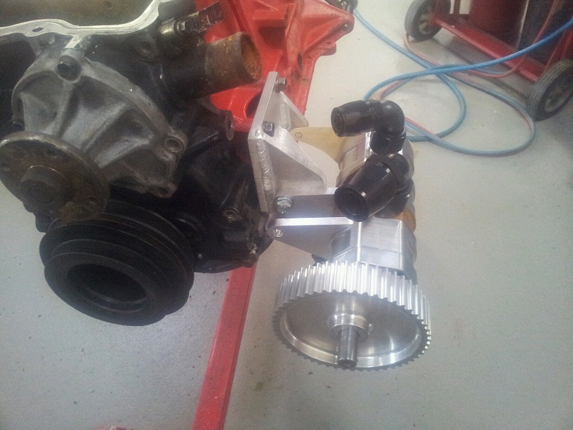

peter mc Posted March 2, 2012 Posted March 2, 2012 well theres some work to get throu before i get near a track hears some work i got throu today , i made the bracket for the oil pump and started on the inlet manifold , needs to be a bit smaller in volume from the drag spec unit Quote

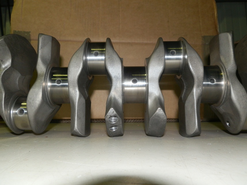

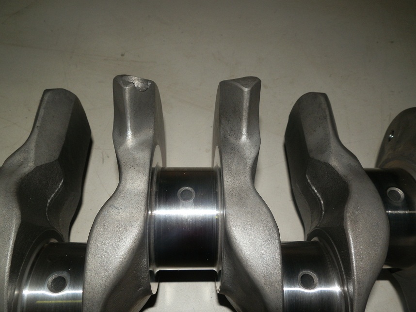

peter mc Posted June 12, 2012 Posted June 12, 2012 I have finally had some time to work on my fj20 , it was just a set of rings lol but it needed a new crank new pistons new head and all guides and chains ,, it went on and on till it was i replaced the hole thing and its now 2.2 , hope to have it finished soon Quote
d3c0y Posted June 12, 2012 Posted June 12, 2012 How are you going to mount the A/C compressor now the oil pump is in the way??? Quote
