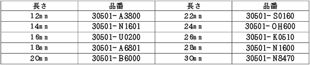

NZeder Posted May 18, 2010 Posted May 18, 2010 Sounds like it's got the wrong (i.e. short) throw out bearing cradle fitted... I agree - Nissan made a number of different sizes - from 12mm upto 30mm - depends on the front cover, fork pivot and release bearing. Quote
NZeder Posted May 18, 2010 Posted May 18, 2010 Here are part numbers for the different length release bearing carriers Quote
