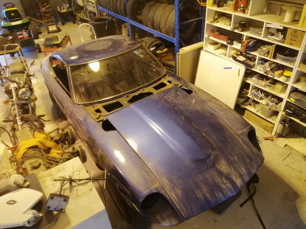

Chipp Posted January 17, 2023 Posted January 17, 2023 Hi Brains Trust My New Years resolution is to finally (after 15 years) get my Blue 240z back on the road and would like to hear your thoughts on what I should do. My car appears to have minimal visible rust, a couple of panel dings and Vinyl roof removed. I understand that there is most likely unseen rust and they can rust from the inside out but after 50 years all of the known rust spots are still solid After speaking with to a couple of paint and panel shops I am in 2 minds as to whether to just get the repairs done or go down the full restoration route. My concern is that if I go down the full restoration route the Zed wont get used as it would become an investment and not a car to take out and drive. Most likely I would just take my other unrestored red zed driving instead. Your feedback would be greatly appreciated Quote

Chipp Posted January 18, 2023 Author Posted January 18, 2023 That is a valid question and at this moment a difficult one for me to answer. At this moment there is no budget restraints but I dont want to over capitalise. At the time of taking the zed off the road it was my club car to compete in the odd hill climb, TRE Rallys etc and I would still like to do this and not be scared of scratching a spoiler or rim etc . If I purchased this car to day it would cost in the order of $45k to $55k so spending another $70k to $100k isnt making sense and turns it into an investment. No doubt If it was a $15k zed shell I wouldnt have any issues spending the cost to restore the shell. My concern is that the restoration companies in Newcastle want to immediately starting to undrilling spot welds to look for hidden rust inside rails and behind guards even though there is no signs of rust. My thinking is repair the areas I know about (bubbles no holes) and maybe look very closely at the known issue area and repair and replace if needed (Battery tray rear lights areas etc) or is going to cost as much as restoration . Am I way off here? What would others do in this situation? Your feedback is greatly appreicated Quote

Chipp Posted January 18, 2023 Author Posted January 18, 2023 Yes I definetly have no issues with going back to bare metal in those areas and the usual suspect areas but a couple of the panel beaters are suggesting removing sills just to check in behind them to look for rust. With restorations is it the rust removal and metal replacement that is the costly component? or is it smoothing the waves in the metal of the 50 year old body? The paint and panel companies said they can spend a 1000 of hour getting the body lines smoothed with no filler. Is this to a concourse level or is this to a level to what it was like when it came off the production line (minus the rust)? Quote
