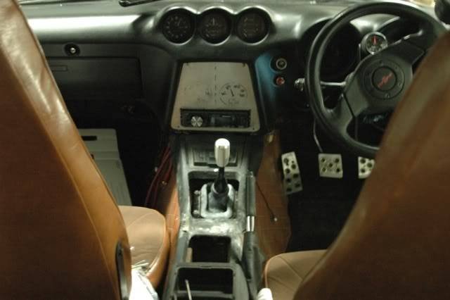

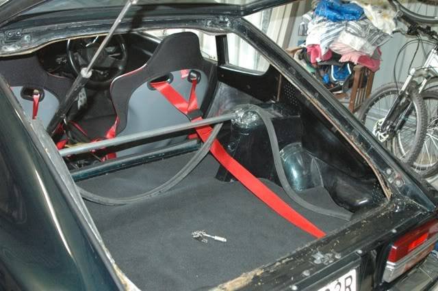

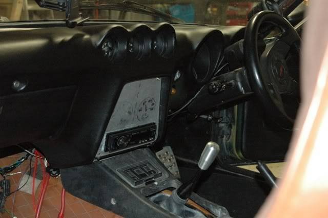

nuclear_z Posted December 14, 2008 Author Posted December 14, 2008 Another issue I noted over the nasty wet last week was the rear lid leaked a bit so today I pulled the rear seal off, cleaned all the old qwikgrip off, cleaned the rubber and put it back on... And here is some shots of the relatively nasty interior... I am going to pull the centre console out this week and start the re-build of it... I am thinking that I will take the ash tray out and put a couple of drink holders in there... thoughts? As you can see the centre of the main dash is pretty fugly... Sourcing new gear now... [/img] Quote
nuclear_z Posted December 16, 2008 Author Posted December 16, 2008 Last night was GREAT I removed that God ugly turbo timer you can see in the photo above under the steering column... THe best part was that is was only taped onto the ignition wires, not even soldered! One less defect for the car I got the central locking working With the alarm being installed this Sat, I should have remote central locking like a modern car I removed the fuel pump kill switch as it was twin-binded speaker wire running from the engine bay right around the car (abour 3.5m long) and have hooked it up using proper wire onto a switch in the dash that wasn't being used... I think I will take it to an Auto-Elecy at some point and have him tidy up some of the relays and extra wiring for the computer as I dont want to touch it... Its all coming along well... Quote

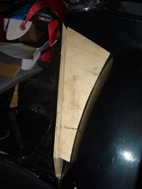

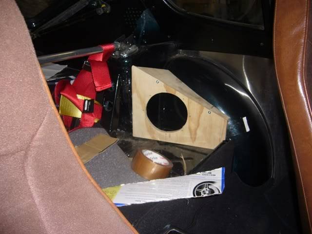

nuclear_z Posted December 22, 2008 Author Posted December 22, 2008 Well some photos of the new sound system, the crazy under bonnet sight and the new speaker boxes that will be hopefully look great in the car. So here is the kit to date: And the rough beginning of the speaker boxes: Can anyone with speakers mounted in the fornt of their car please post some photos so I can get an idea how to mount some in the front so that I get a well staged sound??? I have had only decent speakers in the rear of the line, and I am getting annoyed with having sound coming from behind. Quote

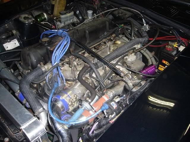

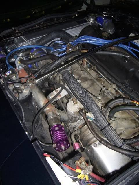

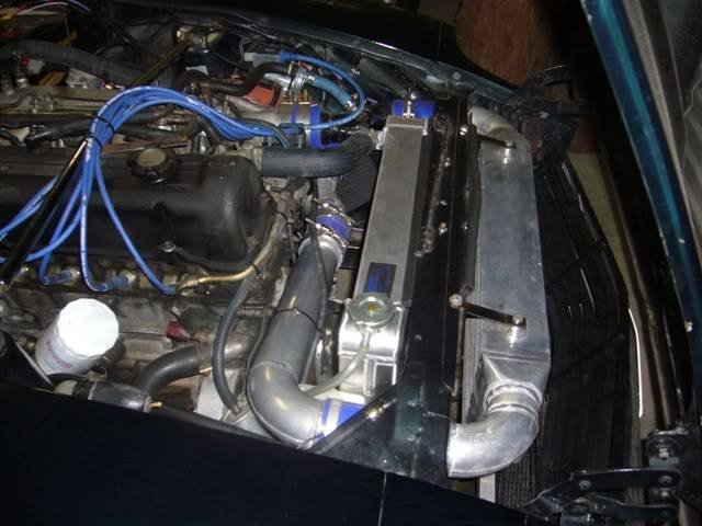

nuclear_z Posted December 22, 2008 Author Posted December 22, 2008 And some photos of the decidedly dodegy engine bay: With the new GTR BOV it should clean the bay up a bit... I want to have a good look at the intercooler piping over the Christmas break and TIDY THE DAMN WIRING!!! Quote

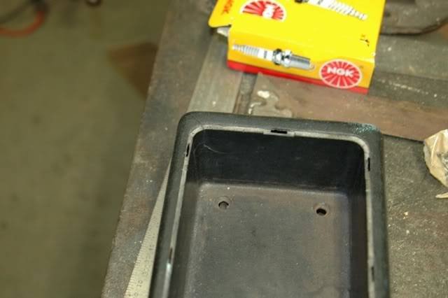

nuclear_z Posted December 27, 2008 Author Posted December 27, 2008 Well guys today was MASSIVE I started out the day by Modifying Michael's gear-stick so that he can fit his centre console back in.... Hope it works out well for him Then, I changed the oil, filter and spark plugs in the car. Runs so much smoother now... One thiing that had me baffled was the amount of condensation / water that came out the exhaust when I turned it on... I did a compression check before I bought the car and all cylinders were a nice 125psi each - so I hope it is just condensation as I hadnt turned the car on in a few days... Next - THE CENTRE CONSOLE My centre console was pretty badly cracked and not in nice shape. Enter the nasty fibreglass crap... Here some photos of the dash pre-glass... I then used my trusty dremmel to sand back all the edges of the cracks and drill the ends to stop from from opening up again once they are glassed up. I hate fiberglass. I am itchy all over from the shit. But, heres some of the photos of the topside glassing.... And then sanded back so that just the cracks have been filled up. I will glass the backside of the cracks tomorrow. Then the nasty business of sanding all the texture off, bogging the console so that it can be high-filled and then painted with the texture paint... I am thinking that I am going to remove the ashtray and build in a cup holder. Just so people dont think that i'm lazy, I then removed the shitty centre dash panel and have made a new one, that fits better and mounted my new head unit in. here it is... Tell me any thoughts or suggestions.... Cheers Quote
