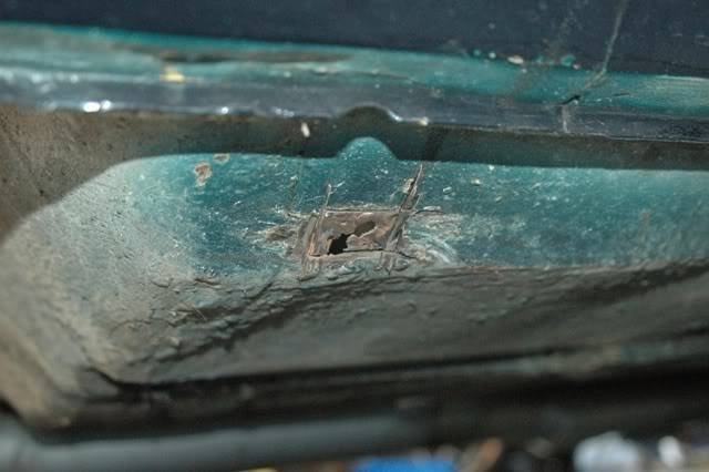

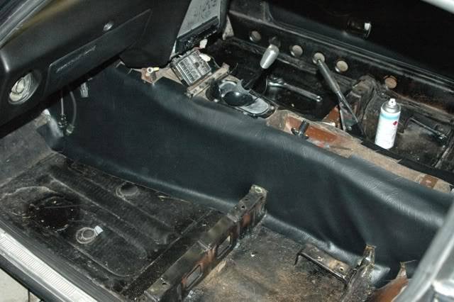

nuclear_z Posted December 30, 2008 Author Posted December 30, 2008 Well progress I have retrimmed the transmission tunnel in black vinyl and it looks infinately better than the brown cross hatch. I still have the original covering with no tears should anyone be interested. The nasty suprise was finding lots of little holes in the floor... Which funnily enough would explain the wet feet after driving it in the rain for a short while. So I pull out the welder and zapped them all up... There was some bigger parts which I had to cut and repair... Quote
stevo_gj Posted December 30, 2008 Posted December 30, 2008 Nice work, the black does indeed look a lot better! Quote

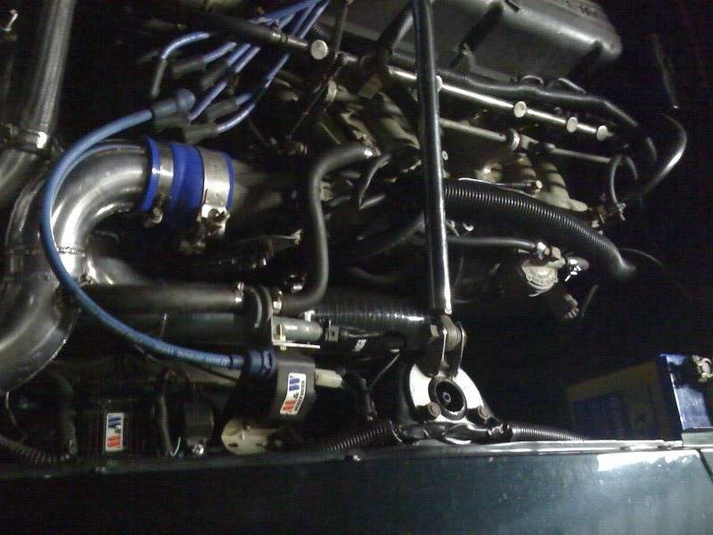

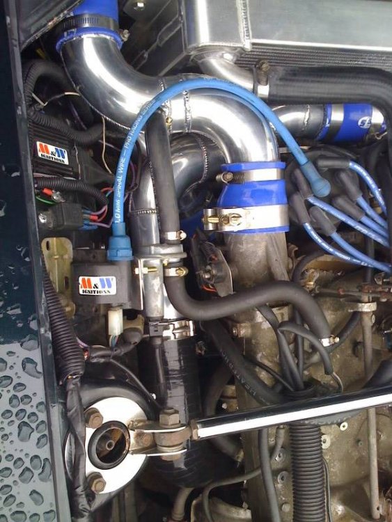

nuclear_z Posted March 11, 2009 Author Posted March 11, 2009 Well I just got back from Drift Garage!!!! Lewis is awesome and his skills are awesome! He has redone a heap of intercooler piping in the engine, moved the pod filter out the front of the radiator support panel. Check it out below. DRIFT GARAGE: aweomse. He prices are pretty good. PM me and i'll let you know. I tried talking to Otomoto about wheel and hub options and possibly having them source some parts for me but they didnt seem interested... I have spoken to my engineer and basically come to the conclusion that I am not going to engineer my wheels, but will get a report for the turbo, efi, brakes and suspension So as of next Wednesday I will be totally legal Well, apart from the massive spacers and the wheels Quote
