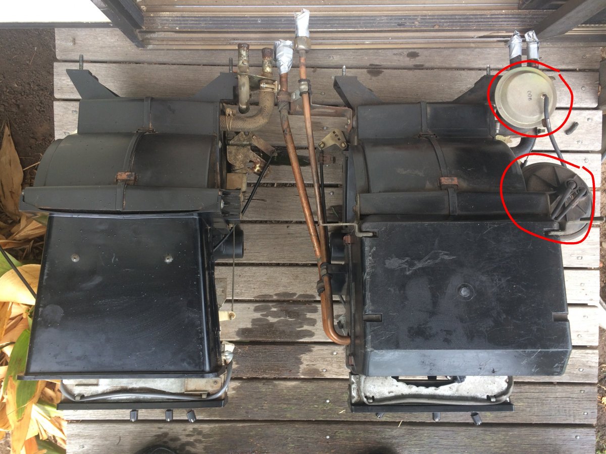

AndBir Posted September 7, 2020 Posted September 7, 2020 16 hours ago, aircobra said: so ideally after a complete set of condesor,evap + housing ,bracket and controls I am going down the same route (but easier with a 260z) and interested to know what you will be doing for the vacuum parts/controls? Quote
gilltech Posted September 7, 2020 Posted September 7, 2020 Quote I am going down the same route (but easier with a 260z) and interested to know what you will be doing for the vacuum parts/controls? Can you not pick up a complete set-up from a parted-out car fro your 260Z? Plenty of 260Zs in Aus seemed to have A/C. You'll need the A/C version of the heater control panel with its extra controls. Quote
AndBir Posted September 7, 2020 Posted September 7, 2020 26 minutes ago, gilltech said: Plenty of 260Zs in Aus seemed to have A/C That is correct however, once the air con failed, it appears the first thing done is to remove anything air con related from the engine bay. 28 minutes ago, gilltech said: You'll need the A/C version of the heater control panel with its extra controls Have one Mine on the left, A/C replacement to be installed on the right. Quote
aircobra Posted September 7, 2020 Author Posted September 7, 2020 right, that's the type of box i will need to fabricate and that's what's shown in the jdm pic. as far as the vacuum question is concerned, from what i can tell from the pics, the whole vacuum circuit is only used to pull up the throttle once the compressor is switched i think thats what ficd is from what i read , you can just nudge up the idle adjuster to 900 and that will be sufficient to not stall the car Quote

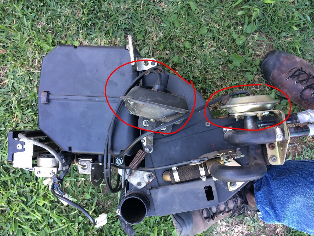

AndBir Posted September 7, 2020 Posted September 7, 2020 1 hour ago, aircobra said: the whole vacuum circuit is only used to pull up the throttle Unfortunately (on the 260z system) not, there are also some diaphragms that are controlled by vacuum system, as shown below. Quote

aircobra Posted October 10, 2020 Author Posted October 10, 2020 by the way, the vacuum actuators are for the heater and the main flap Quote
