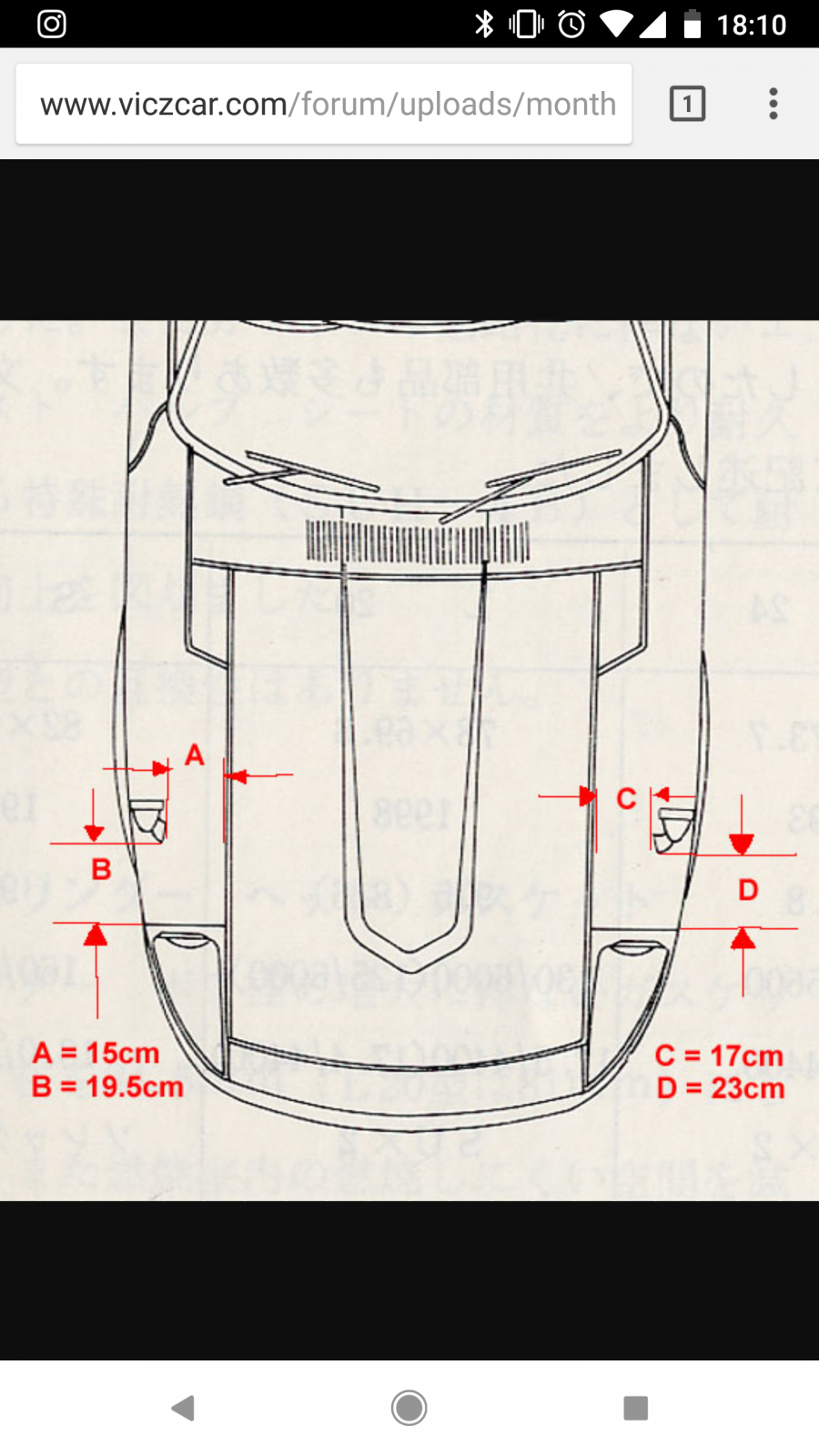

JDM-TOY Posted February 3, 2018 Author Posted February 3, 2018 If you're putting fender mirrors on be aware there is a factory correct location for them. I don't have the diagram to hand but someone else on here will. Some people in the past have stuffed it up! The old story, measure three times and drill once. Hey Gilltech thanks for that. That was another question I was going to ask but I found a diagram in a thread and wanted to see if it was the correct one. See attached screenshot of the diagram Quote
gilltech Posted February 3, 2018 Posted February 3, 2018 That's the one. The mirrors are definitely well off-set from each other aren't they, in both directions. I won't be doing it but were I to do so then I would have to mock them up to test the reasoning behind it, as I know with my eye the fact they weren't mirror-image (pun intended) to each other - particularly measured to the bonnet edge - would just annoy me no end. Maybe there's a happy medium position. Hopefully others on here will chime in and provide some insight and advice. JDM-TOY 1 Quote
theremm Posted February 3, 2018 Posted February 3, 2018 I have installed genuine fender mirrors on my 240z and used the measurements shown in the above mentioned diagram. Very happy with the visibility from the mirrors and to be honest you don't notice they are slightly off-set at all. I never did any mock ups or tested other locations however, so I wouldn't know otherwise. JDM-TOY 1 Quote
