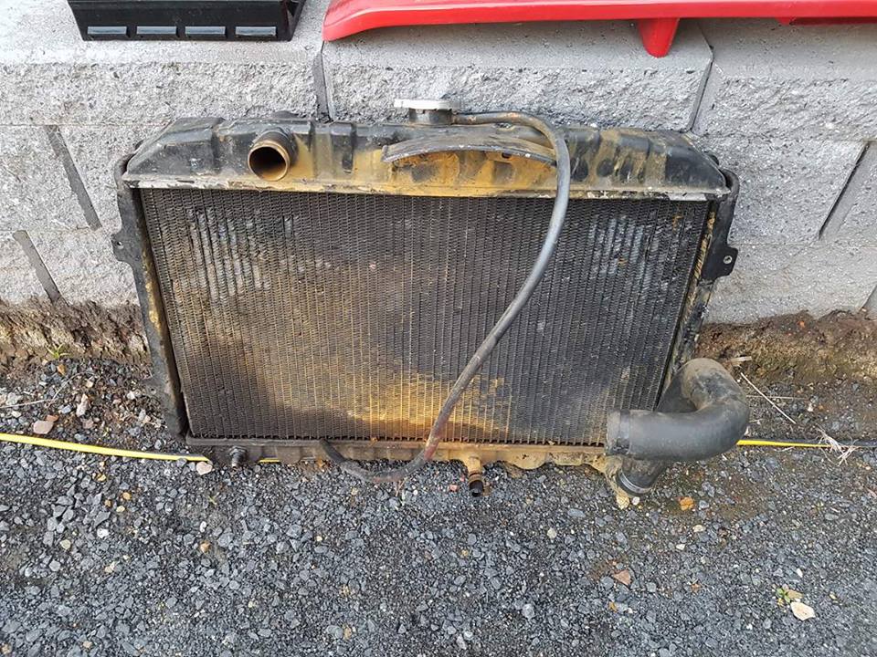

gerrardq Posted September 1, 2017 Posted September 1, 2017 Hi all, Has anyone had any bad experiences with ebay aluminium radiators? is there a better product? I will be converting my Auto L26 to a Manual L28 with a fair bit of internal work. (Pic is what was in the Z) Any guidance would be appreciated. Cheers Quote

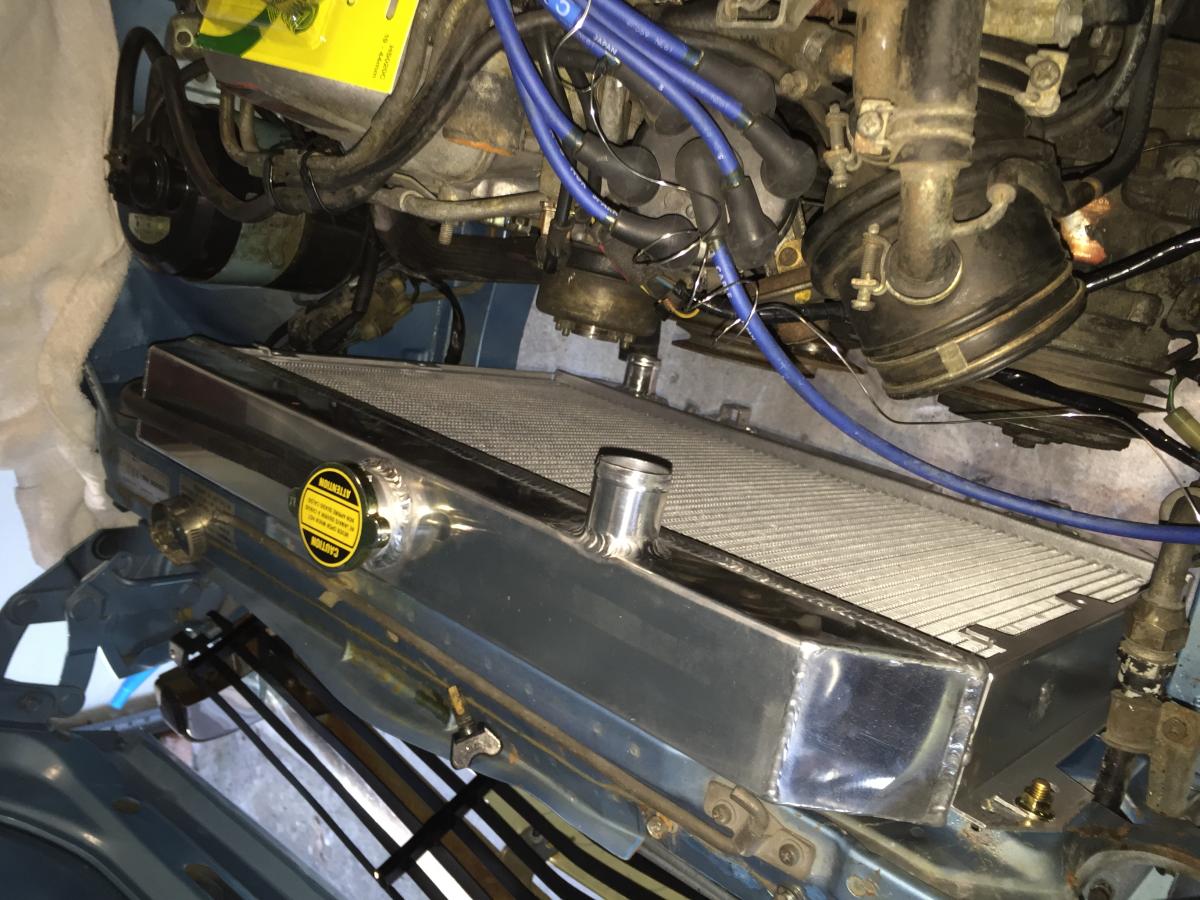

Moderators PB260Z Posted September 2, 2017 Moderators Posted September 2, 2017 Hi I have an ebay radiator in my L28 powered bus. Haven't had a problem, but the mounting holes were slightly off. It does have mounts for a shroud but I did not use them. There seems to be two designs and prices, I went with the slightly more expensve one. Cheers PB Quote
Brabham Posted September 2, 2017 Posted September 2, 2017 Does your current one leak? Give it a clean and put it back in if it holds water. A recore would be around $500 but originals look much better than ally. That looks like a 240Z auto radiator to me. Quote
