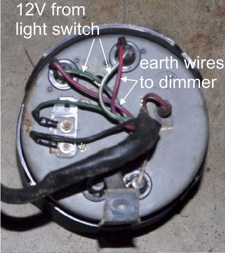

GongZ Posted March 11, 2017 Posted March 11, 2017 (edited) Suggest you don't power up dimmer unit as it is a ground control set up . The green/white stripe wire that runs to your gauges is the power circuit , check you have supply there by using a test light set up or your multi meter . The dimmer has a internal resistor which sometimes breaks down which means it wont work. Try to disengage the connection point just near the back of the dimmer & connect a wire into the two sections of the connector itself that leads from the dimmer unit to the gauge lights , should be a red/blue stripe from memory. I am following this topic with great interest. Scotty has a 260Z - so Alan is correct about the way the instrument lights work. 260Z tachometer < Click to see notes I just thought I would point out that 240Z's are not wired this way. In 240Z's, the power connects through the dimmer (rheostat) to the instrument light bulbs, and the bulb sockets are earthed through the metal body of each instrument. 240Z tachometer < Click to see notes Edited March 11, 2017 by GongZ Quote
